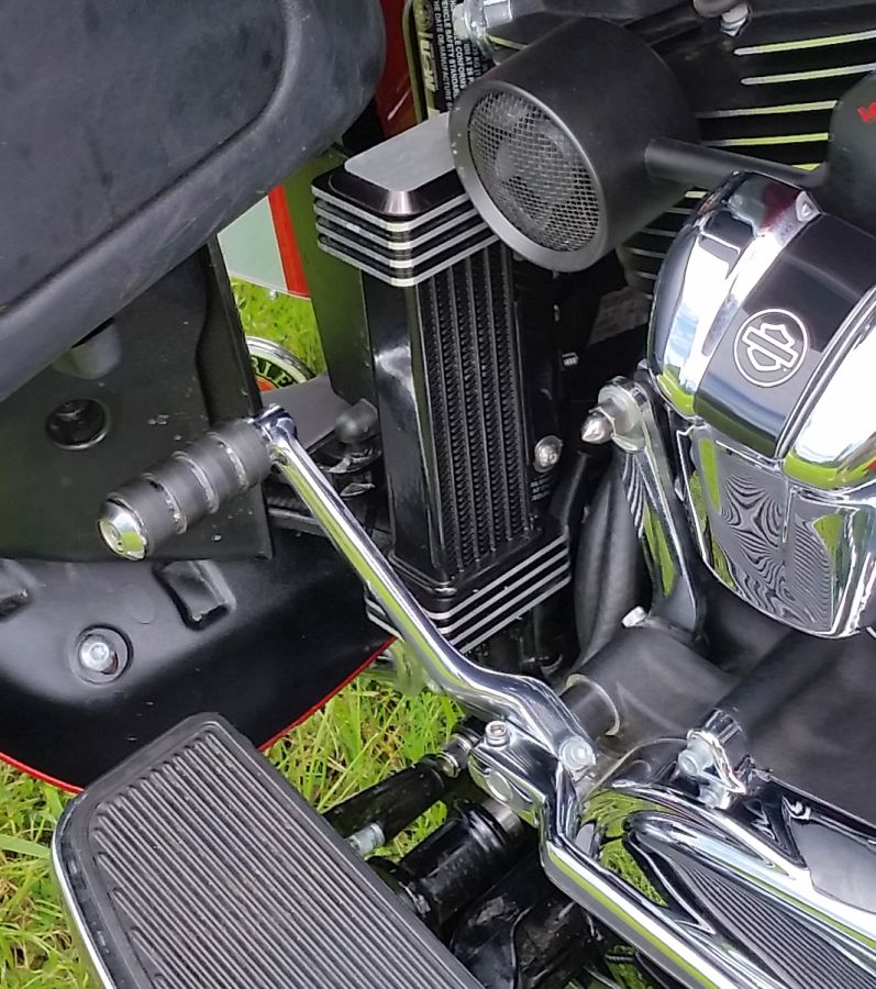

Oil Cooler
Got a few more things done to the Tri Glide yesterday-
- Deleted the stock restrictive air cleaner. Besides being restrictive it also feeds hot, oily, performance robbing oxygen depleted air into the combustion chambers. GONE!
In its place is an Outlaw 606 HiFlow Air Cleaner. Paired with it is a Premium Discrete External Breather System (EBS).
I'm running the same 7 Spoke Chrome cover on it that I ran on the '14 Tri Glide.
The Milwaukee-Eight engine does not have the lean condition that the Twin Cam engine has. It is NOT lean from the factory, AND one can add a high flow air cleaner to it without changing the tune. The ECM will adjust for the extra air.
In this LINK there are dyno charts and AFR charts showing this. I am still running the factory tune. I will eventually put a new tune in, more to adjust the timing a bit and get a bit of a power increase from that. Again, look at the aforementioned link to see dyno charts on that.
- Next up was an Oil Filter Relocation. The reasons for this are to never have to deal with a messy oil filter change again. It is VERY easy and no mess to remove the oil filter now. Also with the filter out in the wind (and not butted up against the engine) it helps cool down the engine. Finally, it allows for installation of a much needed oil cooler.
A bit of a different angle. Also, you can see I am using a permanent, finned, cleanable oil filter.

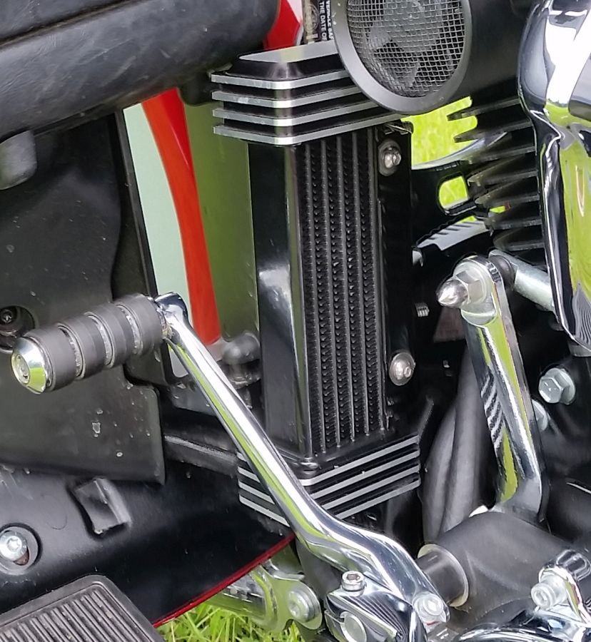

Next up was something that was desperately needed. An oil cooler. You can see from some of our heat testing that there are ways to cool down the metal of the engine, but there is very little in the way of letting heat dissipate from the oil on a Twin Cooled engine. Without an oil cooler the oil just gets hotter and it is very difficult for it to cool down. The additive package (which is what makes 20W-50 oil act like 50 weight oil when it's hot) starts breaking down.
This Dual Cool Oil Cooler is situated directly behind the lower fairing vent.
I have not done any controlled testing yet, but from the hour or so of riding it appears that it lowers the oil temps even more on the M8 than it does on the Twin Cam. :) Controlled testing and a report will be done soon.

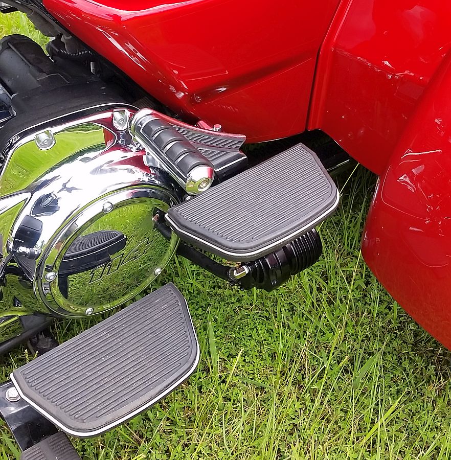

Mary now has about 2,000 miles riding with the new FB16's (Passenger Floorboard Relocators).
She says these are one of the best mods I've done to the Trike for her.
Gets her feet/legs further away from the heat, and most importantly gets her thighs OFF of the grab handles.
Always makes me :D when I can do something that makes the ride better for her!
