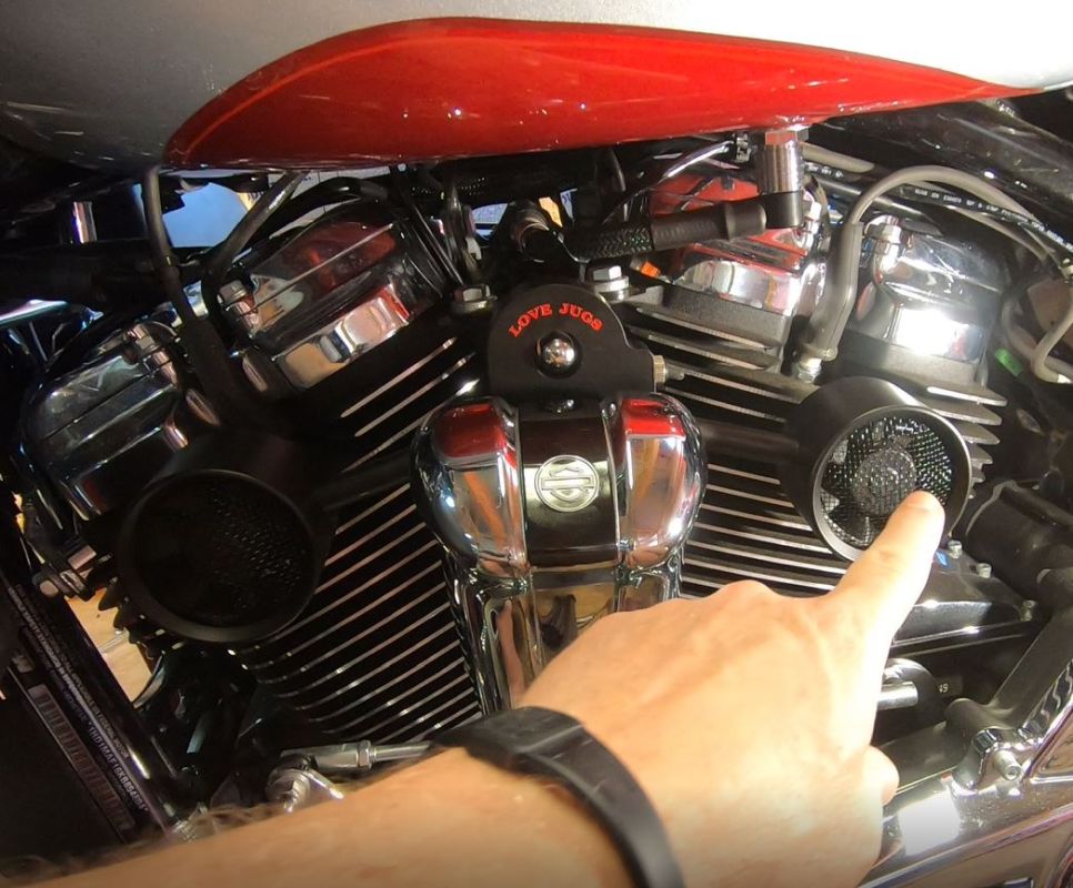

Took some time this afternoon to install the Mighty Mites.
I did not get any test runs done today, documenting the heat with and without the MM's on. Will be doing that later this week.
I did shoot the installation video (even though I discovered, after the fact, that the audio quit working about halfway thru).
Dwayne should have it edited and up on youtube later this week.
I'll also shoot a video of the heat test runs and get a video on that up too.

I installed the Mighty Mites last weekend, and recorded video of it. But I had Two issues that occurred that I am going to rectify this weekend.
1. I lost audio about halfway thru the install recording. I was just going to do a voice-over for the second half of the install, but #2 (below) occurred also, so I am re-installing this weekend and will record WITH audio this time. :)
2. While I have not done my measured/controlled heat tests with the Mighty Mites yet, I have been riding back and forth to work everyday. I am not experiencing anywhere near the cooling effect that I have when using MM's in the past.
I believe I know why. Of the close to 200,000 miles I've logged on bikes and trikes while using fans, those fans have always been very close to the engine fins. This most recent install, I followed the directions, using spacers. This resulted in the fans being over 1/2" away from the fins.
So I will be redoing the installations, sans the spacers, and I believe that I will start seeing the temperature reduction that I've experienced in the past....
...plus I will have the recording needed for the installation video, WITH audio all the way through. :laugh:

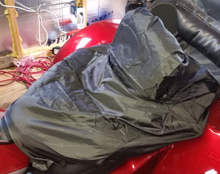

I went ahead and ordered one. First went to order it on the Saddlemen site. They wanted $24 for regular shipping. I looked on Amazon, could not find one, so searched around a bit and ordered one from Revzilla. Only $8 shipping. Got here in 4 days.
Here's a photo on the seat, still in the package...

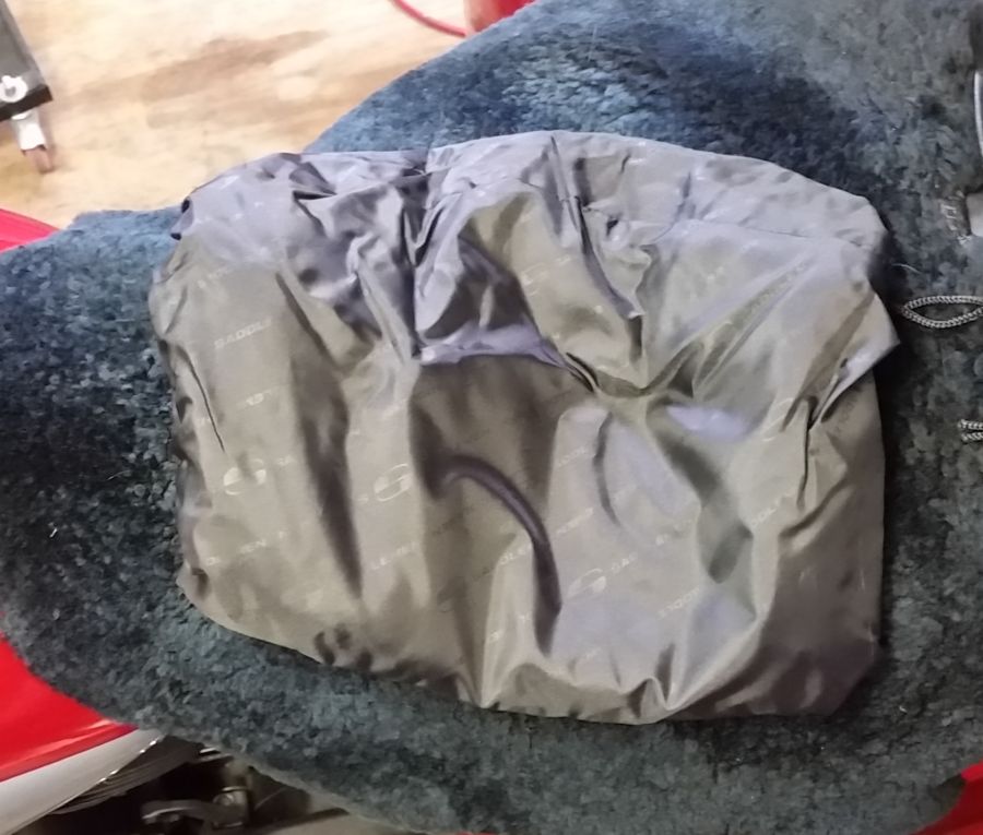

...Out of the package...
...and on the seat.
It was much faster than the trash bag. Looks better too.
I put it around the grab handles, probably won't do that in the future.
Mary is going to spray it with the tent sealer, and I'm thinking we're going to be very happy with it.

I re-installed the Mighty Mites today, got audio this time. lol
Made a small modification.
We've had some cool weather the last few days, but within a day or two it is forecast to be warmer. I will then do my heat testing and see if the little modification made a difference.
After that I will publish the results...along with the difference (if there is any) between the two different installations.
...and on the seat.

I have no reason to think it's waterproof...all but one of the descriptions I read noted that it was water resistant. Mary is going to spray it tomorrow with tent sealer, so the first use it sees will be waterproof for sure.
Yes, it went all the way around the seat, the sheepskin (with the air hawk underneath) and the back rest, along with the grab handles too. Super easy, but still snug. I reckon the weak link will be the elastic.
I'm very happy with it, going to be much easier to use. When on a trip Mary usually does it, and I'm sure she like this better. Many times I am at work when a rain move thru or in, it is going to be much easier to get this covering everything when that happens. Thanks again for the link!

Photo of the last bit of the MM install yesterday.

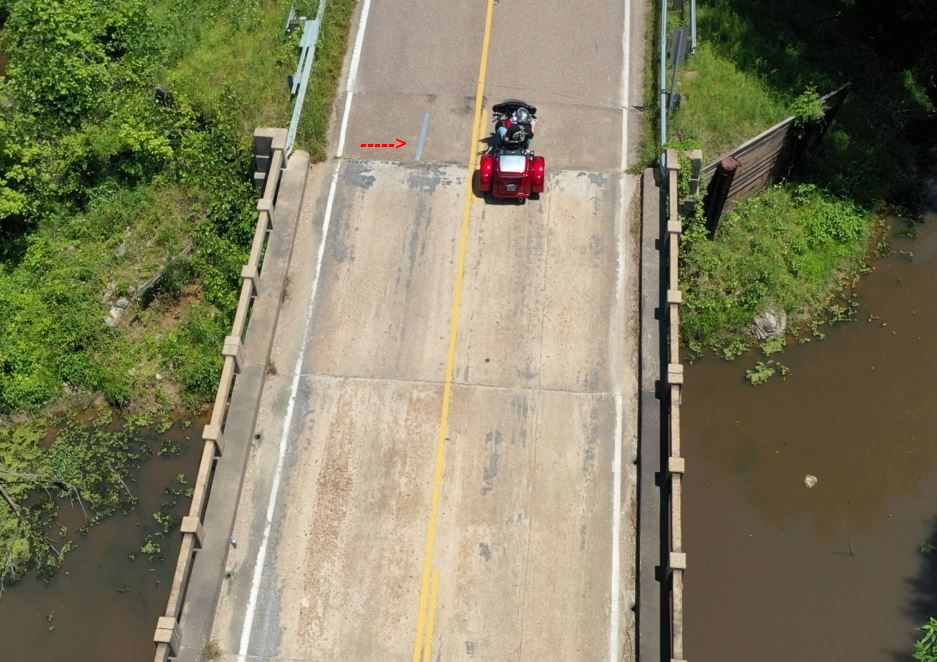

Today we did the OEM shock testing on the 2019 Tri Glide.
All the BumpRecorder Data will be uploaded to Dwayne's computer tomorrow for him to put in a video and convert to jpgs for the written report.

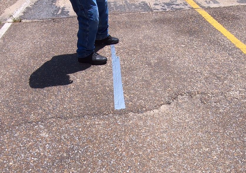

We used a stretch of road that has 2 bridges (4 bumps) with relatively smooth road approaching each bridge.
First thing we did was put a line of duct tape on the road, so that when the front tire was lined up with that line, the rear tires would hit the bump the same each time. We did this at the entrance and exit of each of the bridges.
Next, I rode with the front wheel on each line, with the cruise on 40 mph in 4th gear.
I did this with the shocks at a setting of 1 and also with the recommended setting of 4. (4 was better).
This gives us a baseline of how the oem rear shocks perform at each of the 4 bumps, plus the smooth road in between.
As time permits I will be doing the same exact test with the Convertible Comfort Lift™ and the oem rear shocks, and then the same test again with the 14" Trike Series Shocks™.
That is when it will get very interesting, seeing the comparisons between those graphs.

A shot from above as I head down the road for the first test.* Red -----> pointing at the duct tape that I will hit with my front tire on the way back.

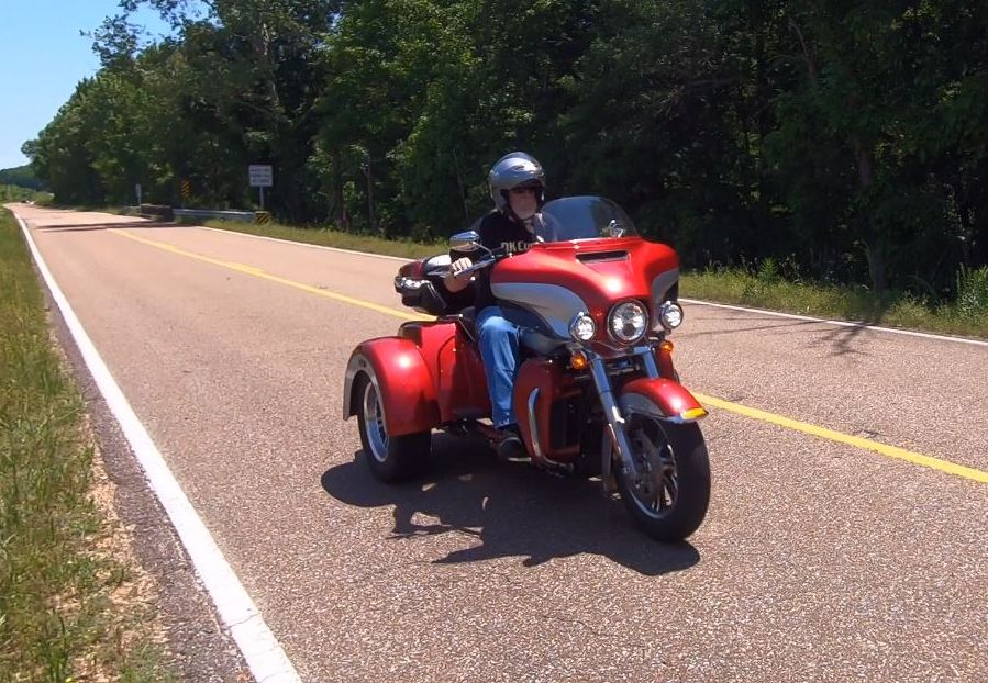

Kevin,
It'll be interesting to see these reports on the stock and your shocks, but I have to question your choice of "bumps"!! That looks like a perfectly smooth road around here :D !! We've got bumps that'll throw your back out, lift you clear off the seat, and rattle your eyeballs. Seriously though, that's just the kind of road imperfection that I was hoping the 14" shocks and lift kit would smooth out and they worked great doing just that.
Kevin,
Hey Barry,
Yeah, the photo I posted was not a good representation of the bumps.
I chose this road because it has smooth road (to get a baseline), then a bridge with bumps at the start and finish, then some smooth road, then a bridge with bigger bumps (plus expansion joints) at the start and finish of it.
(and all of these are "double-tap" bumps, where there is one, quickly followed by another. The double taps are not only uncomfortable, but also show on the BumpRecorder graph how well...or not well...the shocks recover between bumps)

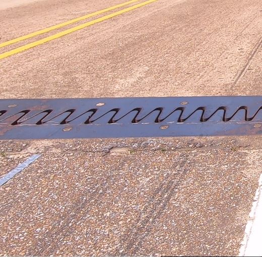

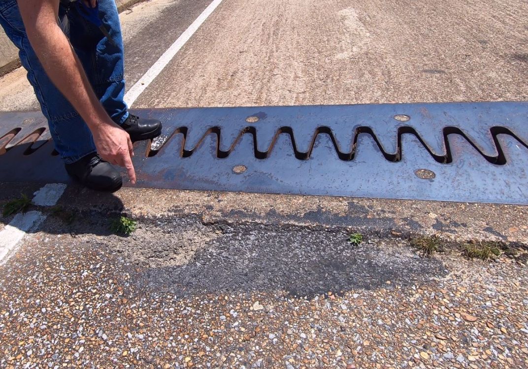

Here are a few more photos-
Small uneven bumps, then the bridge juncture bump:
An expansion joint with some bumps with 3/4" to 1 3/4" sharp variations:
Then another expansion joint followed by a 2.5" hole for the right tire and a 1.5" for the left tire.
These are some pretty good bumps, with the last one being a bit of a bone jarring one with the OEM shocks. We have larger ones, but these are a good representation of everyday bumps that take their toll.
(plus, the bigger ones literally go off the chart on the BumpRecorder!)
