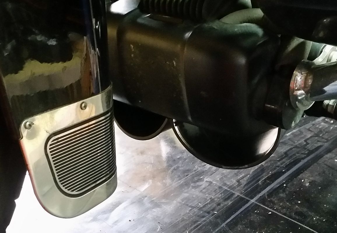

I just got the TG back from the Dealership.
They replaced the horn bracket under warranty.
Did the clutch recall.
Installed new front master cyclinder
Replaced the left side switch...now all my lights work!
Did the front stabilizer with a new spacer. I noticed they did not use factory washers, but used lock washers.
They did not touch the panhard rod, the jam nut is still loose.
The shift linkage arm is still loose. They tried, but said next time I bring it in they will work on it again. Also, they forgot to touch up the frame where there is raw metal showing from the stabilizer bolt knocking around when it fell out.
Really happy to have all my lights again, and that they replaced the horn bracket under warranty.
