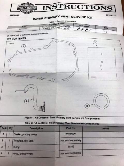

I would like to know what is in the kit, Thanks Doc
Here ya go-

1. Since I am transferring oil from the transmission to the primary, I am going to be installing the Vent Kit and making a video of that. Yes, I could get it done under warranty, but it will cost me less to do it myself, PLUS, I'll be able to do a video of it.

Here's a video of us removing a bunch of parts from the 2014 (some of which were previously on the 2011) for future use on the 2019-
This afternoon we are filming the installation of the Primary Vent Kit. Should be up on Youtube sometime next week.
Hopefully it will be the end of my trans to primary oil transfer.
Looking forward to the video and hope it helps, so far the people that have had it done, it worked, have heard also that it didn't.:(
All for now Trampas
Interesting video, doesn't appear to be to complicated. Was wondering how long it took or did you time it just curious. Have heard it is a two hour job if I remember right but I could be wrong which most of the time I am, LOL:D
I know you will keep us updated if it works or not, never have heard from the people that had it done and it didn't help, be curious what Harley will do on the ones that the vent don't work.
All for now Trampas
All for now Trampas
Nope, not complicated at all. It took a bit less than 2 hours, but we were videoing also. Would have been closer to one hour if not making a video.
But, we did have a couple of advantages-
The instructions call for removing the rider and passenger floorboard brackets, which would normally be necessary.
Since I am running rider floorboard extensions and passenger floorboard relocators, we did not have to remove the brackets, just the actual boards. That saved a solid 30 minutes between taking them off and putting them back on.
I'll definitely be checking and reporting over the next few weeks/months. Might have a week delay with the freeze coming in early next week! I am not planning on riding in 15-20* temps! :xzqxz:

Two things to report on the Tri Glide-
1. At 500 miles now, since the Primary Vent Install. So far no transfer. Will check again in another 500 miles.
