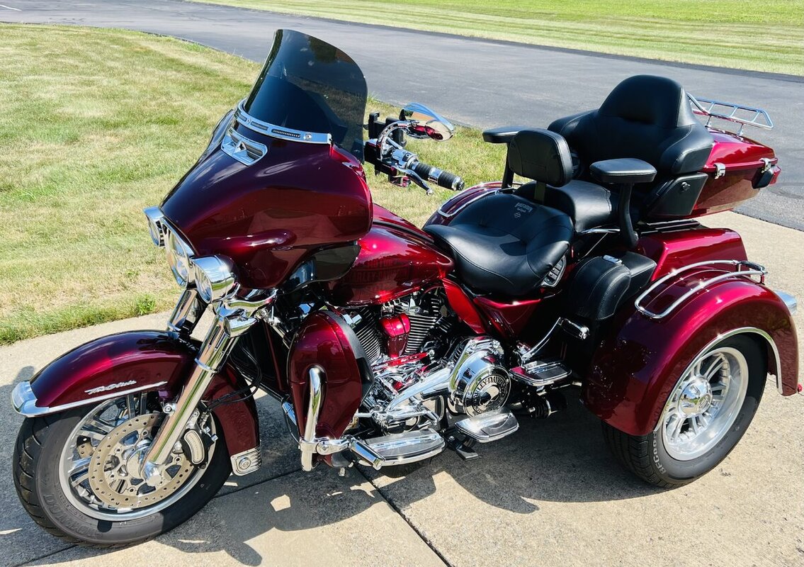

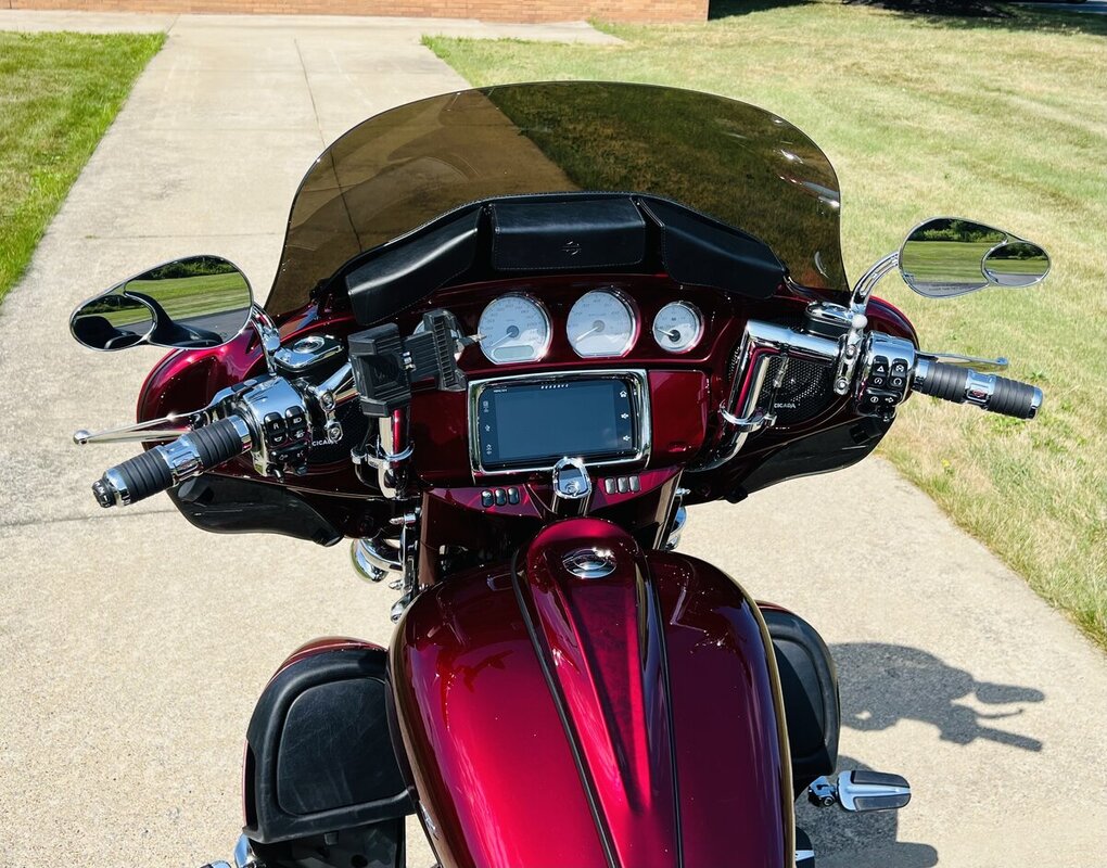

I also have a 2014 and chose the LA Choppers 12” chrome Grande Twin Peaks - 1-1/2” diameter.
I do a lot of my own work, but while I had my TriGlide apart for new paint last winter, my Indy came to my house and did them for me.
The cables are still fine up to 12”, but would certainly need new cables for anything taller.
You will simply just cut some of the tie wraps, and pull and manipulate new positioning.
