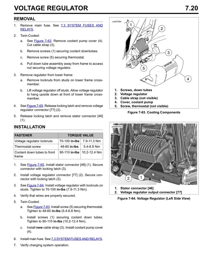

A question for anyone who has actually removed the voltage regulator on a trike. I followed the instructions in the service manual. I removed three bolts (have not found the cable strap to cut). The problem I encounter is "Pull downtube assembly away from frame to access locknuts securing voltage regulator".
I do not like to force anything but this assembly does not move anywhere near enough to gain access to the two locknuts. I'm going to guess that the rubber hoses will perhaps kink and allow some movement. So, my question again is..... how do you get the downtube to move. In complete honesty, this is a 2014 tri glide and my manual is a 2016 touring.

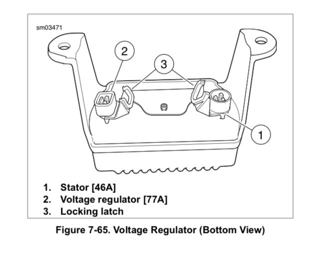

Unfortunately, I’ve never had to remove one personally…. You stated that you have a service manual, but will reattach below what I have…
I have both a Hard copy of the service manuals & PDF copy saved on my phone.
The trike supplement does not cover the voltage regulator, so it is typical on our trikes and 2 wheeled bikes.
Attached are screenshots on removal & installation from the service manual.
Hope it helps!

UPDATE ----- I took my service manual and went to talk to the service department at the local HD dealer. It appears the service manual is missing the portion where you are instructed to drain the coolant, disconnect four coolant hoses, and remove the assembly. After completing the voltage regulator work flush the cooling system and refill.

I don't believe the wires detached off the back of the regulator as there are locks that hold the wires on.
Thanks for the update and the addition info that the service manual itself is not complete.
Glad you got that figured out! 👍🏻
