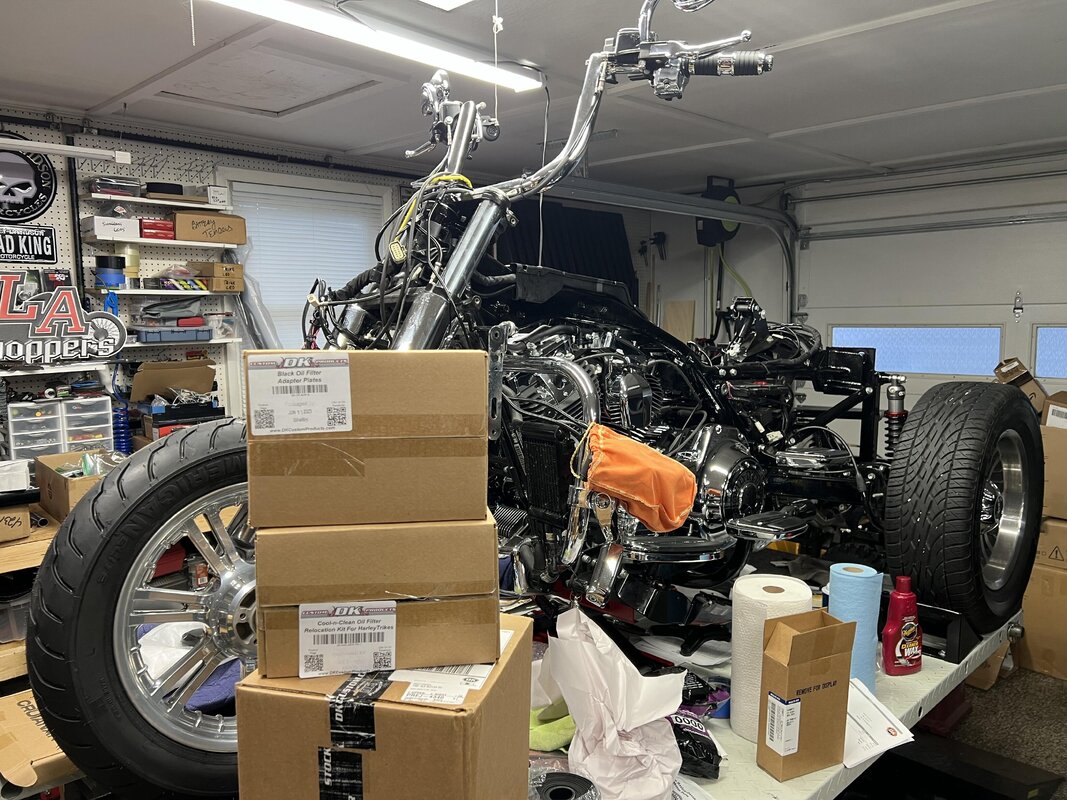

Hi Kevin,
I just received it today.
I was going to wait until later in the year, but since it’s all apart now (parts are in paint) and I’m upgrading other parts too… now was the time to get it and install it.
It’s now added to the “to do” list this weekend.
Thank you!
