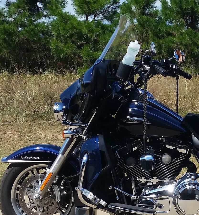

Installed the winter windshield. It is about 4" taller, has a recurve, and is squared off at the top corners to block even more of the air.
This is a windshield I have to look thru, not over. But for riding in cold temps, it blocks Much more of the air.
It works very well at blocking the wind, it also reduces MPG by 1-2. It also makes the front end just a bit lighter and I can feel more feedback in the handlebars from turbulent/crosswind air. Nothing even close to approaching bothersome, but it is there. For us it is a good trade-off for riding in the 20's , 30's and 40's.
One final note...the fairing vent works equally well with this windshield as the stock windshield.

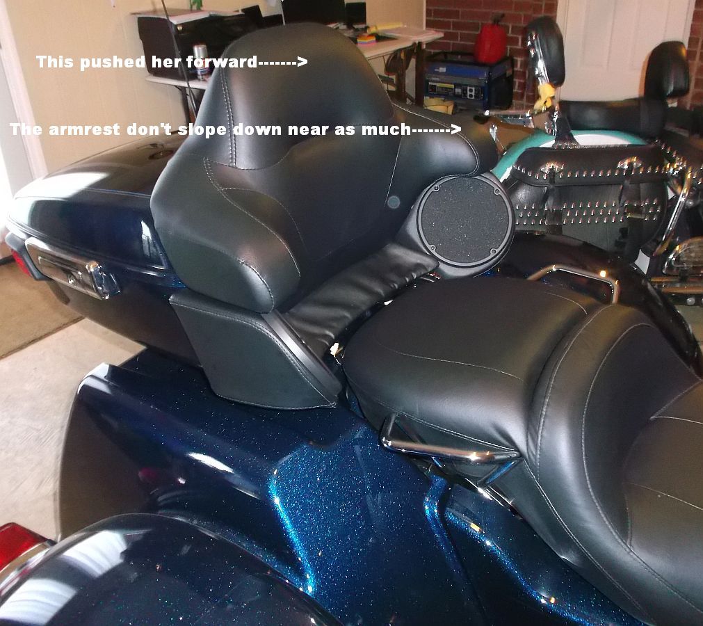

Over the years, we've had several bikes (and 2 Tri-Glides) with Tour-Paks that have the wrap-around passenger backrest. Mary has logged well over 100,000 miles in comfort with those factory stock backrests.
When she sat on the 2014 with the new passenger backrest, it felt even more comfortable for her....UNTIL our first multi-day trip.
As noted in the picture below, the armrests on the new style do not slope down near as much. After hours of riding with her arms resting on those rests, her arms would get sore right below the elbow. Also, she said the backrest being higher and thicker prevented her from leaning back.
Initially she thought she could modify the existing backrest, but after removing it and looking at the plastic frame that the foam and vinyl cover is wrapped around, it became apparent that reshaping it was not really feasible.

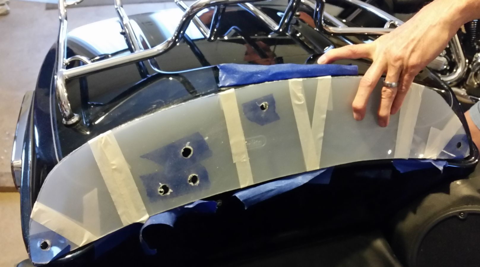

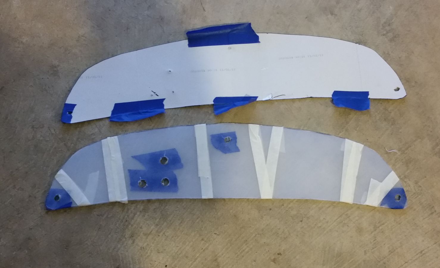

So with the stock backrest unbolted and put away on a shelf, she got a piece of paper and made a template of where she wanted the padding to be for her backrest. It turned out to be quite simple.

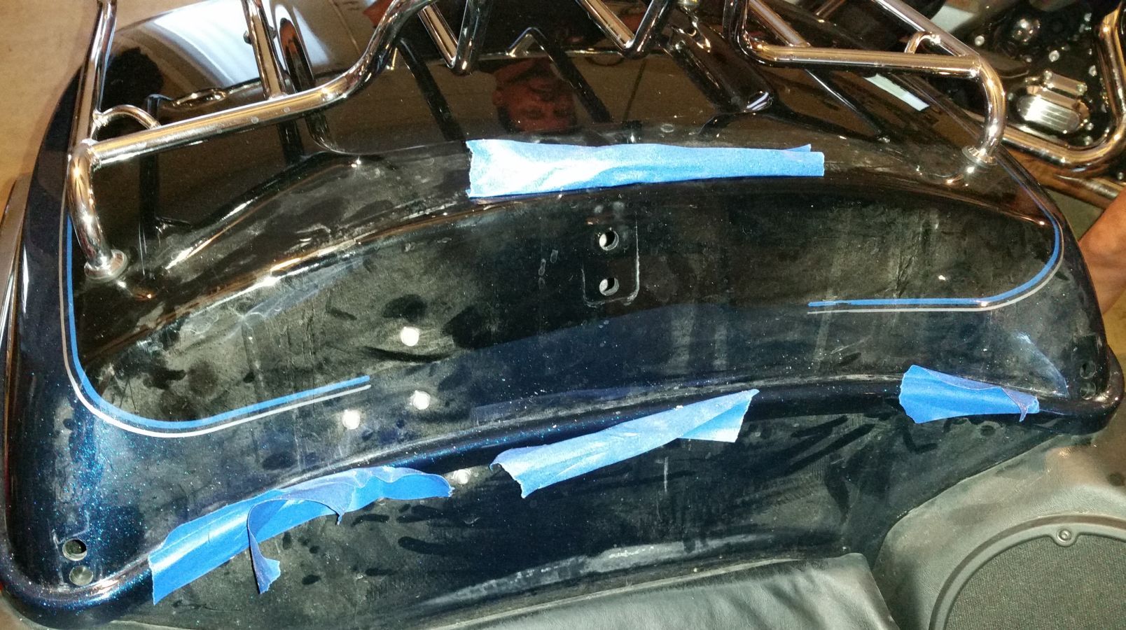

Here's a pic of what the TP looks like with the backrest removed. Yep, lots of road dust there that never gets cleaned. :)
Here's a pic of the paper template (top) and then the plastic frame for the new low profile backrest.

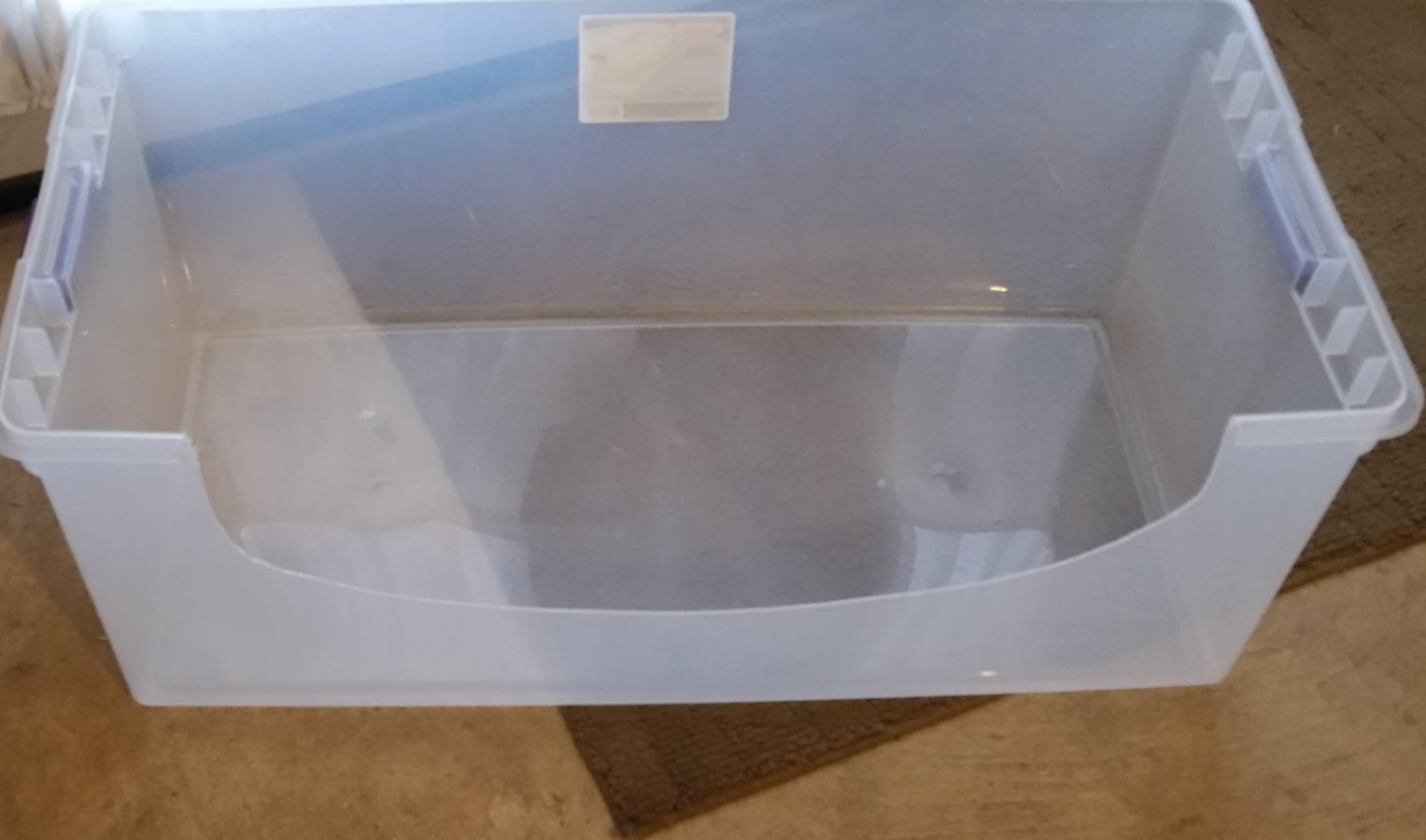

This is the tub that she cut the plastic frame/form from. It is close to the same thickness/strength/flexibility as the stock one.
After cutting out the plastic, we marked where the three backrest mount holes needed to be, and then the access holes for the TP lid strap unit. I drilled the holes for her...other than that she did this entire project herself.

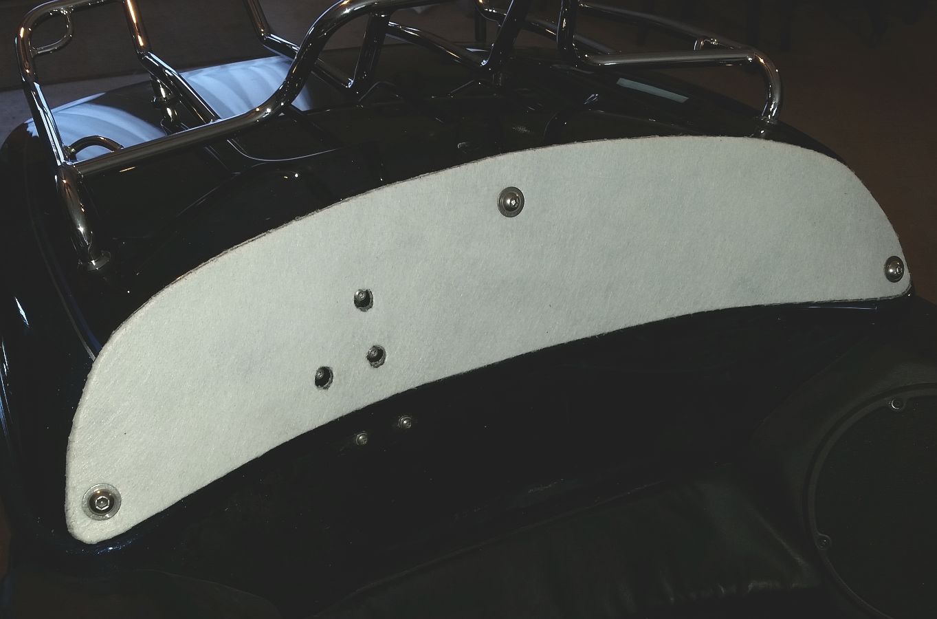

Here it is, checking fitment-
She then cleaned up the plastic form and then glued a stiffener to it. This stiffener is a material she uses in making the frame covers for the Sporty solo seat systems. It is a thin, but strong cloth-like material. After the glue had dried, we test fit it to the TP to make sure it would bolt-up and that it was what she wanted.
She then sewed a vinyl cover that slips over the plastic form and then velcros together at the bottom. By using velcro to hold the vinyl cover to the frame (instead of what HD does, which is to staple the vinyl to the plastic) she is able to play with different foams and thickness of foam easily. Plus I had to have access to the bolt heads that secure the rest to the TP.

Here is a pic of it installed on the bike, but with no foam in it yet.
Here is a pic with it ready to ride, with about 2" of foam in it.

Kury- http://www.kuryakyn.com/products/1596/adjustable-passenger-pegs
The Kury is what we have used on the last several bikes. Mary really likes them because of the variety of different positions for her feet.

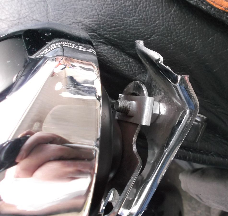

1. On our Fall Color Trip the bracket for the Cowbell horn broke going down the interstate, just leaving the horn hanging by the wires. I still have not taken it in to see if they are going to cover it under warranty.

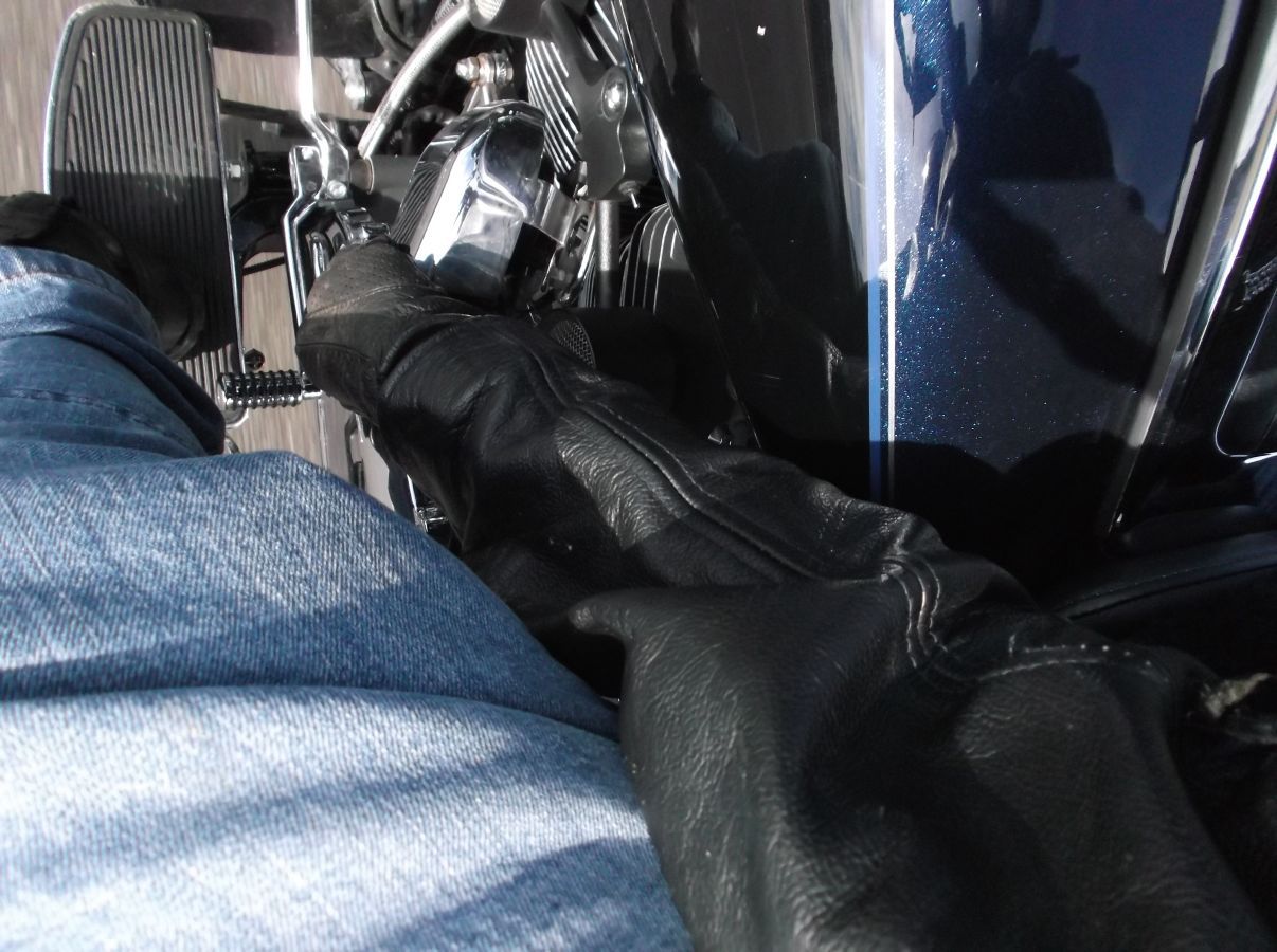

Picture Mary took going down the road-
Once I pulled over and disconnected the wires-

our horn fell off on the freeway too - was interesting pulling over to the side and trying to shift down while holding it.
replaced under warranty.

Yeah, that was an interesting experience, for sure, riding to the next off-ramp with the horn dangling.
