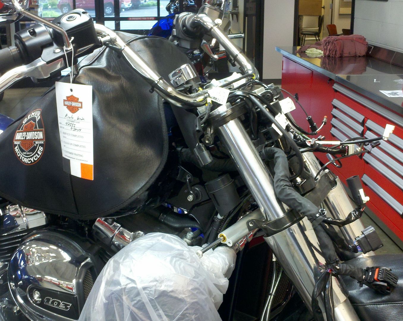

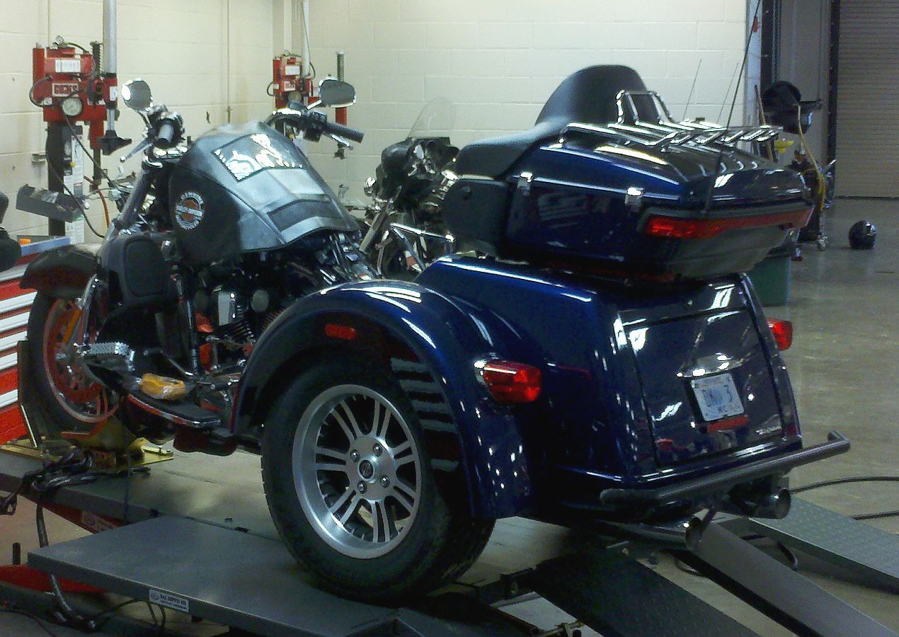

The TG is at the dealers right now...been there for a week. Nothing wrong with it, but when I purchased it, part of the deal was that they would install my custom handlebars...no extra $.
Well, I provided the handlebars, and they were able to find everything else needed except the brake line. So last week they pulled the brake line off and I carried it to a local shop that specializes in hydraulic lines. They made up a custom line which I delivered back to the dealer last week.
This afternoon the dealer called and said it was all finished up. Will be heading over tomorrow to pick it up.
Here are a couple of pics I took when I stopped by to pick up the stock brake line-

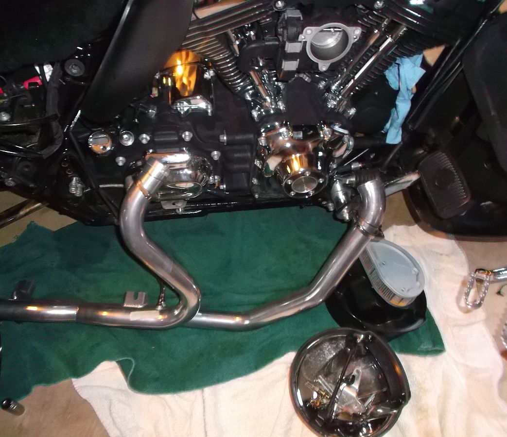

Ok, another picture update.
I already had a Power Vision tune on the bike while it was breaking in. But I recently did the rest of the Stage 1 by adding the Outlaw 636v A/C system and some Fuel Moto 2-1-2 headers, finished off (for now) with some Rush Slip-ons.
Stock A/C removed, stock headers removed. Ready to install the new headers.
Got the catless 2-1-2 headers installed, along with the slip-ons and the Outlaw 636v installed.
DETAILS-
On the 2011 TG I cut out the cat on the stock headers. This time I decided to get some headers that were already catless, also that would have the bung for the wide-band sensors. (Devin as the "PRO auto-tune" for the Power Vision that I'm going to mess with).
Also, got them ceramic coated for some heat reduction.
For a few months I've been paying close attention to the sound of slip-ons, and I kept liking the sound of the Rush best. So I put my old Rush Slip-ons on. No Baffles, just the TTI W258's. (that's the configuration that produced the best dyno #'s on the 2011, and I like the sound just fine :) ).
However, I will be building some slip-ons from scratch in the next couple of months. I believe they will produce more power, and hopefully I will like the sound. We'll see.

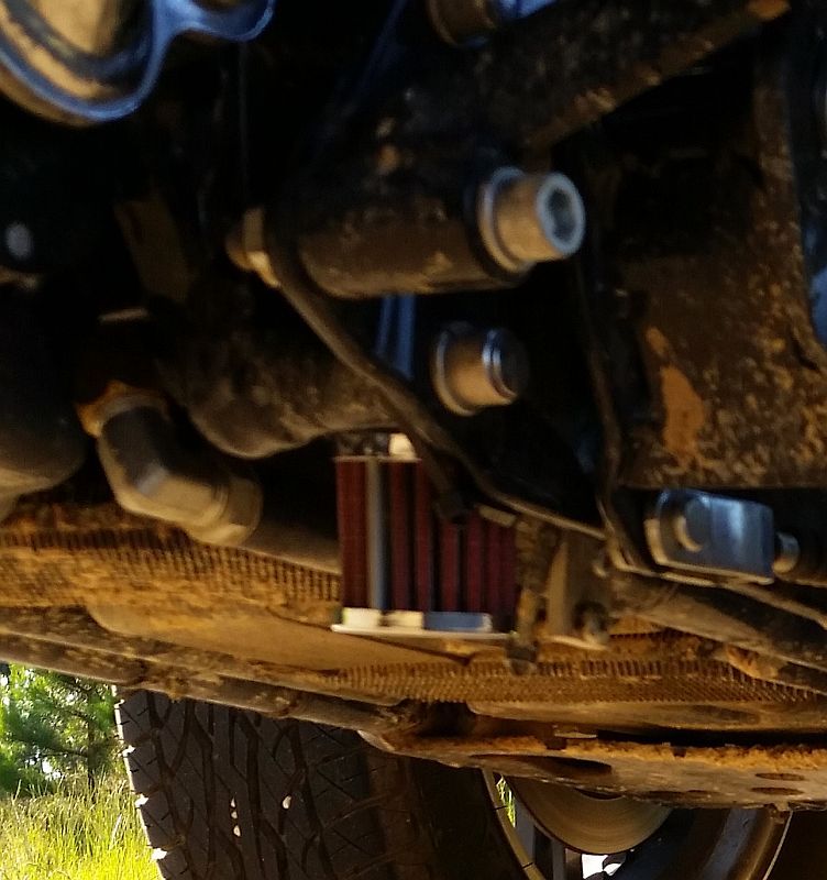

One complication encountered...the OilBud Oil Cooler thermostat housing sticks up too far for the headers with the wide-band sensors. I called Oil Bud and he overnighted me a shorter housing...except it did not show up...someone elses parts were in the box he sent me.
We ended up fabricating our own plate for the thermostat housing.
On the OilBud, I am still not done testing it...will report more when I have a definitive conclusion.
The headers installed easily and quickly, re-using the stock heat shields.
Because the 636v dyno's out ever so slightly better than the 587, even with the shorty filter element, that is what I installed. However, I am not at all sure I like the look with the shorty filter. I may end up putting a 587 on it.

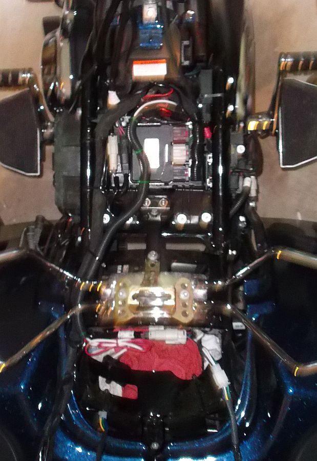

Wiring-
Next thing I did was a bunch of wiring.
Power Point in Tour-Pak
Two ports for heated gear
Cig Lighter mounted on handlebars
Power Vision cable routed better
Already had the Wards Parts Werks fans wire, but cleaned that up a bit
Isolator, canbus converter, and adapter for some aux lights
These are all connected directly to the battery with inline fuses. It was a real rats nest of wires once I had hooked everything up and tested to make sure it was all working. All that went without a hitch. But I did not take a pic of it when it was a rats nest...just too nasty looking.
But below is a pic of how it turned out once I tucked almost all the wires into a flexible wire conduit. I was more than a little nervous/cautious doing all this wiring on a Canbus system. But it all worked out well, and is much cleaner than the wiring I did on the 2011 TG.

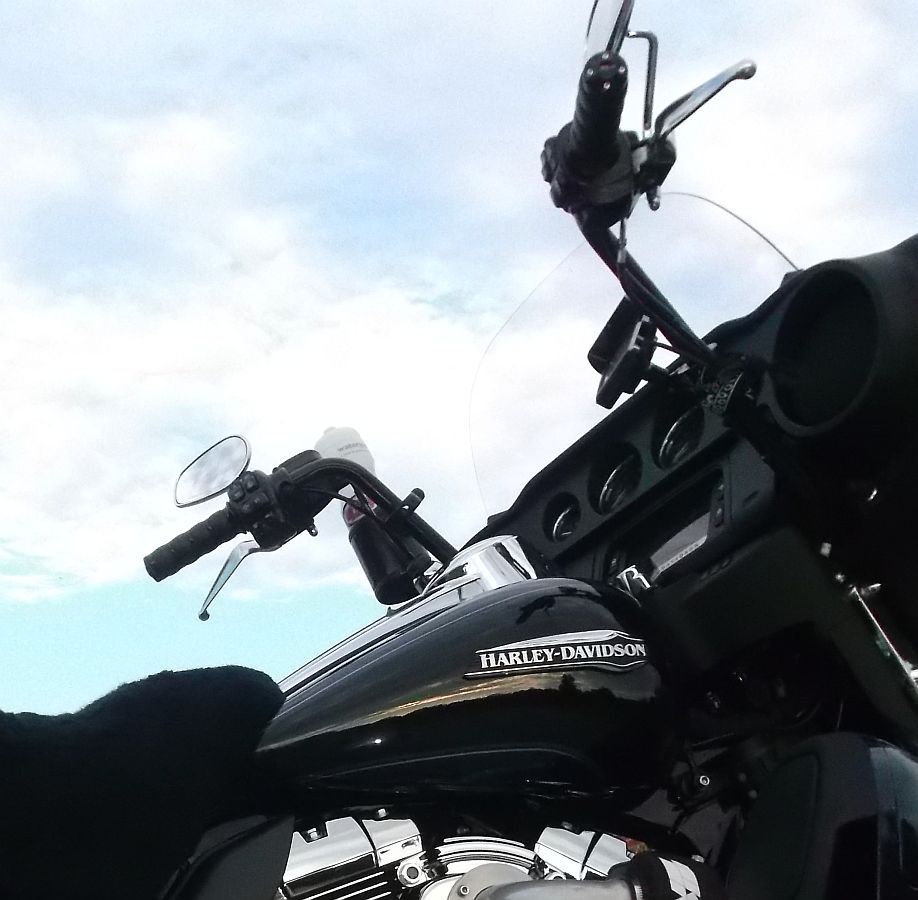

I need to take some better pics, but the one below are the stock bars, extended 9" longer.
Much more comfortable, and I have the following mounted on them with room to spare.
Drink holder
Power Vision
Cig Lighter
Video Camera mount
I also have some ISO grips on it and am really starting to feel a bit at home on the 2014.

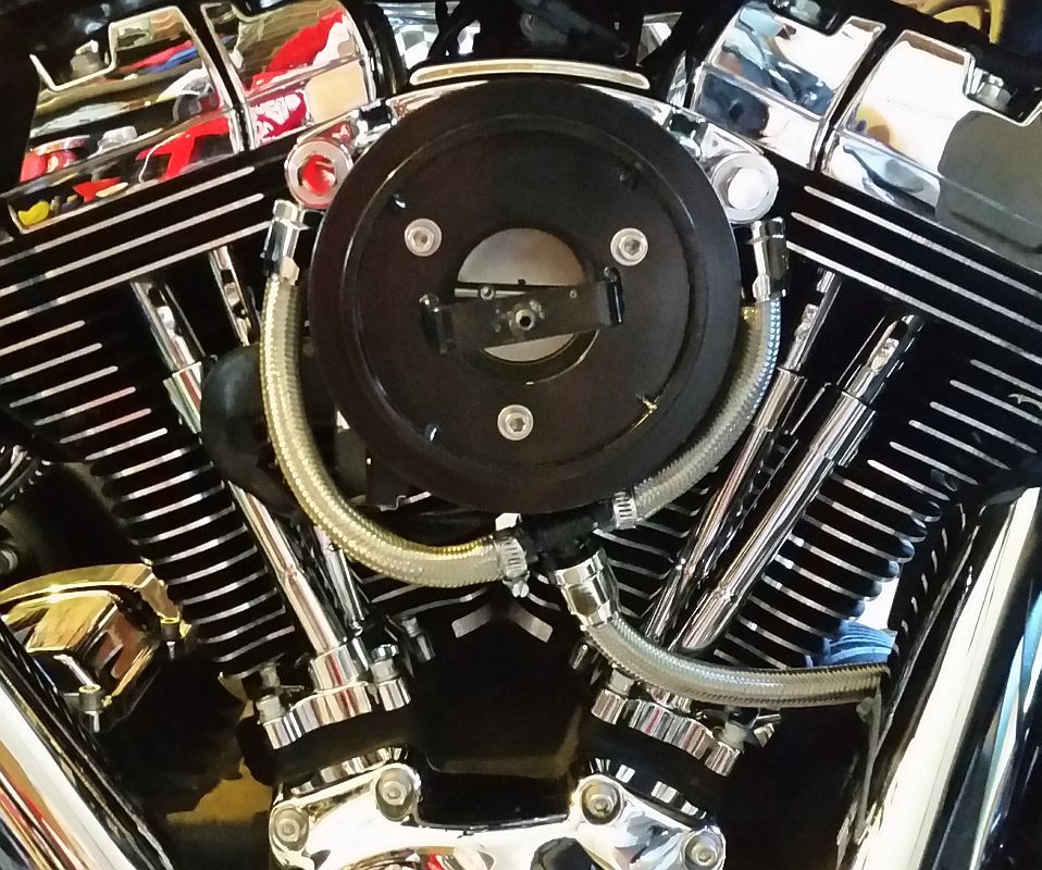

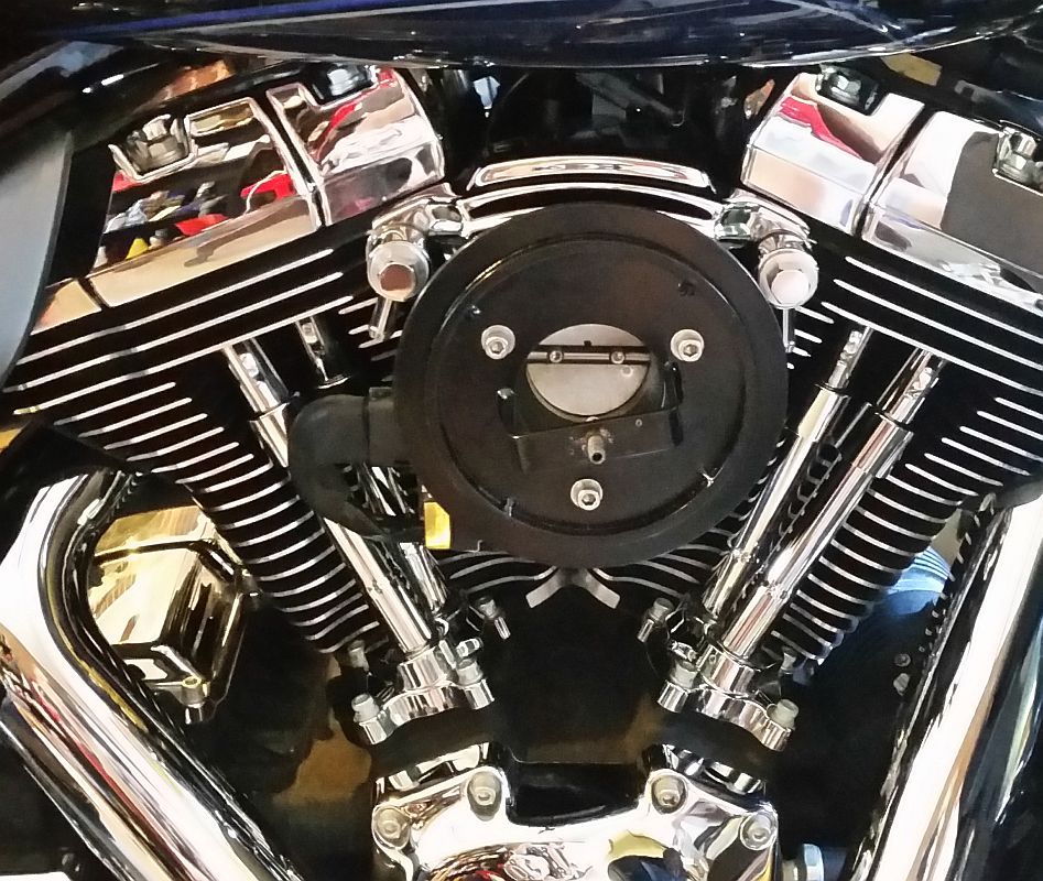

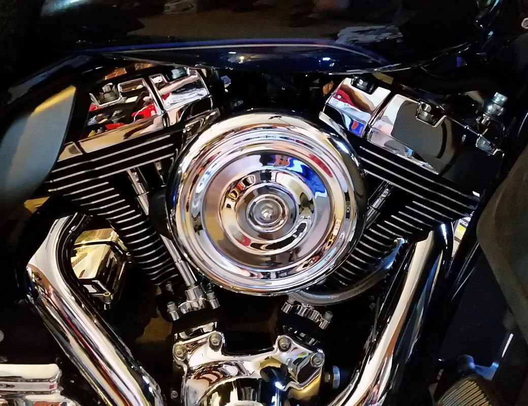

How's that A/C work sitting right behind the lower fairing? Looks like it doesn't get much air compared to the stock A/C.
Re: Ongoing 2014 Tri-Glide build-out, lots of pics and thoughts on the differences
It works great, flows much better, AND more air than the stock filter. (the air come from 360* around the sides of the filter, not from the front that is close to the lower fairing)
It flows 245 CFM, and utilizes the Venturi Effect to increase the velocity of the air entering the throttle body via a unique Patent Pending tube design.
However, it does not Look like it will flow a lot of air...we are all so used to the bigger elements. That is why I mentioned that I may change to the 587...just for looks.

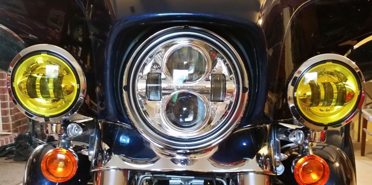

Some new pics/info on most recent mods-
I wanted my passing lights to be yellow...just to stand out a bit more to oncoming traffic, both during the day and night.
I got some film from lamin-x.com and it worked like a charm.
Really happy with how it turned out, and it did not seem to reduce how well they light up the road at night.
I originally had pulled the stock air cleaner and replaced it with the 636v with the shorty filter. Had to use the shorty because of the radiator filled lower fairings.
While it functioned fine, I just could not get past how weird it looked with that filter on there.
So I pulled it off and put my Outlaw 587 filter from the 2011 TG back on...running it with the Chrome Bobber Cover.
Only thing I did different is use the Premium Discrete Breather System with the SS Braided hose and the Chrome Hose Clamp Covers.
I did keep the Chrome Support Bracket Cover on to tie the two rocker covers together.
Here's a pic with the 587 backplate on and the beginning of the PD Breather System.
Here it is with the SS Braided Hose installed...with the Chrome Hose Clamp Covers for a bit of a finished look. I know the hose is not symmetrical in the install, but it is covered by the Bobber cover, and I wanted the hose to have a forward angle to it after the T-Connector.
Here's a pic of it all put together...still inside.
Couple Pics of it outside-
I routed the hose forward and then down on the left side to the filter...between the frame and the floorboard.
Had to get down on the ground to see it to take a pic. Still lots of mud under there from the Boogie Rally. lol
I've been extremely happy with how it's running, and we are enjoying it even more than the '11.
That's it for now. More thoughts and pics to come in the next week or so.

Kevin, any risk that the SS hose will rub thru the push rod tube? Lot of vibration at that point and SS acts like sandpaper. :confused:
Did you buy a sheet of the film and cut it yourself? I went to the site and didn't see any yellow or amber rounds.
I've ridden about 300 miles since this install. Just went and checked the hose. Pics I posted alter the perception a bit. The hose is 1/2" or more away from all parts of the engine and exhaust. Only place they are close is to the back of the cover...that's ok with me if it scratches that edge.
Appreciate the heads-up, am going to keep an eye on it and make sure nothing shifts.
No, I bought them pre-cut with tabs. Here's the link-
http://www.lamin-x.com/Harley-Davids...er-p/hd021.htm
