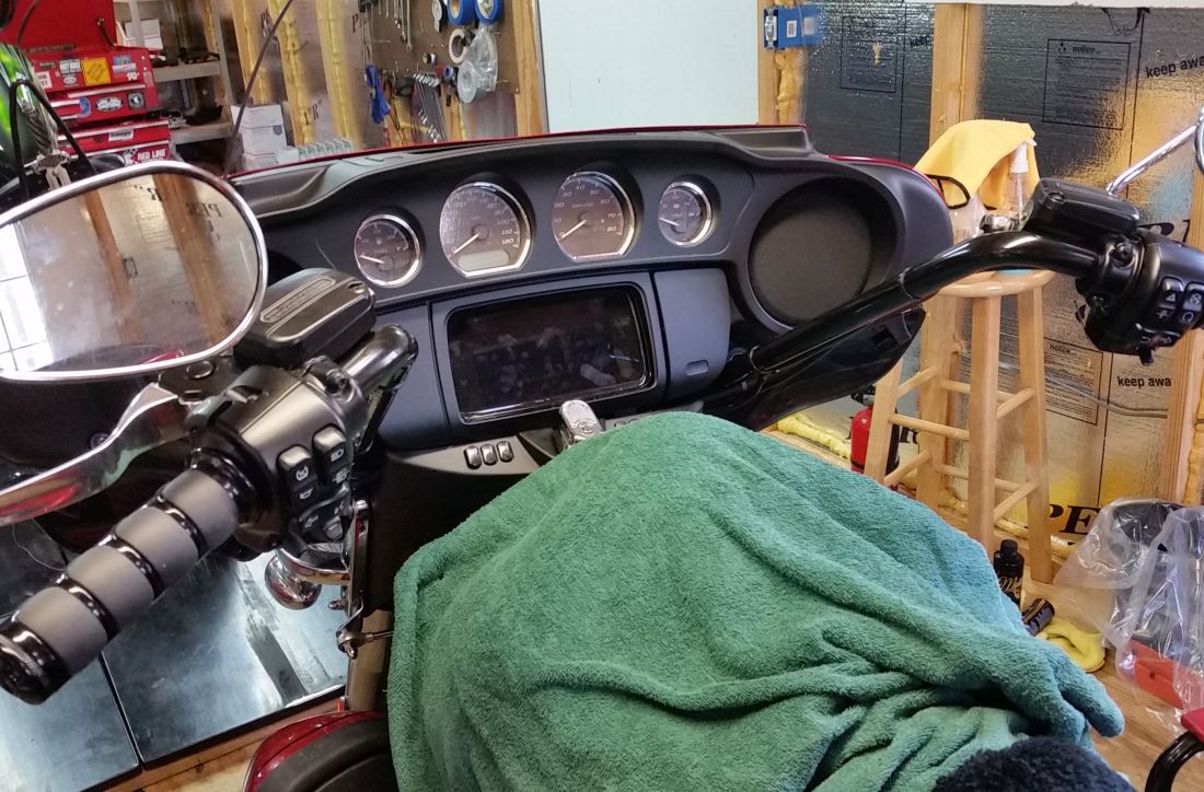

One of the first things I'll be doing is adjusting the bars a bit...I will be rotating them back towards me a bit. Will not look as "cool", but it will be Far More Comfortable!

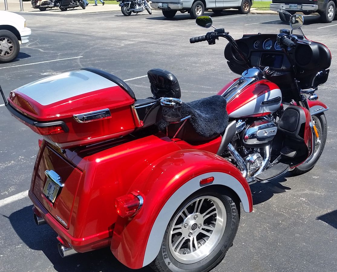

When I installed the tour pack extension and move it back 2 inches there’s a gap between the seat and the flap from the backrest. Wires are showing. Did you experience the same thing? Any advice?
Same thing with me
Called DK and the young lady advised me to go to kuryakin and get the tour pal spacer - believe it’s same one Kevin uses
Copied & pasted from the Tour-Pak Relocator Description:
Fitment Note: Depending on how far back you move your Tour-Pak, you may want to fill the gap between it and the back of the seat. Part #8742 from Kuryakyn does a nice job of filling that gap.
We have ours relocated back 3" and do not use any kind of filler pad. We always have a sheepskin on the seat and it fills that little gap.
As far as the wire showing, I use zip ties tokeep them tucked up under the OEM backrest flap, just like they are stock, so only the line of wires going from under the seat to the connectors that are under the OEM backrest flap would be visible, but for the sheepskin.

I had a 2017 tri-glide put the Kuryakyn filler pad on after I put the DK relocation kit on. Traded the 2017 for a 2019 Tri-Glide Put the relocator kit on. and bought another Kuryakyn filler pad on. The filler pad seemed to me thicker than the older one. Momma like's it.

First thing I did was adjust my handlebars back a bit. I have a bad shoulder, so getting the grips closer to me is much more comfortable.
Had to get creative with some tools to loosen the top clamp enough to move them.
Now they are in the "right" position for me. Not the coolest look, but super comfortable. (Read the Report on How to set your Ride up for YOU..."The Comfort Triangle" at this LINK).

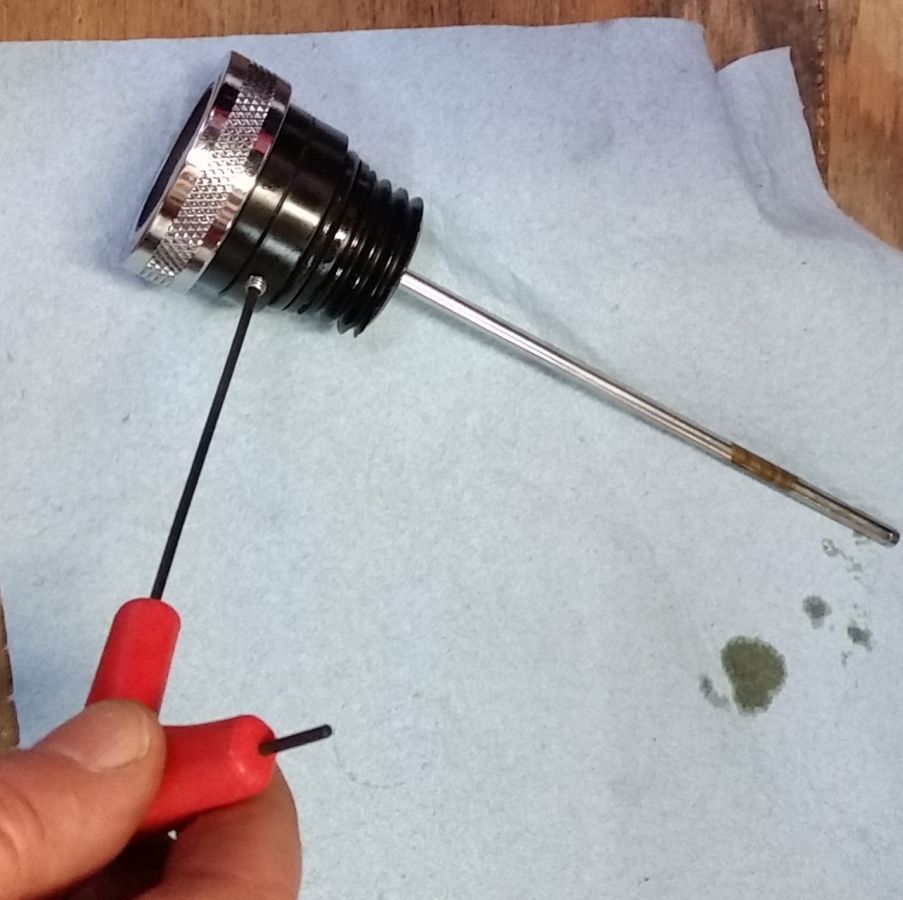

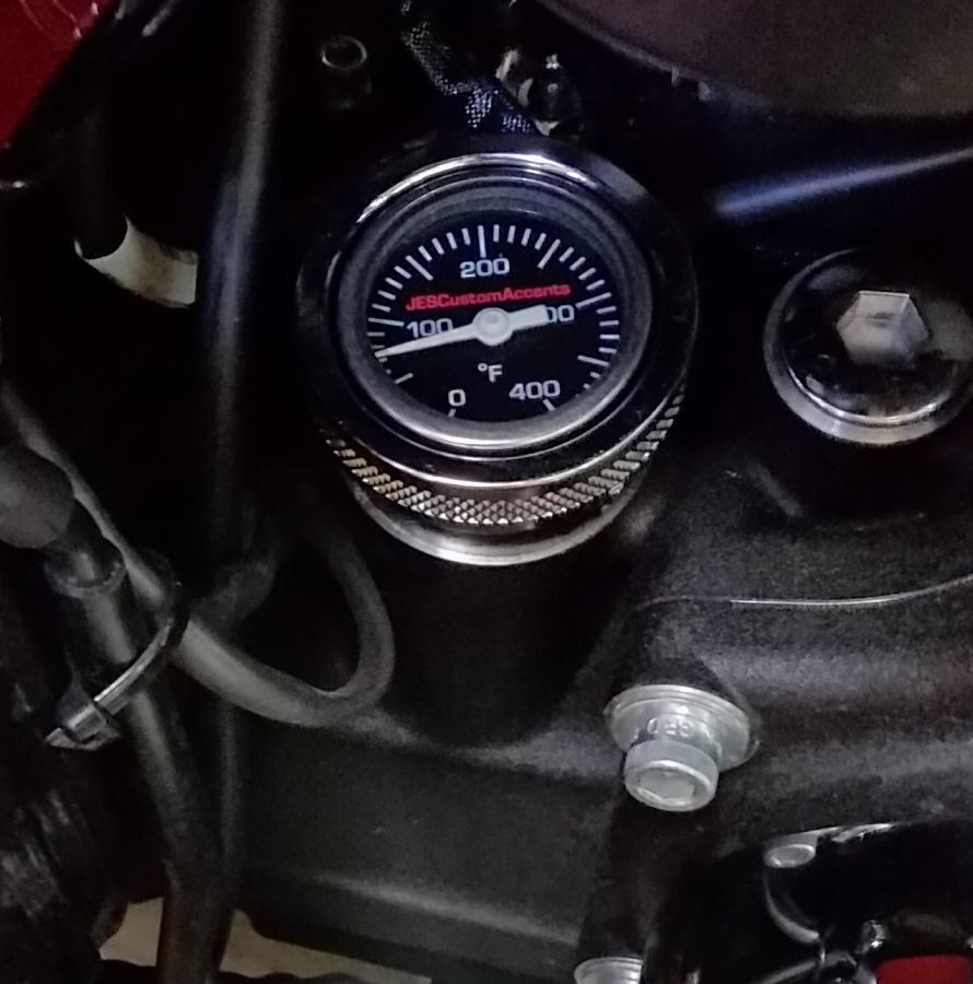

Next up was to install the new analog dipstick/temp gauge.
There are 3 pieces to it & it is a multi-step process to install.
Comes with good instructions, which I followed...
Had it done in 15 minutes.

Hi Trampas,

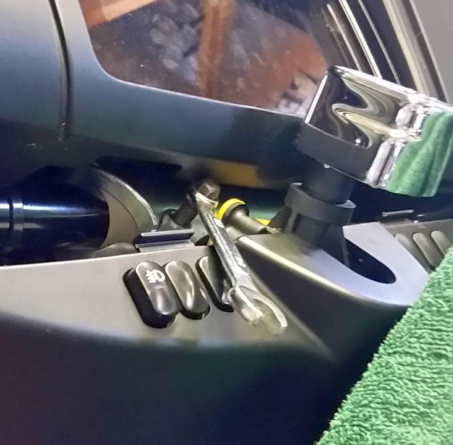

The "right" way is to remove the inner fairing so you have full access to the 4 bolts of the top clamp.
#5 in this LINK
I did not want to do that. So I removed the two screws that hold the dash panel in place...this is where the button for the passing lights is...#14 in this LINK.
This gave me access to the two lower bolts of the handlebar top clamp. I was able to barely get in there and loosen both of those just enough to pull the bars back toward me.

Kevin, what's the part number of your oil temp gauge?
been looking for one.
EDIT: I found-it, Thanks for the pix.
Cool. Guess you noticed they don't use part #'s. :)
Because I read a few reviews of the oil filled ones leaking, I got the air filled one.
I've had quite a few of the HD Brand digital dipsticks. While they seem to last longer now than they used to, I still have not had one last even 3 years.
Hoping this one lasts longer!
While doing my test runs yesterday, I found it easy to read. Happy with it so far!
