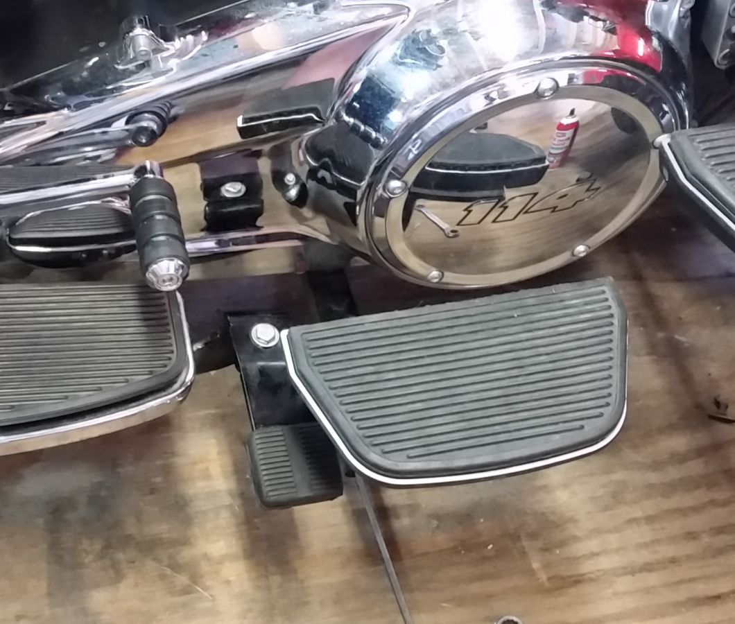

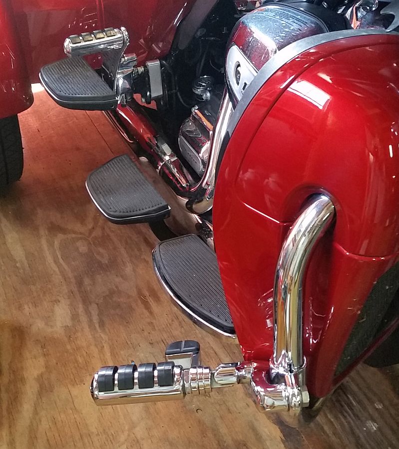

Quite a few other things I've not had on here and missed. The first is the Floorboard Extensions. I used new ones, left my old ones on the '14.

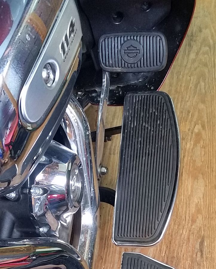

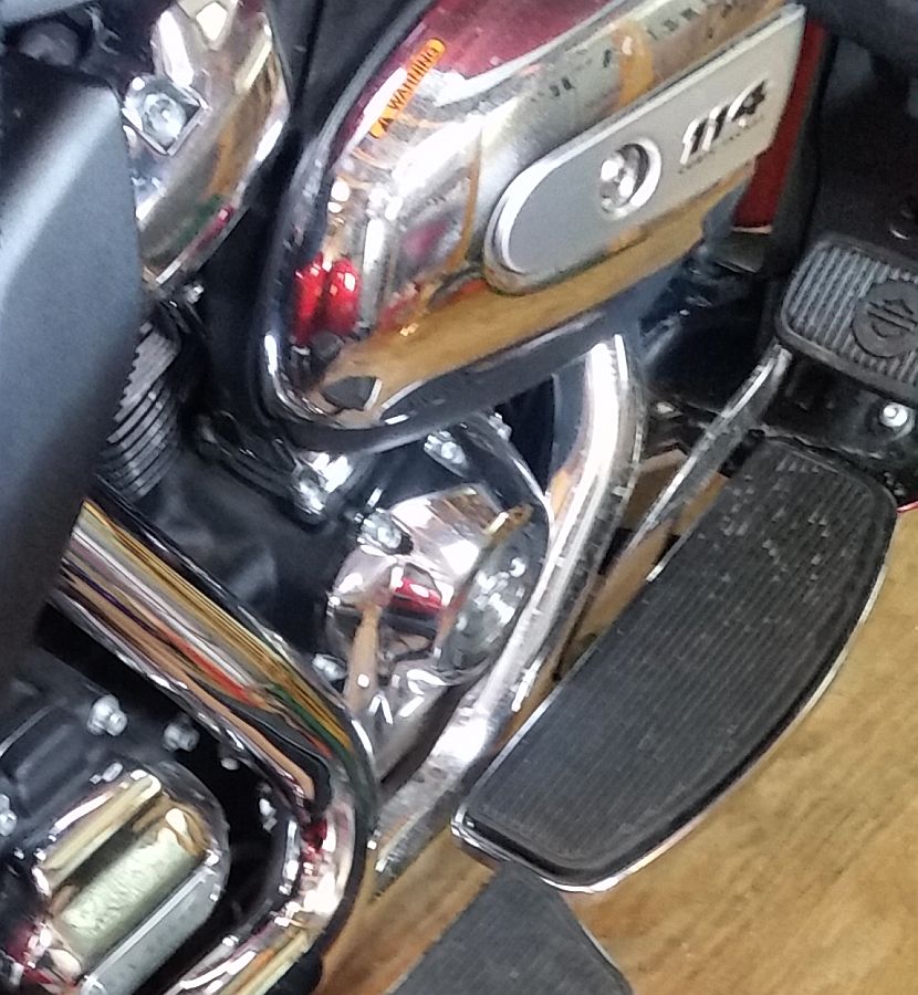

Here is how close the Ride Floorboard is in stock form-
And here it is with it moved out. One would not think it could make so much difference. It is MUCH more comfortable.

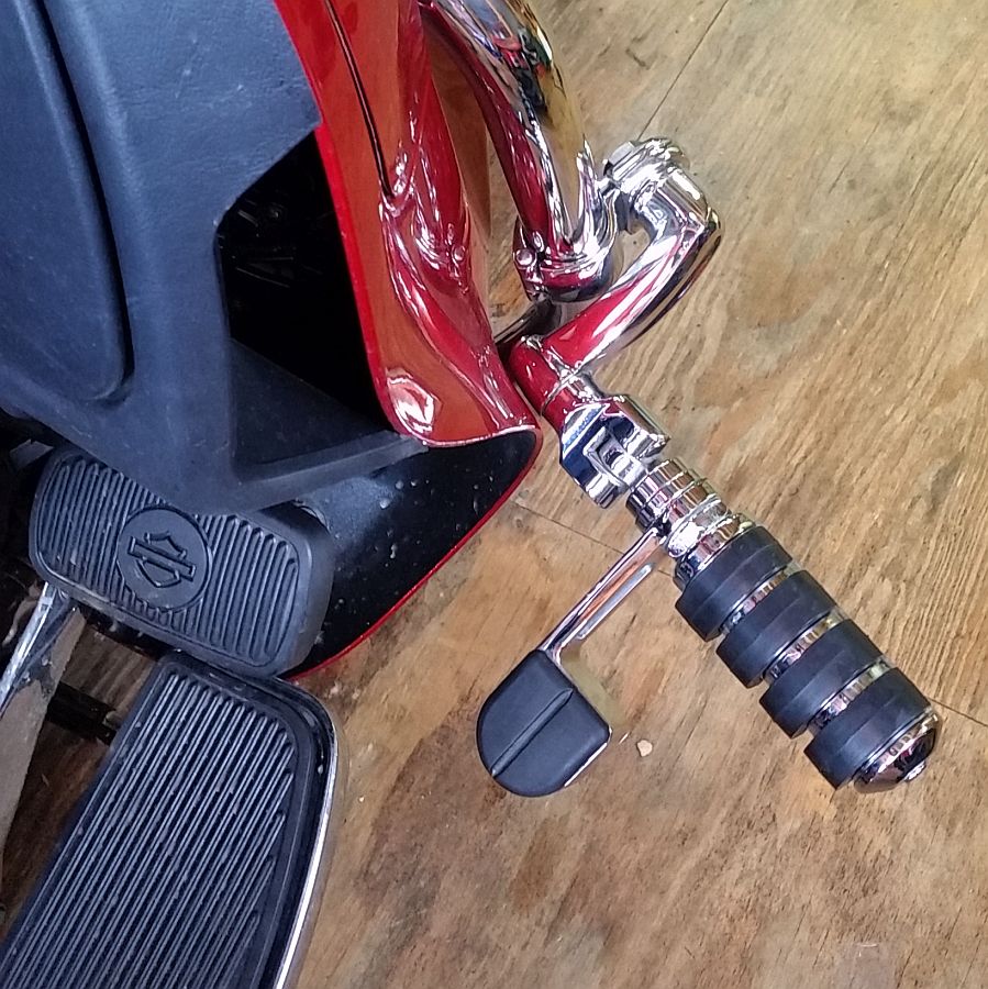

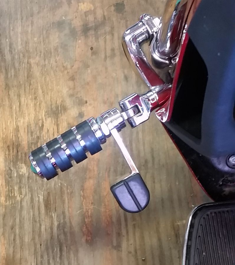

Next up our my Highway Pegs with heel rests.
These came of the '14 and have close to 60K miles on them. I use them a lot & they are holding up very nicely. While I don't always have my feet on the pegs, 90% of the time I at least have the front of my foot on the heel rests.
Next thing was getting the Adjustable Passenger Pegs installed.
This is the 3rd bike they are on. These have well over 100K miles on them, and work just as well as when new. Where Mary rests her boots on the chrome, it is a bit worn, but only in those spots.

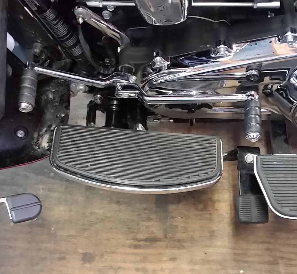

Did a few more things over the weekend to the TG-

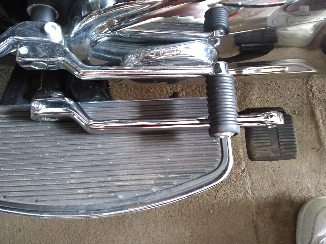

Installed an extended heel shifter. This allows my left foot the full use of the left floorboard. I've only ridden about 50 miles with it like this, but can say that I really should have done this earlier. It looks a little funny, but so do the Mid-Steps. Everything fits well. I was a bit concerned that the longer heel shift would hit the mid-step or make the parking brake harder to use. Nope. All works well.
btw, did I mention how much easier it is now to get on and off the TG with the Mid-Step. Super happy to have that installed. :)

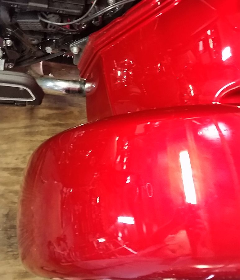

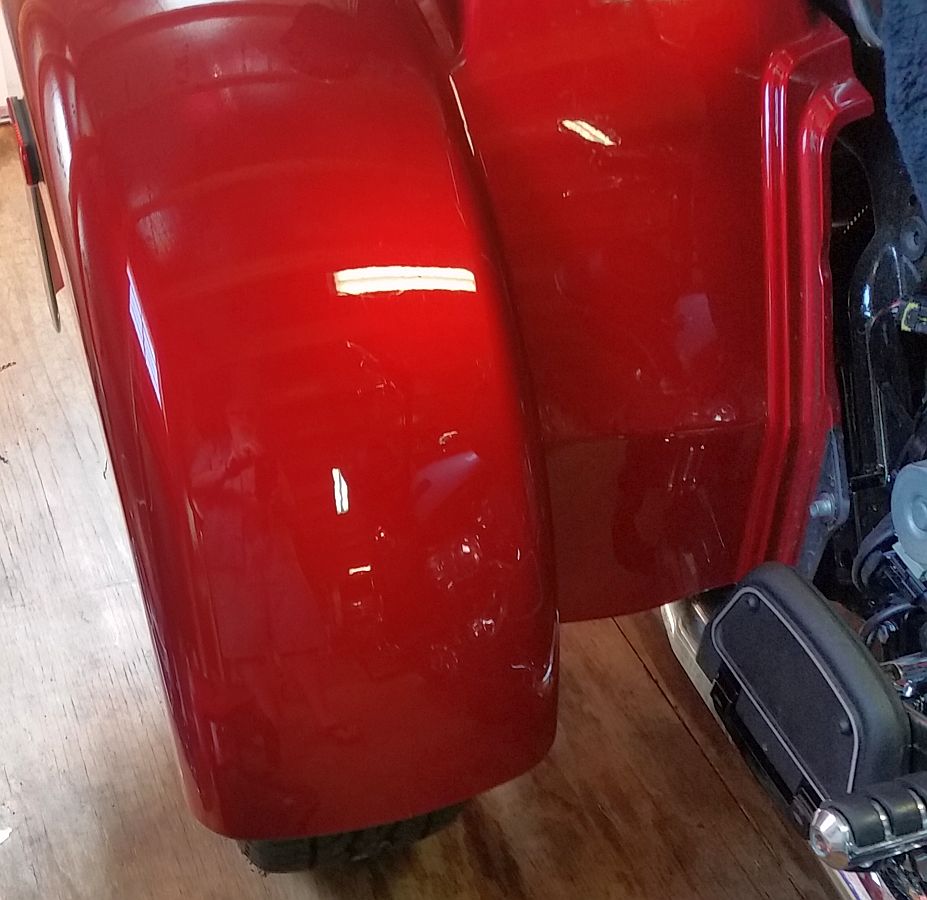

Below are a couple of photos of the fenders and body with the film installed. It turned out nicely, and looks good, even though these photos were taken right when we finished and is still all smudged up from our work on it.
Two things to note-
1. When prepping the fenders for the film, I found 3 small rock chips on the right fender, and 2 on the left fender. This is with less than 1500 miles of riding. All this riding was done of paved roads, except, of course, my gravel driveway.
2. This week I will be putting ceramic coating over the film, this is not to give it extra protection, but to make cleaning the bugs off the filmed areas easier, like the rest of the bike that is ceramic coated.

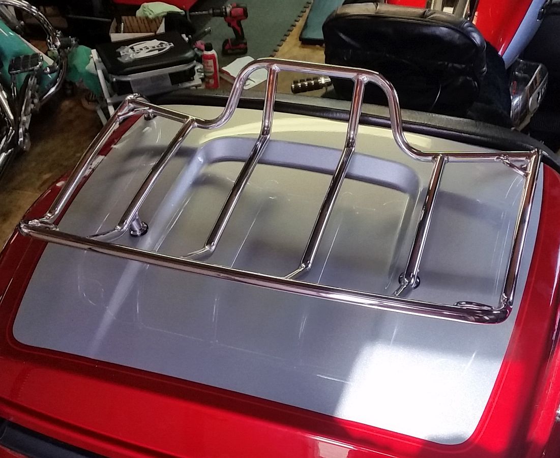

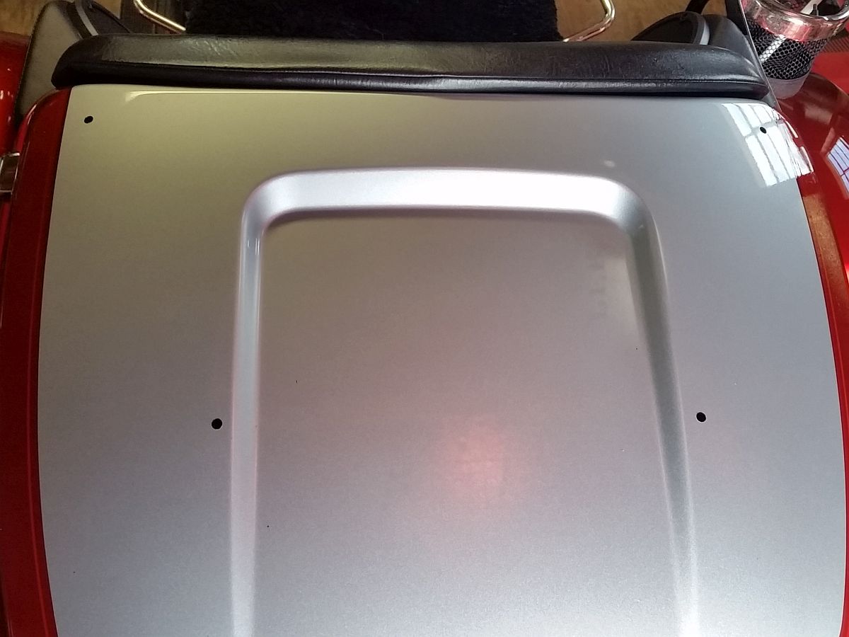

The last thing we did is drill holes in the Tour-Pak lid...
...this is always a measure 3 times first deal. Don't want any extra holes. :)
Then installed the TP Rack.
It is the second time we've used this style rack. Mary likes it because it has loops in each corner that make for easy use of bungee cords that stay in place.

I thought there is little indents underneath the tour pak lid to know where you drill hole for the tour pak rack, at least I seen a video of it being installed can't remember who did it. I know my rack is different that yours and maybe that is it, not sure, a rack is a rack and I went with the one I had on the 16 triglide and was happy with it, more money for sure but I don't plan on adding a light kit to mine which is a option.

There are circles molded on the underneath side of the lid that line up perfectly with the H-D tour pak racks. Easy peasy, no measurement and if you drill carefully inside the circles everything lines up perfectly. But the rack Kevin has is different. The H-D rack legs (front to back) are all in line but on his rack they are staggered. Notice how outboard the front legs are so I know those would not line up. Maybe the back ones would but I don't know.
But I do like his rack. Looks wider than the H-D racks and I like the loops in the corners.

I agree I like his rack also, but I guess I better be happy with the one I got, just wish mine had some loops in the cornors, LOL, wondering where his rack came from, not sure that is a HD brand but you never know, with the indents in the top lid of tour pak I would imagine it would fit both styles that HD sells

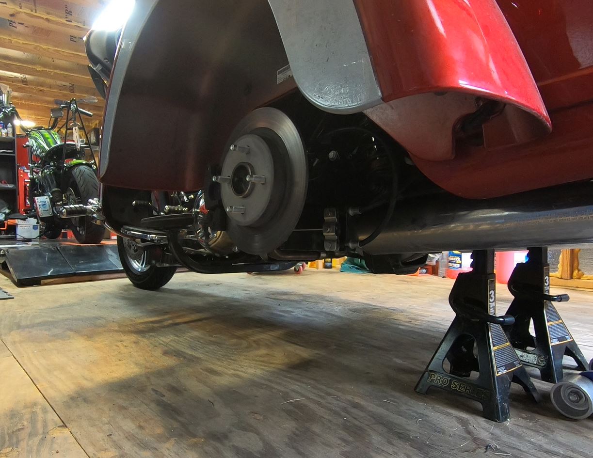

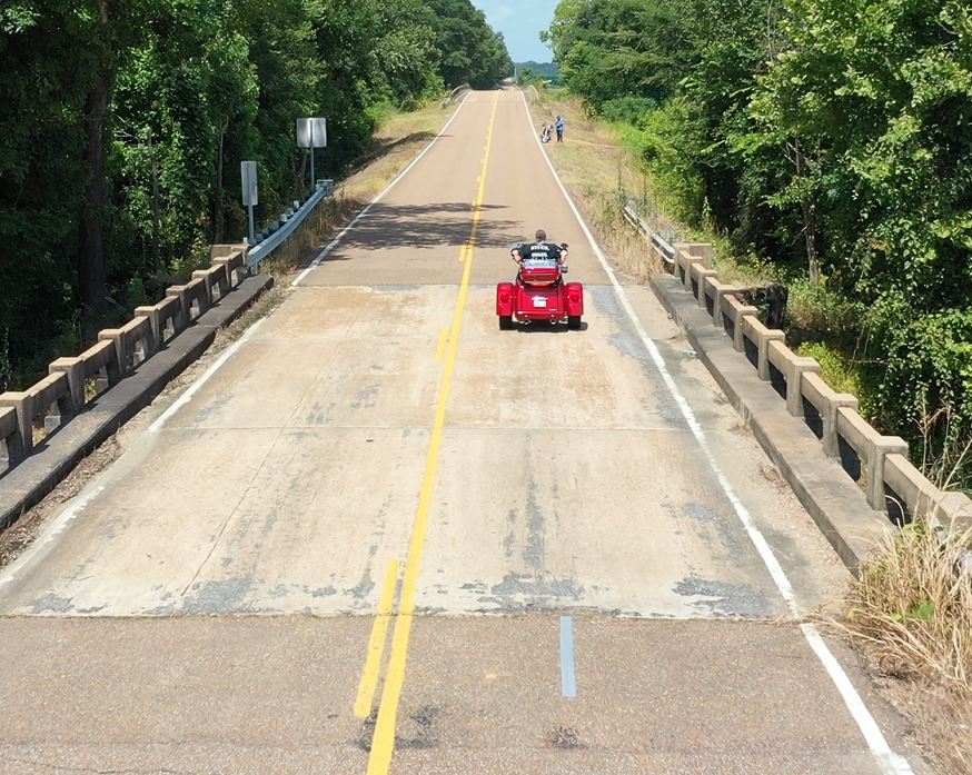

Did bump recording of 2019 with OEM shocks and Convertible Comfort Lift™
Then came back and swapped out the OEM shocks (Discovered an easy way to remove them without removing the body) for the 14" Trike Series Shocks™ and the 14" CCL.
Then went out and did more bump recordings with that set up.

After some testing we were back in the shop swapping parts out for more testing-

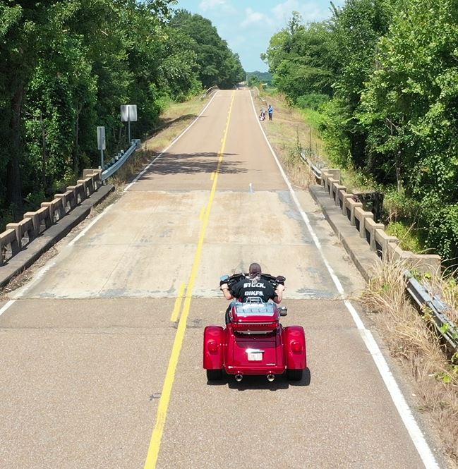

Then back out for some more bump recording.
We have four different bumps, and lining the front tire up, right on the duct tape strip at each one, with cruise on 40 mph. The bump recorder does the rest.
Well, until Dwayne has to put all the video together, along with the BR graphs, in a digestible format. :)
