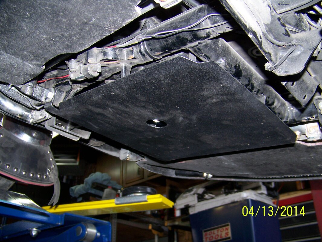

Due to the low ground clearance of the tike, today I built a skid plate for better protection of the oil pan. I managed to rip out the oil pan plug last summer so today decided it was time to do a preventive mod. With the design I came up with I can still access the oil filter and change oil without taking the skid plate off. Attached are a couple pics of the damaged pan and the new skid plate mounted.

Larry nice job! You know I'll want one. I have bottomed out a few times loading on the trailer and every time I pray. It just touches on something.
Well I haven't done that yet but as we all know stuff happens and it only takes once to spoil your day and perhaps several days after. Great job Larry. How many bolts to mount it? Four I would guess.. If and when you are ready to put them out there I sure would be interested. I see you have a mud flap on the rear of the front fender did you through bolt that in order to mount it? Just curious.

thanks for the interest in this skid plate guys. I do intend to get more made up but for now want to do further testing to ensure the design is right and if it needs tweaking more before offering them for sale.
Currently it uses the two footrest bolts up front and one bolt at one of the center stand tabs at the rear. I don't think two is really needed at the back but may add a second after evaluating further. The pan is 16 gauge steel because that is what I had on hand plus the fact that my hand break is only capable of bending up to that thickness. I should know later if that is heavy enough.
Any other suggestions are more than welcome too.
Larry
If your trike has a raked front end it does lower it a little. When you add in a speed bump or too great a breakover angle while loading on a trailer, you risk hitting the oil pan drain bolt, it's the lowest point under the bike.

</div> I took some measurements this morning concerning ground clearances. If you have running boards the rear support bar that clamps to the frame measures at 4 3/4" from the lowest part to the ground. <br />
<br />
Up front both the crash bars and the skid plate measured out at 5".<br />
The Hannigan kit does lower the bike at the rear and when adding in a raked tree it'll be lower than stock bike. When it's all said and done the Hannigan trikes end up with about 5" of clearance. Keep in mind that even 2 wheelers will vary their ground clearances and levelness in height due to air in the shock, lowering kits or leveling links added.<br />
<br />
I want to do further testing before offering them to other. but at this point feel the design is pretty much set. If anyone is wanting one let me know and I'll put you on a list.<br />
Larry

On the skid plate issue.. I was wondering just how much engine heat (if any at all) is designed to be dispersed through the bottom crank case cover? More than likely very little or none at all. I admit I sometimes trend to over think things, but one thing we all know for sure, for every action there is an equal reaction.. Your thoughts?

</div> There's enough of a space in front for plenty of air flow. If anything I think that the skid plate will trap and funnel air when moving between it and the engines bottom.<br />
Larry
