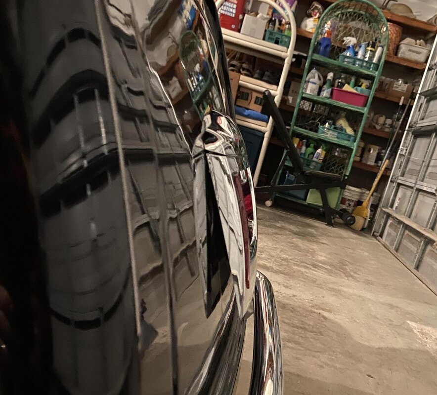

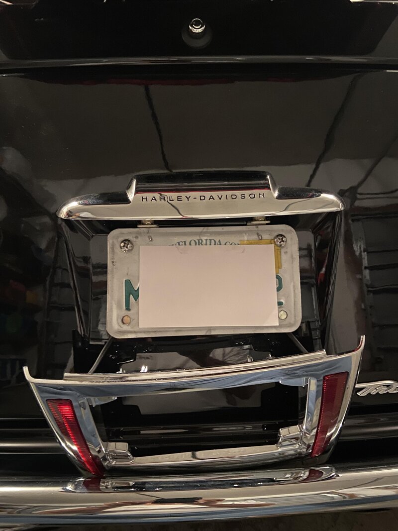

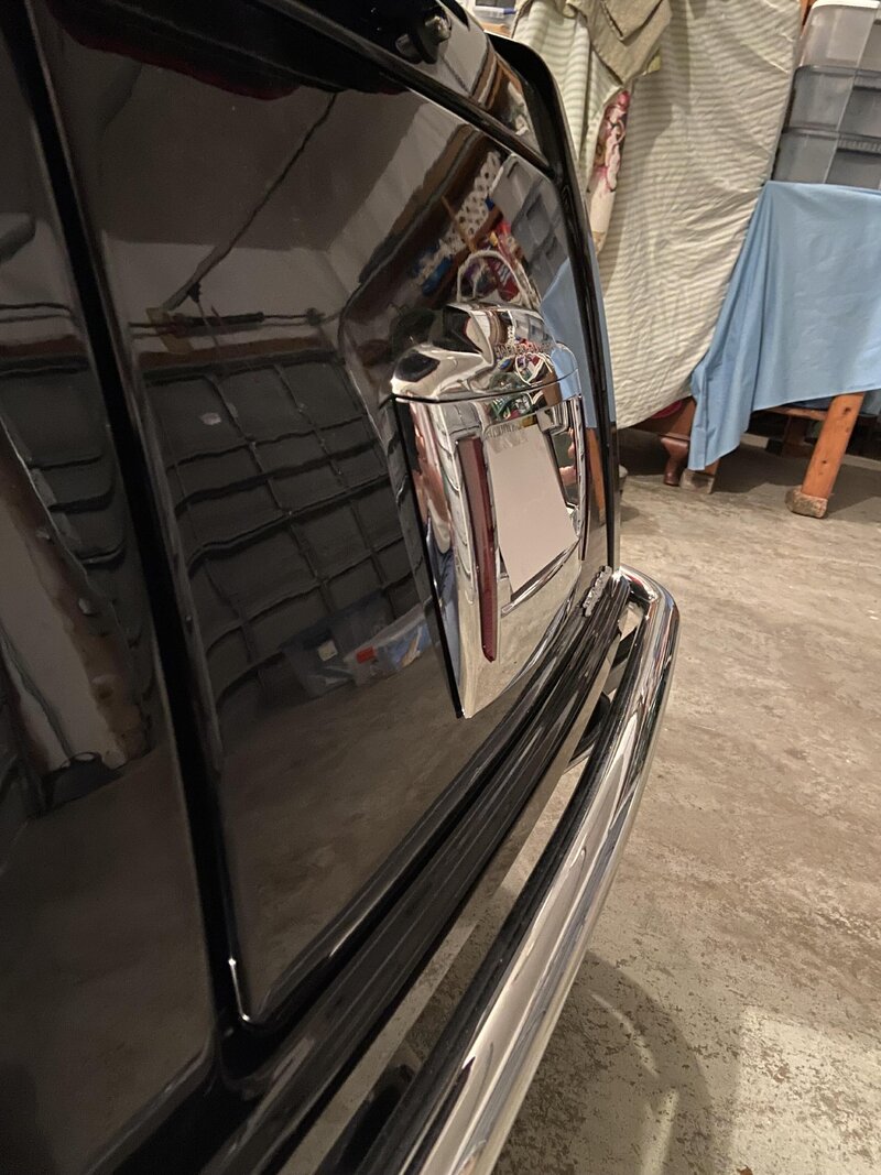

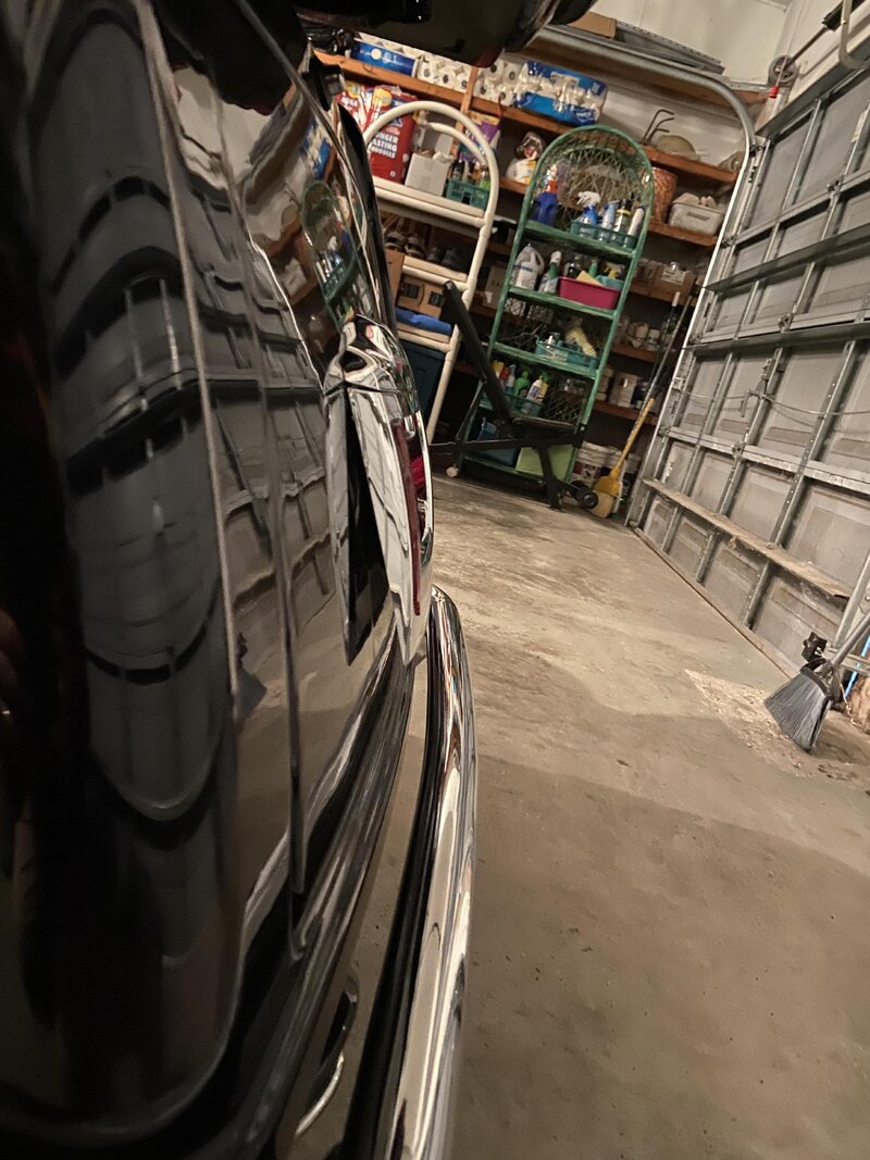

2020 TG - license plate frame won’t sit flush with the hatch. Take the frame apart, take out the plate then the frame sits fine. Put the plate back in and it kicks it out at the bottom - like in the picture. I’m sort of surprised Harley uses such a cheap plastic, ill-fitting, poorly designed part. Before I take a dremel to it, and grind off some of the plastic inside (and maybe ruining it), wanted to see if there are any other solutions. I’ve looked around for an aftermarket replacement to no avail. It’s not that big a deal, but it is a deal. Thanks in advance. Sorry the picture is sideways.

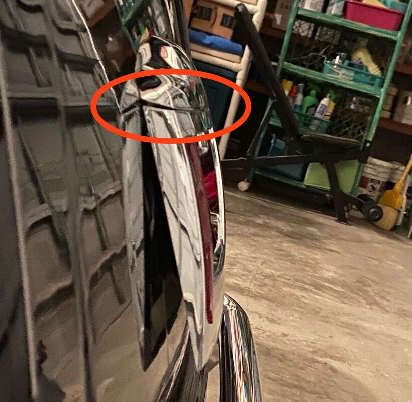

I rotated the pic you posted and then zoomed in to the top.
it is not sitting flush at that upper seam.
you need to take a look why, but that is the cause why it’s sticks out a lot.

Thanks for rotating the picture Brett. The frame does sit flush against the hatch when I take the plate out. Put the plate back in and it’s acting like a shim and kickin the bottom of the frame out - as in the picture. Think I can dremel off some of the plastic on the inside of the frame to lessen the shim. Maybe add some felt stick ons on the back of the plate to protect the hatch paint. Thanks.

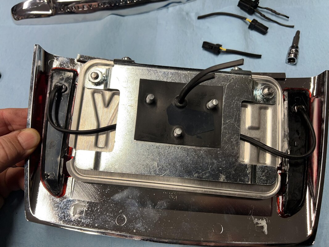

I have my TG in pieces right now (Getting custom painted) and I have this frame off. I’ll see if I can can take a few pics from the back side if the frame assembly, verses how my plate sits.
I’ll reply back again after I take some pics over this weekend & hope it helps.

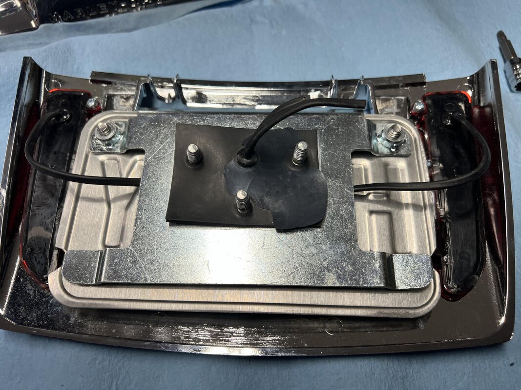

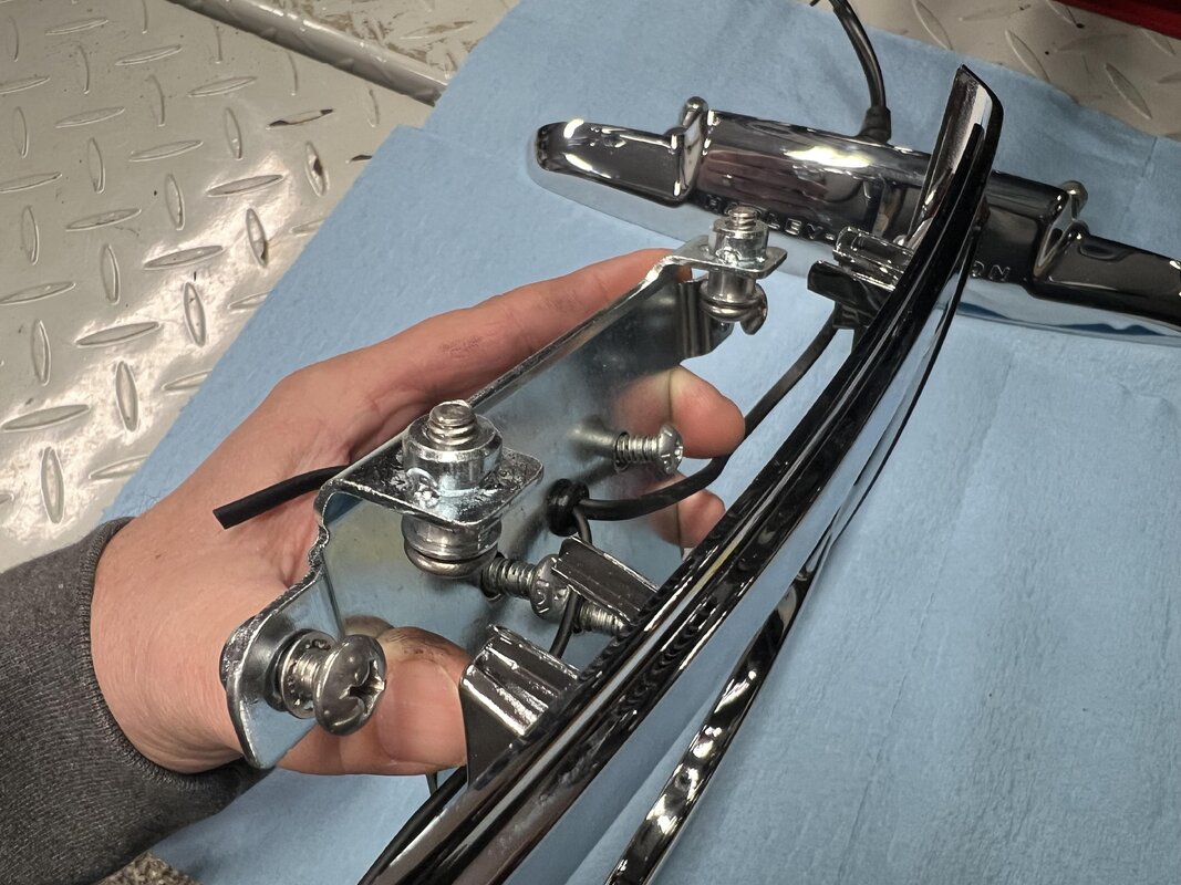

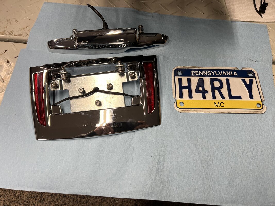

I just got home and will attach pics below…
here’s a link to the CIRO3D part:
https://ciro3d.com/products/lighted-license-plate-frame-holder-for-tri-glide®
link to the instructions:
https://cdn.shopify.com/s/files/1/0...TED_LICENSE_PLATE_FRAME_FOR_TRI-GLIDE.pdf?943

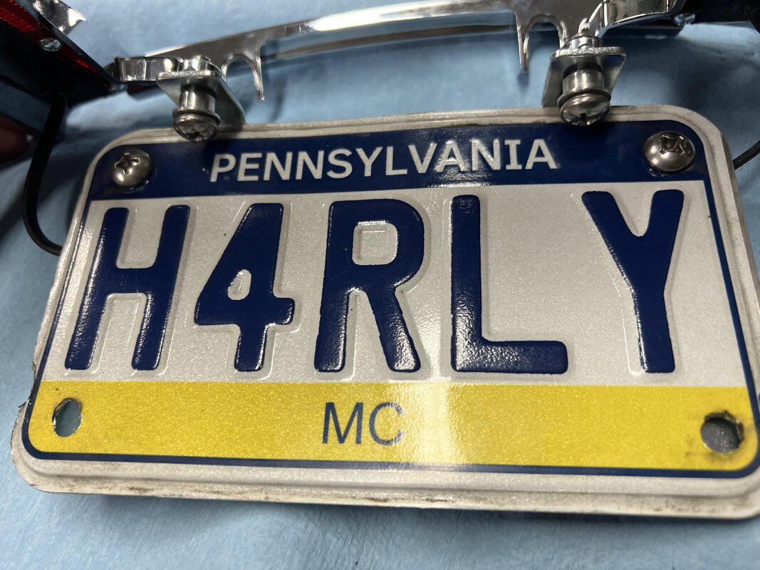

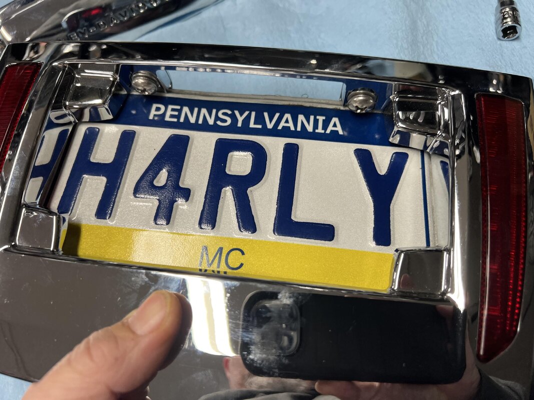

I think it may be either the license plate bracket 3 screws, and/or the wiring routing behind the plate that might be the cause.
Pics below hopefully helps.
although I’m mechanically inclined, I had a hell of a time trying to “de-pin” the pins from the connectors, so I just cut the wires. (I solder daily, so I’m just fine to resolder/heat shrink back when I reassemble).
also, my last bike had a custom rear fender and License plate frame where I had to modify my license plate. Luckily all of the notches are covered up on my TG.
ANYWHO…. hopefully the links & my pics help!
again, it’s a nice license plate frame (with lights) and I honestly have not seen any other choices that look as nice as this CIRO3D, plus their LEDS have a lifetime warranty.
- Brett

With Brett's help got it figured out.
The dealer hadn't used the bolts to secure the plate to the frame.
Thanks Brett, for spending the time with this. It would have taken me awhile to figure it out without the pictures you took. I think I owe you a beer.
