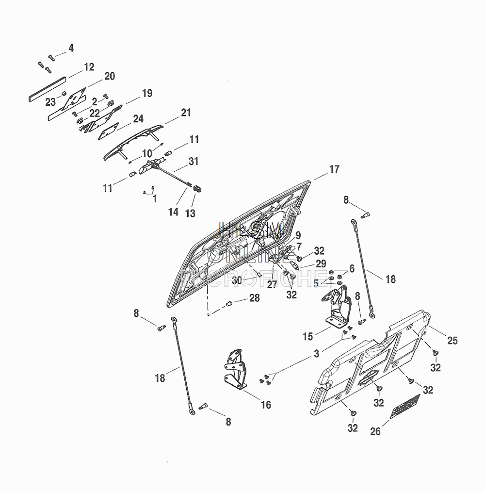

It was pointed out to me recently that my license plate light isn't working. Who knows for how long. Keeping in mind, the rear end on my '10 TG is from a 2012 model (warranty). Anybody know if it is just those little external hex screws that cover it? Haven't figured out yet what size tip to use. I am assuming it is LED. There is power getting to truck lid. Or does that whole light assembly get replaced?

Andy. Not sure if this helps, but I have 2011 trike suppliment service book. Looked up the listing for the license plate bulb. The Harley part # is 524411-95 Requires (2) Not sure if it's the same as 2012 models. Good luck. Jerry
Its been awhile since I worked on the bulb, but I seem to remember that I removed the whole bracket then took it apart from the back side to get at the bulb. The one I worked on the wire was pulled off the mounting point. But its been 3 years since I did that repair and I'm not positive of the steps. It just wasn't very hard.
2 screws hold # 11 2 bulbs in on a stock bike
So I ordered the bulbs yesterday and find out they are incandescent , not LED. Probably burned out for years and HD never checked at any service). At least I never got pulled over for it.
