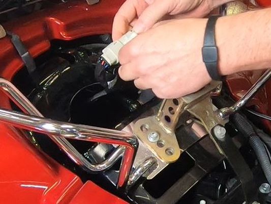

I ran a 20 amp fused wire all the back to the Tour-Pak and installed a power point for charging while riding.
In the past I've run the wires thru the factory grommet that the factory wires feed into the Tour-Pak thru. On the '19 the grommet was much tighter than previous years, so rather than fight it I ran the wires through the speaker cut-out (which I had off to install the passenger drink cup holder anyway).
The wires are between the Tour-Pak and the liner right up to the mounting point of the Power Point.
There are small holes drilled in the liner for the wires and the fasteners that hold the Power Point to the liner.

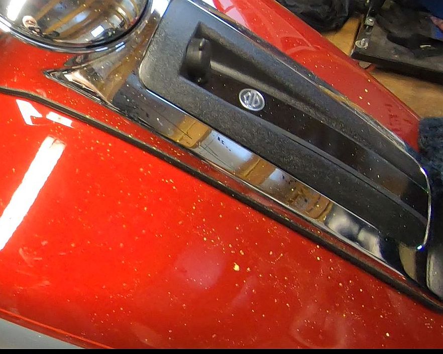

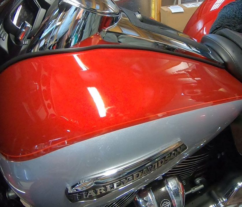

This weekend I tried out a new waterless wash and detail spray that was recommended to me by a professional detailer. Worked very nicely.
Before-
The nice things about this is that I did not have to "wash" the bike with a hose and bucket. Went super quick, left a nice shine, and really important, it was very slick when done. This means less dirt and bugs to stick to it. Of course, it also encapsulates the grit so as not to scratch the finish.
After-
I'm really liking the things I'm learning to keep the paint looking good with a minimum amount of time spent on it. I did the entire trike in about 20 minutes, and it looked better than if I had spent 1 hour on it the old way. Oh, and I used it on the aluminum wheels...YEAH, the ceramic I put on the wheels have sealed them and the brake dust and road grime did not stain the wheels. Literally 30 seconds to wipe them clean and shiny as new with this spray.

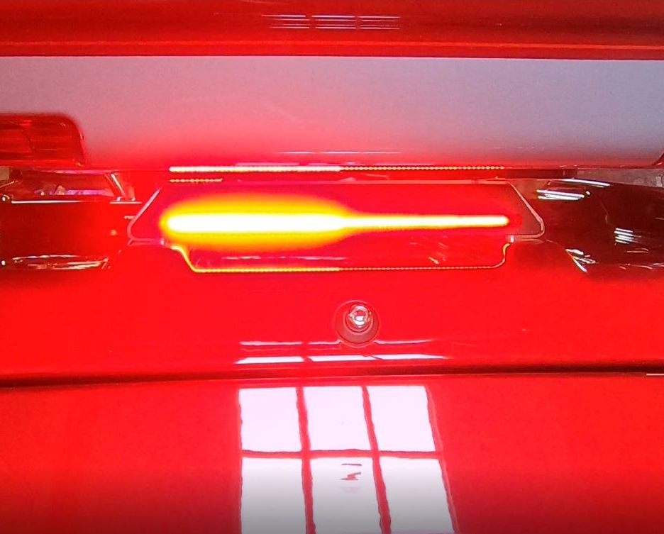

I did the wiring on the LED Tour-Pak Filler.
The light this puppy puts out is comforting...it really gets the attention of those behind me, day or night.
Left blinker on in this pic-

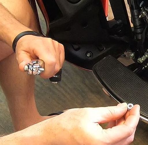

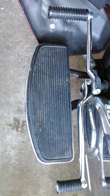

I installed my Extended ISO Shift Pegs of the '14. For me these are much more comfortable.
While doing that I also wanted to raise the front shift lever just a bit to give me more room for my boot to get under it to upshift.
While doing that I discovered the HD has made a change to the shift levers that some of us have been waiting decades for. lol
Instead of threading the shift lever, where it pinches onto the shaft, they are using a self-locking nut that fits in a keeper channel on the bottom of the shift lever. WOW, this little improvement makes things MUCH better. Kudo's to HD for this, a very welcome change!
