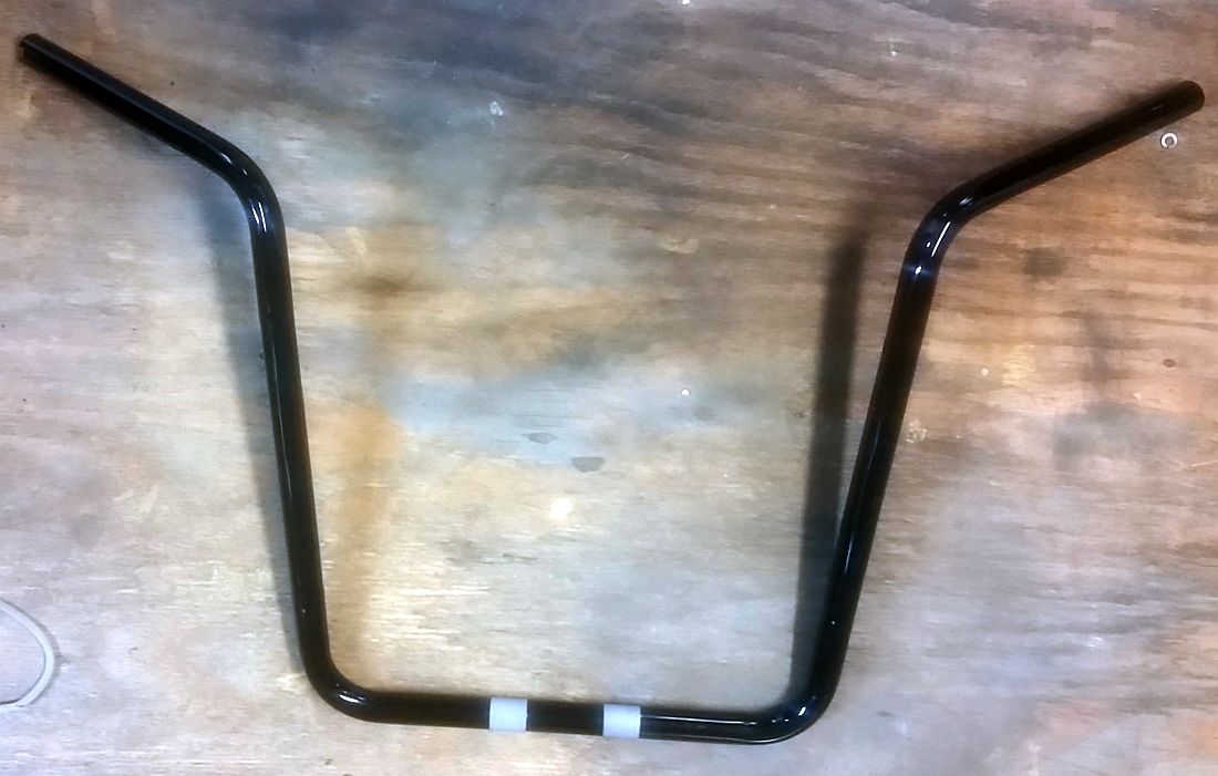

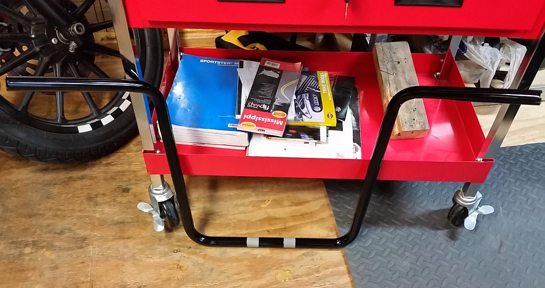

Got the handlebars back from powder Friday.
Unwrapped them up yesterday...
...They turned out well!
Will be getting them installed sometime in the next week or so.
btw, a couple of folks have asked. These are stock Tri Glide bars that have had a 9" section added to each side, making them taller. The grips were also rotated 15 degrees further forward for better wrist comfort for me.

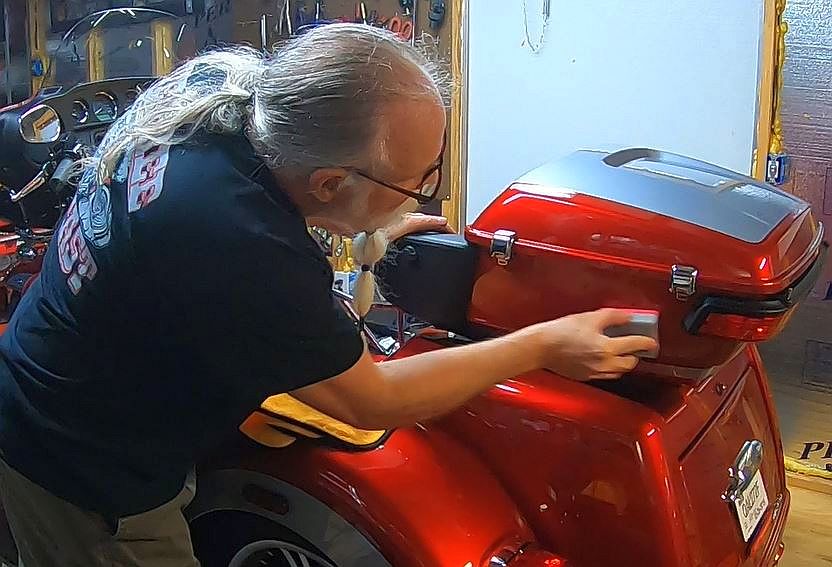

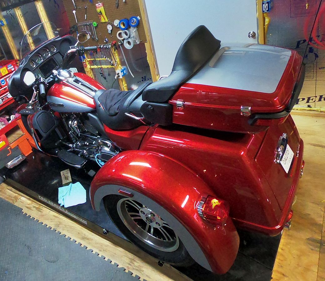

Yesterday I got a big chunk of the ceramic coating done.
Pic of the TG on the lift prior to starting-
First I cleaned all the dust and dirt off the paint.
Then I used the prep polish to get everything off the surface, oil, silicones, etc. Leaving only the clear coat, giving a good clean surface for the coating to adhere to.
Then I began applying the ceramic coating-
I got everything done except for the two side covers, the front fender and the three wheels.
This is how it sits now-
Today I am planning on finishing it up.

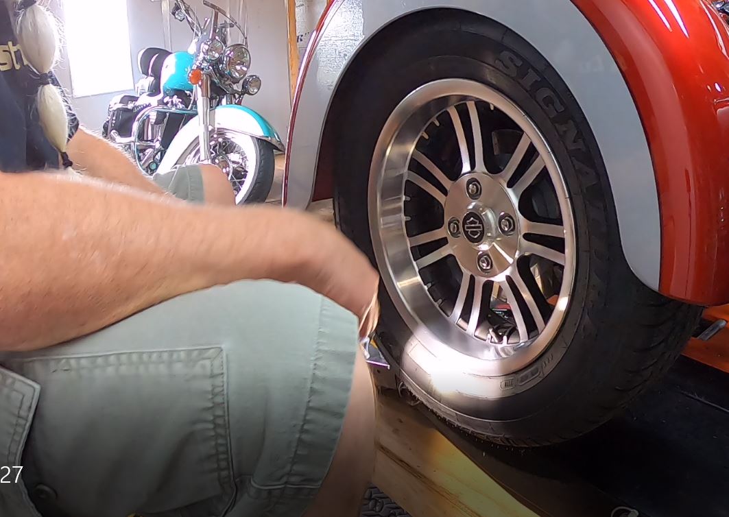

First I did the rear wheels.
I have to say I was a bit disappointed. The wheels have very fine grooves in them. After using the prep polish to prepare the metal for the coating, I could not get all the prep polish out. I spent a significant amount of time trying, even used some alcohol to help get them clean. In the end, it might have been better to use a polishing wheel, but I was not prepared to spend that kind of time. After getting them as clean as I was willing to, I went ahead and coated them.
If the coating works on the wheels as good as the paint, I am going to be happy. It is so irritating to have brake dust, road grime, etc. stain the wheels. If the coating will keep that from happening it will be worth it.

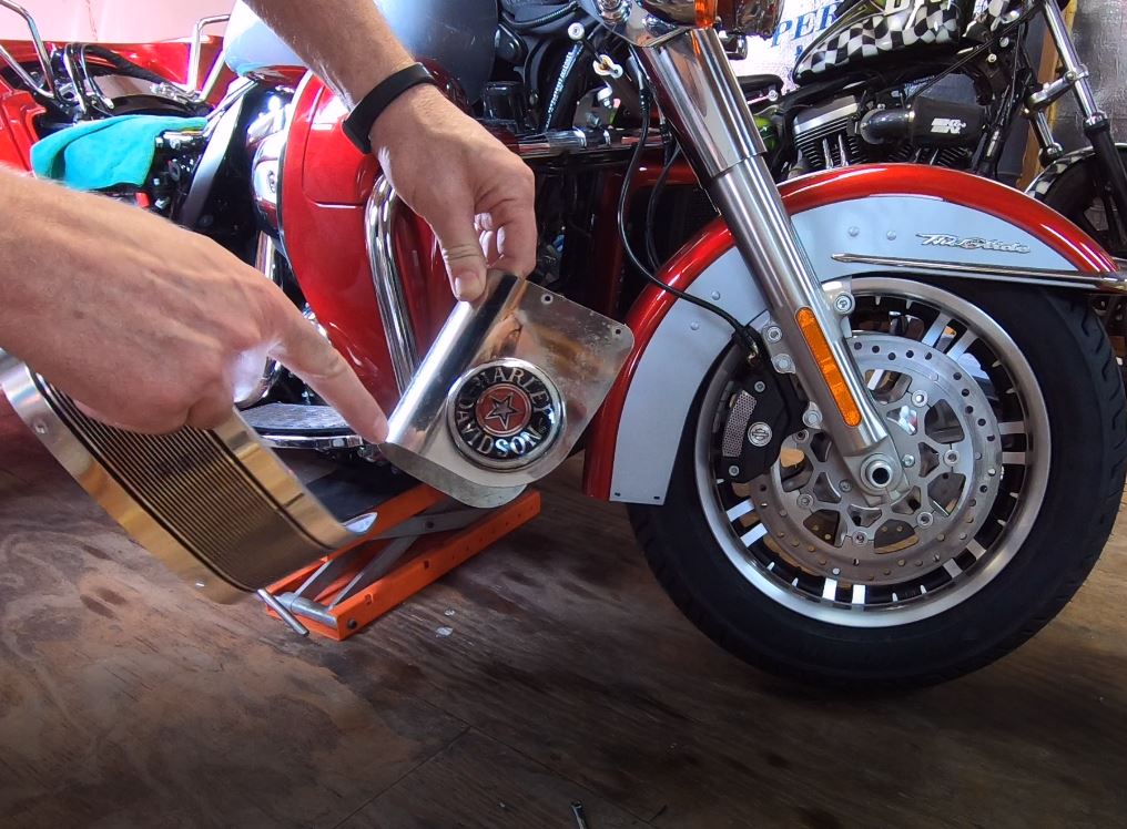

After that I removed the OEM fender skirt. I will be cleaning up the custom fender skirt that I pulled off the '14 and be re-installing it in place of the OEM. (Thank you Richard)
Here's a photo of the OEM in my right hand and the custom one in my left-

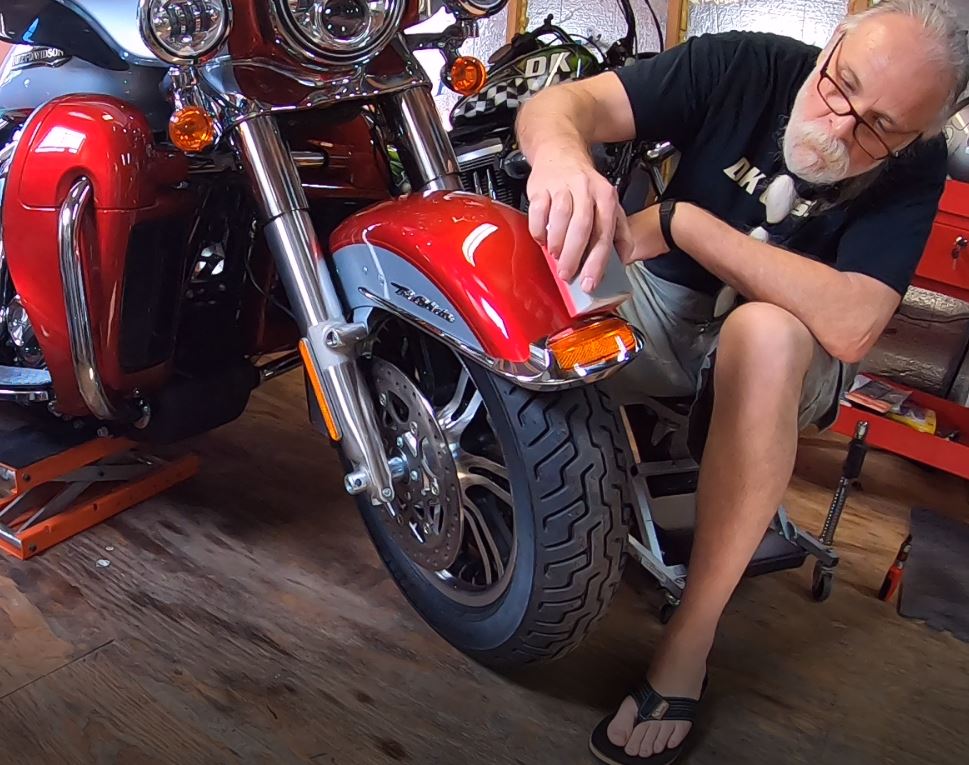

Next I cleaned, prepped and coated the front fender and the side panels.
Gonna give it a few days to cure, then put it back together.

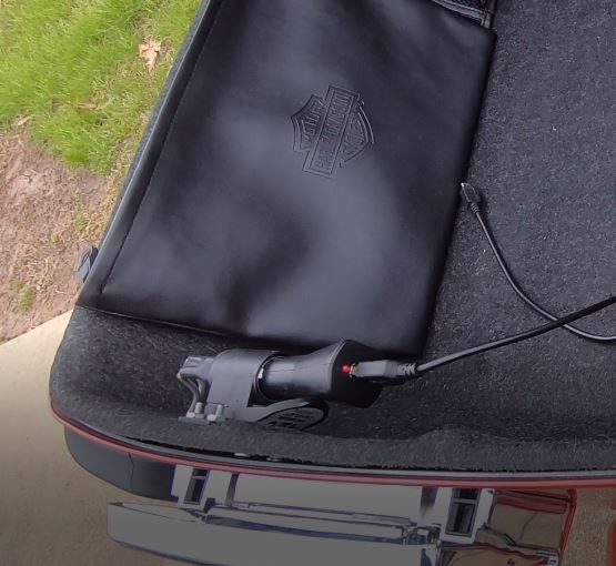

-Ran the power wire for the Power Point in the Tour-Pak

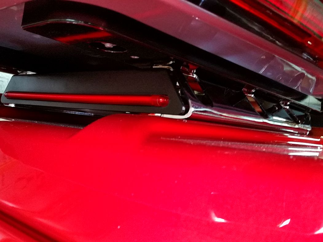

-Installed the Tour-Pak Filler with Run-Brake-Turn LED Lights

-Installed TP Power Point

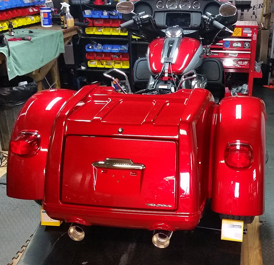

Got it outside (it was cloudy) for the first time since doing the ceramic coating.
Got some photo's of the above I'll be posting up, then some videos once we get them edited.

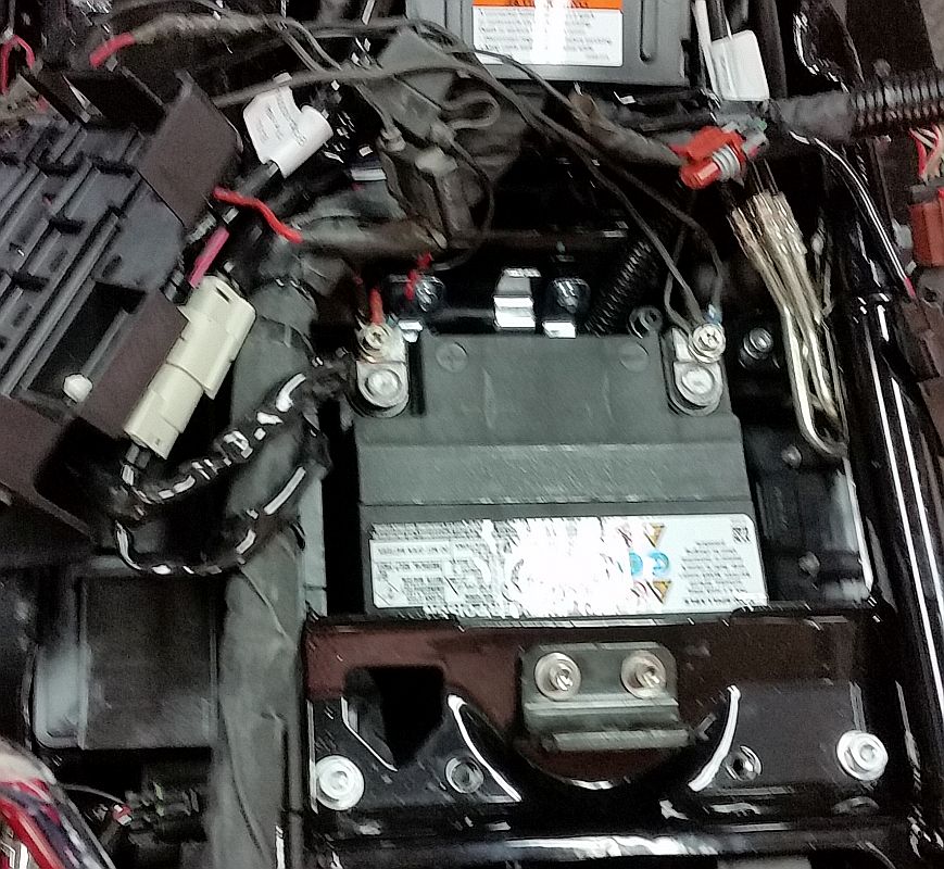

Some photo's of progress made.

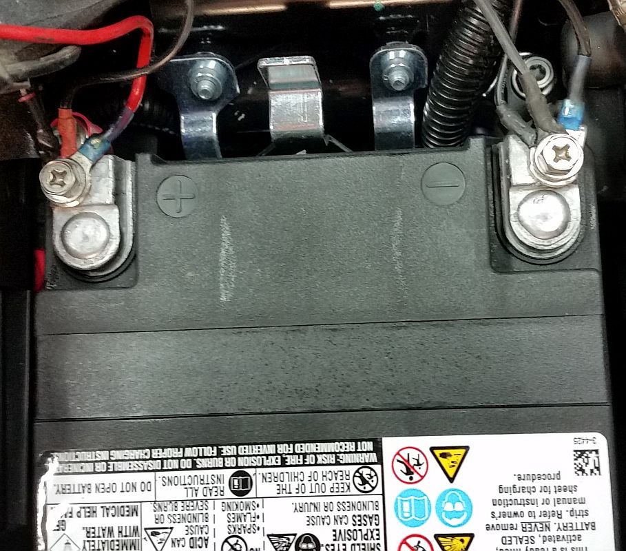

Hooked up 3 hots and 3 grounds...
2 for the Gerbing heated gear and one for the Tour-Pak power point.
Had to move a bunch of the factory stuff out of the way to get to the battery.
Each year HD gets the wiring and routing a tad bit cleaner/more organized. This '19 is the nicest yet.
I always use dielectric grease. Knock on wood, we do a lot of traveling and I have very few problems with my bikes/trikes...I like to think it is paying attention to the little things that make for years of trouble-free riding.

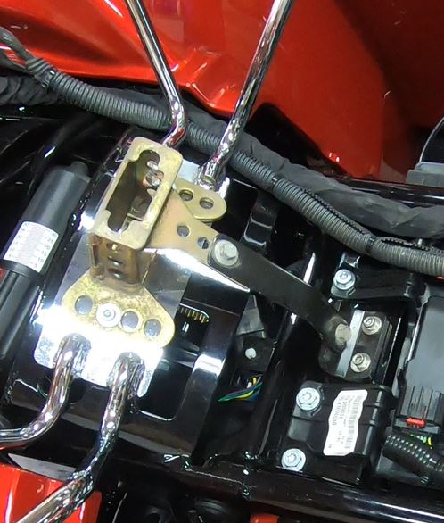

Got it back together, along with all my wires routed in the flex loom.
Got the back rest bracket installed. Same one has been in 3 or 4 bikes now. HD says it does not fit the Trikes...it does. Took this one out of the '14 Tri Glide.

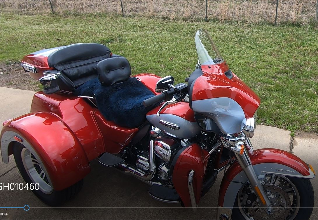

Here's a still grabbed from a video. You can see I have the windshield back on, my back rest, Mary's custom low-profile back rest and her drink cup holder.
Oh, HD is finally using an extended thumb screw at the rear of the seat. Very nice!
Also, I'm really enjoying how fast the infotainment/navigation boots up.

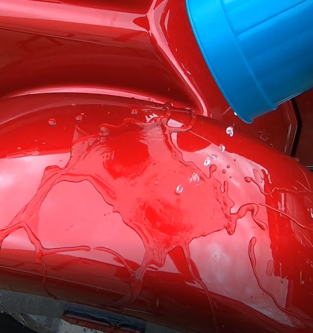

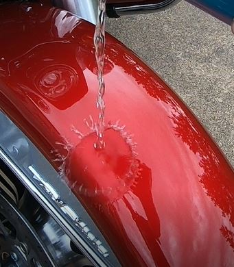

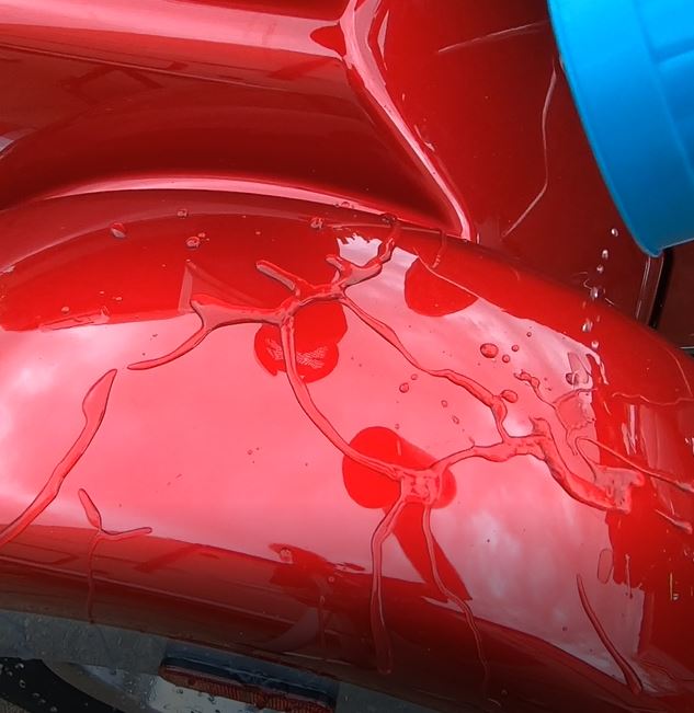

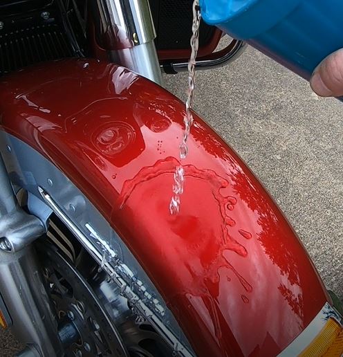

It rained all morning, then this afternoon it was cloudy, with the sun peeking out now and then.
All photo's below are untouched...straight out of the camera, only cropped them.
Grabbed a few stills out of a video while pouring water on it-
Amazing how water reacts to the ceramic coating.
It just flows right off, the little bit that remains is all beaded up.
This photo shows why this Wicked Red paint seems to look red sometimes and orangish other times. In this photo you have red, pink and almost a yellow...light is hitting different areas of the paint differently.
I am very happy with how this ceramic coating has worked out. Not nearly as much dust/dirt settles on it, and bugs rarely stick, and when they do, they come off very easily.
Oh, and someone asked how spilled gas affects the coating. About a week ago I spilled some on the Softail, actually quite a bit from a malfunctioning pump. Within a couple of minutes I had rinsed the area with water. I cannot tell, visually or by touch, any difference where the gas sat/rolled down the paint. What. if any, effect it will have long term, I don't know.

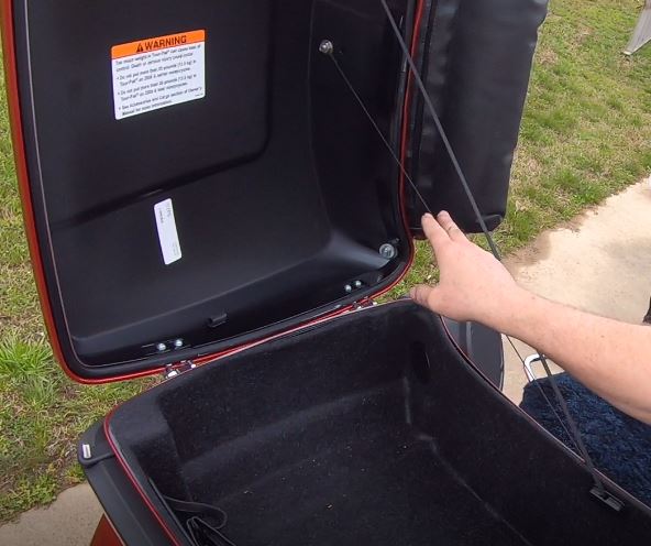

TP Lid Safety Tether installed. It is some lightweight paracord with a washer on the top end and a ring on the bottom end. The washer goes on the center back rest stud and the ring goes on one of the screws holding the factory tether to the TP bottom.
We've never had a factory tether fail, but have seen more than a few broken TP's after a factory tether failed...so it is inexpensive insurance to have a safety tether.
I ran a 20 amp fused wire all the back to the Tour-Pak and installed a power point for charging while riding.
In the past I've run the wires thru the factory grommet that the factory wires feed into the Tour-Pak thru. On the '19 the grommet was much tighter than previous years, so rather than fight it I ran the wires through the speaker cut-out (which I had off to install the passenger drink cup holder anyway).
The wires are between the Tour-Pak and the liner right up to the mounting point of the Power Point.
There are small holes drilled in the liner for the wires and the fasteners that hold the Power Point to the liner.
We ran this same Power Point in the '14 for years and tens of thousands of miles...the position works perfectly for being out of the way, but having easy access to using it when the TP is full.
Here's a pic of an almost full TP with the power point in use-
