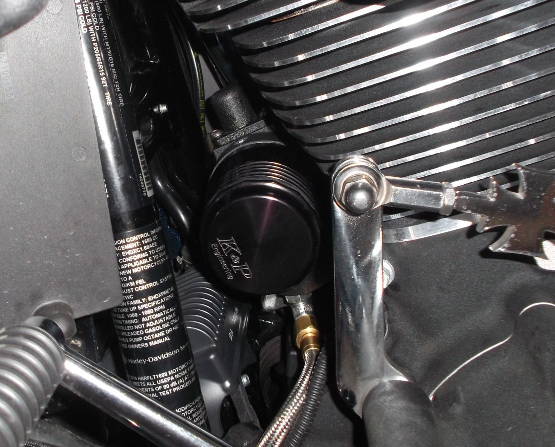

25. High Performance Cleanable Oil Filter

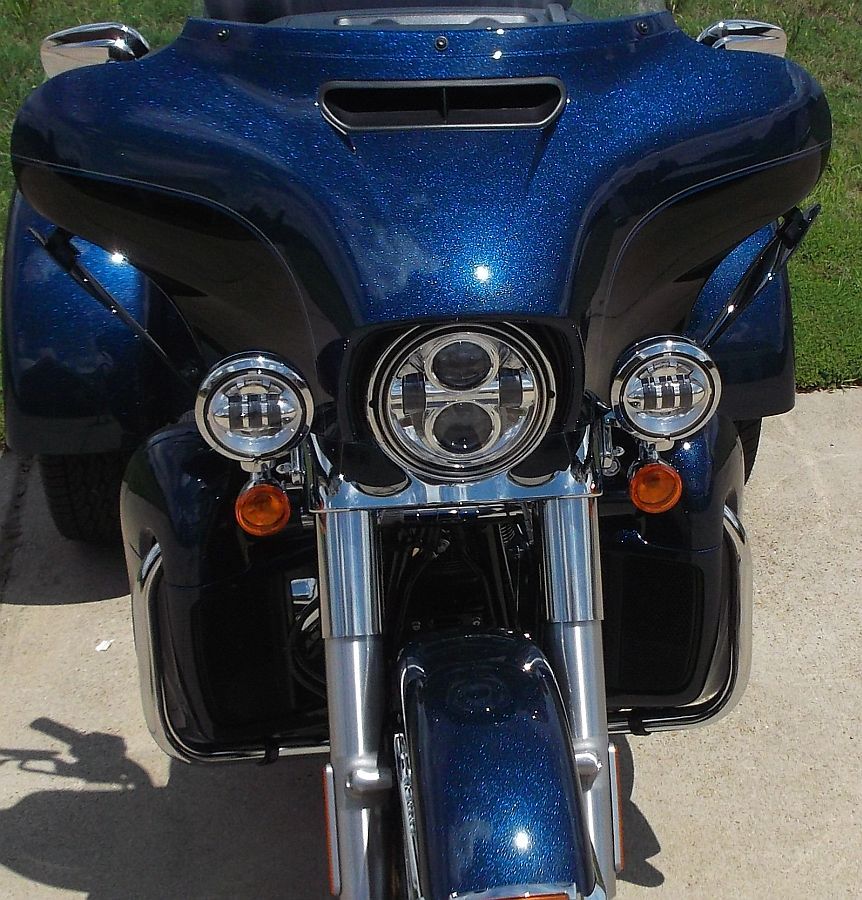

Paint- When it is cloudy it looks like a navy blue color, when the sun hits it, it really pops with all the flake!

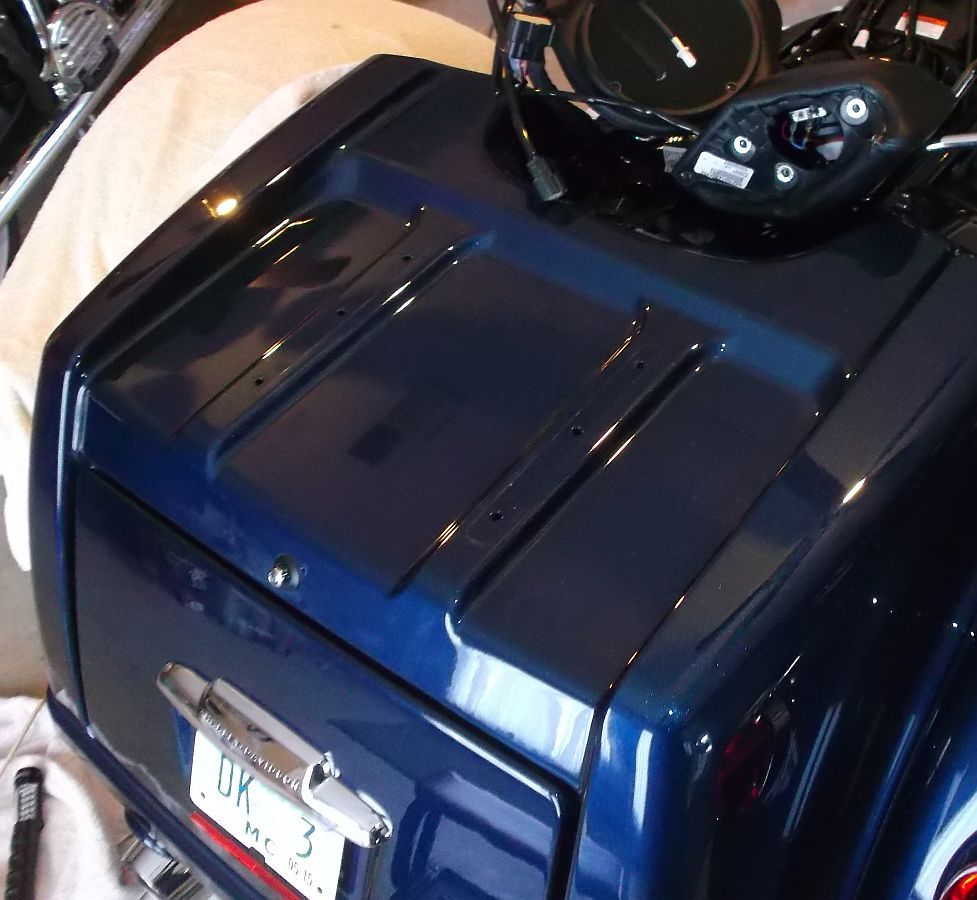

Rolled it out in the sun to get some pics of the paint. I guess I should have asked Mary to take the pics, lol, you can see the flake, but it really looks a lot better in person than any of the pics I took.

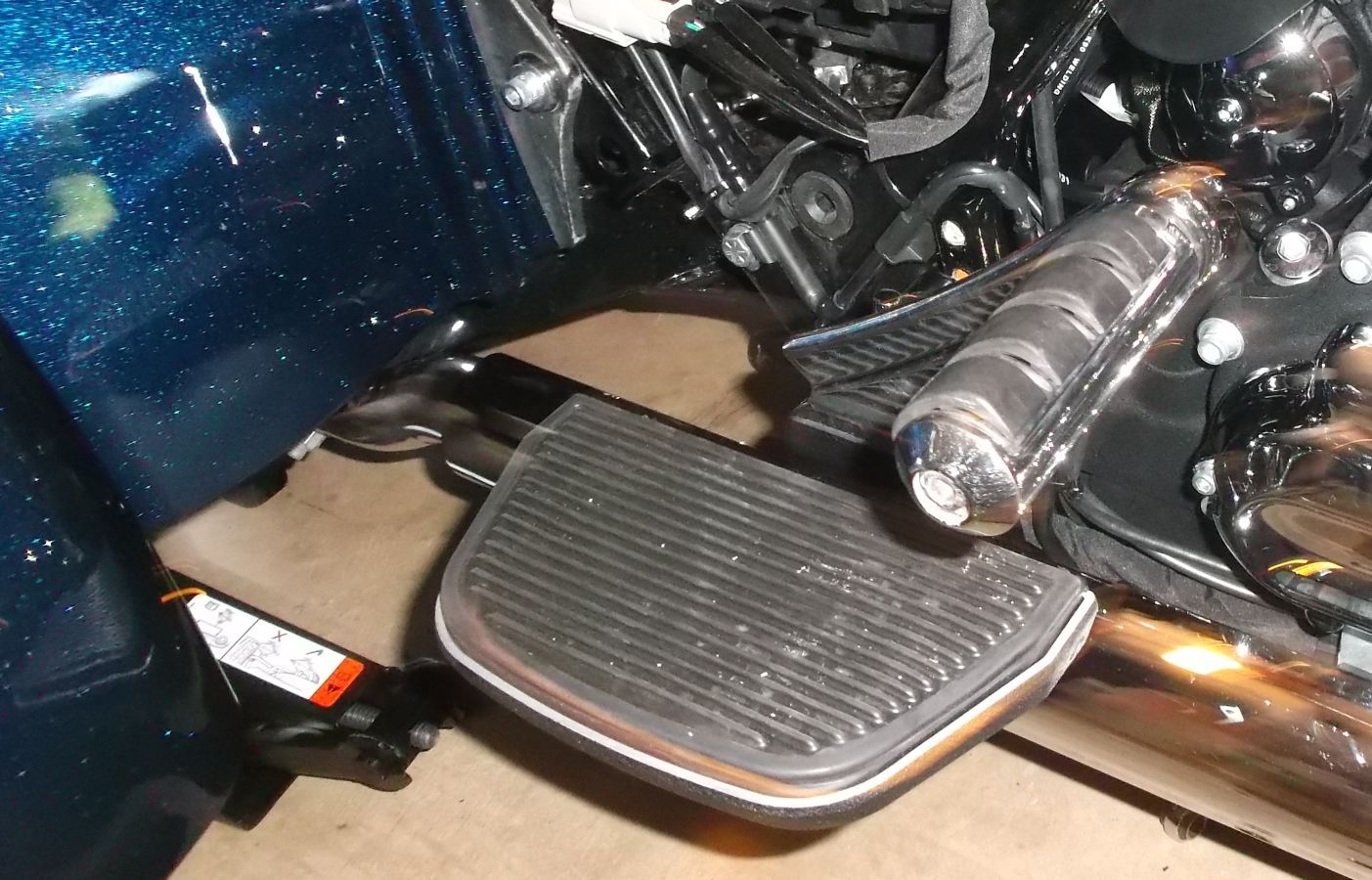

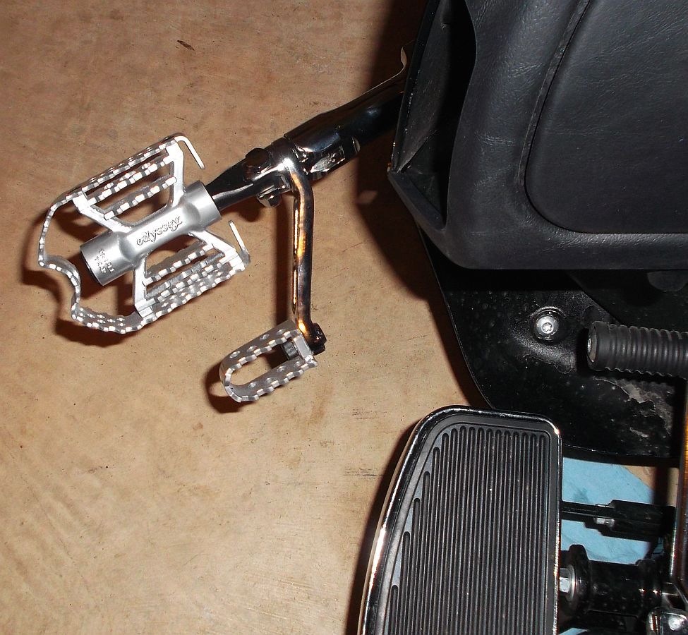

Here is how the passenger footboard came, at the highest adjustment-
I put it on the lowest adjustment (1.5" lower)...now the two higher adjustment holes are showing...one with rust in it already. Will be picking up some plugs to go in those holes.
Next I installed Marys' Kury adjustable passenger pegs. She uses these a LOT.

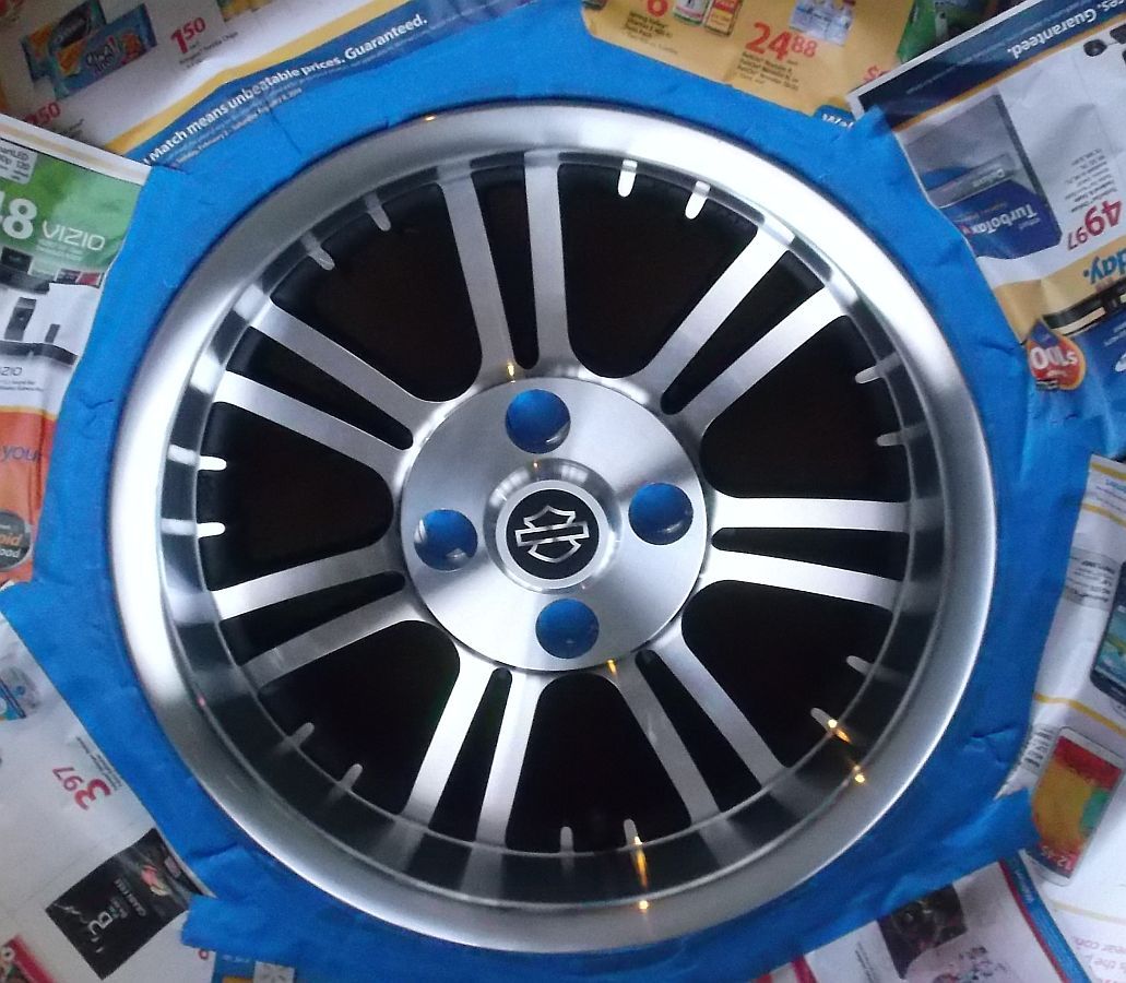

Next I pulled the wheels, Mary cleaned them and taped them off. I then gave them 4 coats of clear. They are drying over night and I'll put them back on tomorrow. Hopefully we'll never have to look at, or clean any more stains off them.

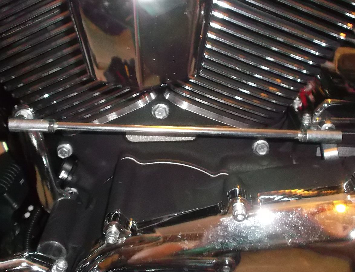

Next up was getting rid of the stock linkage, which is just plain looking, plus, it is not if it will fail, but when.
Replaced it with one of our Chrome linkages that has heim joints (that won't fail).

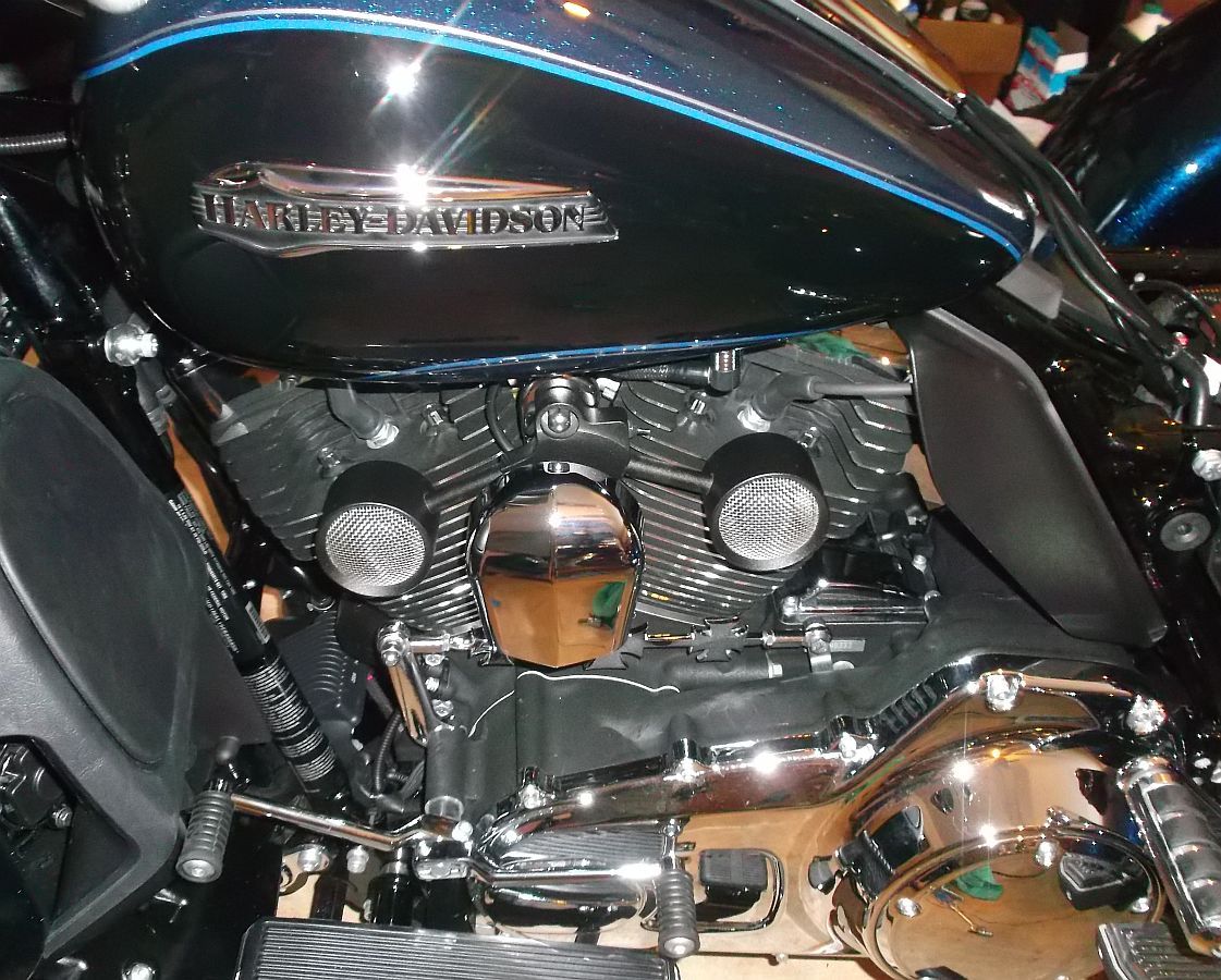

Last thing I did today was install the Wards Parts Werks FCS fans.

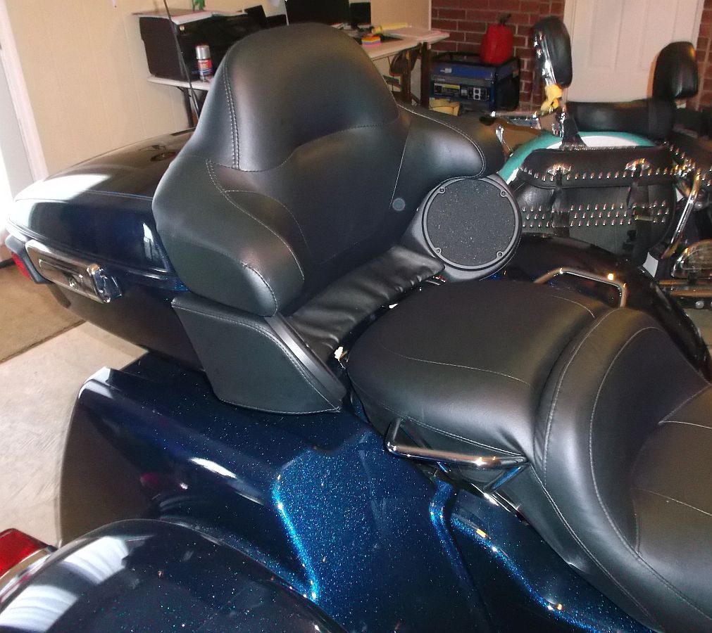

From the pic below you can see I installed my backrest, air hawk and sheepskin. Definitely better for me...but need to get the handlebars made and installed...those puppies are just too short for me.
Also, hopefully you can't see in the pic that Mary put some 3M film on the fenders, the plastic between the fenders and the side covers, and also film on the side covers.
Here's a better pic of the Wards fans and the DK Custom Shift Linkage-

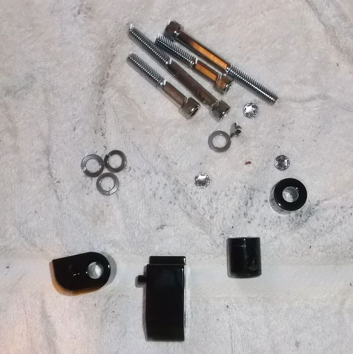

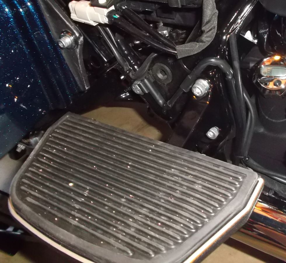

Have not done much on the list. Today, after work I put the floorboard extensions on.
I ordered the kit from VTwinGoodies.com I knew it would only fit the right side and I would have to do some other work to make the left side work because of the parking brake.
But I thought it would be a good jumping off point.
This is the 4th kit I've purchased from VTwinGoodies, as always, it was delivered quickly. :)
It does not seem like moving the floorboards out 1" would make that big a difference....but it really is Much more comfortable for me.
Here is the right side stock- Foot is way up against the engine/pipes.
This is a pic of the parts from VTwinGoodies-
Here is a pic of the right side with one of the round spacers and one of the squarish spacers installed.
The hardware with the kit is Grade 8.
Much better, I can move my foot around more, and much less likely to get my boot heel scuffing up the exhaust shield.
Here is a pic of the left side in stock form. It does not feel as tight against the engine/primary, but there is still very little room to move my foot around.
I figured I was going to have to pull the bolts, see what I needed in the way of spacers and longer bolts, & then make a trip to the hardware store in the morning.
I was very happy to see there were only 3 bolts and all the same size.
I was able to use the second round spacer &amp; a bolt from the VTwinGoodies kit. I thought I was going to have to go to the hardware store and get a couple of spacers and grade 8 bolts. Then I realized that the Sportster Passenger Comfort Peg Extensions we make would probably fit. They did! :)
So I was able to get it all bolted up (with lock washers and thread-locker) this evening. No need to go to the hardware store in the morning.
Here's a pic of the left side finished.
It went much easier than I thought it would.
There was plenty of wire for the parking brake to move out 1"

Two ???'s --- how does one disable the EIMTS ?
and
What brand of clearcoat did you use on the wheels ?? --- was thinking about taking them to a local auto paint shop and having them do that and then noticed you used a rattle can approach
TKS
G
What Montgomery said about the EITMS.
Clear coat I used was Rustoleum Acrylic Enamel Crystal Clear.
I've ridden in the rain several times since, and they just wipe clean with some pledge. No Stains! :pepper:
Only question now, is how will it hold up over time.

Did a Tank Lift with the Deluxe Option.
Bikes pretty dirty from riding in the rain and wet roads Saturday night.

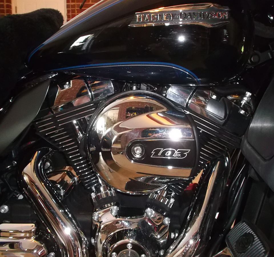

Here's how the tank sits on top of the rockers in stock condition. Trapping heat, blocking air flow, and covering up all that chrome.
15 minutes later I had the Tank Lift installed....now there is much better air flow over the engine, less air over the top of the tank causing buffeting, and more chrome is showing...also, as you can see, on the waterheads it makes the coolant hoses more visible also.
Next thing I did was remove the left side scoop/thigh protector. I left the right side on. This scoops air in behind the rear cylinder, and with the left side scoop deleted, it leaves a path for good air flow across the back of the rear cylinder for better cooling.

Next up was a Tour Pak relocation. The TP was delivered to us in the rear most position (oem has two location choices).
As with other Tour Paks in the past, we decided to relocate this one another 2" further back than stock. This gives Mary plenty of room, but does not put the TP so far back that it compromises integrity of the mount or the handling of the TG.
For decades HD has used a tubular rack for the TP mounting. This is a fundamentally flawed design that is prone to cracking/breaking.
8 years ago we began producing a Tour Pak relocation kit that is essentially a flat plate that sits on top of the tubular rack and allows the TP to be moved back. Besides allowing for adjustment for TP placement, it also strengthens the flawed HD tubular rack.
When the Tri-Glide was introduced HD used the flat plate design instead of tubes for mounting the TP. Then in 2014, All Tour Paks are now mounted on a flat plate from the factory.

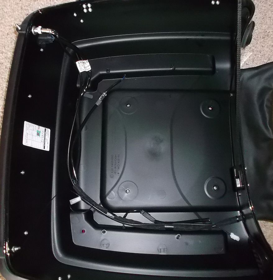

The first step was to unhook all the wiring to the Tour Pak, remove the speakers from the Tour Pak (there are no connectors on the wires to the speakers that you can detach without removing the speakers), and then remove the TP mounting rack from the trunk. There are 6 bolts that hold the rack to the top of the trunk and you can access them from inside the trunk.

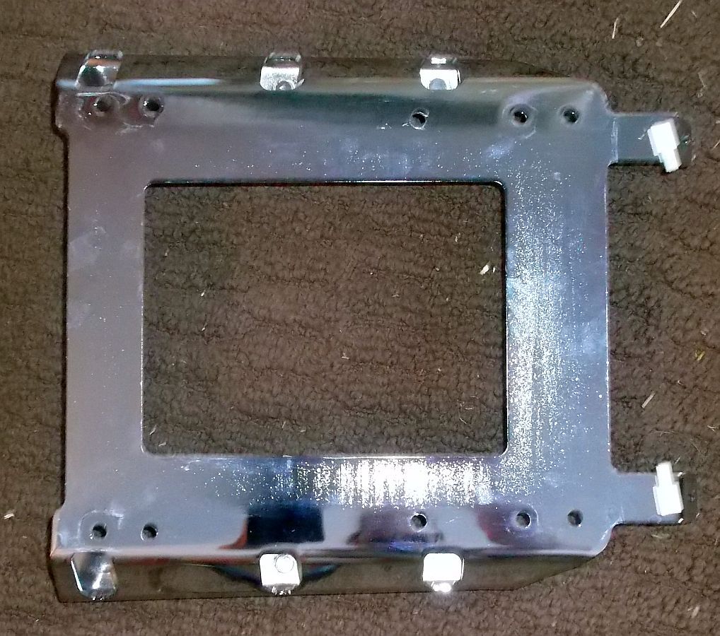

Next step was to remove the mounting rack from the bottom of the TP.
4 nuts.

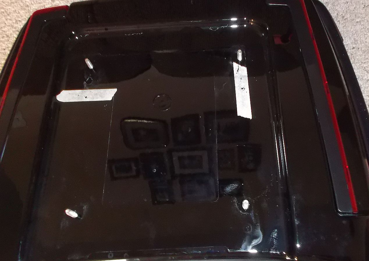

Next step was to use some masking tape to mark where we wanted to drill the new holes in the mounting rack for the front 2 bolts/studs.
This picture shows that I drilled pilot holes before the full size holes.
Here the holes are drilled and ready for fitment.

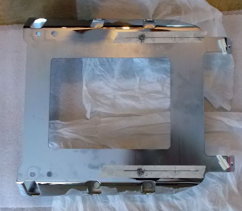

Next was placing the mounting rack on the TP so that we could mark where we wanted the new back holes to be in the TP.
Here is where we want to drill the new holes in the TP...thru the plastic AND the inside metal plate.

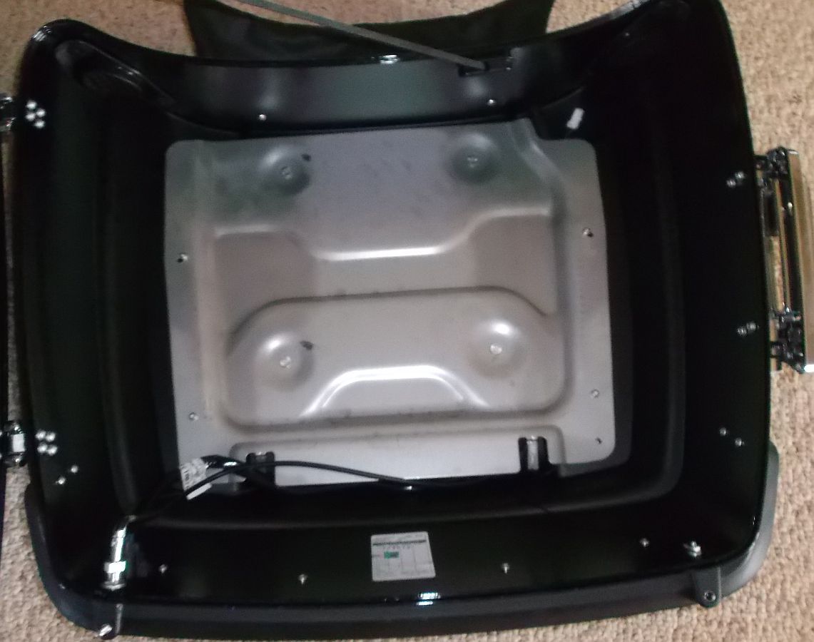

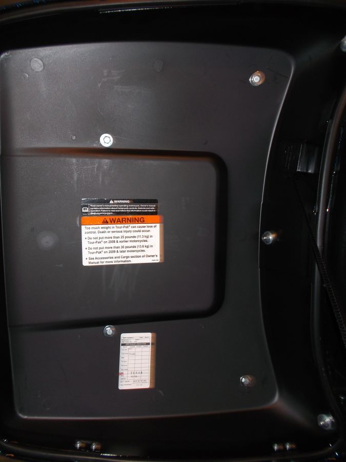

Before drill the new holes thru the TP and the inside metal plate, we removed the inside metal plate to make sure no wires were in the path of where we would be drilling.
Metal plate inside TP, below liner.
btw, to remove the liner, the bottom side of the retractable tether must be removed.
There were none, but in the past I have seen wires running right across the path of where we wanted to drill holes.
Now we drilled the new holes thru the TP and the inside metal plate, and then attached the TP to the mounting rack in the new position, 2 inches further back.
Note- in the past HD used bolts that ran thru the metal plate and then the TP.
Now they are using press fit studs in the metal plate. That is why you see the extra &quot;bolts&quot; in the following picture. I could have cut them off, but they are not visible unless you get your line of sigh lower than the bottom of the TP, so I left them there.
Tour Pak installed back on the TG...now with an extra 2 inches. We're ready for lots of miles for Mary to travel without feeling cramped at all.
btw, in case there's any concern that the rack or mounting is not strong enough with this modification...this is the same thing we did on the 2011 Tri-Glide and we had that TP loaded for 10's of thousands of miles at 2.5x over maximum rated load and never had a single problem, including on those "roads" up in the Yukon.:)

Did my first oil change at 700 miles...also installed the reusable oil filter off the 2011, and installed the Oil Bud oil cooler.
I have not finished evaluating the Oil Bud. Will have that done tomorrow.
Here's a pic of the filter and the Oil Bud adapter with thermostat sticking off the top.

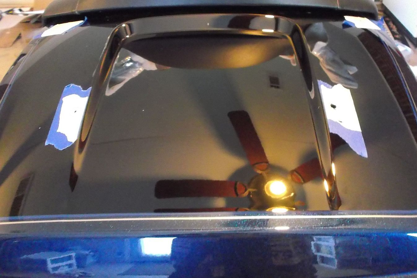

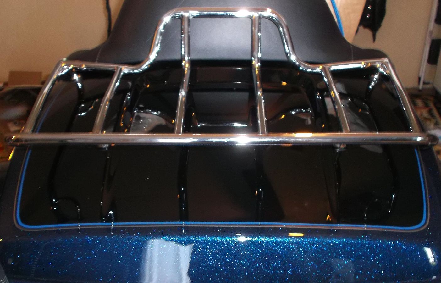

Next up was getting a rack on top of the Tour Pak. I picked up a Kury rack that has bungie loops built into each corner.
Taped off the lid, drilled pilot holes and then the 1/4" hole for the bolts.
Here's the inside of the lid. The kit has good hardware with it, good heavy washers and heavy rubber cushions, top and bottom. The bolts were 10mm hex. Been awhile since I broke out the metric sockets.
lol
And a pic of it installed...the top side has the cushion and a nice foot for each leg.
Got the left side Highway peg set up installed this afternoon. Will be doing the right side in the morning.
There was never any doubt that I would use a peg/heel rest set up. This set-up is light years more comfortable than just a peg, and it can look really good too.
As far as what pegs to use, I really agonized over this. On my Heritage I went for looks at the sacrifice of some comfort. So much of the Heritage is about looks, and I just "had" to keep the classic theme consistent.
On the Tri-Glide, I ended up going for function over form. We put serious miles on the TG, sometimes very long days. If I don't have a lot of comfortable (and stable) foot/leg positions, the pain from the previously broken pelvis, broken knee, and 9 broken bones in the right foot can turn a fun day into, well, not so fun.
I ended up using the same combo that served us well on the 2011 TG. Triple Traps for the Pegs and Trap Shift peg for the heel rest. Mary painted them with the "chrome" paint...but they don't really match. They are not as poorly matched in person...the camera with the flash really does them no favors. lol
This is a proven set-up, the pegs rotate with firm pressure for endless foot and leg positions.
So I know I'll be comfortable, as some point I may chrome them or give them some other finish.
