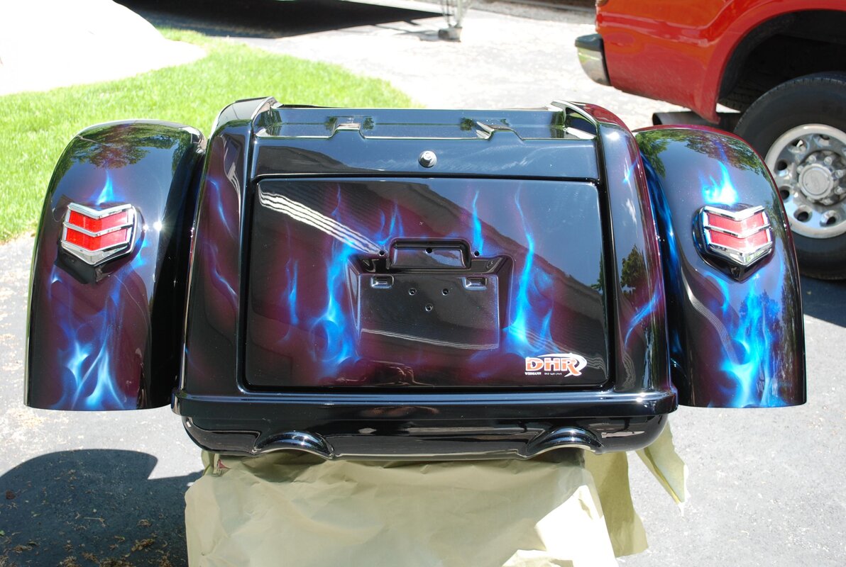

I like the 40 Ford taillites.Was there bodywork necessary to mount them ? Where did you purchase them ?
Thanks ,Wayne
I to suffered from a bike vs car accident, but I lost my left leg among other injuries. Left with no options, I ordered my Tri-Glide. It went from the dealer directly into the paint shop and after that I added my own touches. Gone are the huge H-D taillights, replaced by '40 Ford LED's. Blue "real flame" paint on body and a hand painted eagle on the fairing. Also posted a pic of the custom V-8 trike I'm working on...
Being in the wind, even on three wheels is still the best therapy...
Those '40 Chevrons look really good on your trike. Nice work!
