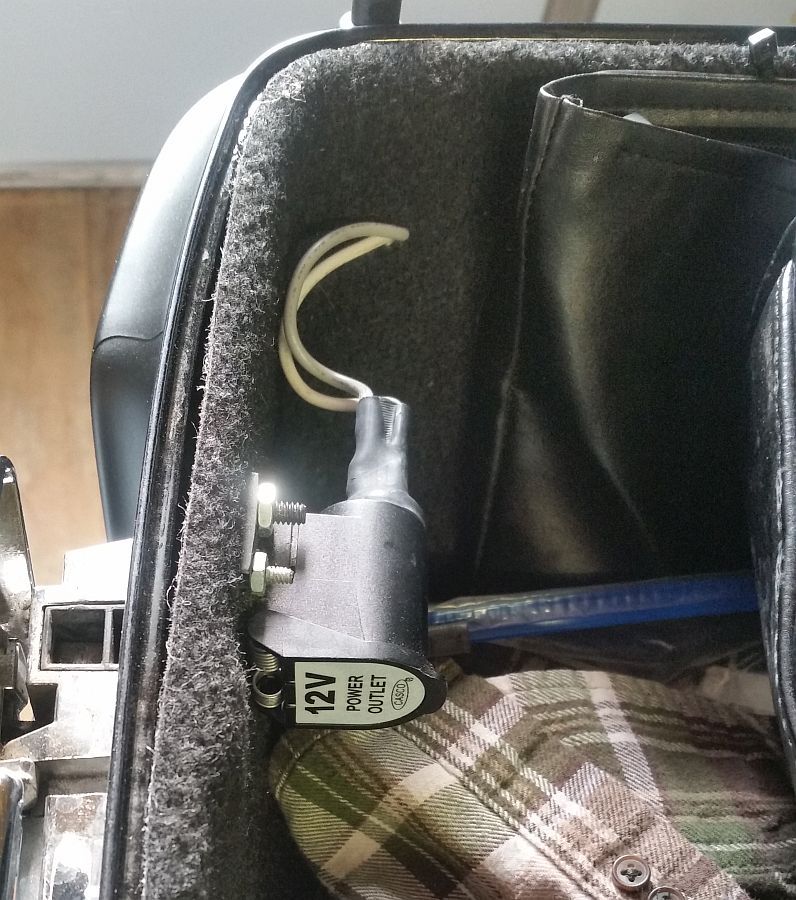

I added a Power Port in the Tour-Pak a while ago...just realized I had not posted a pic of it.
Picked it up at Wally-World, and wired it directly to the battery, with an inline fuse. That way I can use it, even if the ignition is not on.
The reason I put it up high is so that when we're on a trip and the Tour-Pak is full, I can easily plug in whatever I need charged without digging thru a bunch of stuff. It has worked out really well in that location. At times I've had two phones and two camera batteries charging at the same time.

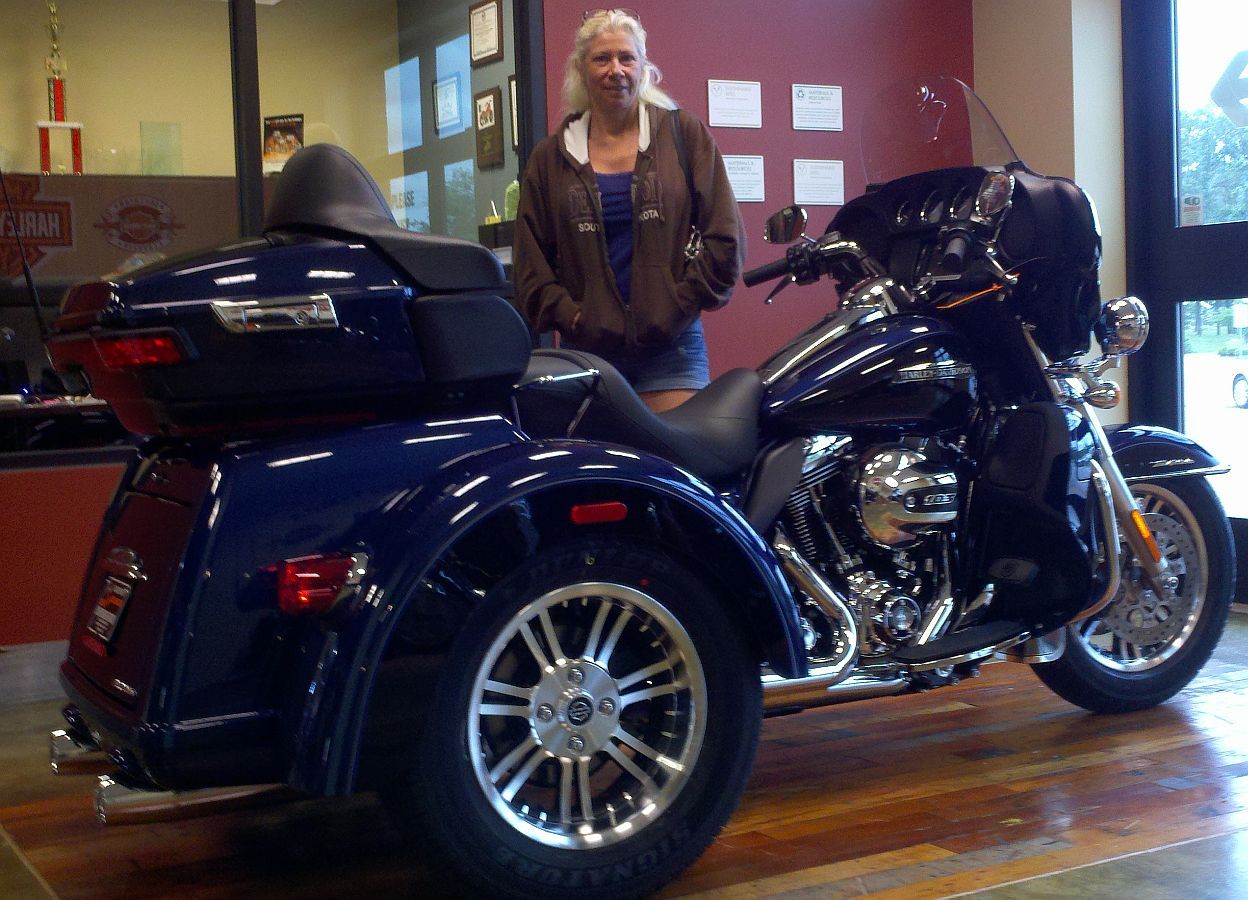

Here is what it looked like when we decided to make it our next Project.
We have already completed a couple of small mods to it, and there are many more coming.*
