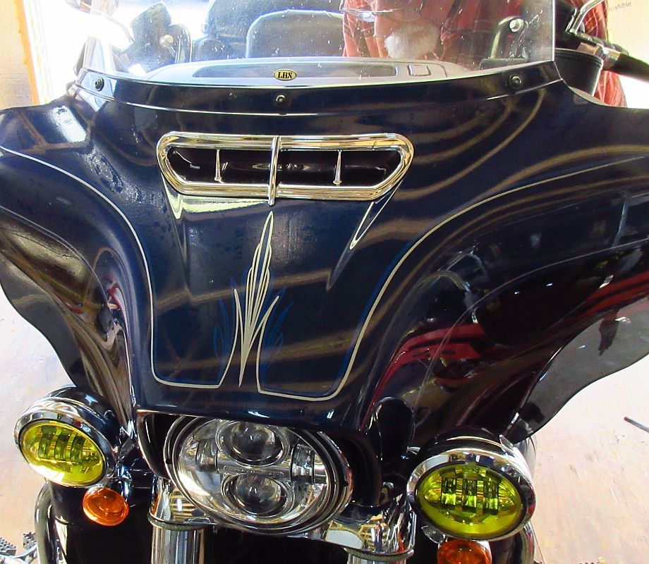

Today we had a local guy, George Perkins, add some pinstripes to it...waking it up a bit.
It is still drying, so the pics below are not cleaned up, still has some of his guideline marks on it.
In the next couple of days we should have some nice pics of it.

George, working on the top side of the tank-
Fairing-

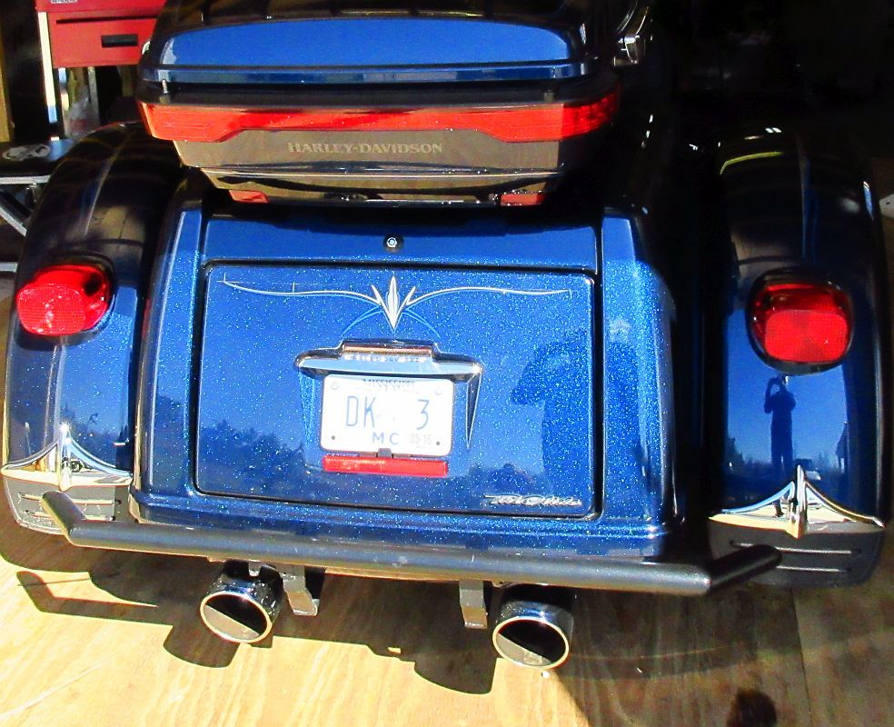

Working on the trunk-
Trunk finished-
The front fender, rear fenders and sides of the Tour-Pak got a little work also.
Will post more pics up after it is cleaned up.

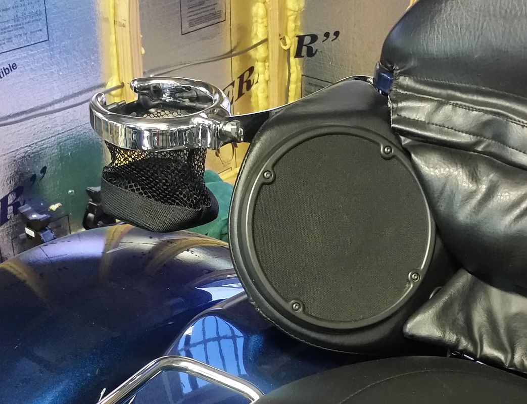

Pic of a cup holder I added for Mary-

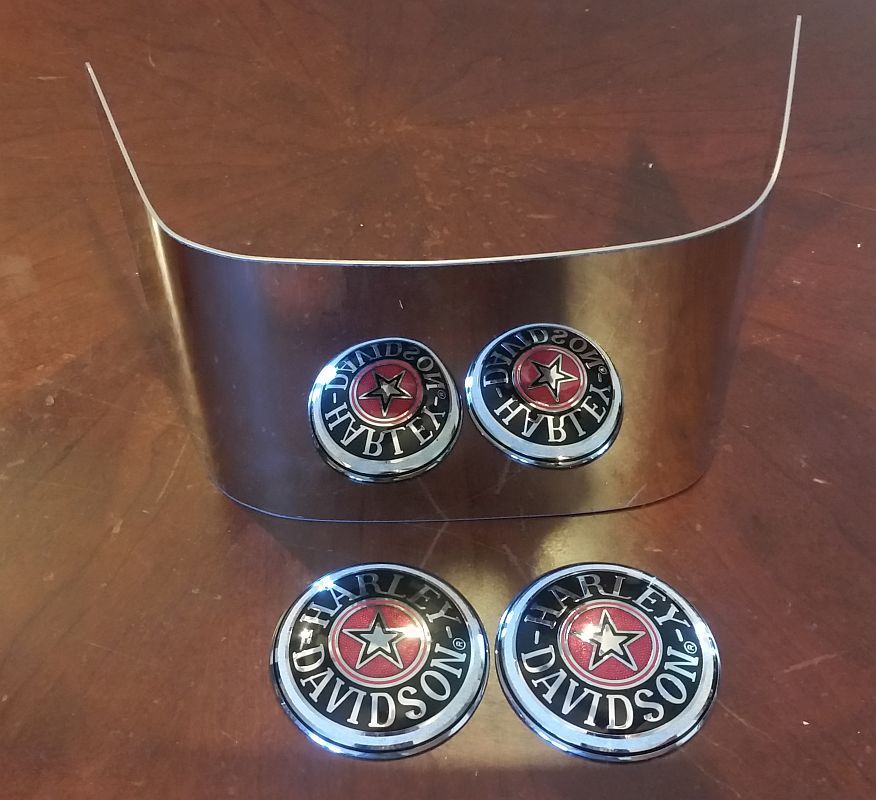

Already drilled the holes for the attaching bolts...now we're getting the emblem where we want it-
Since the back of these emblems are concave, we filled in the space (a week ago) with JB Weld, so that the back of them was flat. We then put commercial grade double sided tape on the back of the emblem. We also drilled a hole thru the skirt and then secured the emblem to the skirt with the double-sided tape And a sheet metal screw into the JB Weld. :D The tape would have probably held it by itself, but figured better safe than sorry. ThumbUp
Emblems in place-
Installed on the fender-

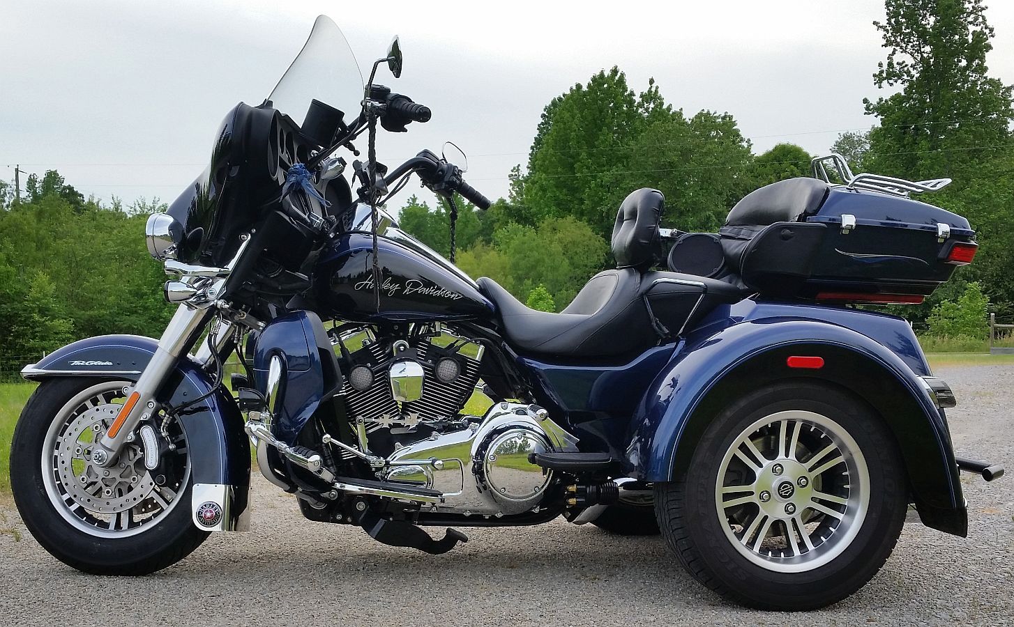

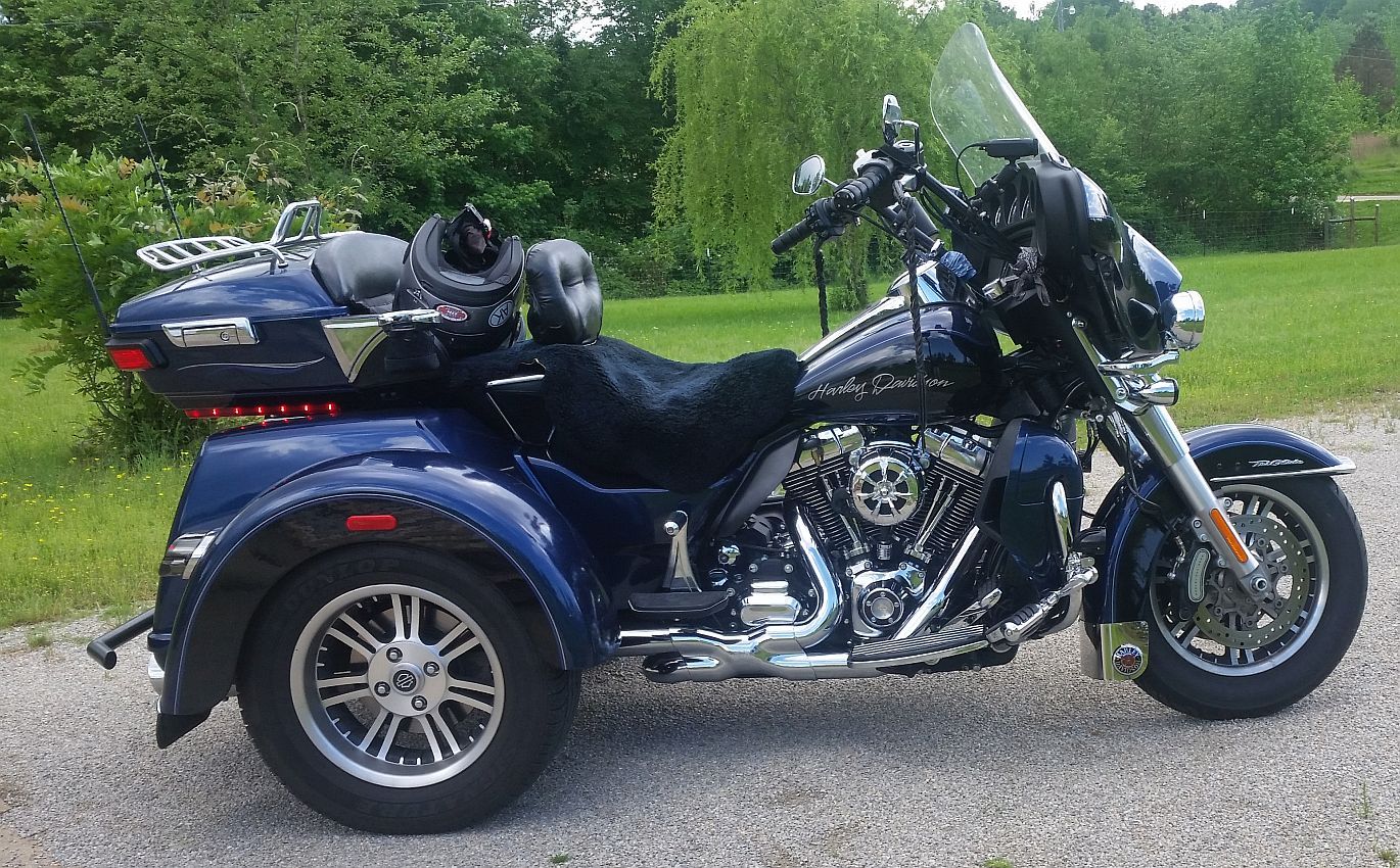

Still have a few more things to do, but it is quite a different Tri-Glide than it was a few months ago. *:)
"It is quite a different Tri-Glide" than anyone"s. You seem to be one of those breeds that always inventing ways to make it better. Nice work by the way.ThumbUp
