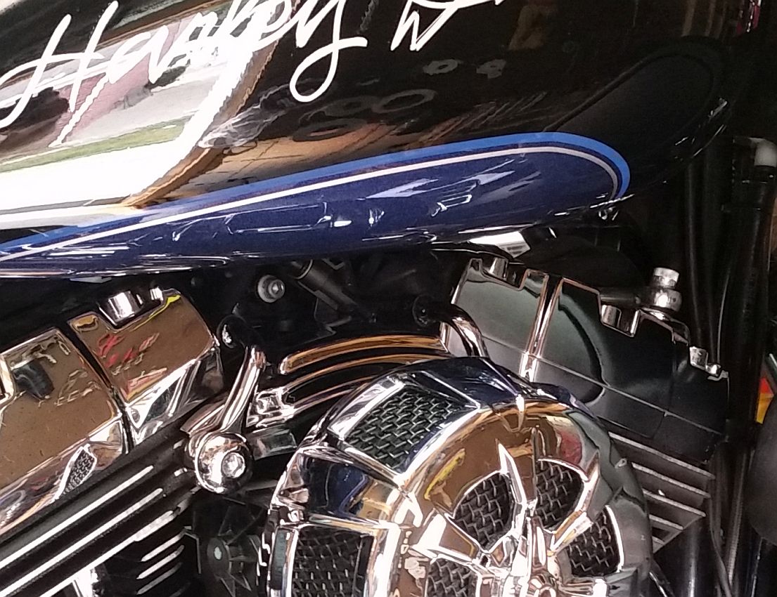

Installed the Outlaw 606 Air Cleaner with the 7 Spoke Chrome cover. Painted the metal mesh a contrasting black. Used the EBS with a chrome catch can.

Dual-Cool Oil Cooler & Oil Filter Relocation- Keeping the Twin Cam from running too hot will increase the life expectancy of the engine. This unit also makes changing the oil Much Easier and No Mess.
We are super happy with how this turned out. It is the only oil cooler that works with the Twin Cam Twin Cooler engine.
We worked a long time on this to get it right, and the drop in temps are substantial, and the ease of filter changes are night and day from stock.

I already put a zerk fitting into the primary case for my shifter shaft. It has quieted it down quite a bit. Although I did wait too long to do it and the bushing is pretty worn.
