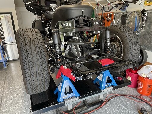

Another fan of the Nexgen shocks. I installed the 14" shocks with comfort lift brackets, the ride is greatly improved, the harshness of the ride is gone. If you install these yourself, do yourself a favor and remove the body first (6 bolts inside the box), it is well worth the extra effort.
Is it necessary to lift the trike off the ground to do this?
