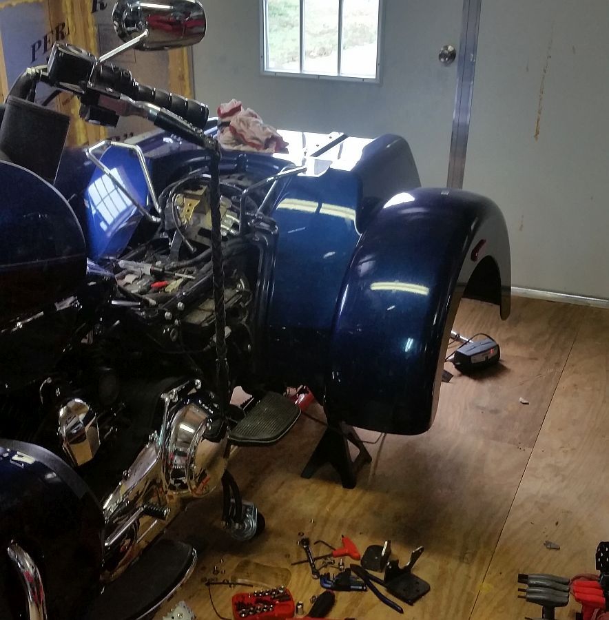

We broke down the TG a bit, I went to work on installing a newer prototype of the oil filter relocation, while Devin worked on installing some rear fender LED's.
The OF relo bracket we've been running has held up well to over 1500 miles of riding. But it did not leave clearance for the passenger floorboard to be on the lowest adjustment, AND for the adjustable passenger pegs.
So we cut a new one, with a bit different configuration, so that everything would fit nicely.

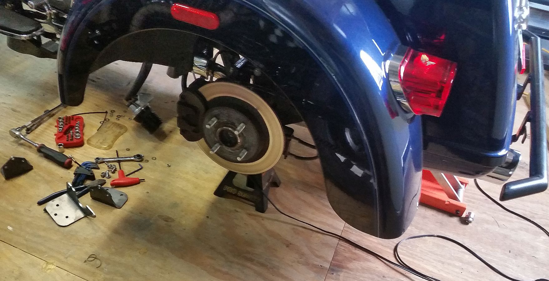

While I was doing that, Devin was installing the second prototype of our rear fender LED's.
btw, we are NOT holding up the rear of the TG with the jack stands you see. There is a flat scissor jack under the crossbars below the trunk, and then jackstands on either side providing some stability.
Here's a pic of the, "hidden while off", fender LED's. They are run-brake-turn, and are mounted to a special bracket we fabbed...not just for mounting how/where we wanted the LED's, but also to protect them from water/debris coming off the rear tires. That's the theory...we'll see how it holds up to rain, mud, gravel, etc. :)

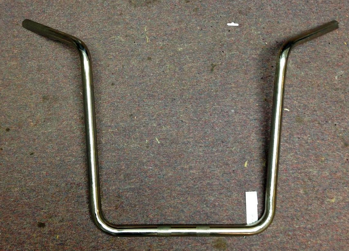

handle bars and sheep cover
Just wondering what Mr. DK is using for "Handle Bars" (size & Name) and where he got his Sheep cover from.?
AAAAAAAAWWWWW Kevin, the dealer will tell you it will buff right out.
Yeah, they might :laugh::laugh::laugh: ...til they touch it and feel the ridge.
Pretty sure he made his own bars.
Yes, I made my own, using the stock bars, extended 9" longer by welding a 9" straight section of pipe on each side in the already straight section of the stock bars.
Here's a pic of the bars after welding the 9" section into them...but before I got them powder coated.
Much more comfortable, and I have the following mounted on them with room to spare.
