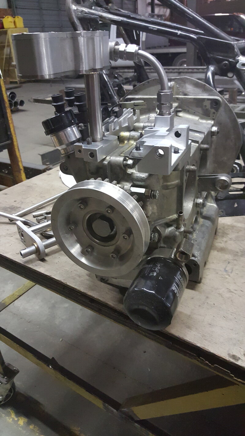

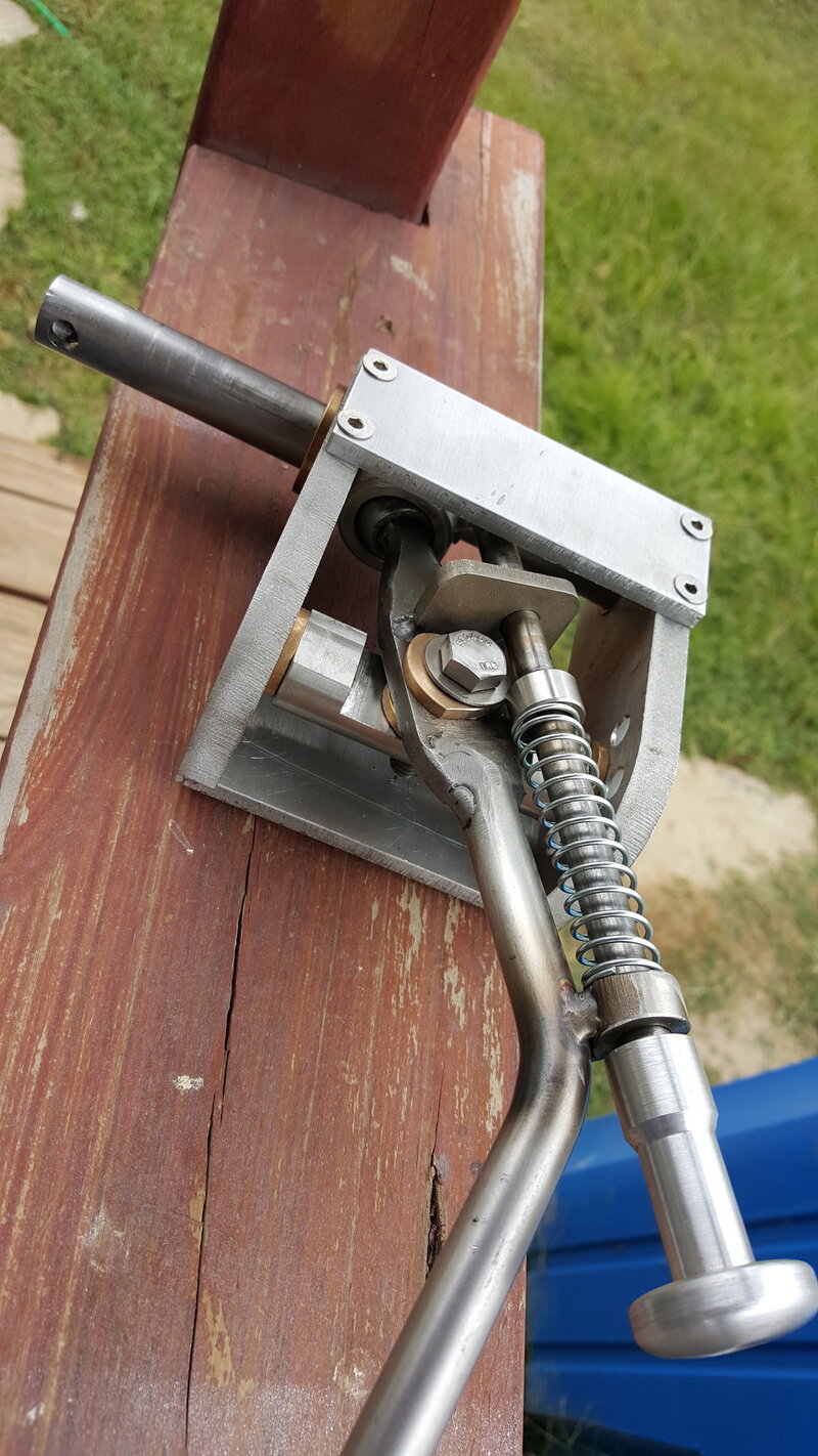

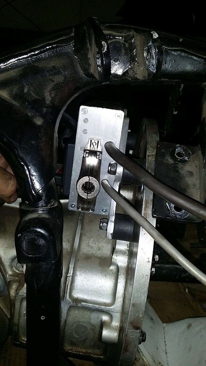

Got the ignition switch and found s place to put it

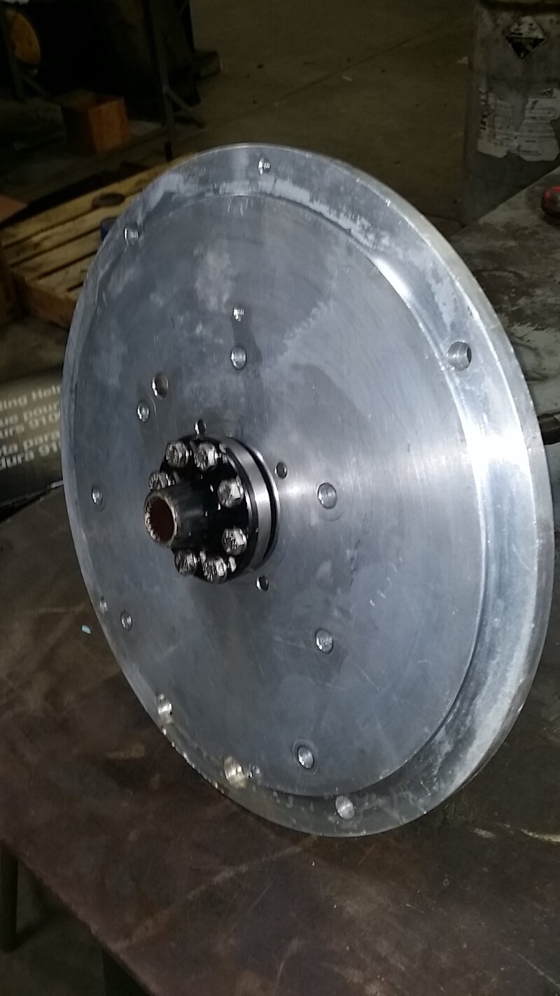

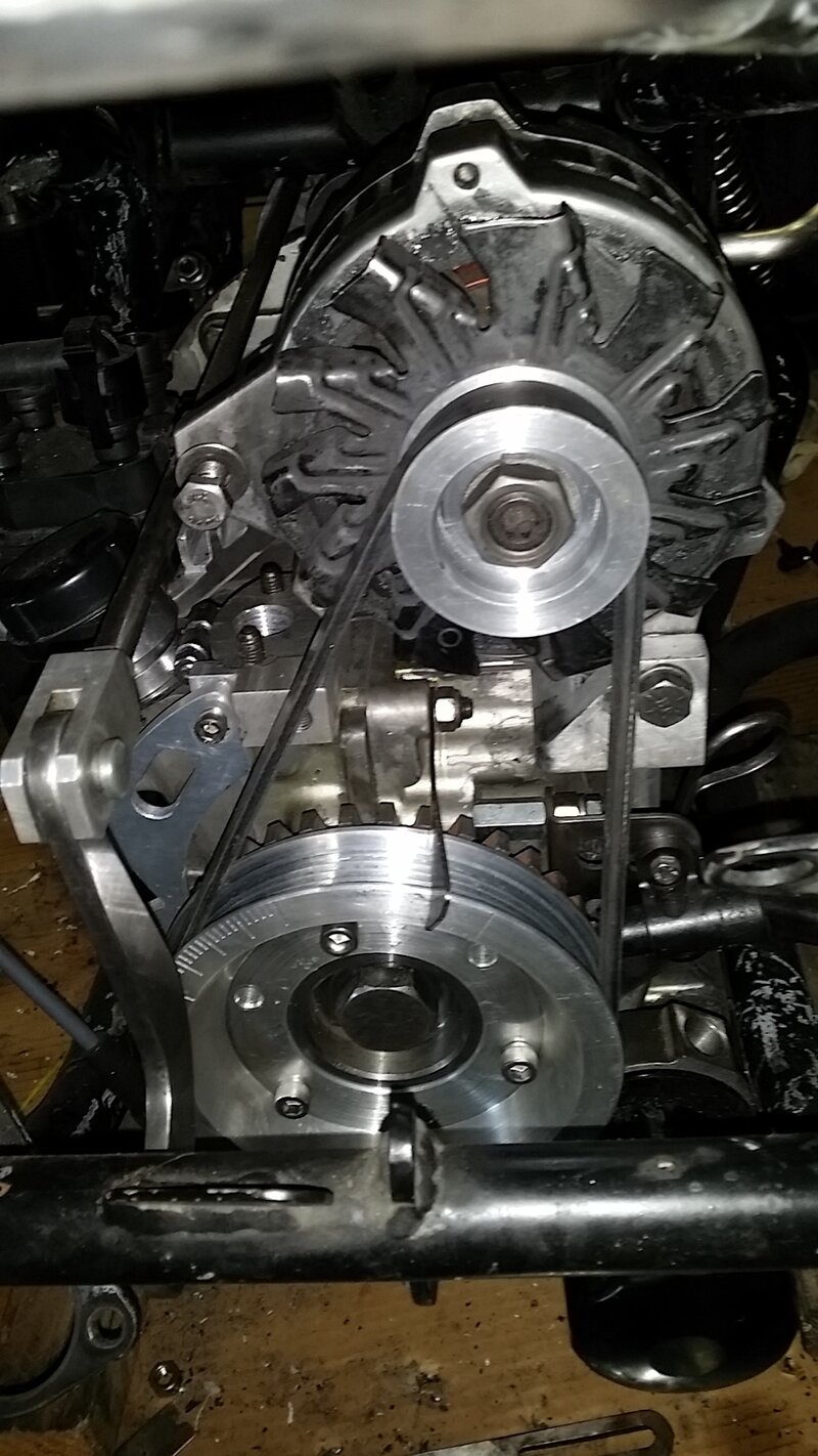

Made a matching alt pulley to go with my crank pulley.

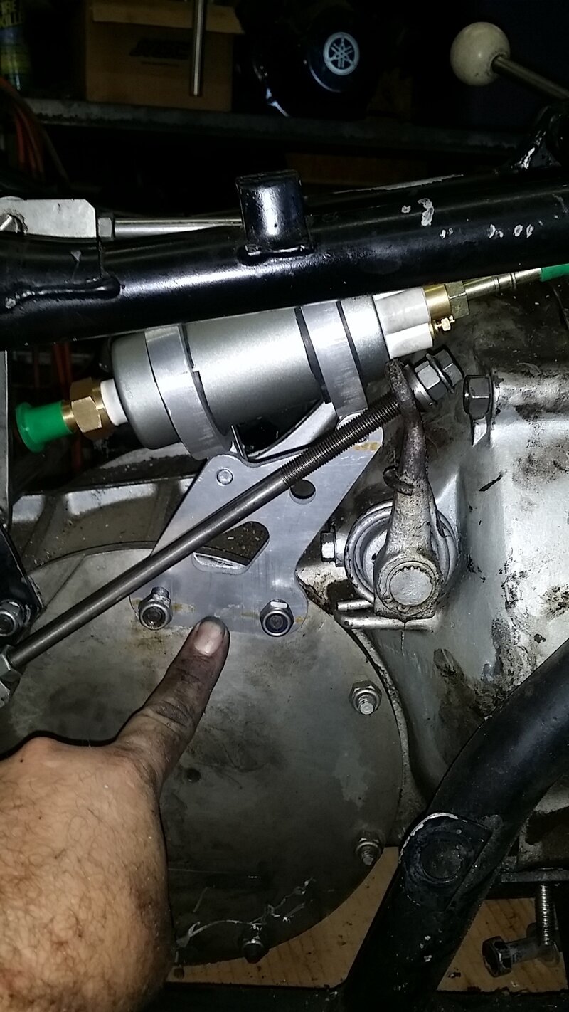

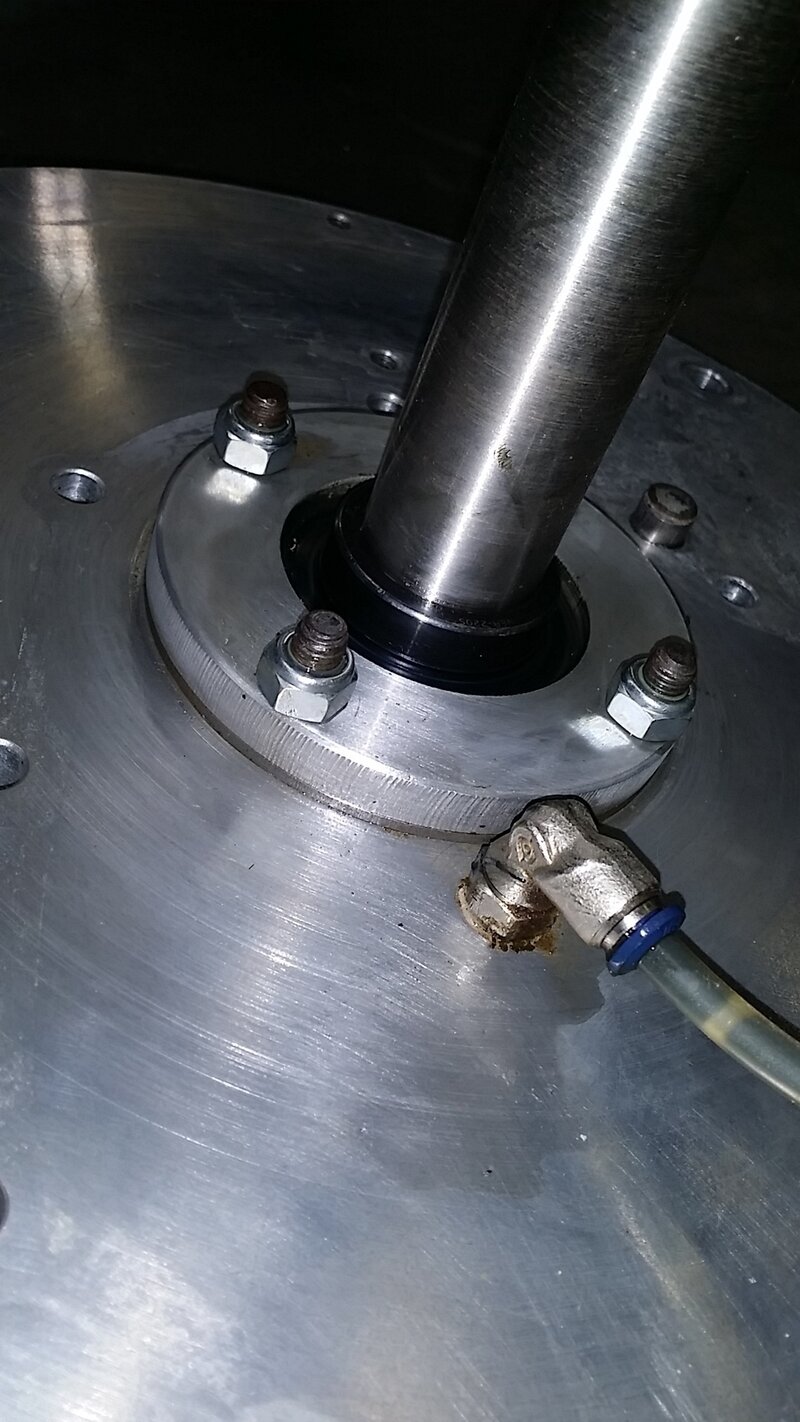

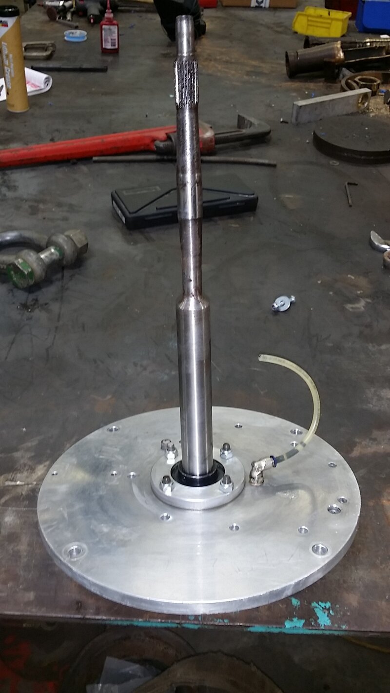

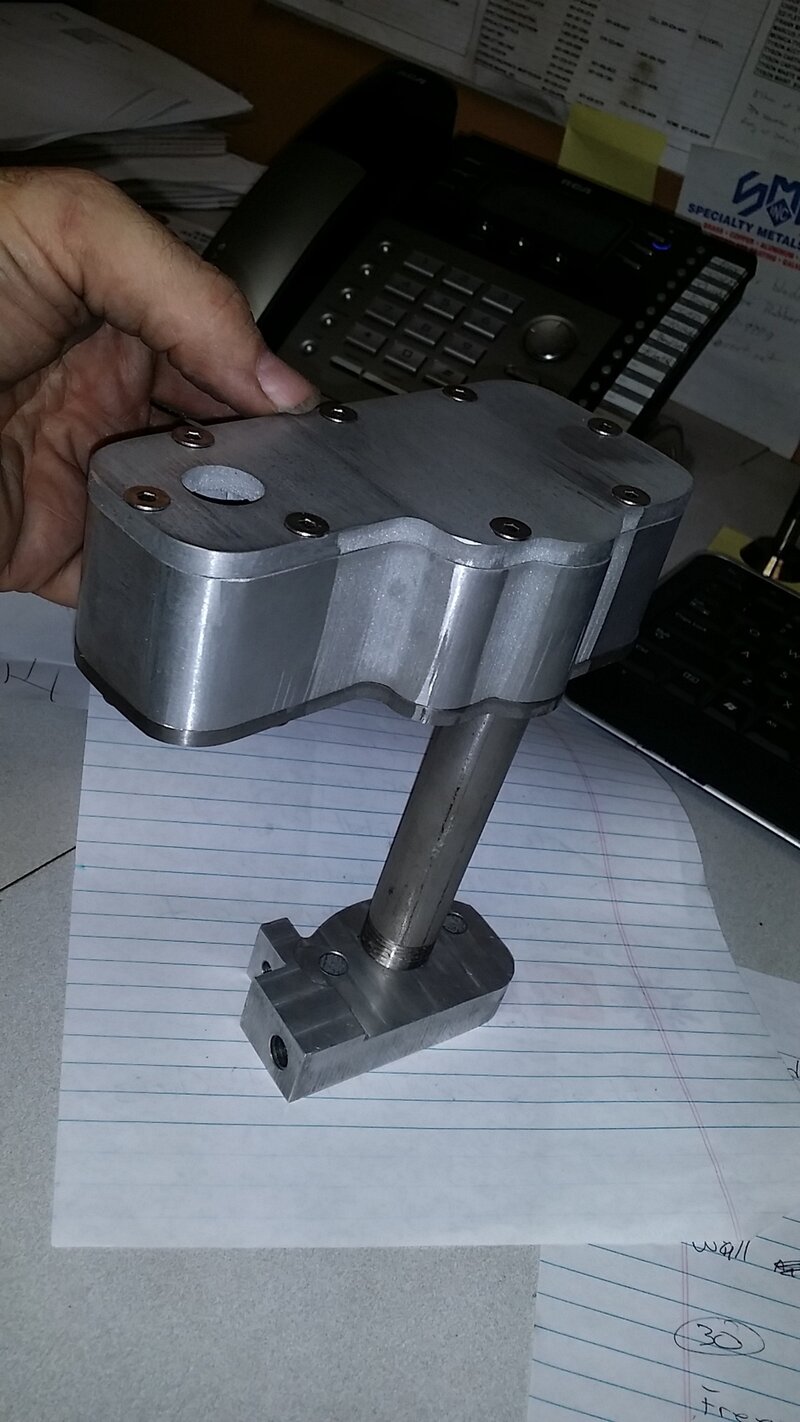

Finished up the machine work on the ford fuel pump mount rings.

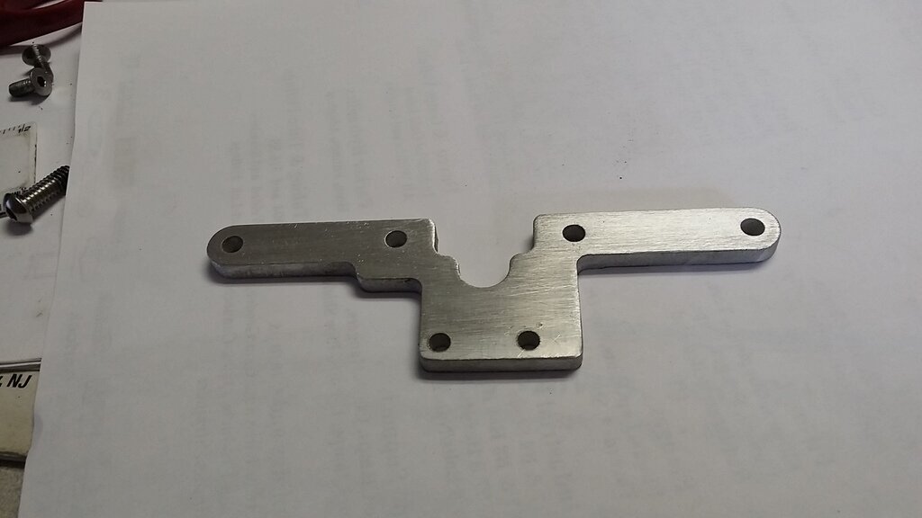

Made up a bracket. Looks like it is gonna be right here.

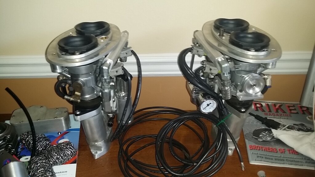

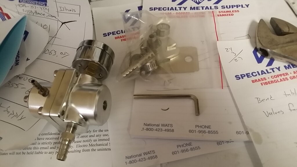

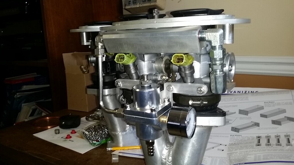

I could not get happy with a location or fuel line route with the automotive pressure regulator I had.
So i got a pretty hot rod adjustable regulator.
And made up a bracket.
Mounted to the intake/throttle bodies.
I had already mounted the idle air valve on the other side.
So the sorta match now.

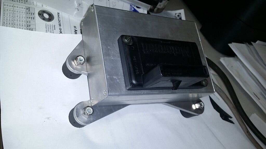

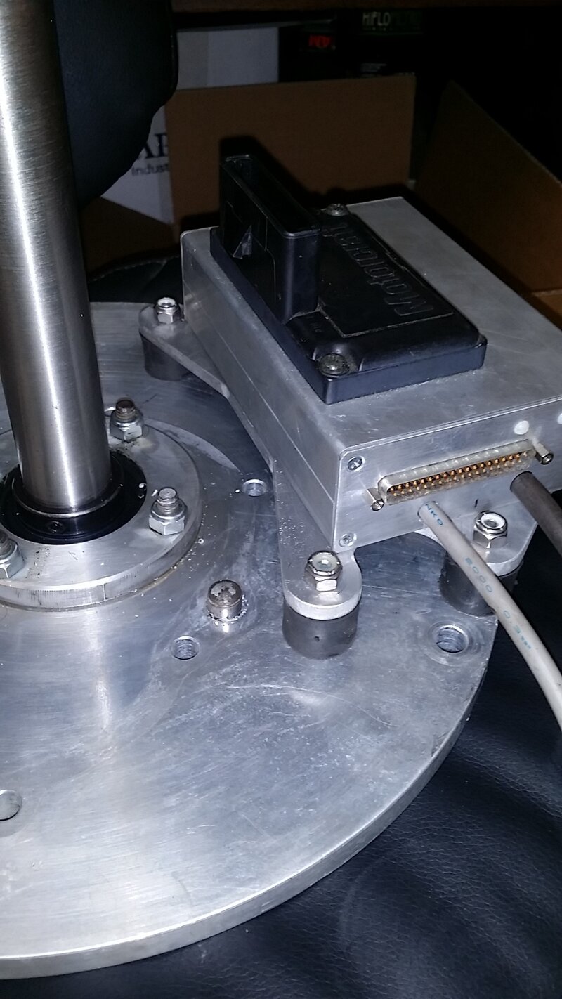

I have some rubber vibration isolators ordered for mounting the computer.

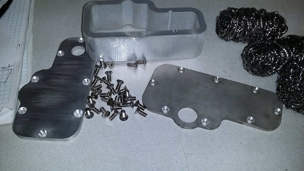

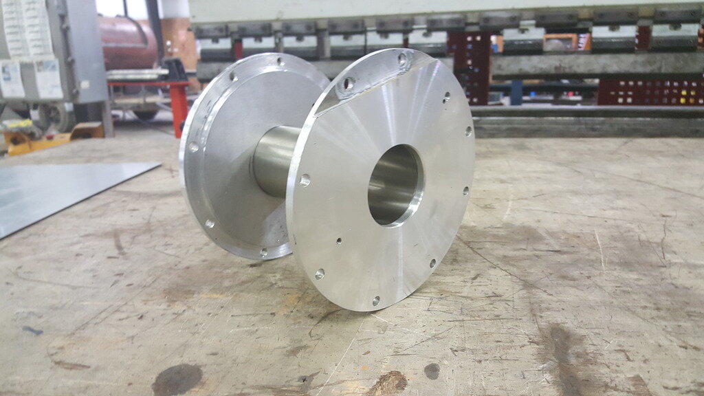

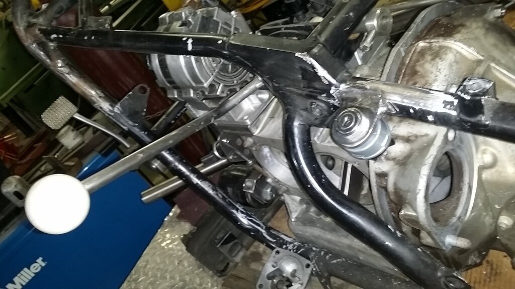

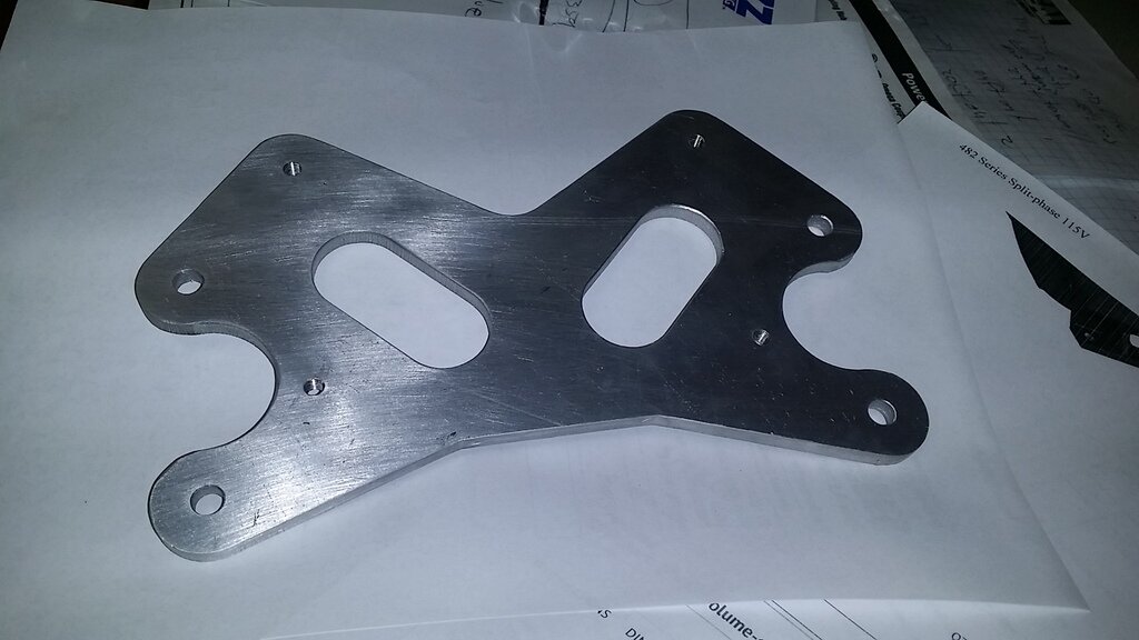

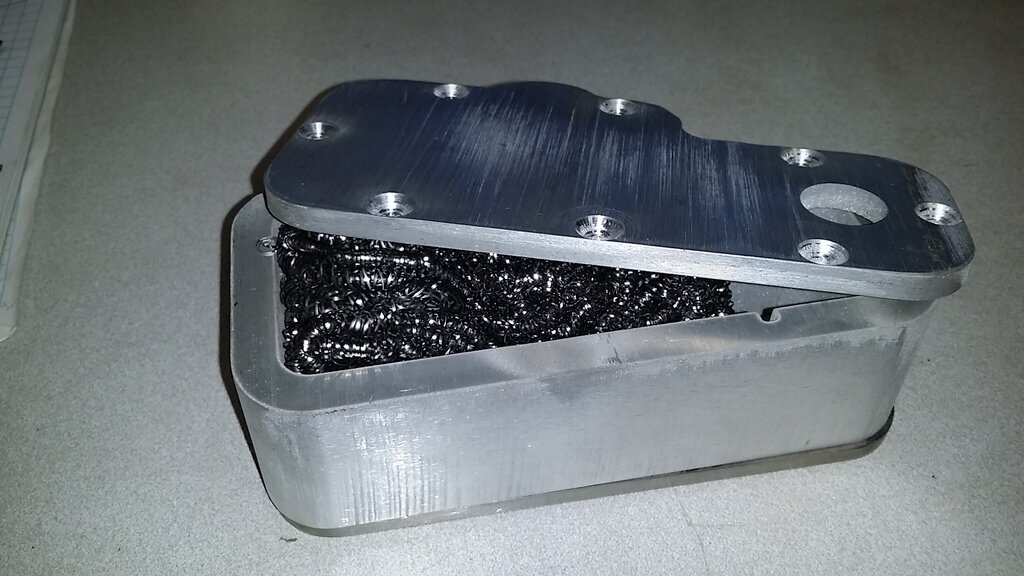

Here is the side covers for the extension case
I am gonna cut a hole in these to pass a header pipe through the trans case to the other side.

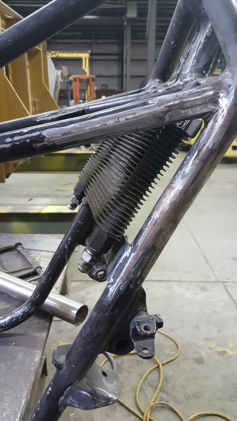

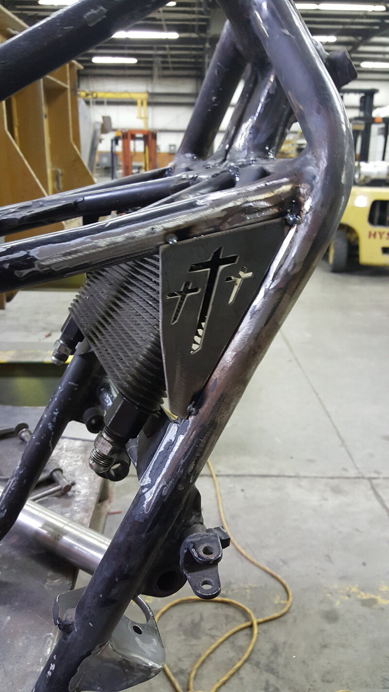

Tore down the mock up. Gotta rework a spot the oil cooler hit. But other than that it is time to paint the frame.

The hole through the tranny extension case now exist.*
Headers are gonna be interesting to build to say the least.*

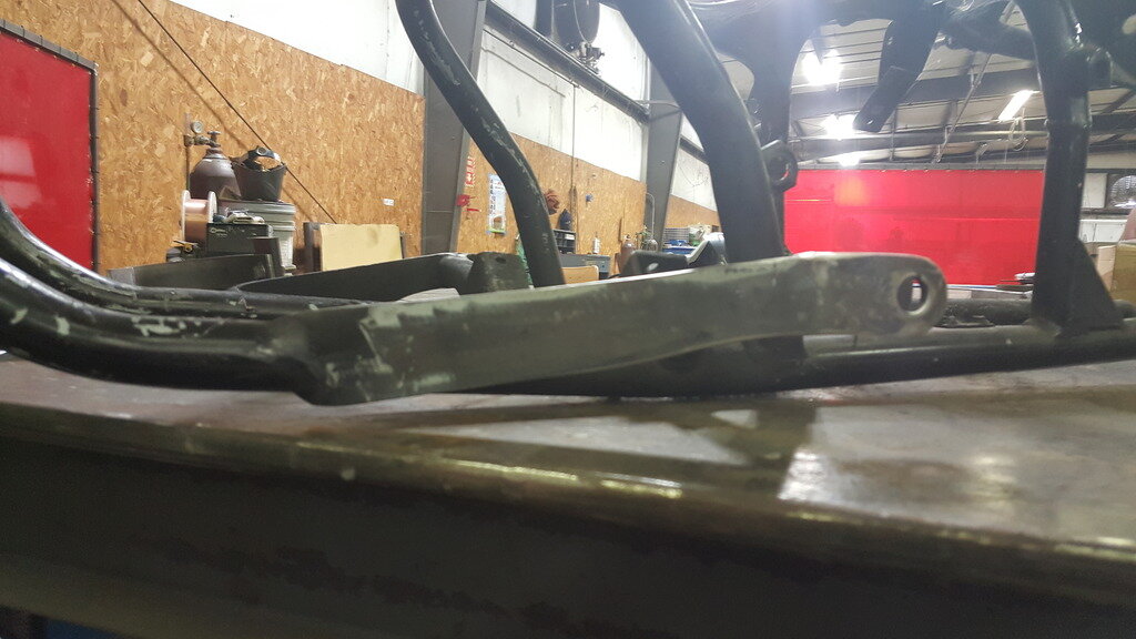

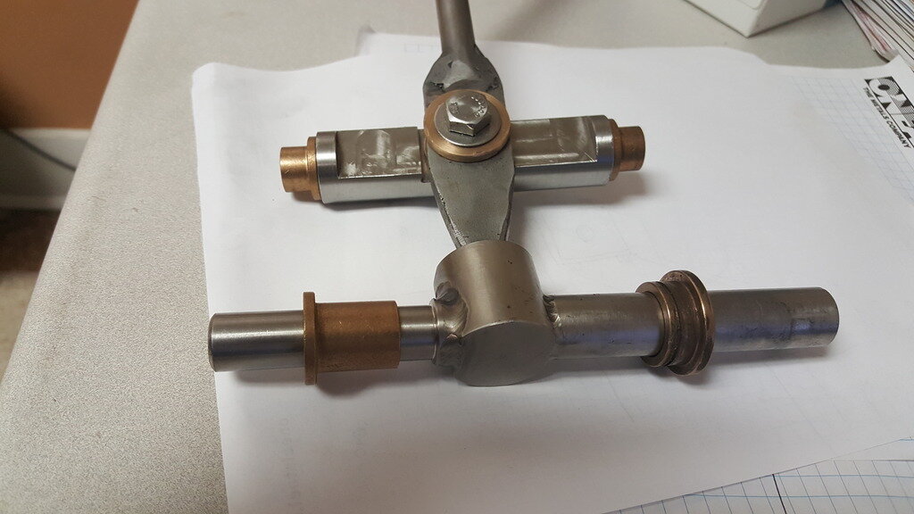

Ground some clearance room in the swing arm mounts.
The engine is gonna be wider and the pipes larger. Both need a bit more room, everything is so tight to fit.

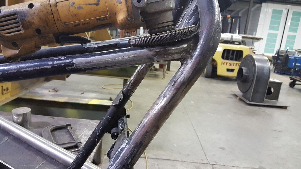

Then cut out (again) that gusset that hit the oil cooler.
The oil cooler .
Then made a single sided larger gusset to replace the boxed in gusset.
And welded.

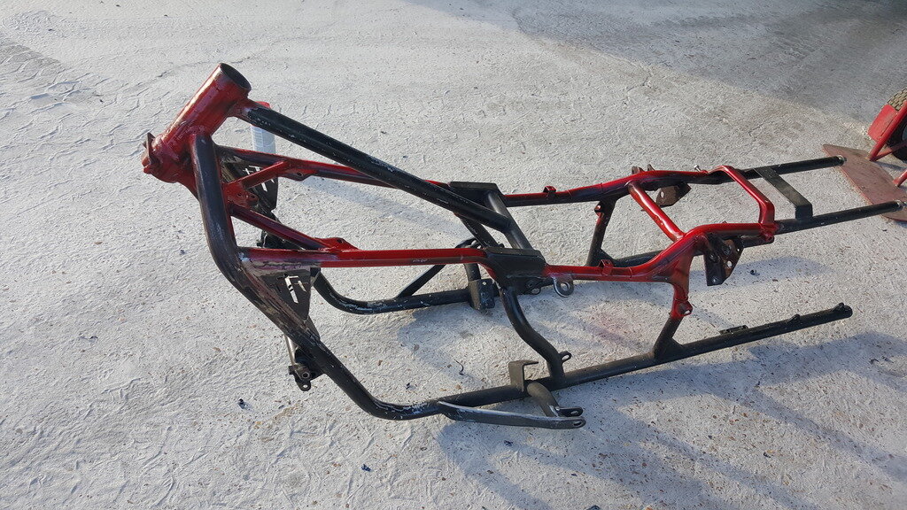

For those who ask.
The red parts are the pieces of the original Honda frame that are left.

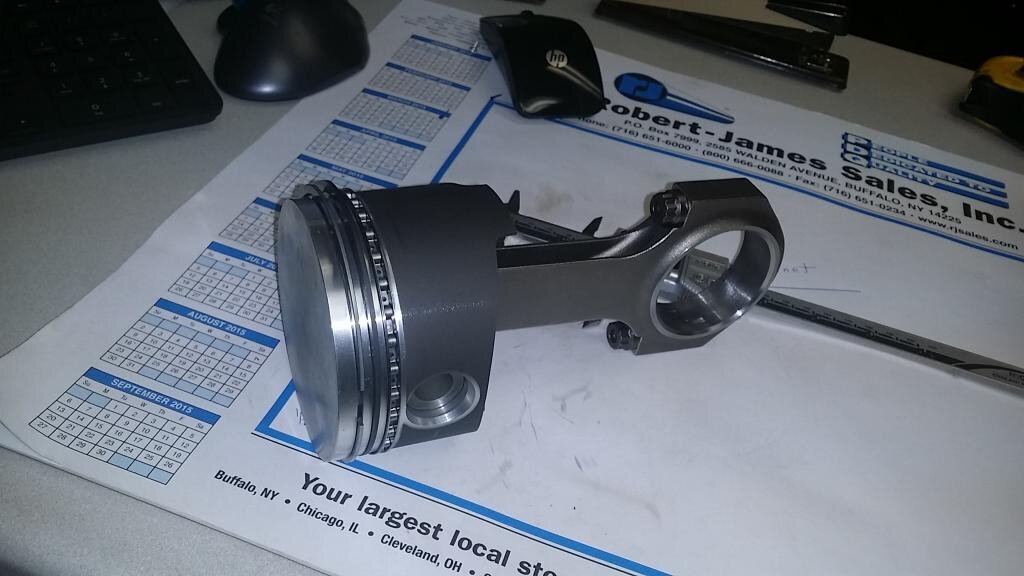

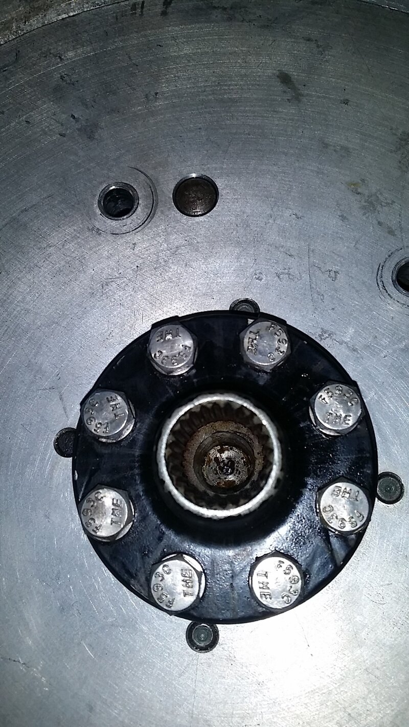

Match weight balancing the engine parts.
I guess I got good parts. Nothing is more than 0.8g different in weight. So matching up part weights I get all the piston ,rod, pin, and ring assemblies all within 0.4g
As I understand, a full high rpm race engine is 0.1g and a street fighter engine is 1g , so I should be good to go.
Now to send the crank out to get dynamic balancing.
