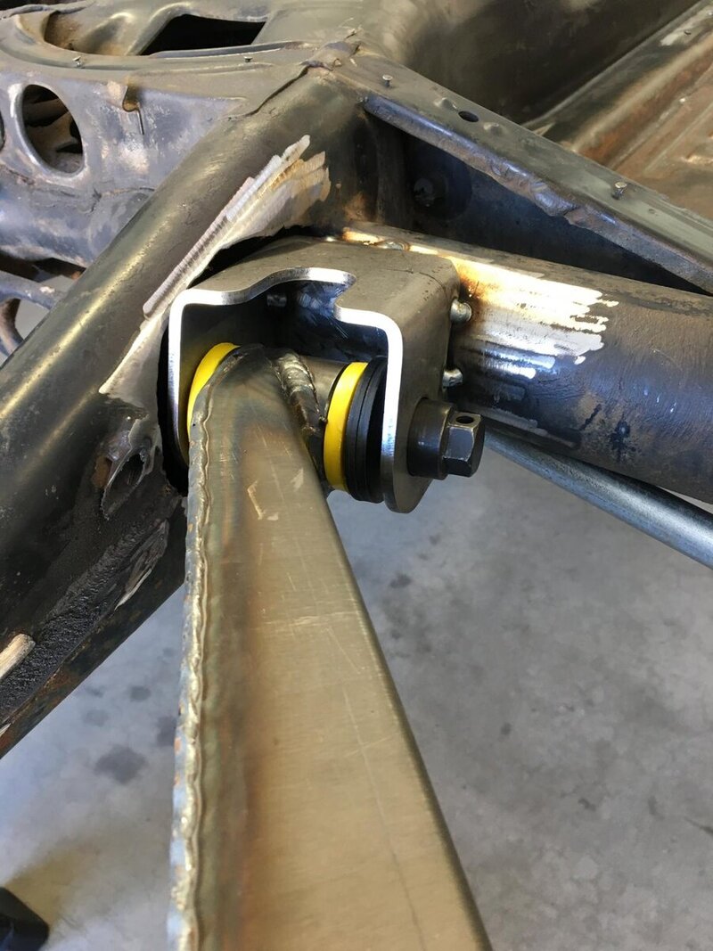

To convert from swing to an IRS.
You need an IRS trans, cv joints/axles.
The IRS trailing arms, spring plates, torsion springs, spring end caps.
All the parts are a bolt on swap.....except for the inner pivot point for the arms. This is the conversion kit spoken of. It is just the pivot bracket but it is a difficult job. You have to cut into the frame horns and insert the bracket into this hole you made while getting it in location and snug enough fitting (no gaps) to weld the bracket into place.
Is it worth it?......Yes
