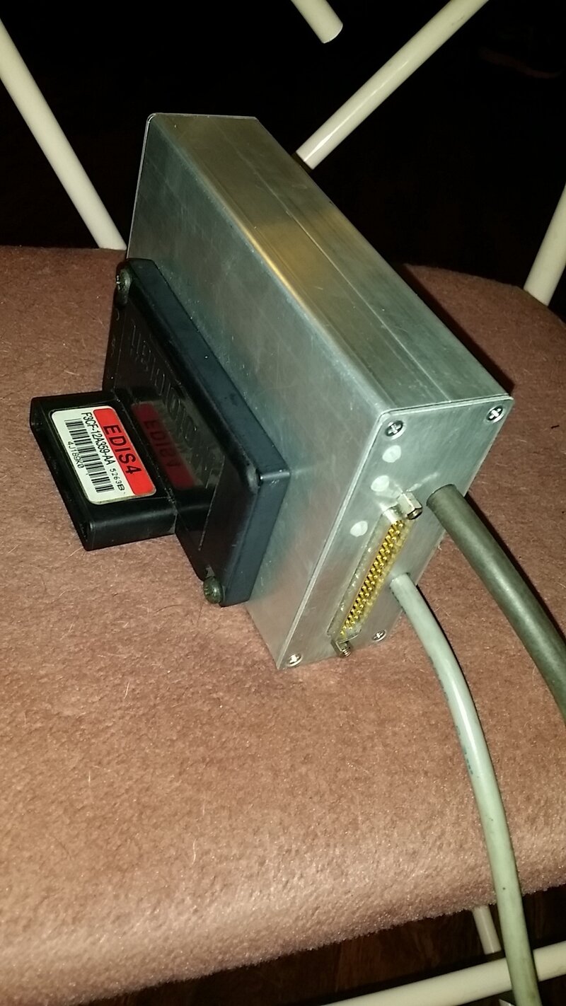

A buddy had the 2.2 board and the Motorola chip laying around from an unassembled kit that was give to him unassembled. All the small parts were missing but it was a freebie. I bought all the parts for the board from digikey key for under 20 bucks.
It is my first non bought controller. It seems to work even with the mods. So at a 20 dollar expense I am gonna give it a try.

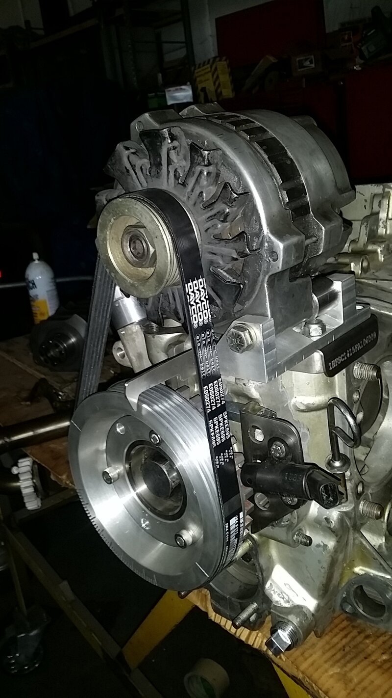

Drawing on a billet aluminum alternator mount to go where the gen stand is supposed to be.

Getting there. Might be putting things together before long. No big frame mods this time, but I gotta get it blasted and painted. The engine has to be built in the frame.
The stretch fit (no spring tensioner) belt came in today.
Hopefully this ends the chance of slinging the belt off at rpm.
