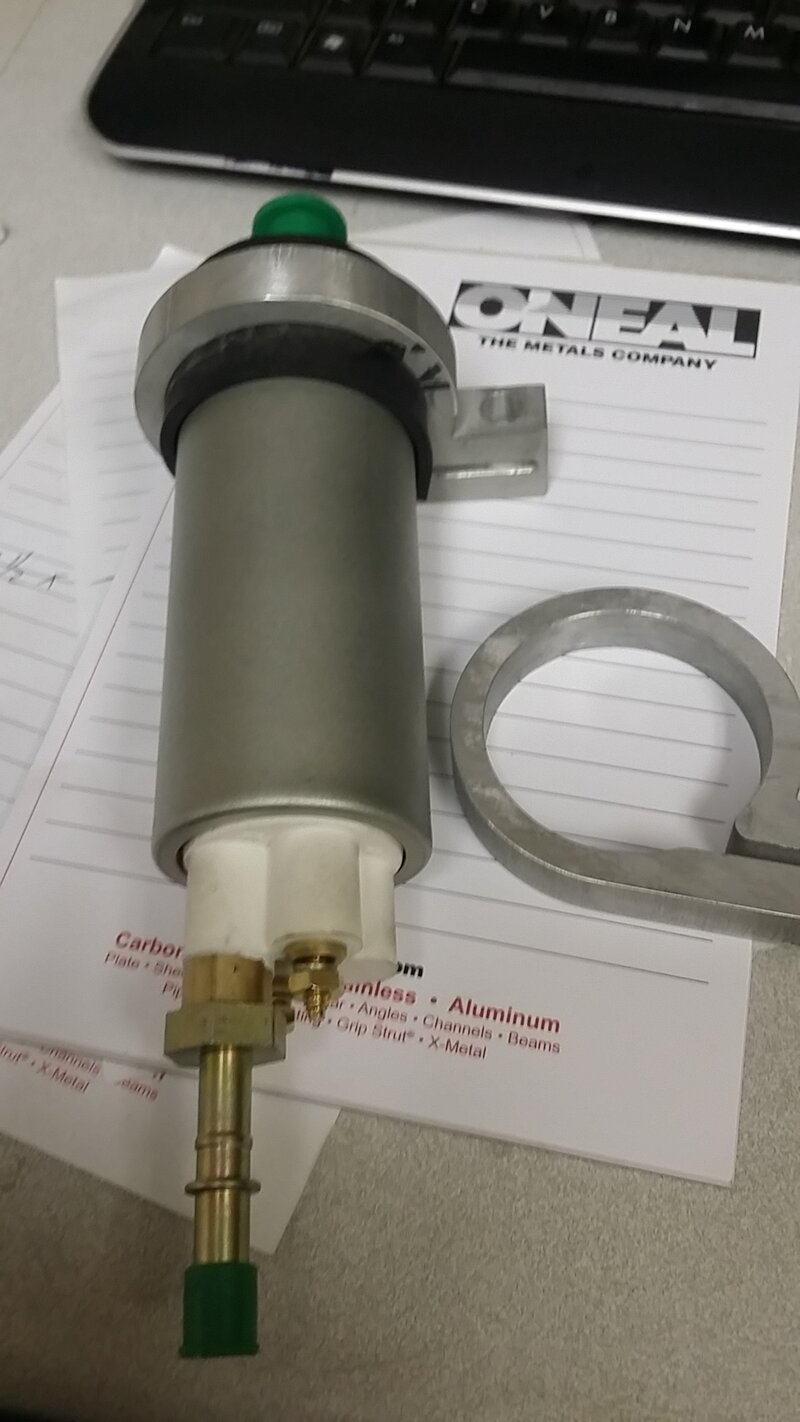

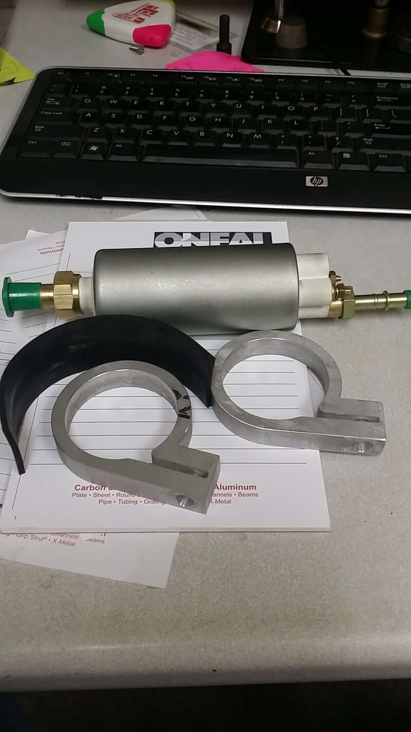

Working on fuel pump mounts.
Whittled these rings out this evening.*
Ford truck outside the tank pump.
Now to find a place to put it.

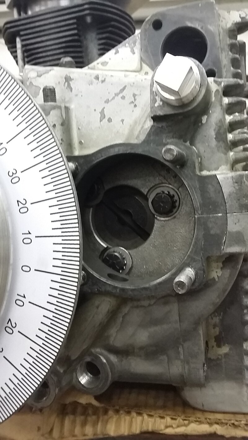

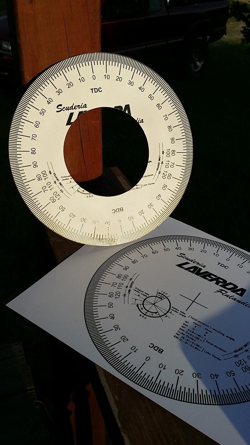

Never could find my degree wheel.
Printed a picture of a degree wheel and glued it to a piece of metal yesterday.*

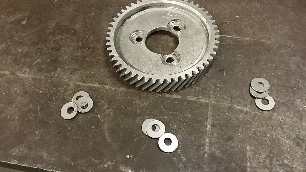

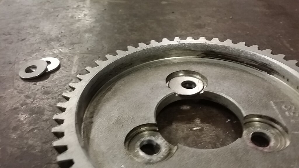

Checked the cam today and it is almost 3 degrees advanced. Wow! All my eagle cams were close to spec, but not this engle. If ya gonna run an engle better check lobe center.
I guess I am gonna be slotting the holes in the cam gear now.
Yeah I checked it several times and at different amounts of lift. Got 2.5 to 3 advanced every time.
I don't have an adjustable gear. I suppose I am gonna turn mine into one though. I don't wanna run it advanced. Want it at the advertised 108.

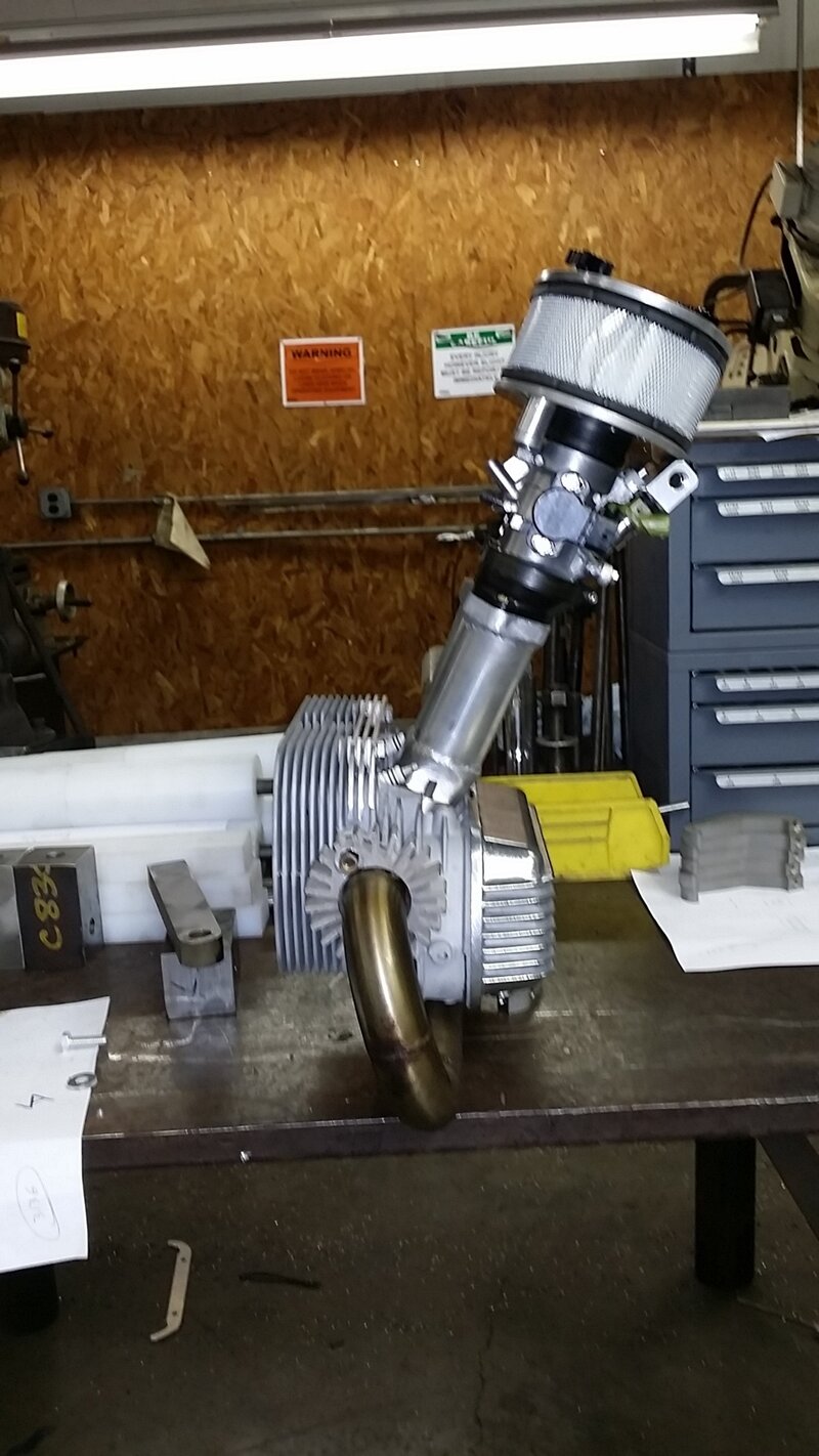

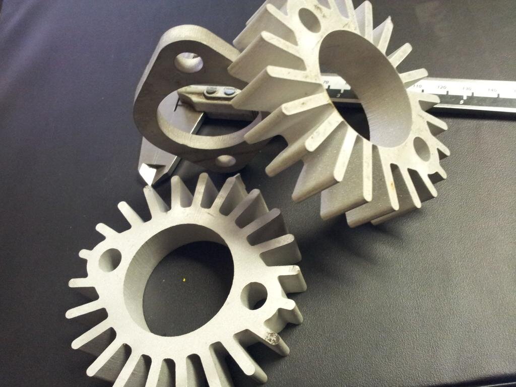

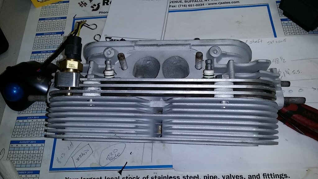

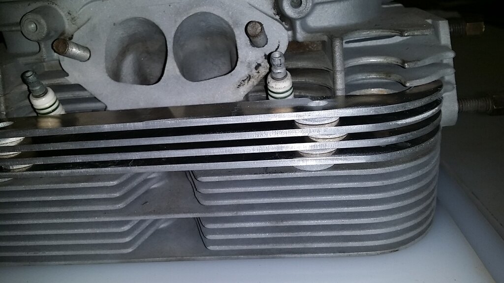

Making some add on fins for the heads.
Any extra cooling is a plus.
Also wanting to disguise the engine. A lot if folks don't know what it is. Would like to fool a few more.
I made these exhaust flange fin rings a while back.
An old school mototorcycle look.
Any other ideas to make it appear different/less identifiable?

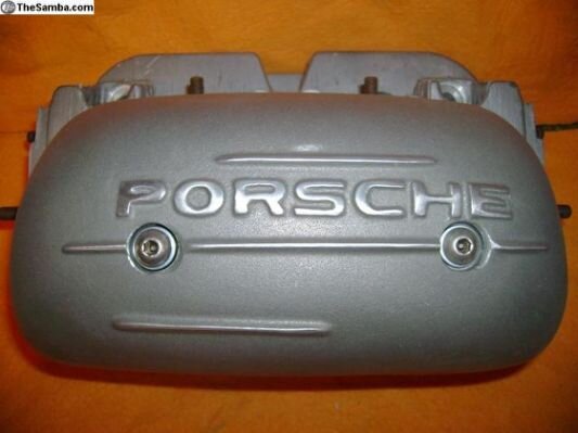

I did do that. I want to vent different and I drilled holes in those.
I searched and searched for something really different for covers. Did find a set of old AeroVee *airplane covers and tryed to get them. But they sold for way too much money.
In the end I got another set of cheap no name covers.
But i sure thought it would be neeto for someone to say "I dunno, look that name up" and come up with an airplane site......lol....still makes me giggle.
There they are.
I looked at these for a long time.
Different but I don't want to be identified as that either. The 4 cam covers fit.
But i sure thought it would be neeto for someone to say "I dunno look that name up" and come up with an airplane site......lol....still makes me giggle.
There they are.

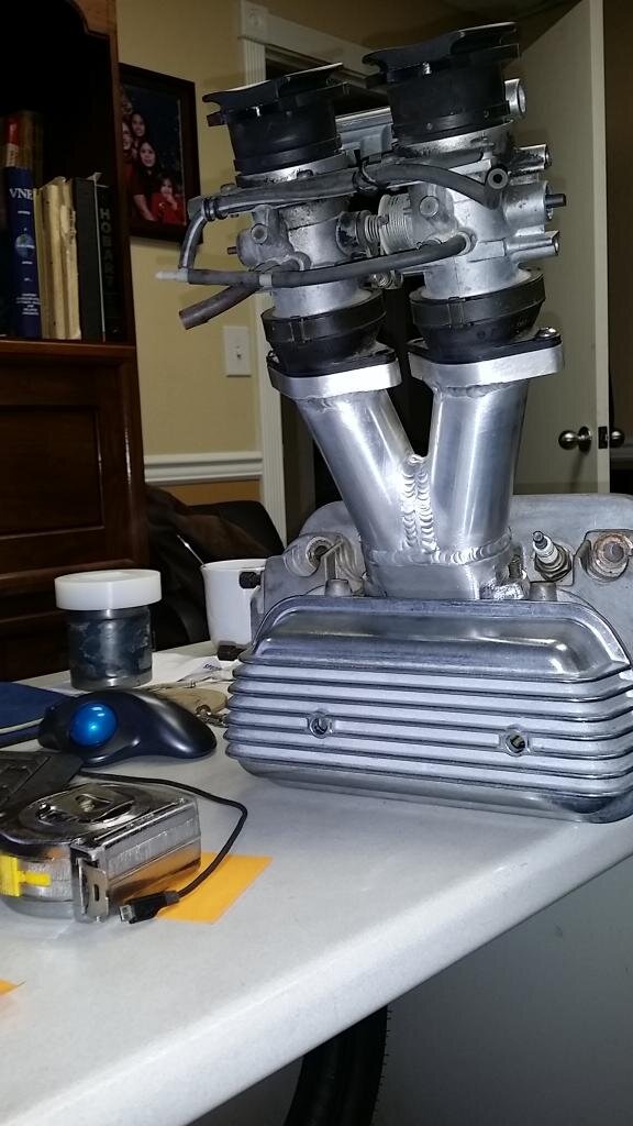

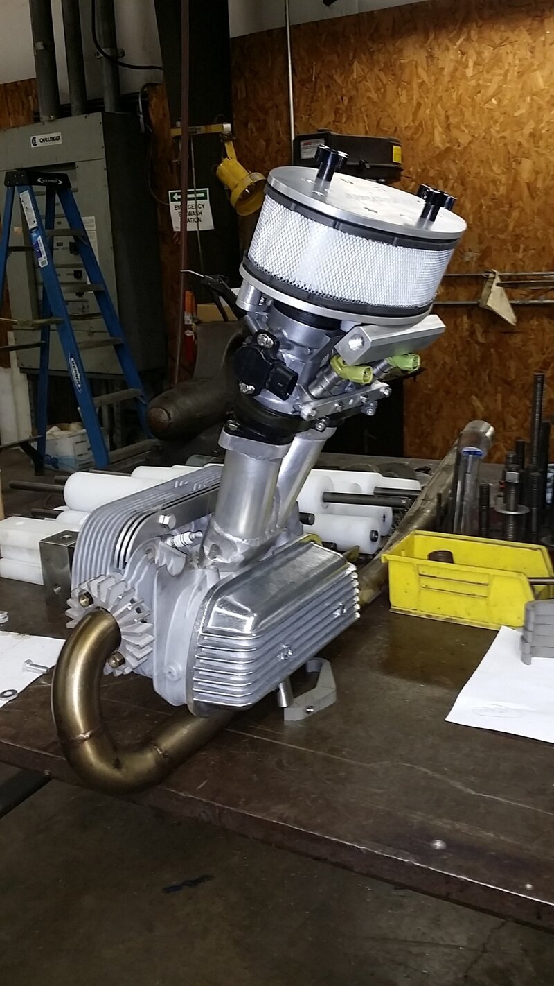

Some of the mock up.
Just had to see what it is looking like.

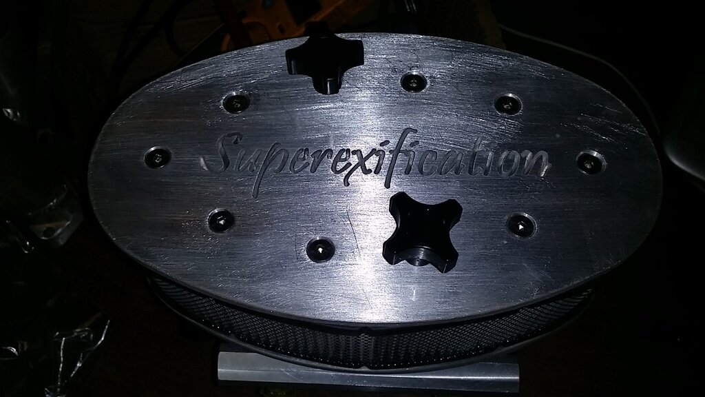

A few know my name ... they might get the tag on the filter lid. Still not confident about it. Was gonna be just SupeRex.

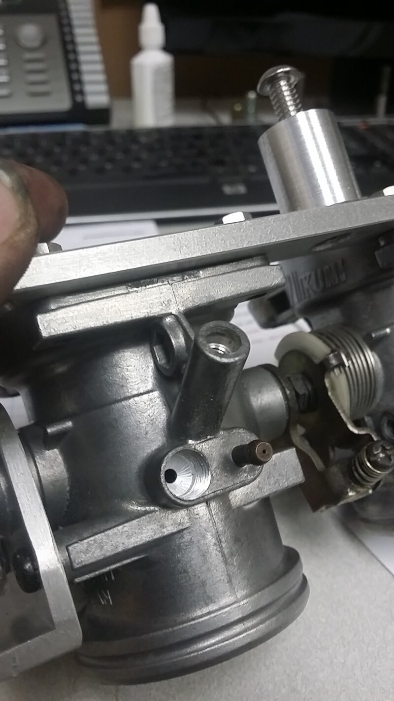

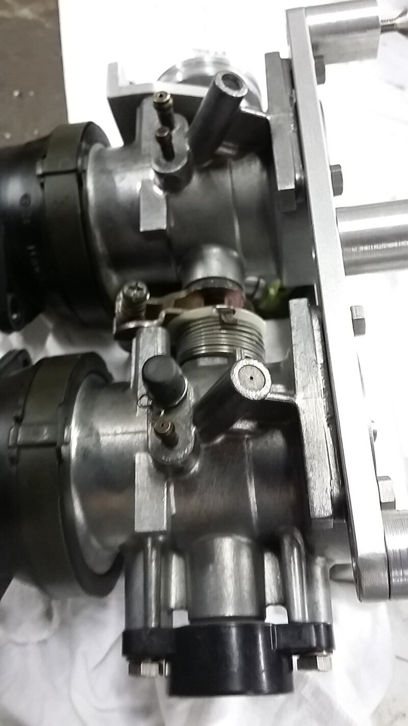

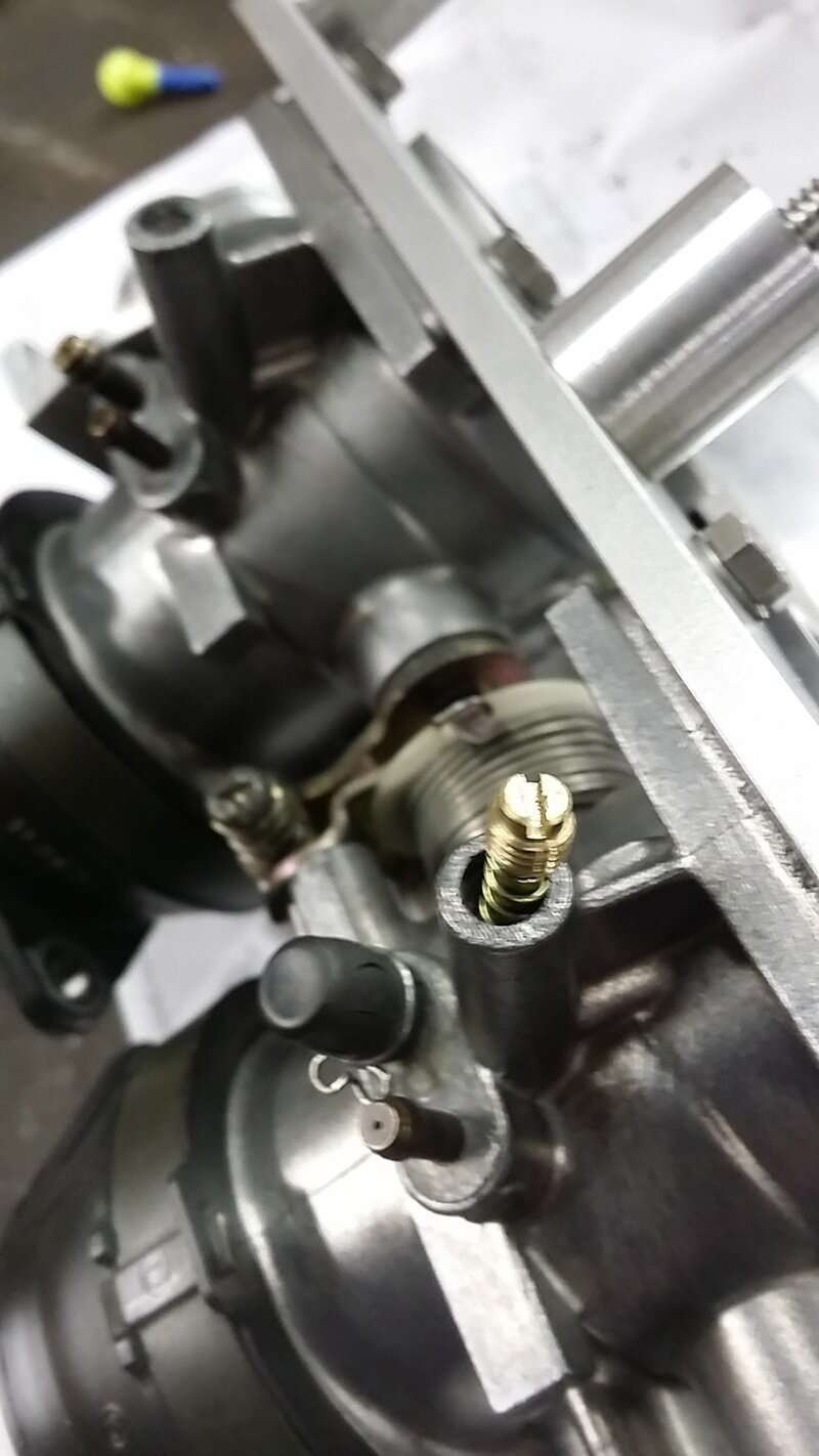

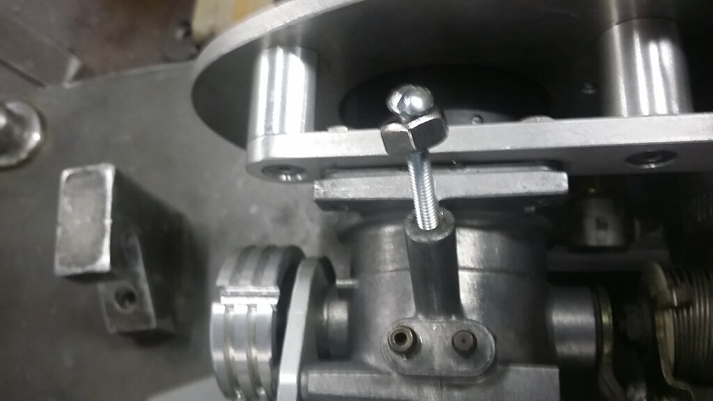

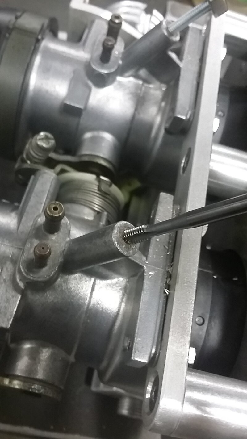

Next up is idle air. I have the big motorcycle throttle bodies and a Ford Mustang air valve. I have the controller built and can pwm the air valve. So now working up just how to hook a Ford air valve to motorcycle throttle bodies on a vw engine.

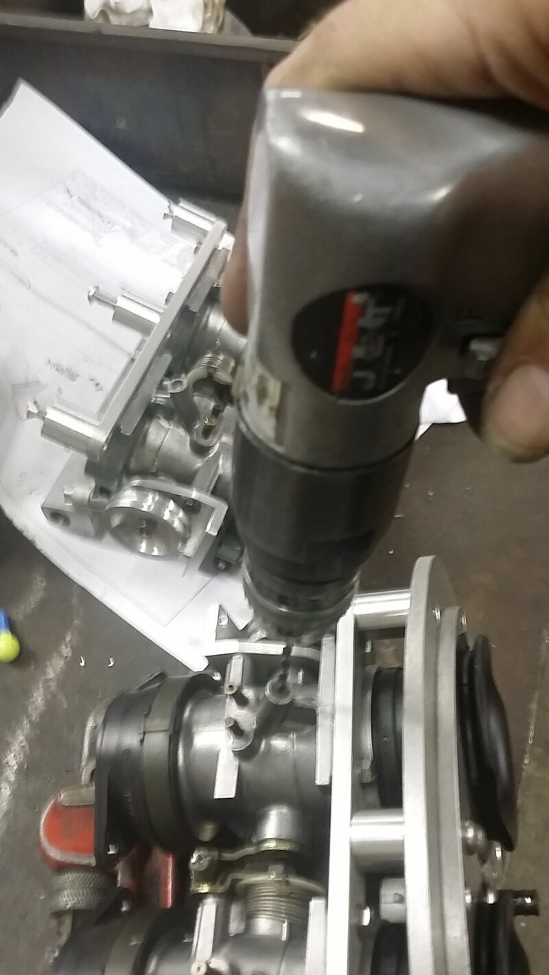

Looking at the bodies and wondering why they have no adjustments for idle air.
Then start wondering what this boss is ....
So....
Why not drill a hole in it?
Thread it.
Put a screw in it and hive it a pull.
Guess what's in there?
An idle air adjustment needle.
Dang things where not meant to be adjusted on. Non serviceable, or so they thought. They put a pressed in plug over the screw to stop me.....lol
Pulled all 4.
Drilled and tapped 2 of the ports for tubing fittings.
Going to have tubing from the ford air valve into each throttle body. And it is adjustable.
