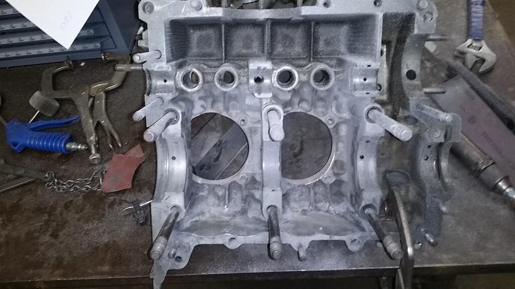

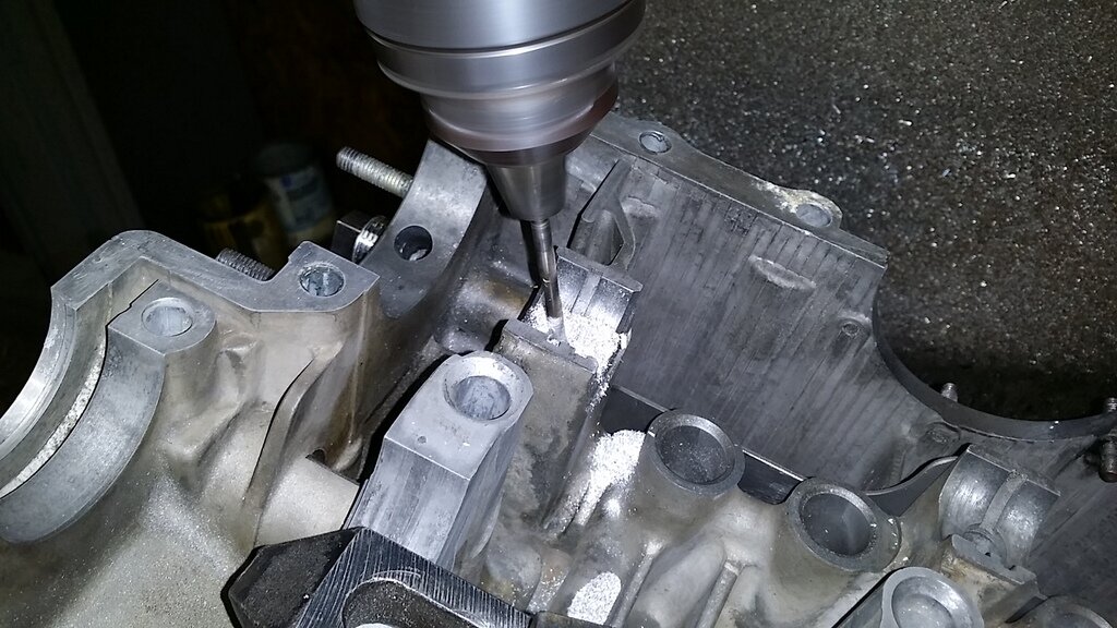

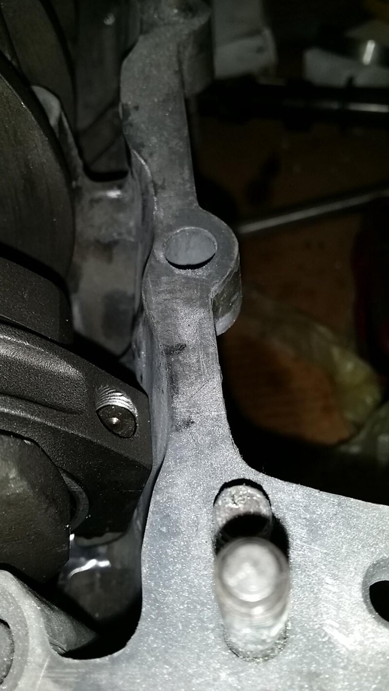

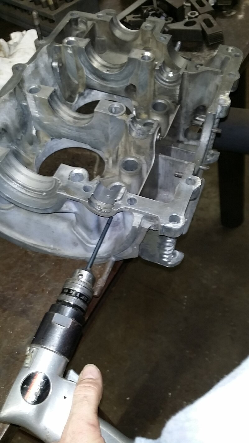

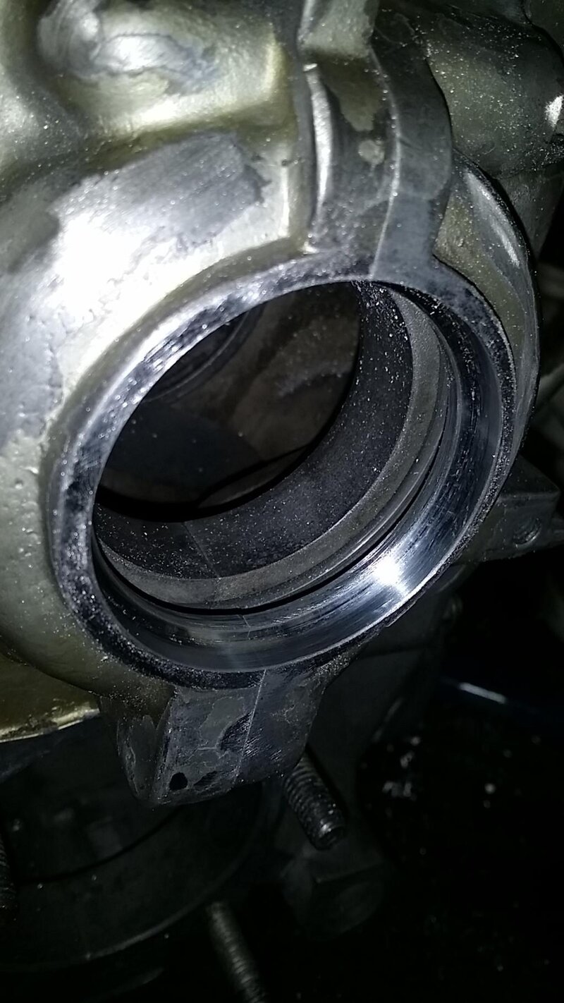

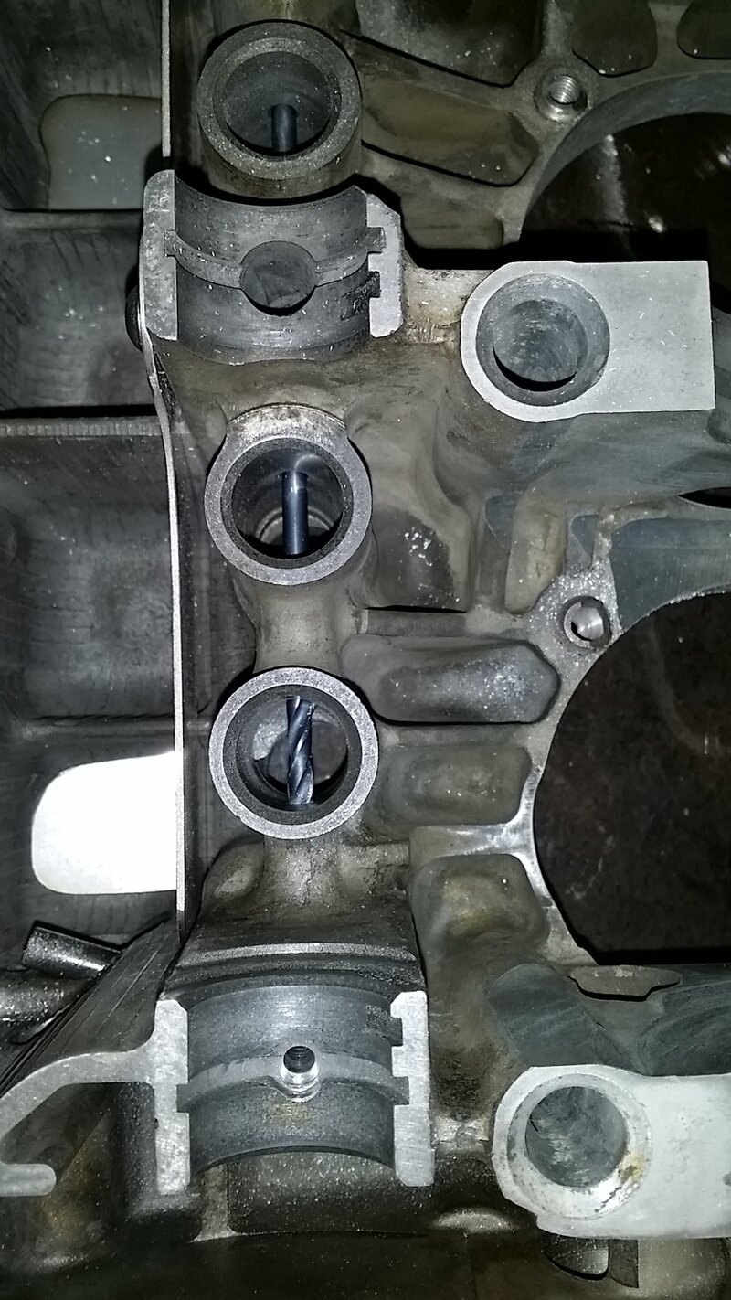

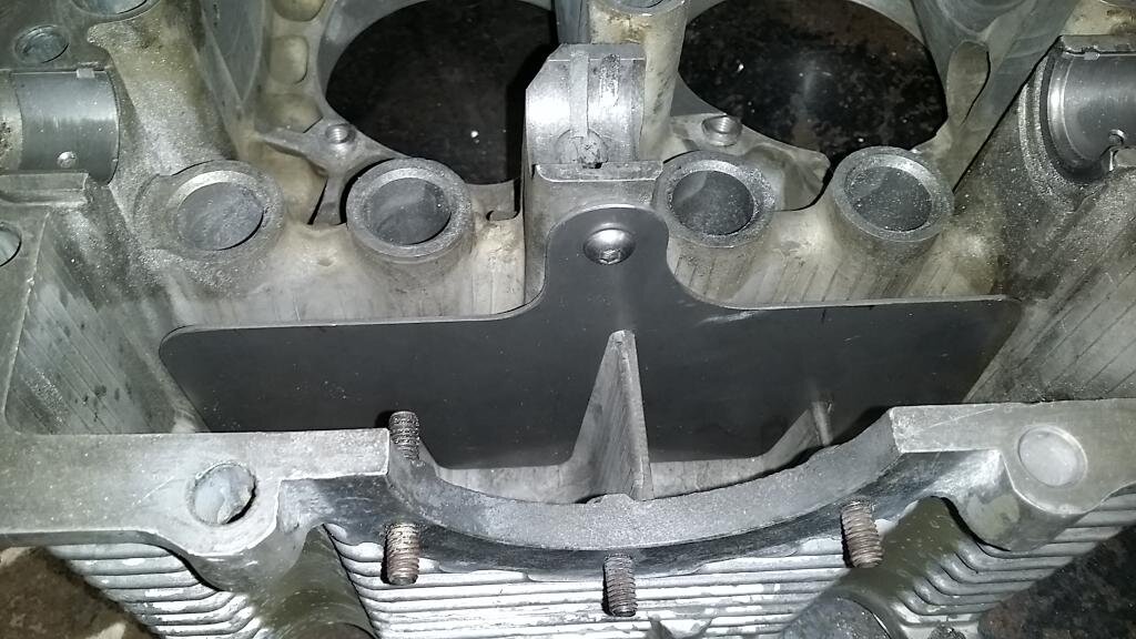

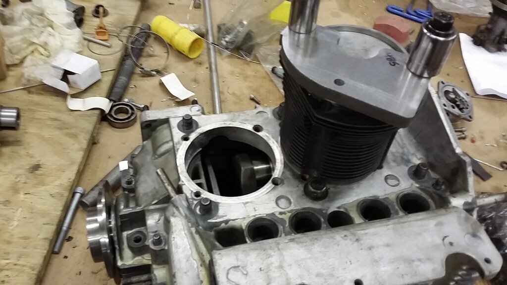

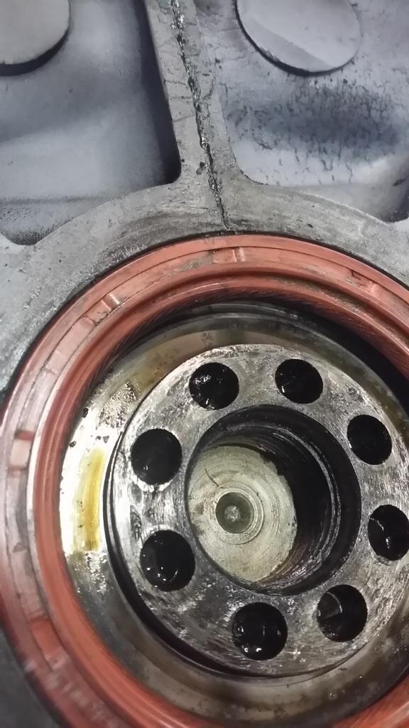

So the 2387cc stroker motor is coming along. Had to do a lot of milling and grinding to make room to swing the big crank. Cut the case for a lip seal on the pulley. Made a two piece bolt in windage tray. Stated on a plug to block off the dizzy hole.

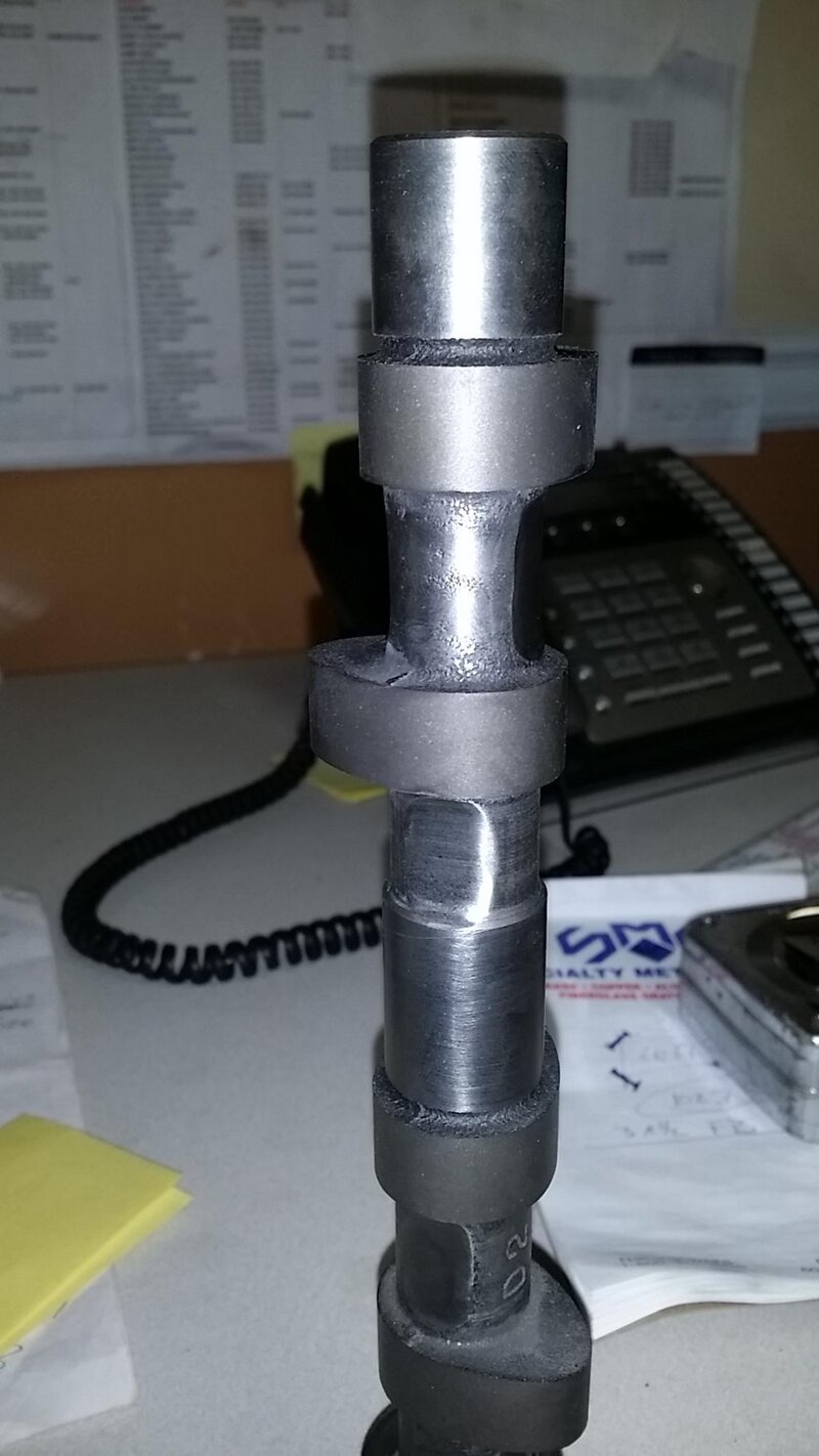

Even had to cut notches in the cam to clear the stroke.

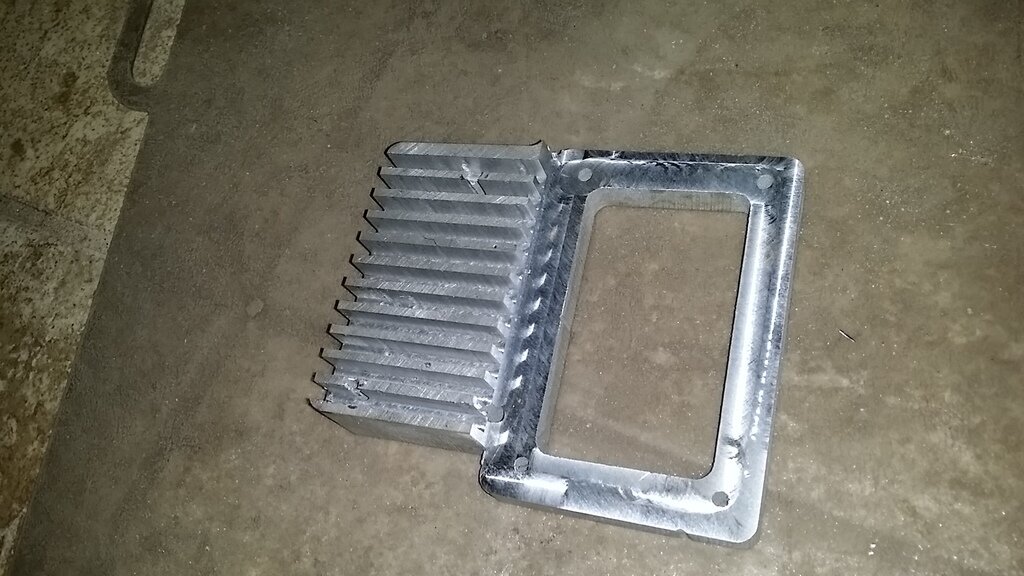

I made a little baffle plate to cover the distributor drive area. My pressure bypass is in the gear cavity area instead of right at the push rod tubes.
Hoping the baffle will keep the oil from flinging out the fuel pump and distributer holes.
Moved the oil Porting around in the case.

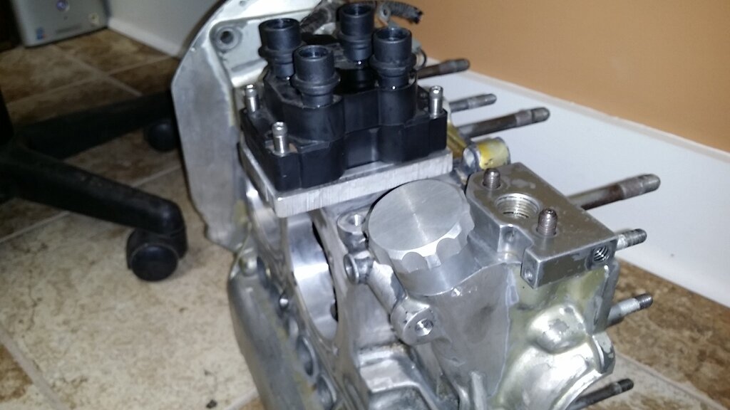

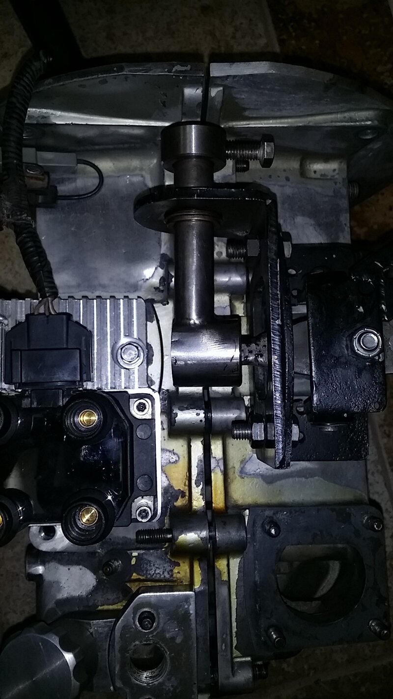

Then started whittling on a coil mount for a Ford coil.
So now the distributor hole is the oil filler.
The fuel pump hole is the crankcase vent and the oil cooler mount is now the coil mount.
Checking the shifter clearance.
Looks like it will clear the coil.

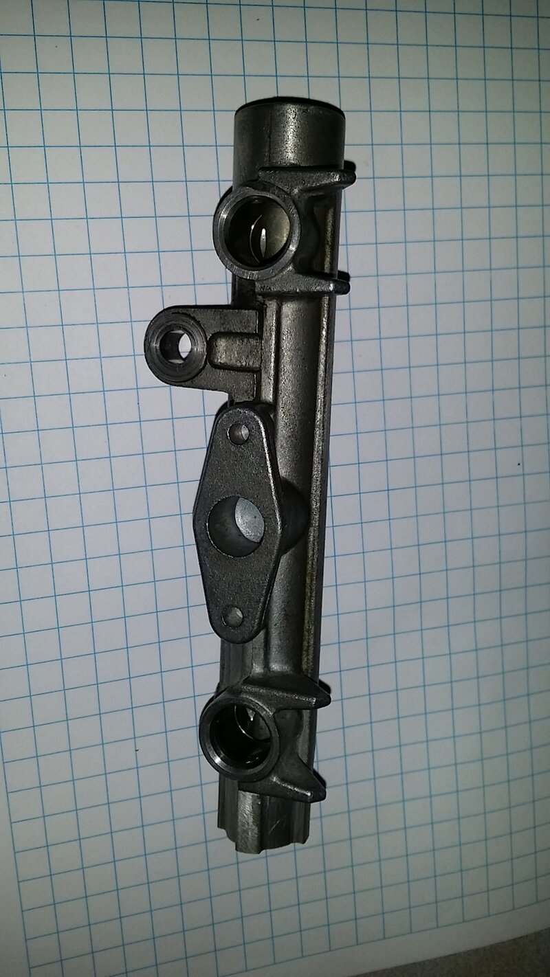

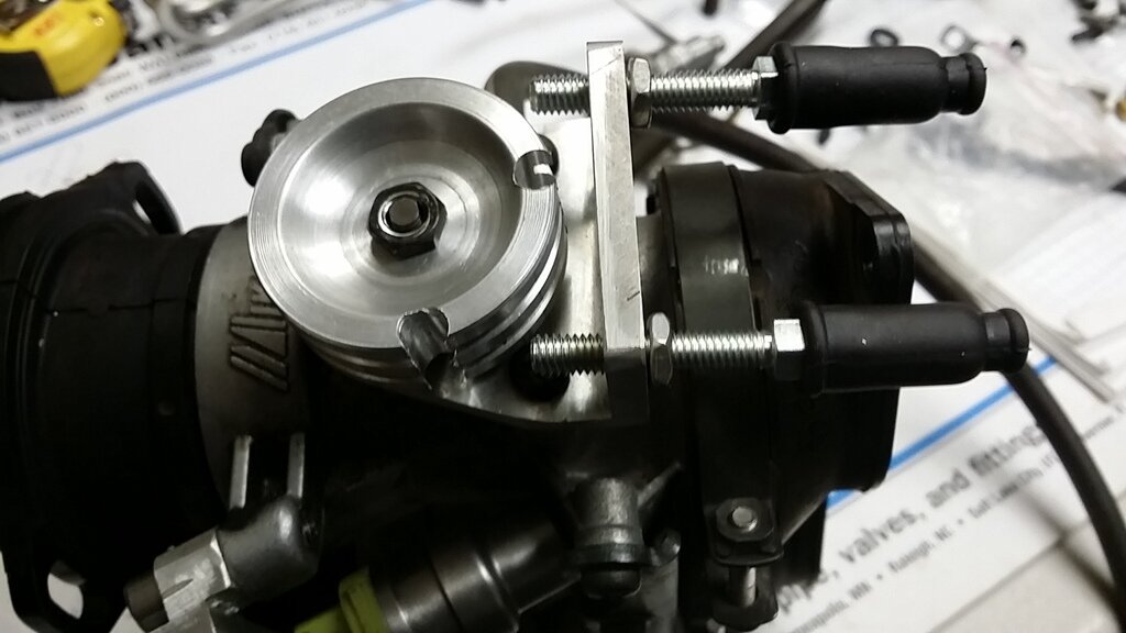

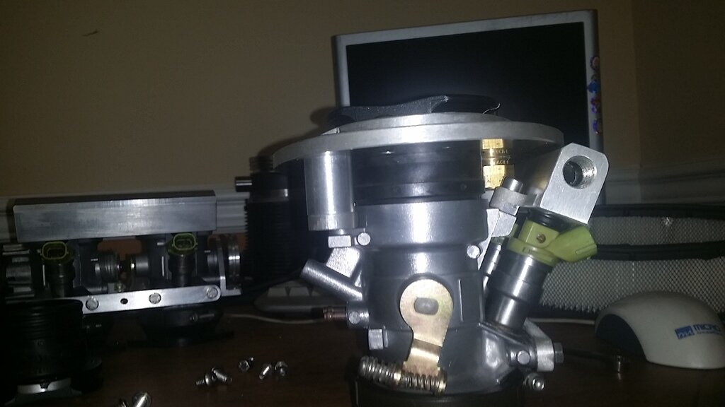

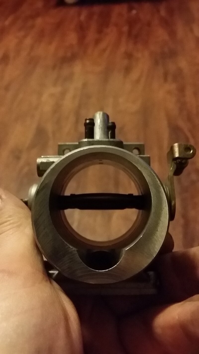

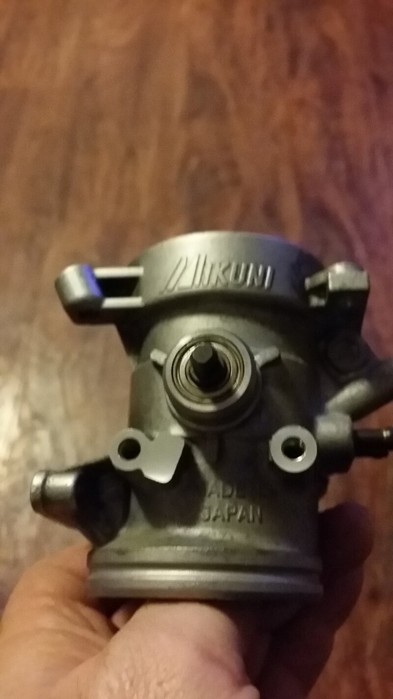

The 4 in a row throttle bodies I cut into pairs are all the same casting. Just machined or not in all the places. So all I had to do was machine in the bosses for a place to put some throttle linkage.
Then machined the motorcycle throttle bodies to fit automotive injectors.

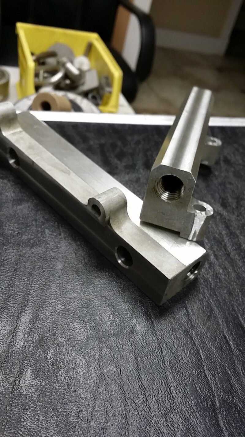

Then went to machine the fuel rail, but decided I did not like the way they turned out.
So i started over from scratch on fuel rails.

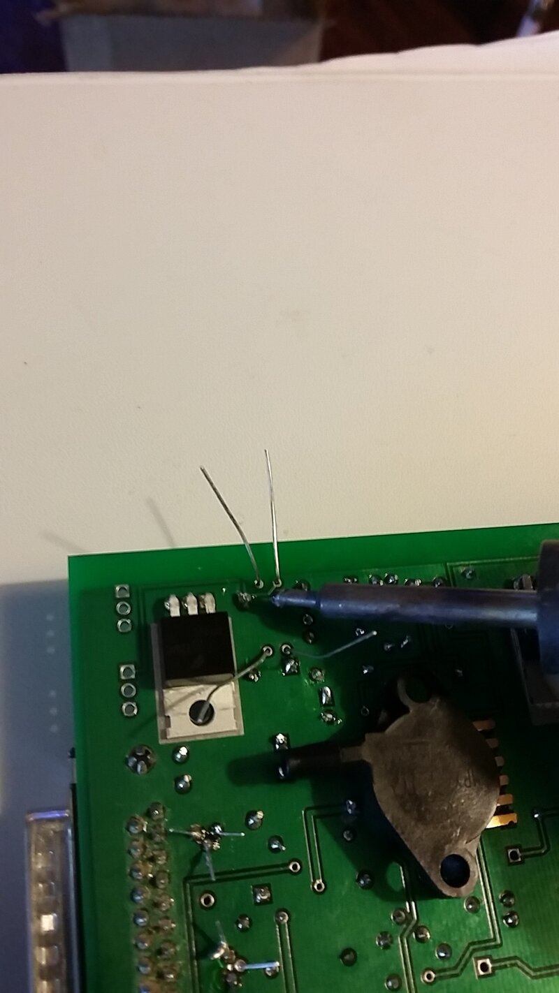

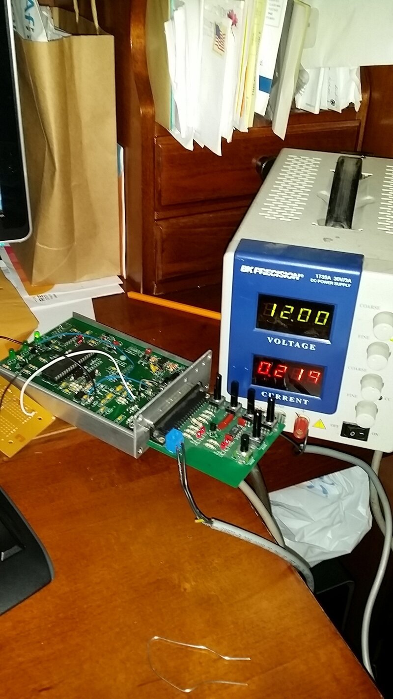

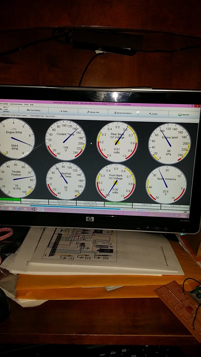

Took the box of electronic goodies.
Soldered up the board.
Powered it up and loaded some code.
Had to do some troubleshooting. I had a transistor soldered in backwards.
Got it sorted and started writing map tables.
All the inputs and outputs work now.

Whittled out a set of fuel rails.
Started on some linkage. Going to use cables this time instead of levers.

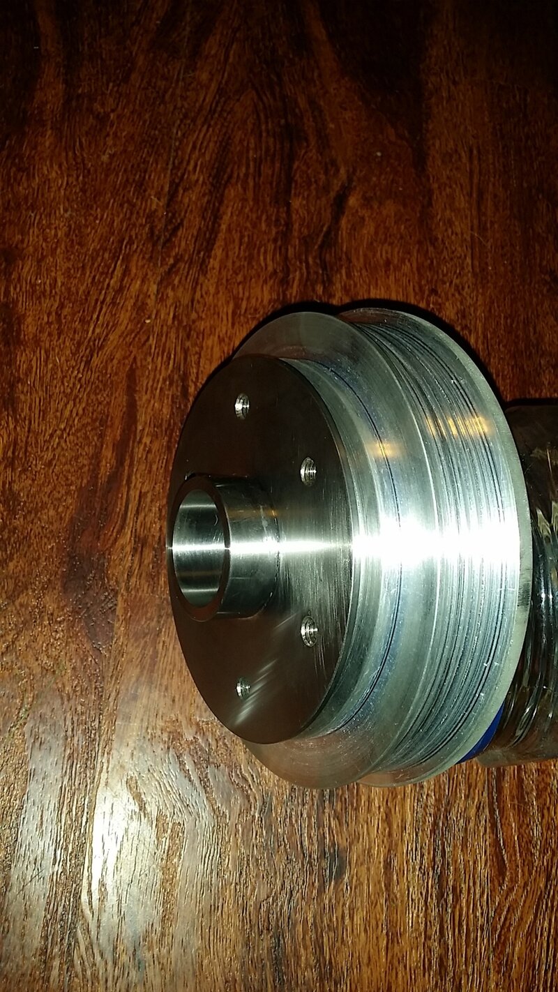

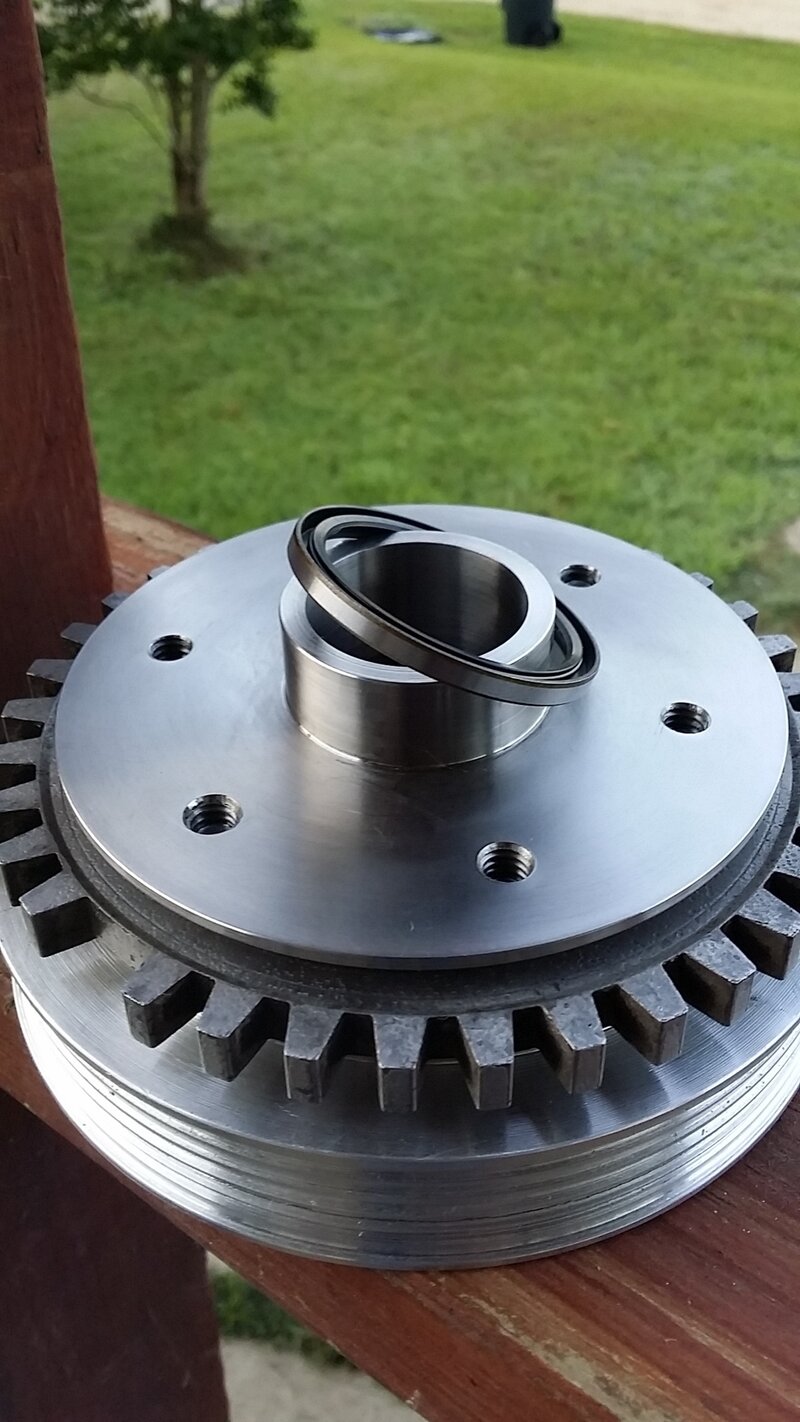

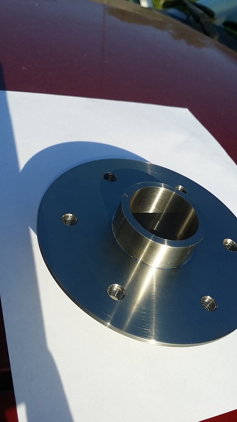

Starting on the pulley hub to adapt a Ford crank trigger to to it.

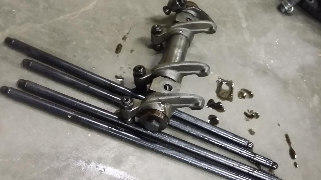

Yea, I am still wondering on the rocker arm geometry. Running the 1.25's with the 110 cam I am not sure if I am going to have to shim up the rockers to get good geometry.
Most all of the new rockers are the type with the adjuster on the push rod side and the curved face on the valve side.
They all take custom length push rods and or shimming. Most even take some shimming side to side to get aligned with the valve correct.
I am running 5.5 inch "chevy" rods so my deck hieght is tall. My push rods are long. Also running 050 heads and the rocker pad is not to stock dimension I hieght.
I have a stock length set of Chromoly push rods and hoping I can use them. Being just a stock height on the heads I am thinking I can just use the shims.

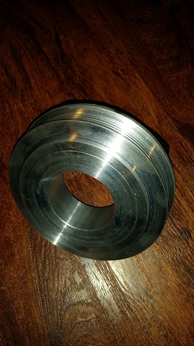

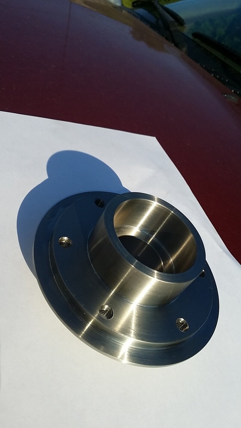

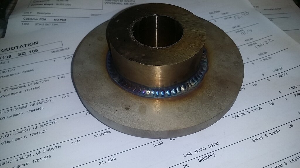

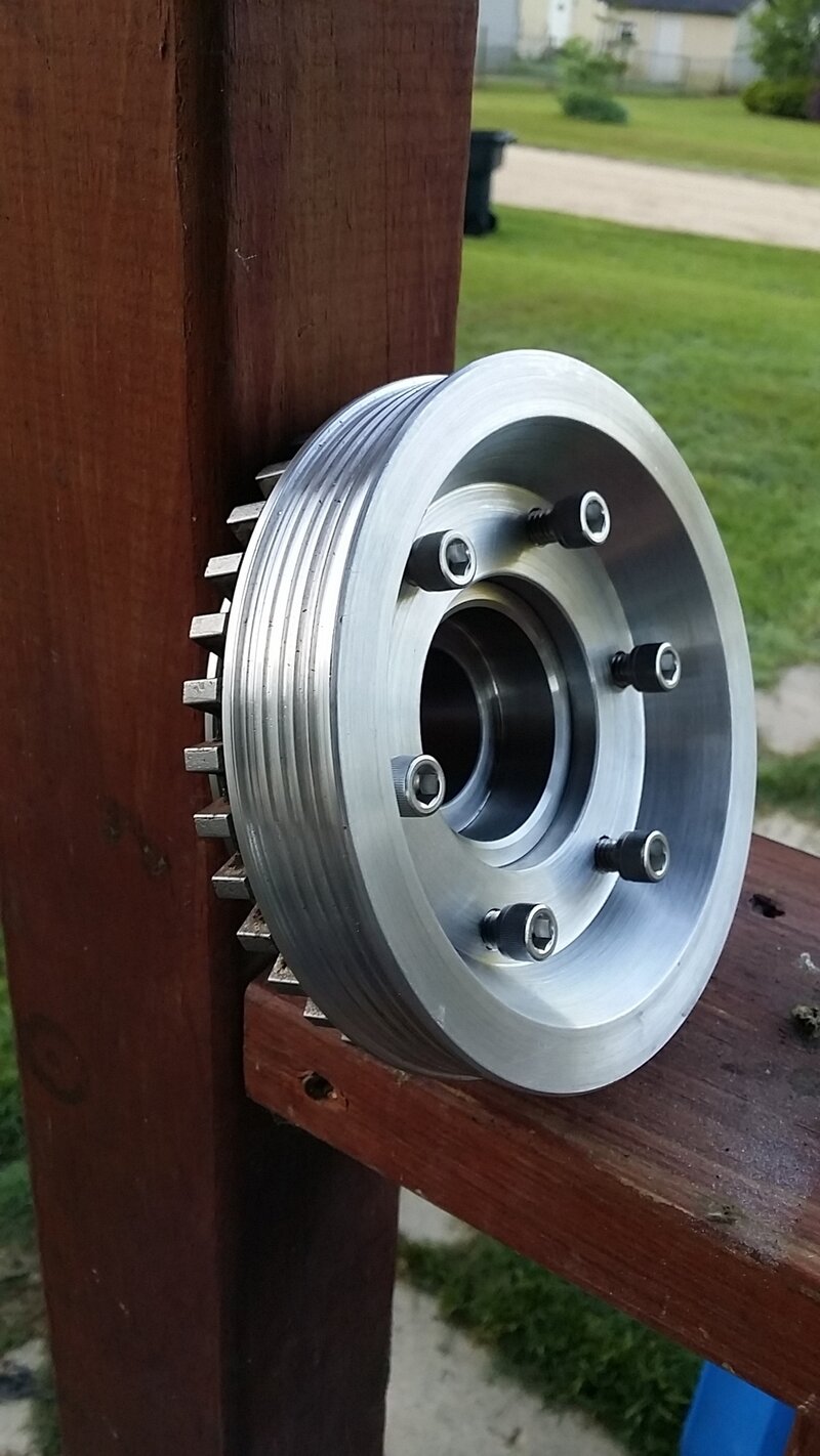

Whittled on that hub an hour or so this evening.*
Still not done.
Why is it I hafta make all my own parts?
Ya do what ya gotta do to make all the parts you want to fit together.
Still have a good bit more to go, especially on the front end.

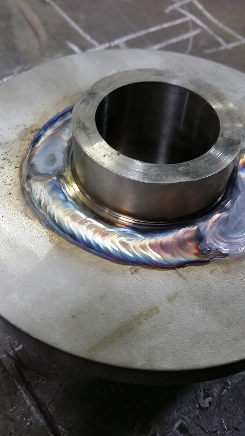

Have most of that pulley made.
Mocking up the bottom end again.
It has been lightly assembled so many times now.
I am gonna check the cam lobe center degrees. I am hearing that the engle cams are bad about not being to spec. I always ran the eagle cams "straight up" as in exactly like the cam card. But they are spec at 107 degree which is fairly advanced. The engle is up posed to be 108 degree and is what I want now. But i hear that their qc is poor now and it could be anywhere up to 5 degrees from spec. So i gotta find out.
Pulley.
