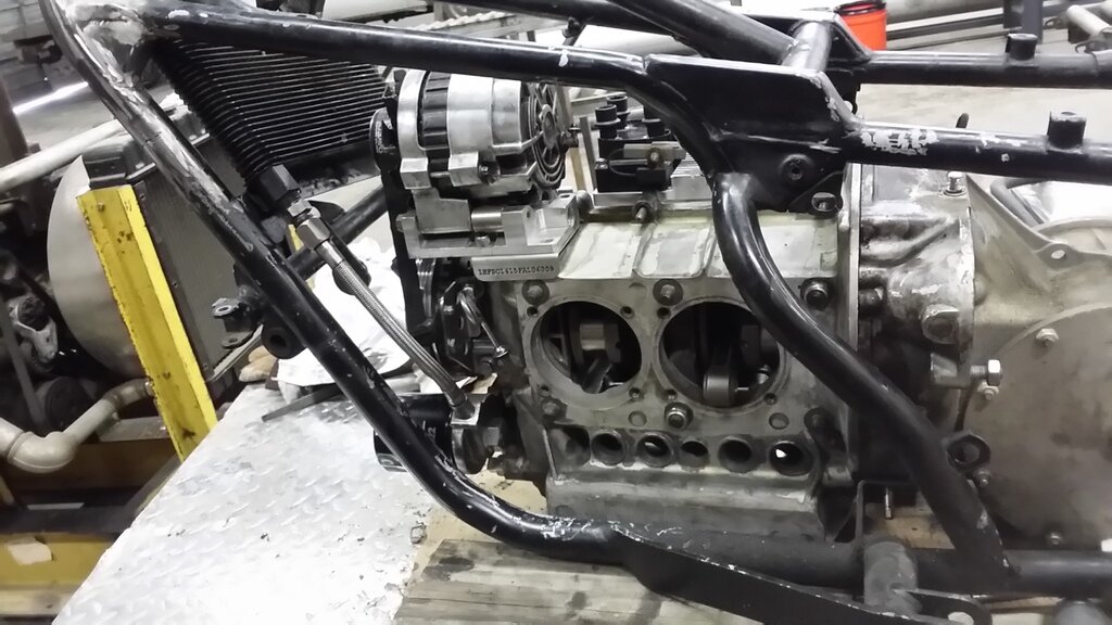

Not much new going on. Have been so busy with work.

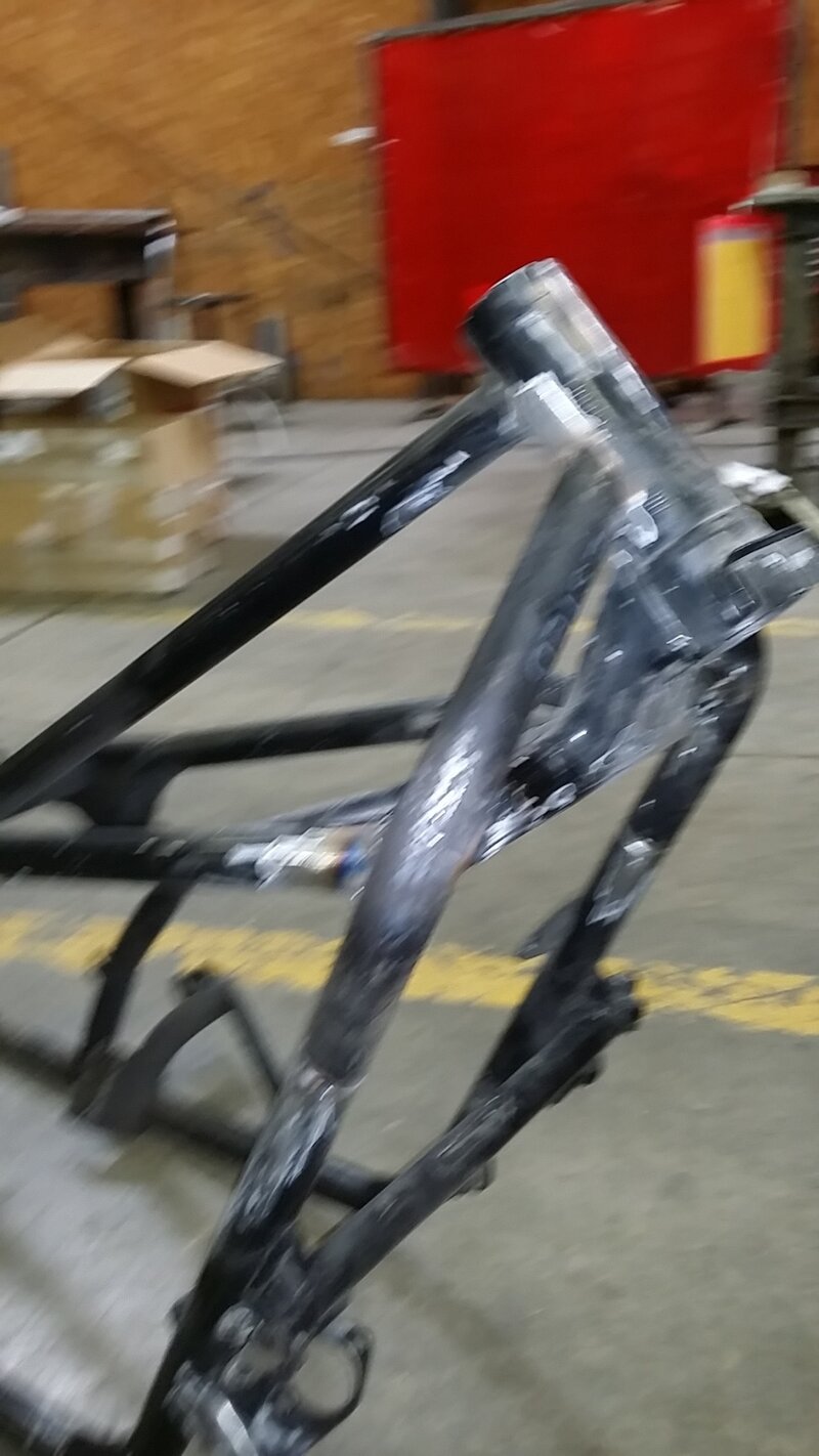

But before I blast and paint the frame I am gonna change this joint.
This odd angle kinked joint has always bugged me.
Cutting it out and fitting a radius bend.
Made plugs for the joint.
I have one side cut out, fitted and tacked in. Once I weld it up I will cut the other side.
Frame has many joints and plugs already.
Both sides in and partially welded.
Now to get some good welds on it then some gussets.
I think it looks better with the radius.*

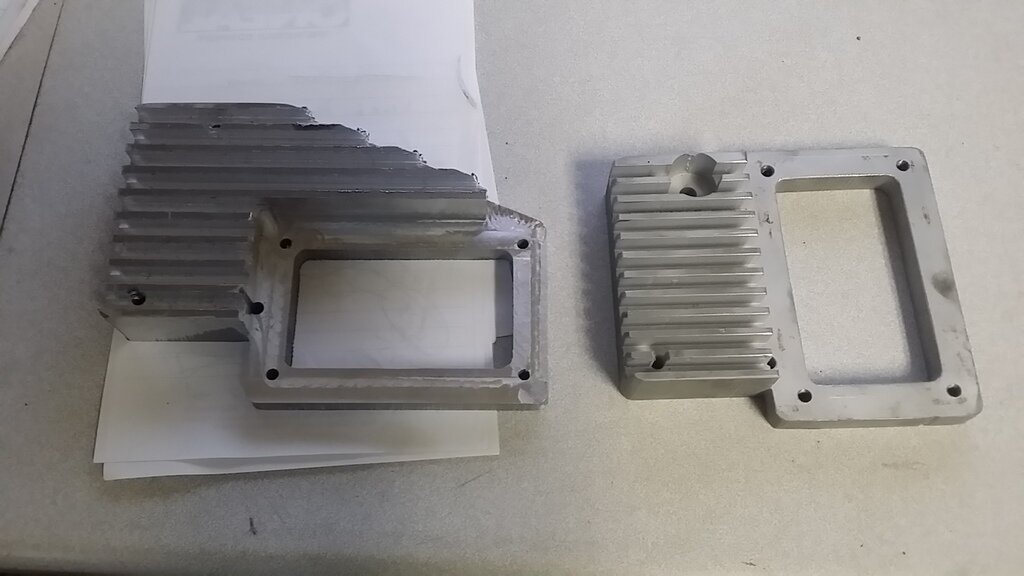

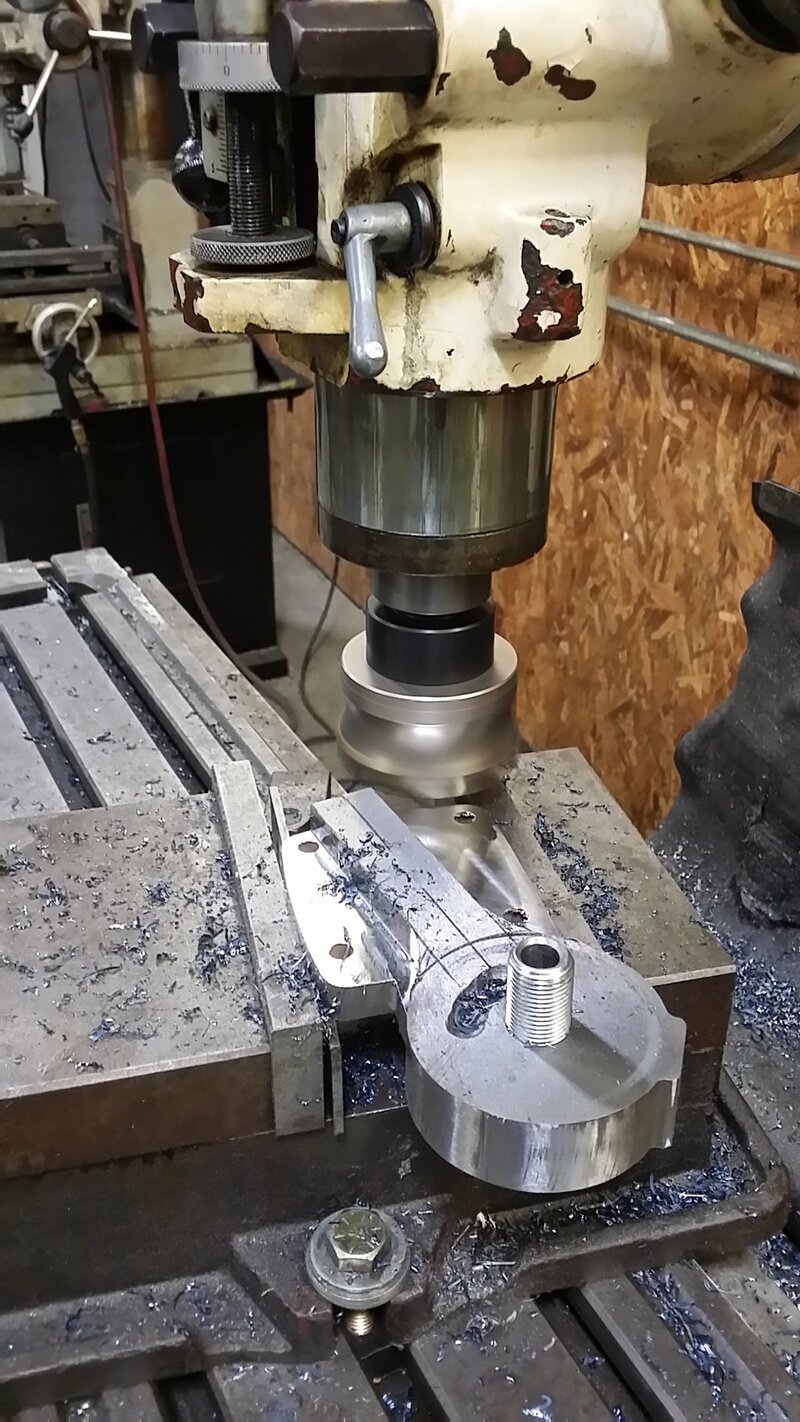

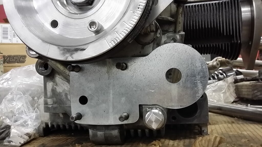

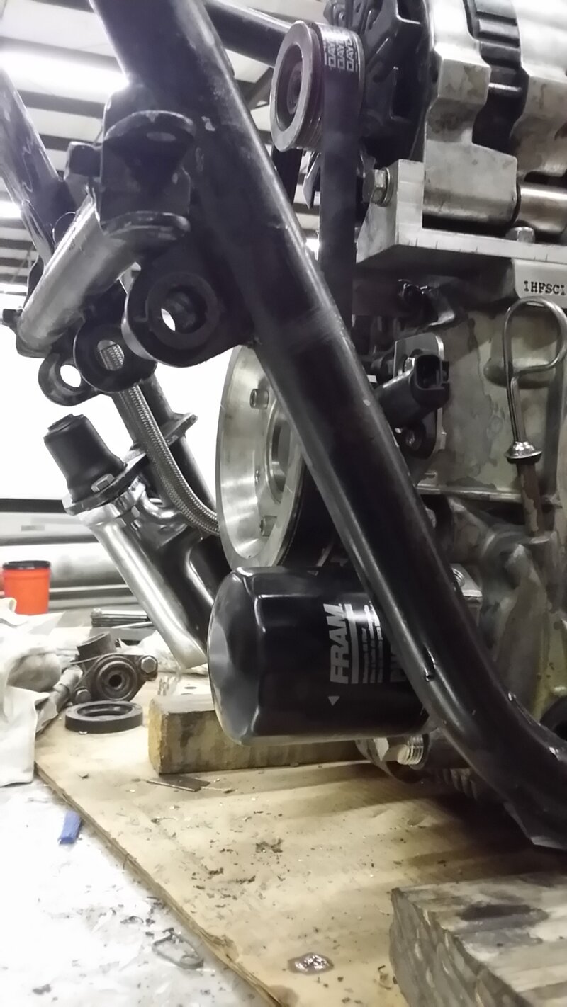

Trying to design up an oil pump cover with the filter in a place that fits for me. Cut a couple sample patterns and just not there yet.
I have plans for where the remote filter was. So now it is going to point out from the pump cover.

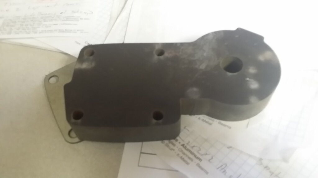

It will look some like this. This is just a profile template to find the place the filter will fit. Not much room to work with. The brake master cylinder is on the opposite side mounted on the frame.

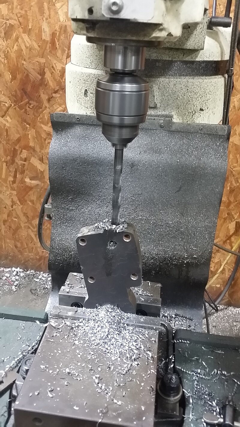

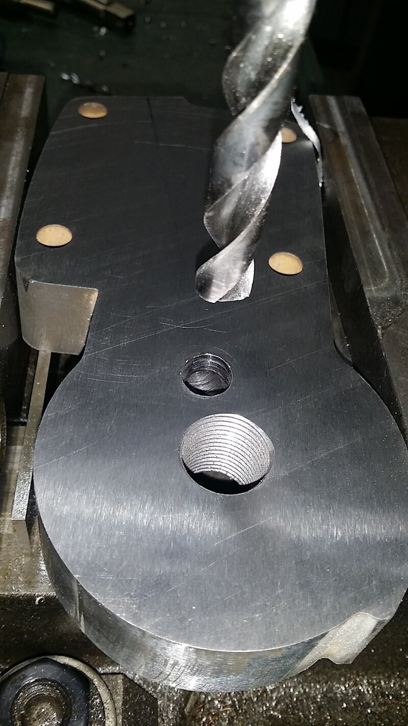

I will cut this shape out then do all the oil passages and other mill work on it.

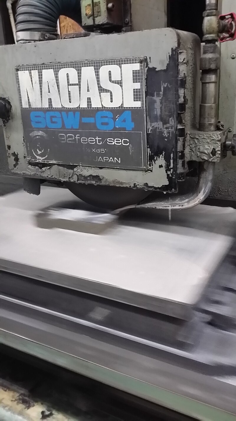

Whittling on it.
It is now functional.
But i am gonna whittle on it a bit more. Make it look better and loose some weight.

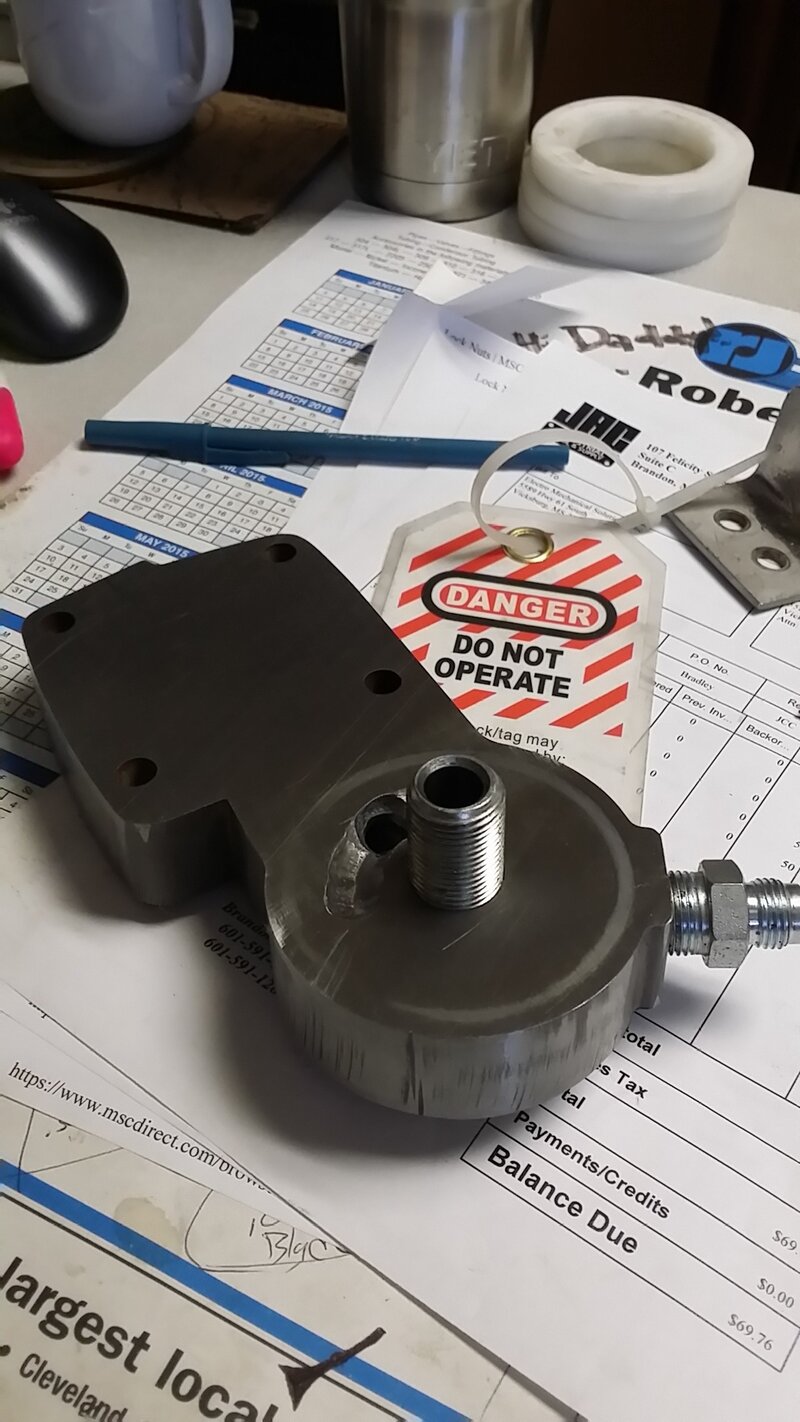

I went with steel.
Hoping to maintain better clearance in the pump. Trying to get better hot idle oil pressure. If I can I will run a lighter weight oil.
Eventually it will all come together.

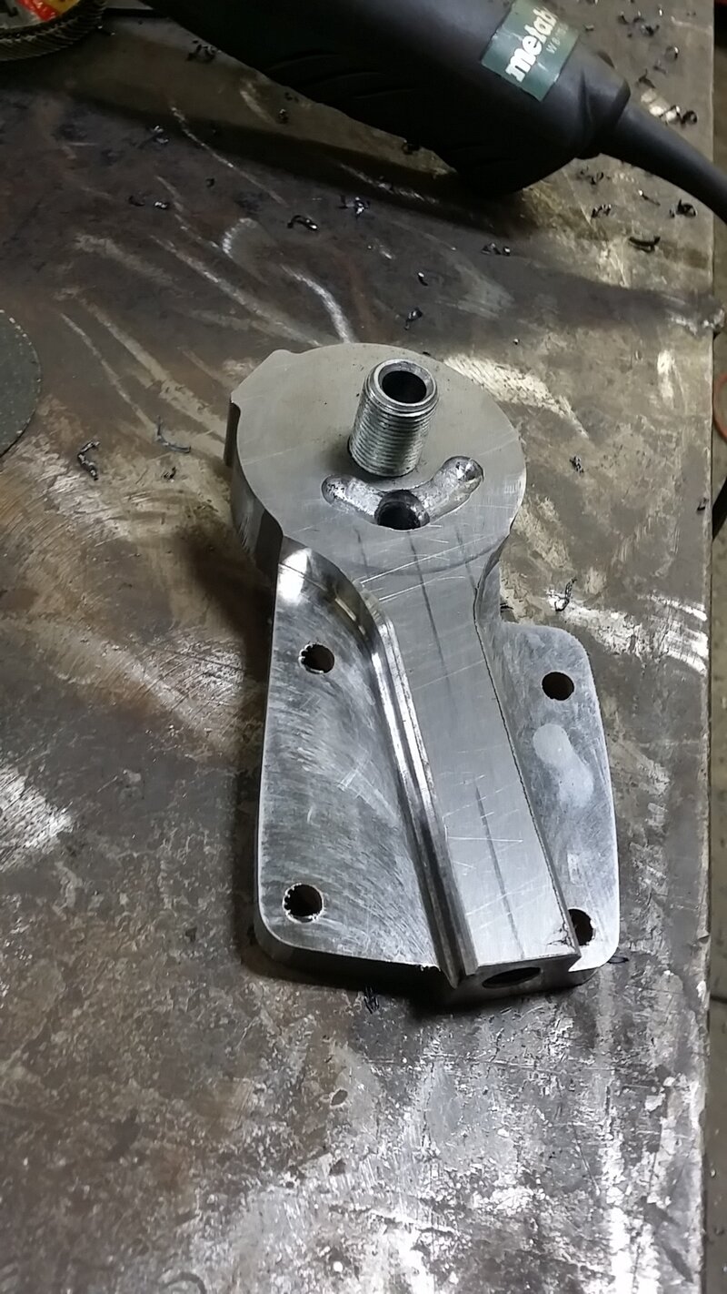

Cut a little weight off the back area behind the filter.

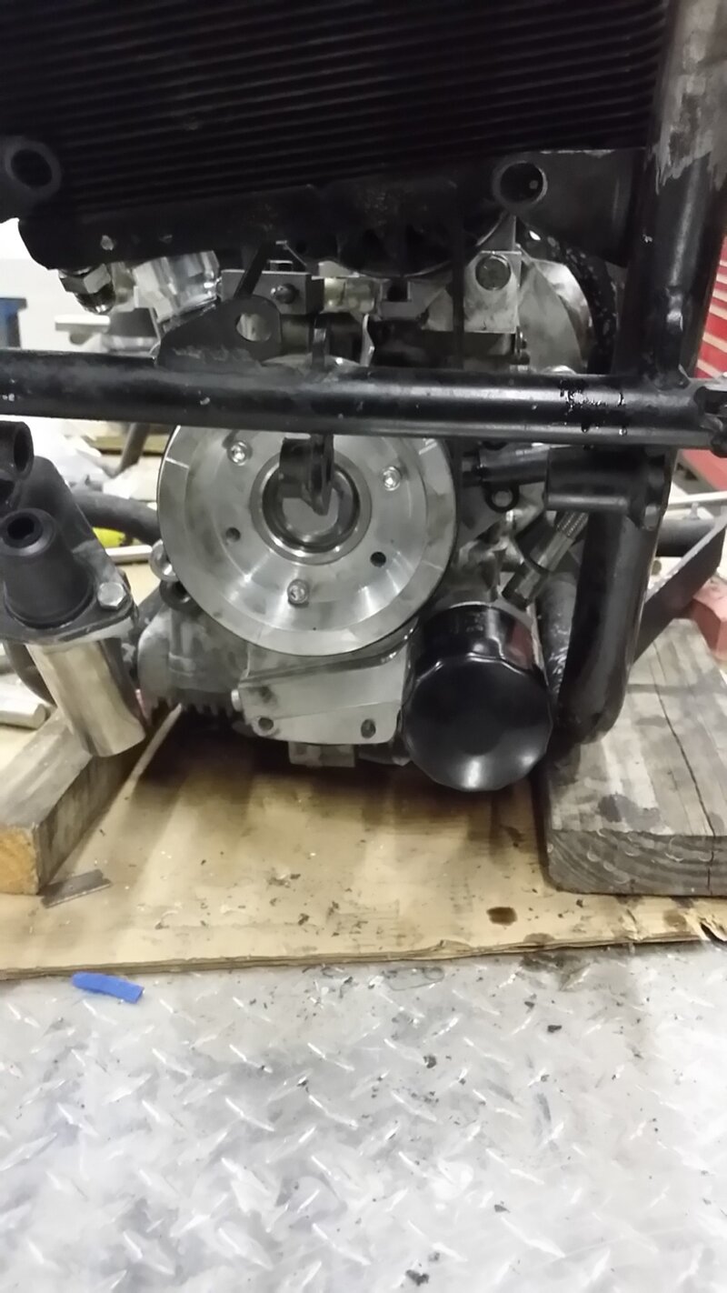

Here it is.

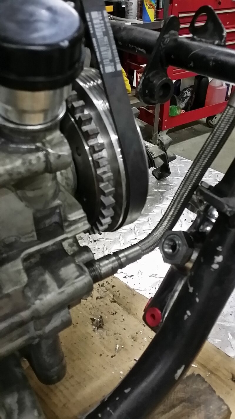

Pump straight to filter and then out the top fitting to the cooler.
Still gotta plug the oil hole in the case where the oil is supposed to be going. Then drill and tap an external entry into the oil gally.

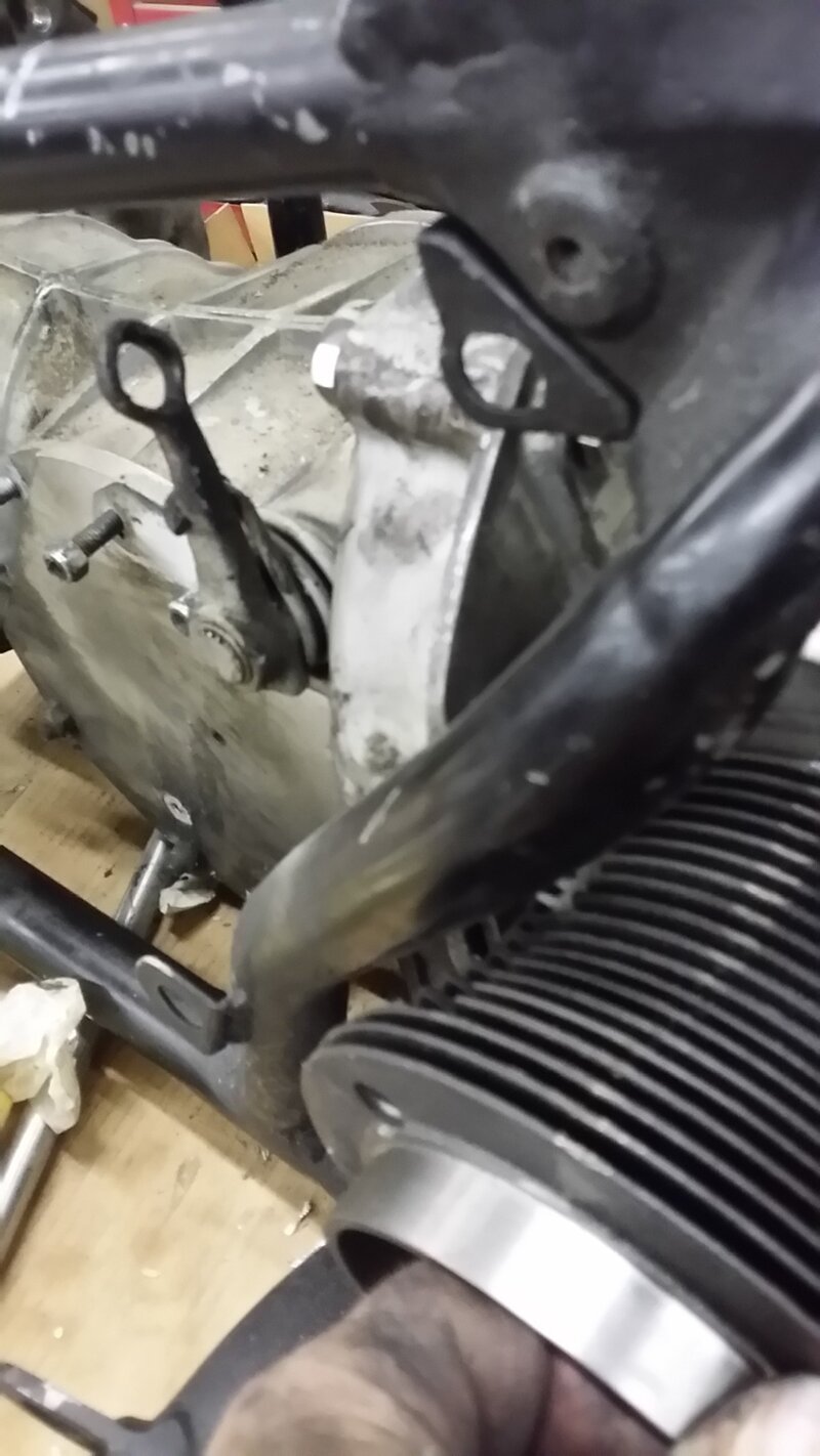

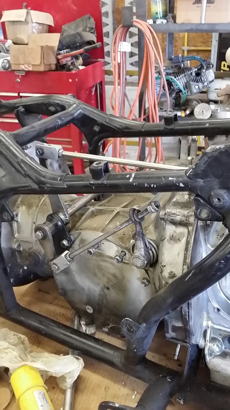

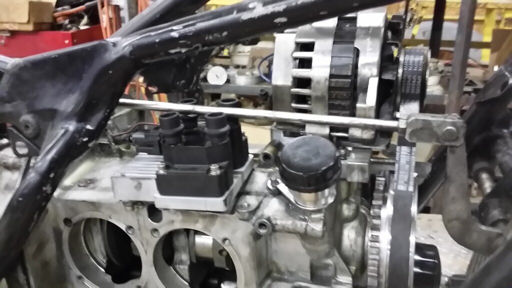

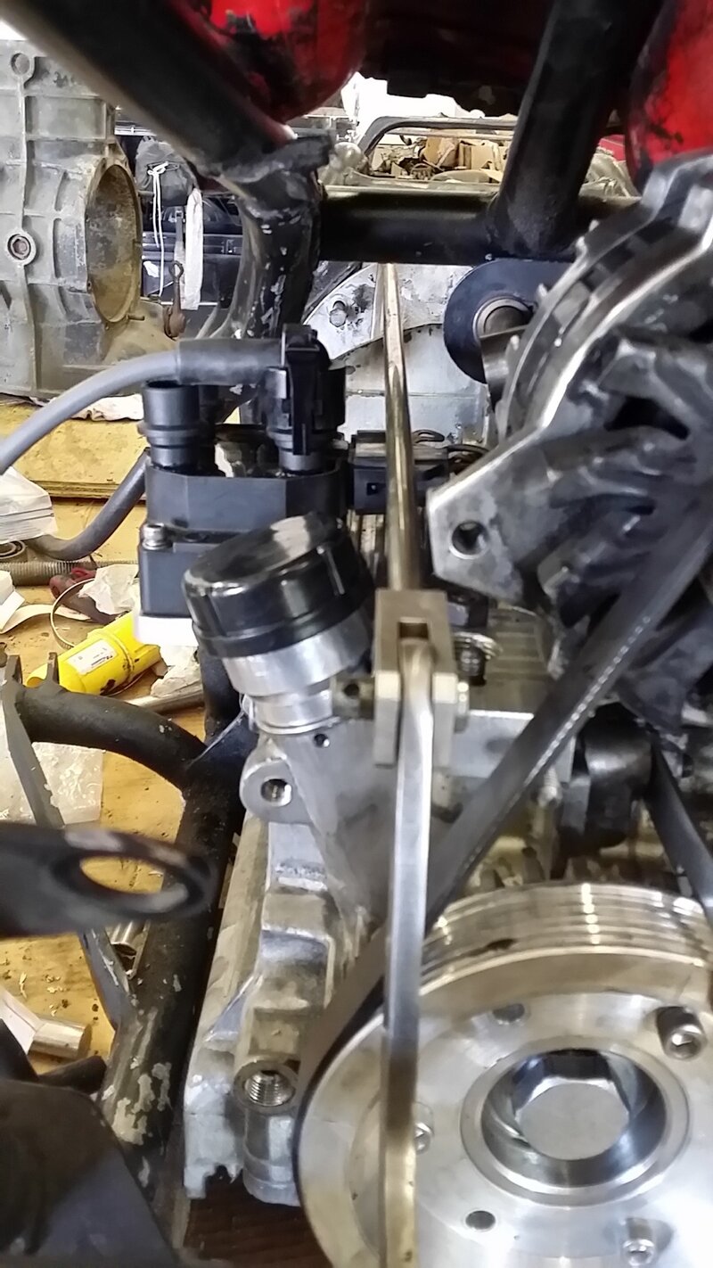

Never did get the clutcj link to work out the way I wanted.
So much for my fancy smancy coil mount.
Re made the mount and moved the coil.

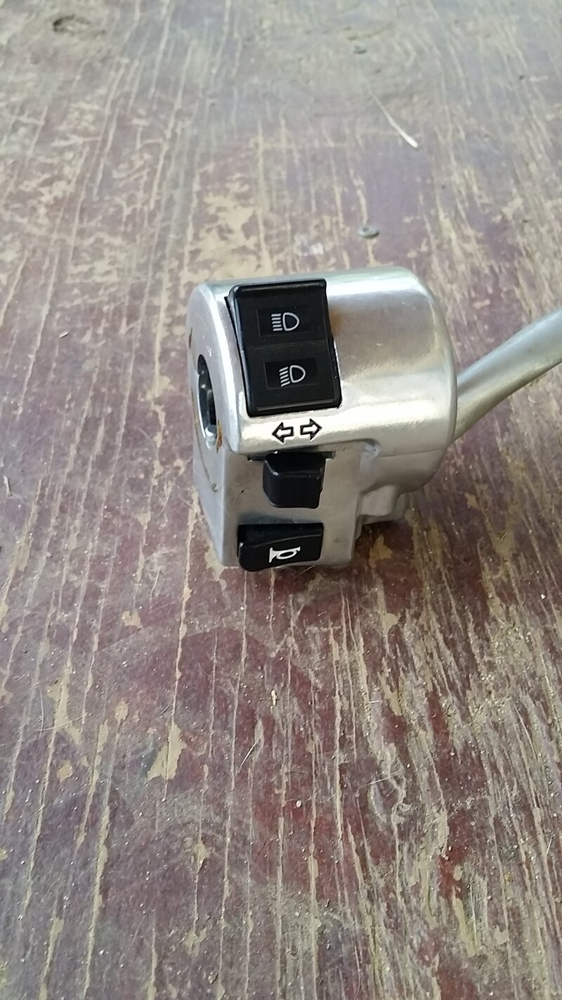

Going to eliminate some of the extra stuff I had from the gold wing.
No electrical on the rh bar.
All on the lh that I am gonna use.
But i am gonna add all the electronic for the fuel injection and distributer less ignition.
So on to mounting this stuff, hide some and only the cool looking stuff sticking out.

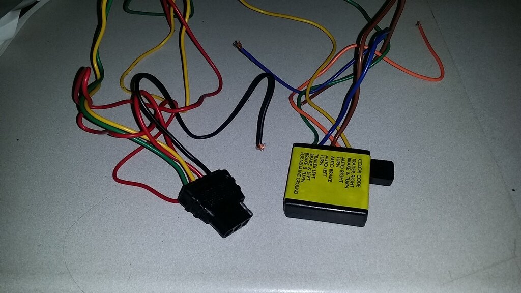

Got some signals off ebay.
Plan on using the dual filament reds as brake tail and turn.
No center mounted light.
As the motorcycle switch does not have the compound contacts like an old car did back when signal and brakes were a shared filament, I got a trailer light adapter.
This should combine the curcuit.
