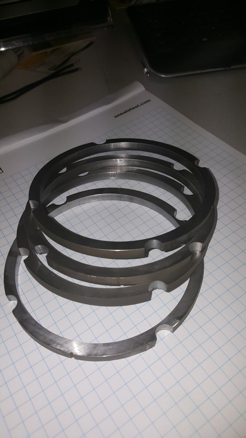

Did a little more machine shop time on the cylinder spacers. Only final grinding to thickness left. Wont know that number untill the short block is together.

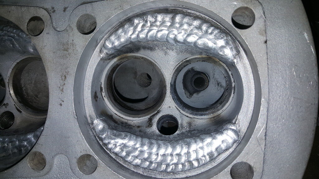

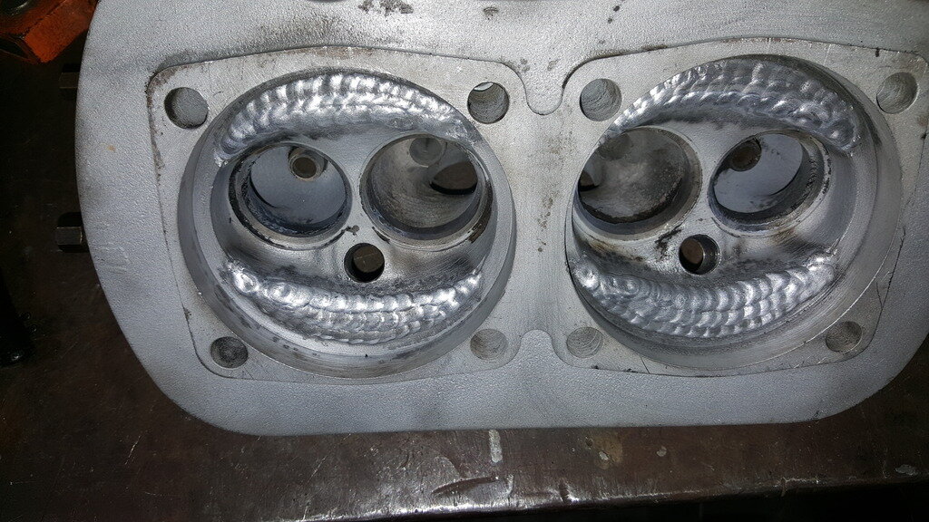

These are mofoco 050 heads. Full tilt street heads. Wont even fit on a "stock" engine. Valves wont fit into the bore.

That they are. The 050 heads.
Other than they were 54cc and a step, they are fine for a smaller engine.
These are 42 in, 37.5 out. No step, 60cc chamber now.

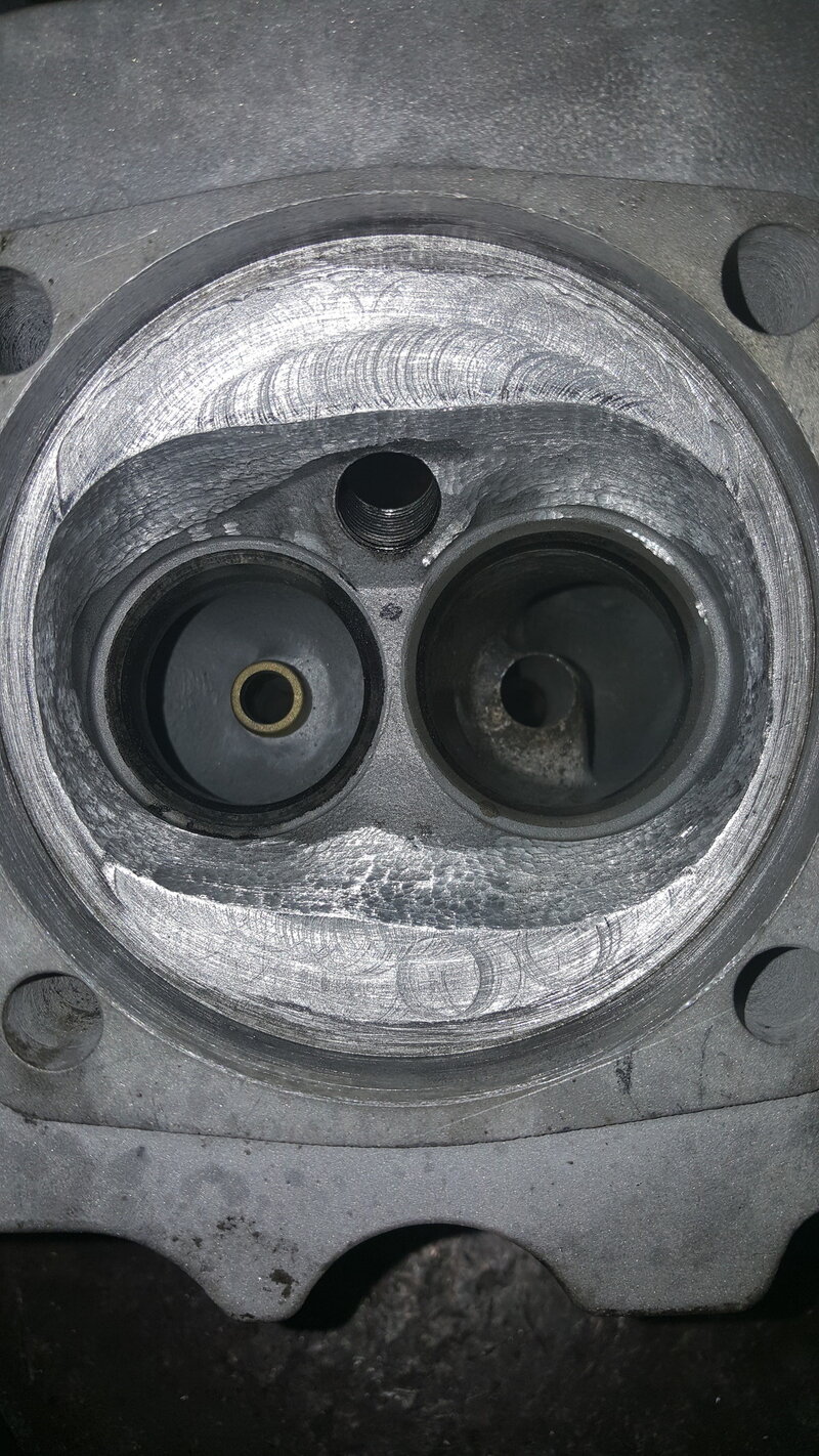

Now i gtta get back on the machine work on the heads.

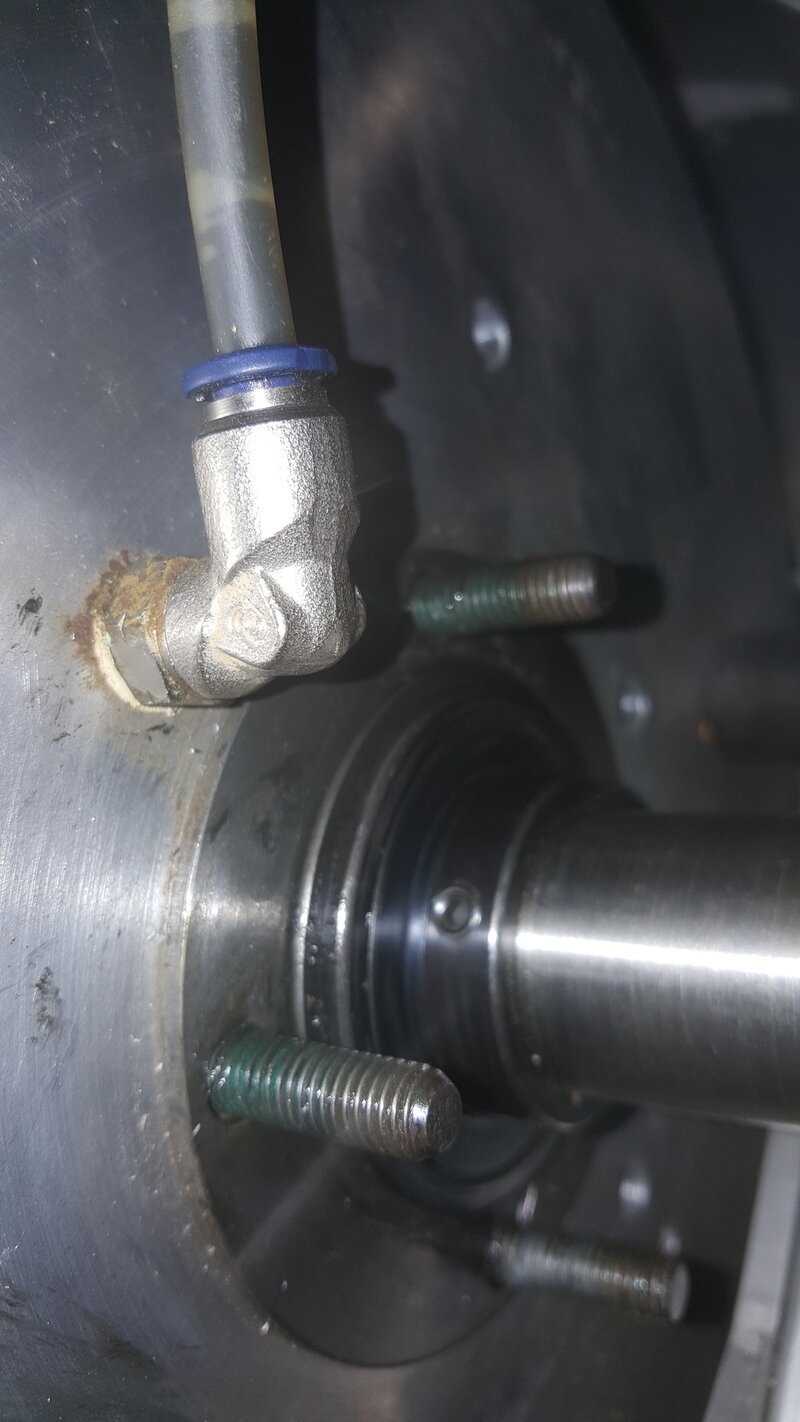

Back on the oil pump.
Cut o ring grooves in the body and the face for a positive seal on the suction side.
Plugged the pump outlet.
Then moved the outlet over and out the face.
So now it looks like this inside the pump.
And this on the outside.
