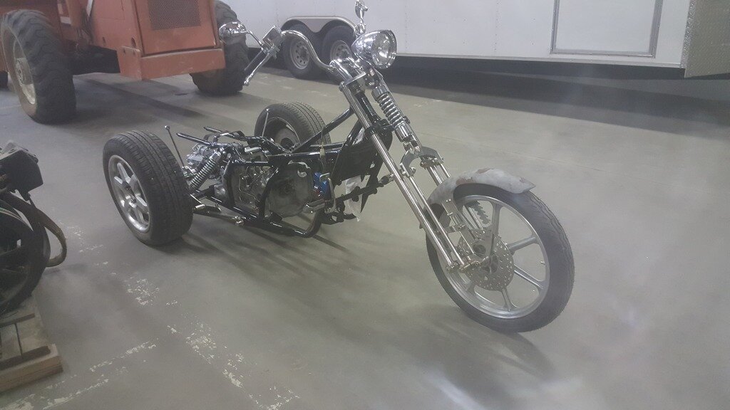

Anyone else?

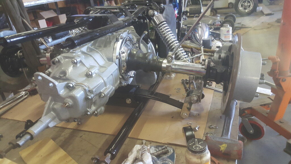

Making this.

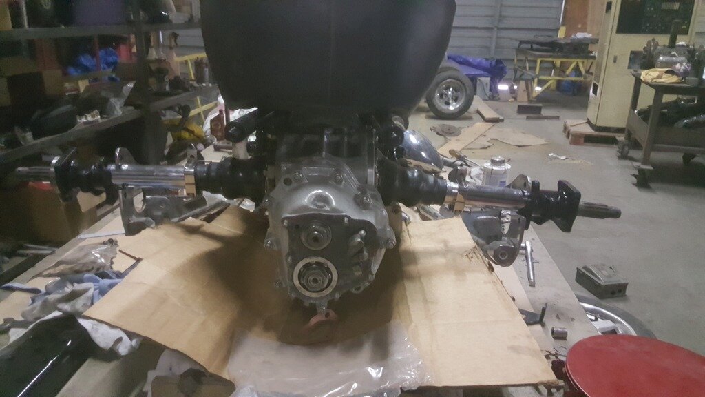

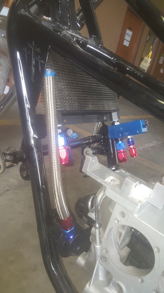

Stab this up in the bore the pressure piston goes in on the case.
That should end its entire function and move all the oil control to the external regulator.*

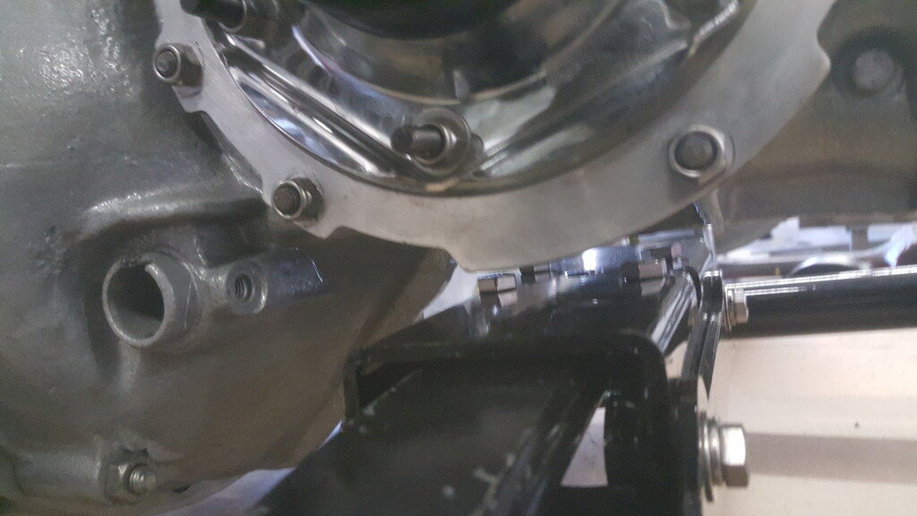

Also plug off yet another oil port.
The bypass port and an aluminum pipe plug.
Temporary covers for the running trans.
Prepping for blast and paint.

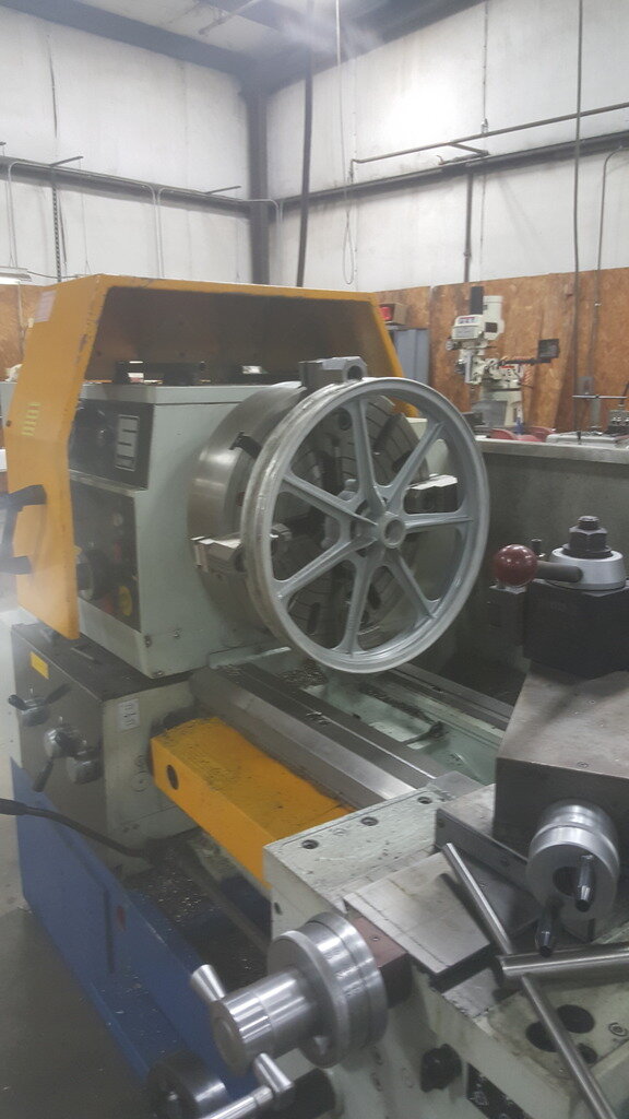

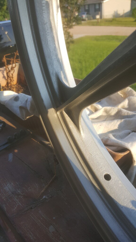

Those end castings I bored a few pics back....
Pressed right on there today.
Right crush fixed.that up.
And a 100 ton press helps a bit too.

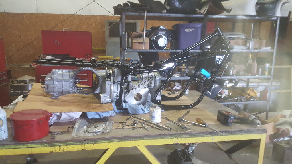

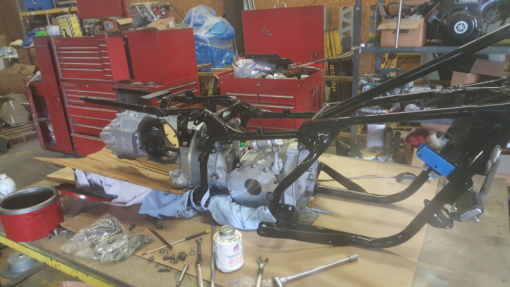

Assemble a piece here and there.
No instruments at all.

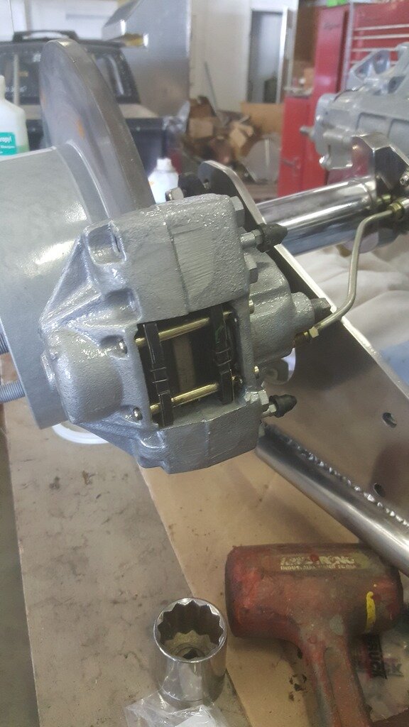

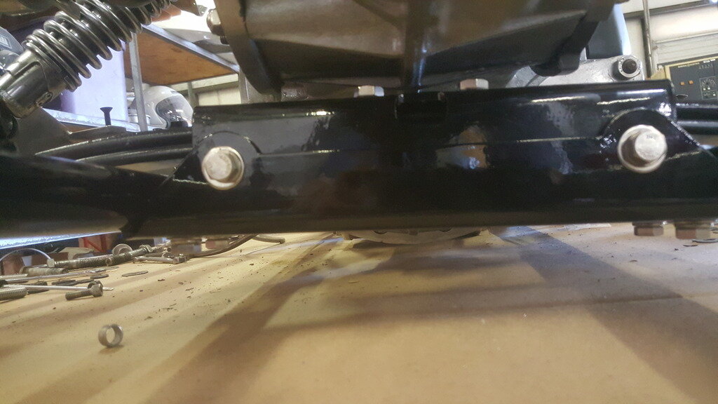

Also put a few small parts on the frame.

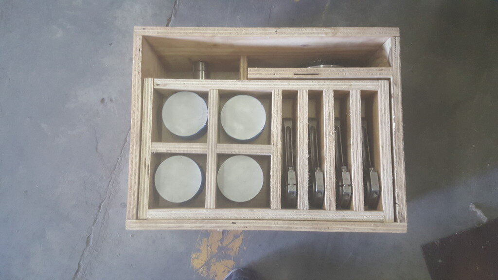

Got the pistons ready for the ceramic coating.
Waiting on more port 15 silver for the trans case
One of a kind workmanship!ThumbUp

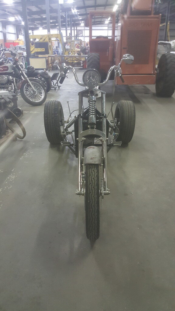

Those of us that are into VW trikes are impressed with the creativity & cutting edge technology you are putting into your ride. Don't slow down now, the end is within sight!
I wonder, is there a reason you chose swing over irs?

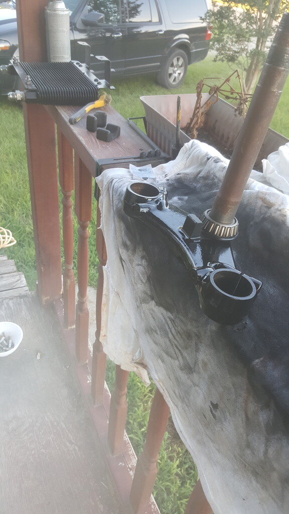

Not lots done the past few days. Worked all weekend.

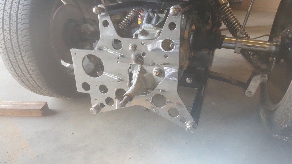

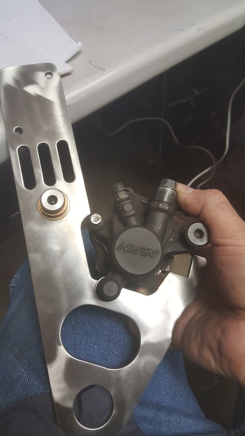

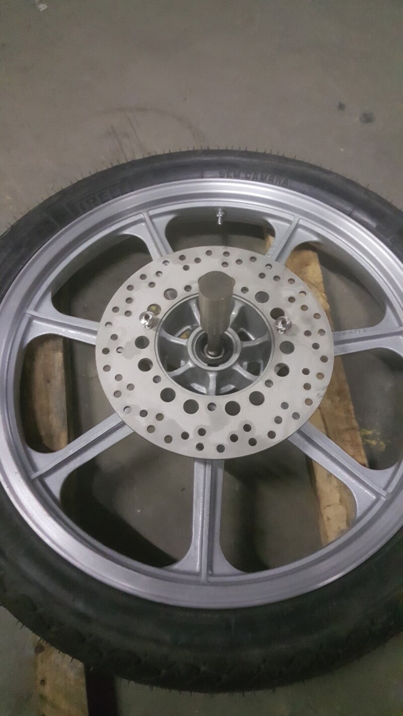

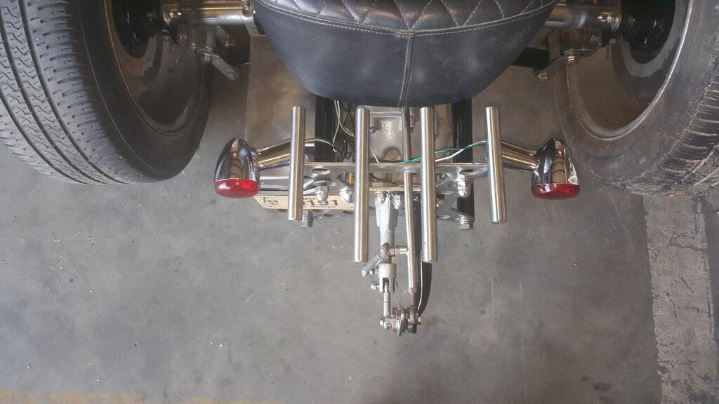

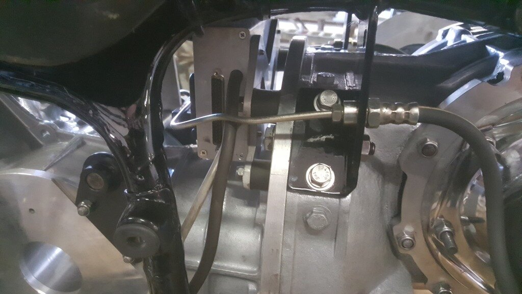

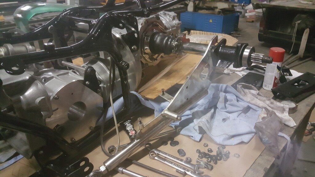

Finished the build of the brake stay.
Next is the torque link.

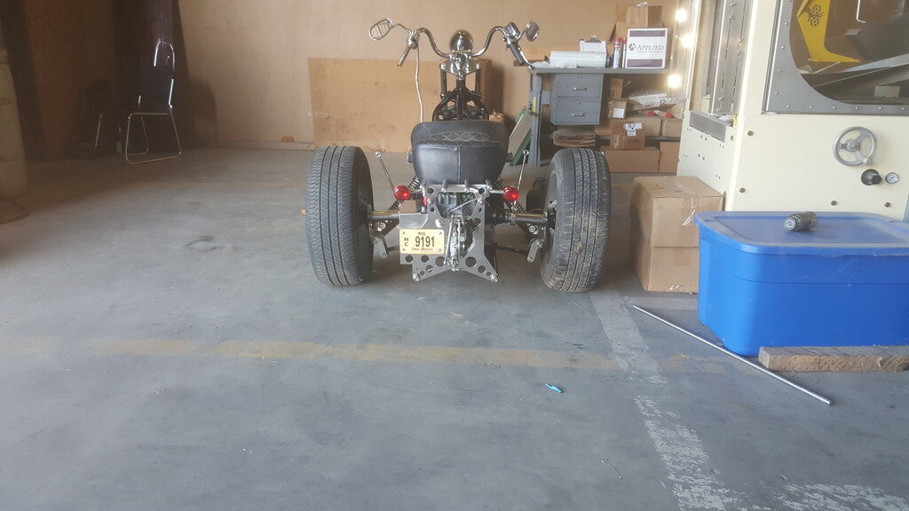

I did mock up a couple pieces to check fit and clearance.

All of this is on top of, or in addition too everything else that I have done with it before.
I originally built this before digital cameras were mainstream. So very little picture documentation back then. Getting it all together and working the first time was probably more involved than this time around. A lot of the details I am picturing here are old news. Such as the internal mods to the trans.
The big new changes are the shocker front end instead of hydraulic and the fuel injection.

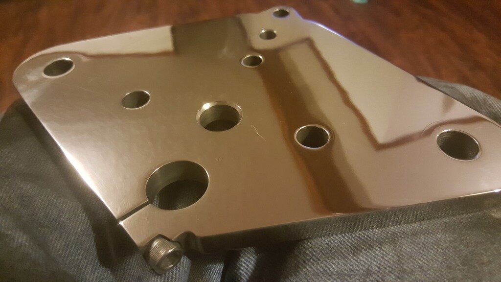

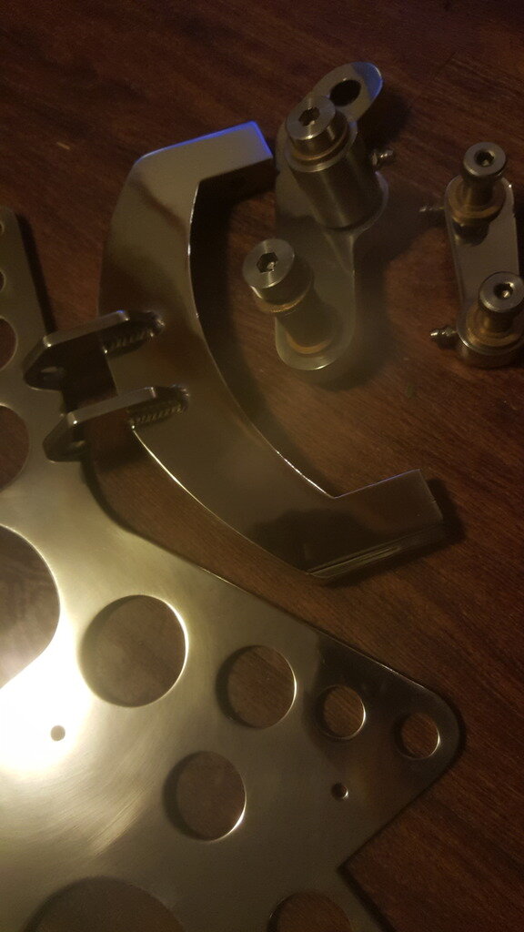

I am re-making some parts just for cosmetic reasons. I am really trying to make it pretty this time.
It has been in a bike show before.
With only 4 bikes in the class.
Did not even place.
Maybe with some shiney bits it will have a chance of placing.

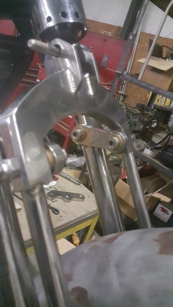

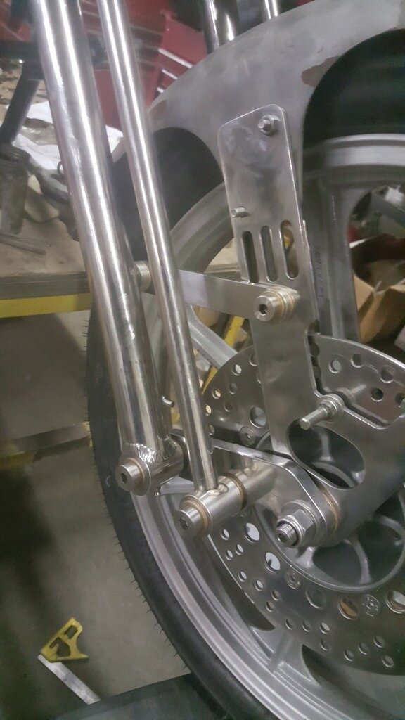

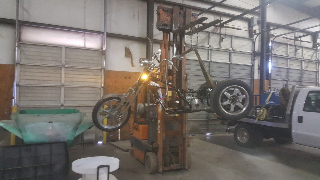

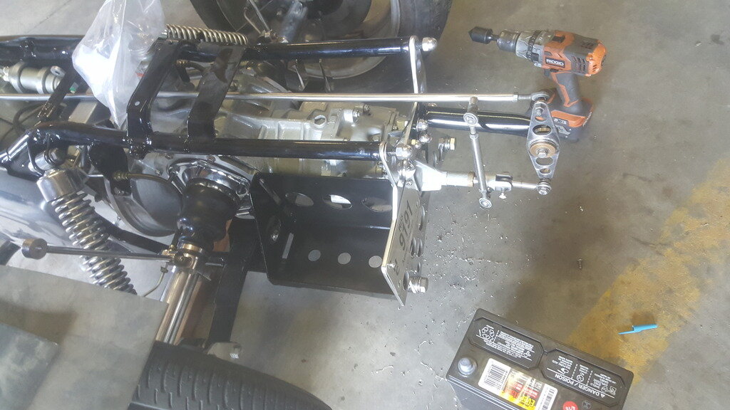

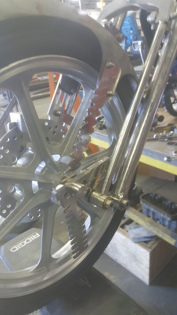

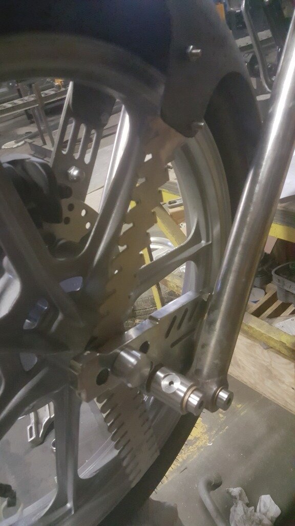

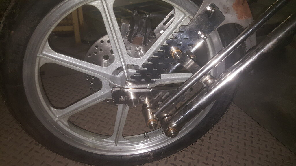

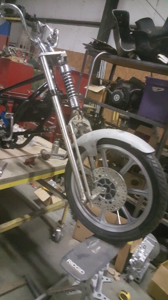

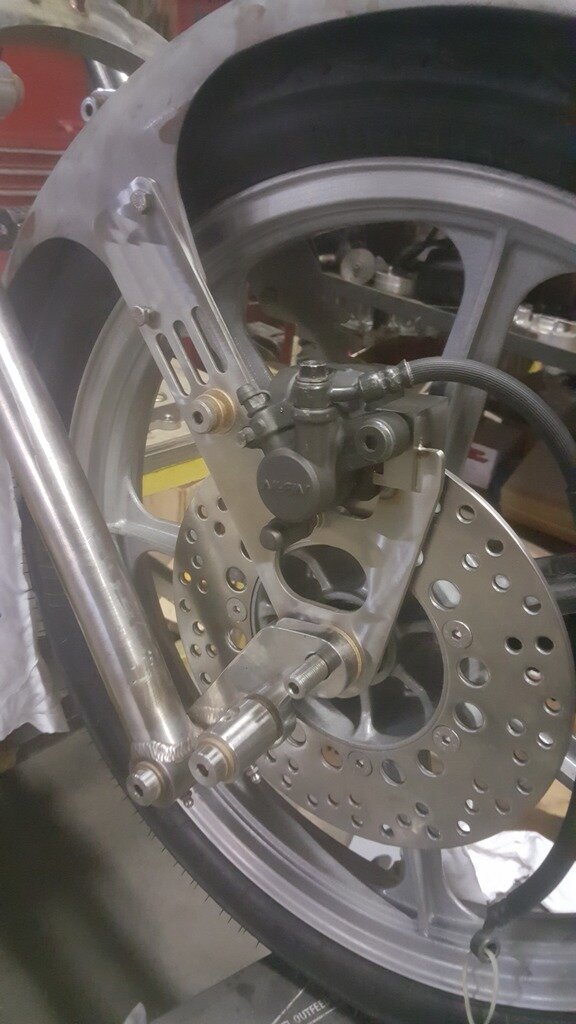

I had to put a parallel links on the other fender stay. Have a heavy brake and fender stay on one side with a parallel link. Thought it would be enough but the fender still wiggled. So the other side got one too. Had to pull the fork leg and machine in the mounting point.
So there it is on the pistola side with the heavier bullet stay.

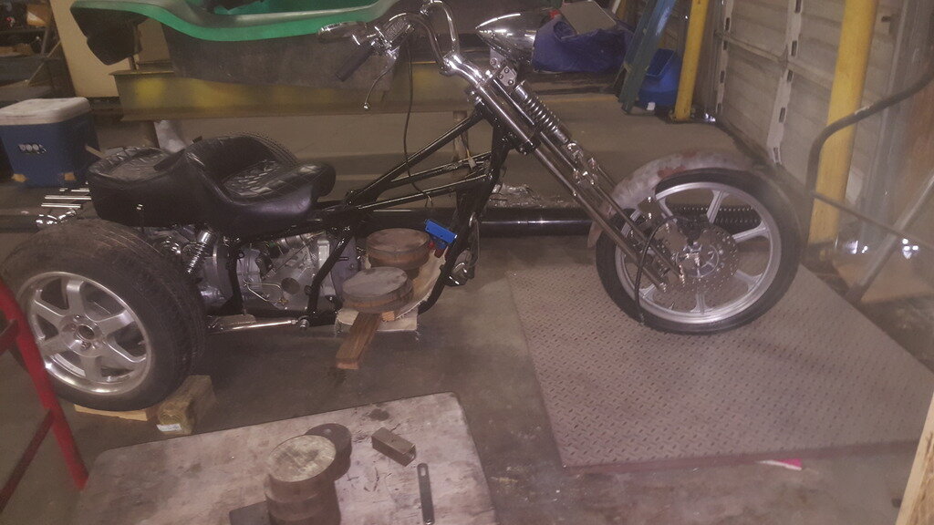

Here it is weighted and on the scales.
Yes I weighed it before I took it apart.
So the ride hieght and rocker angle is set.
Now to remove the link and weld it out.
