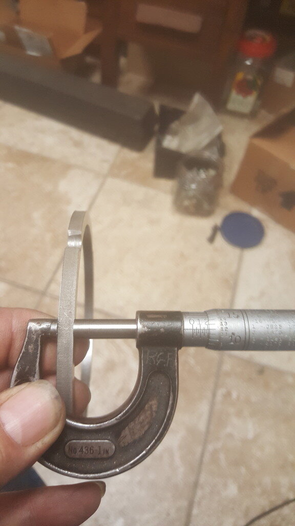

Deck hieght all measured out and shims ground to thickness.
Zero deck to cylinder.
My deck is the copper gasket thickness.
.050"
