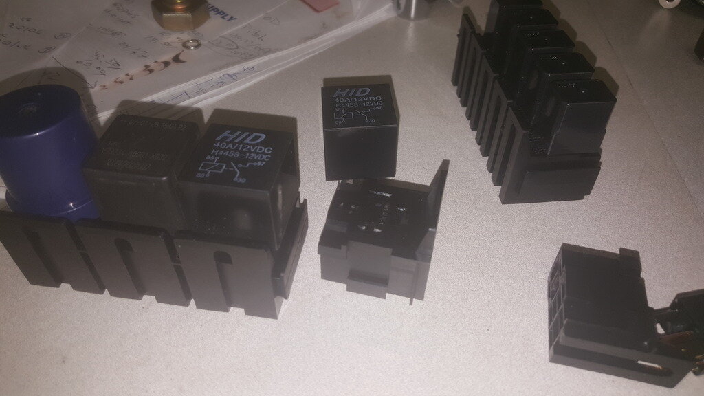

Ordered a bunch of relays. Thinking I am gonna put the wiring inside the handlebar. Then put all the switches on the negative side of the relay coil. That way there will be no power in the handlebar. If something shorts out it would just be turned on and not smoking.

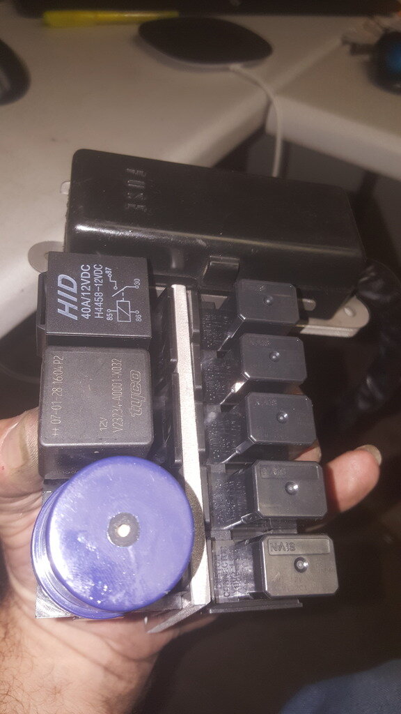

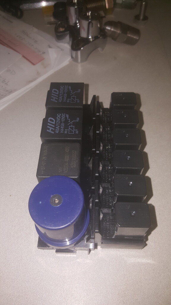

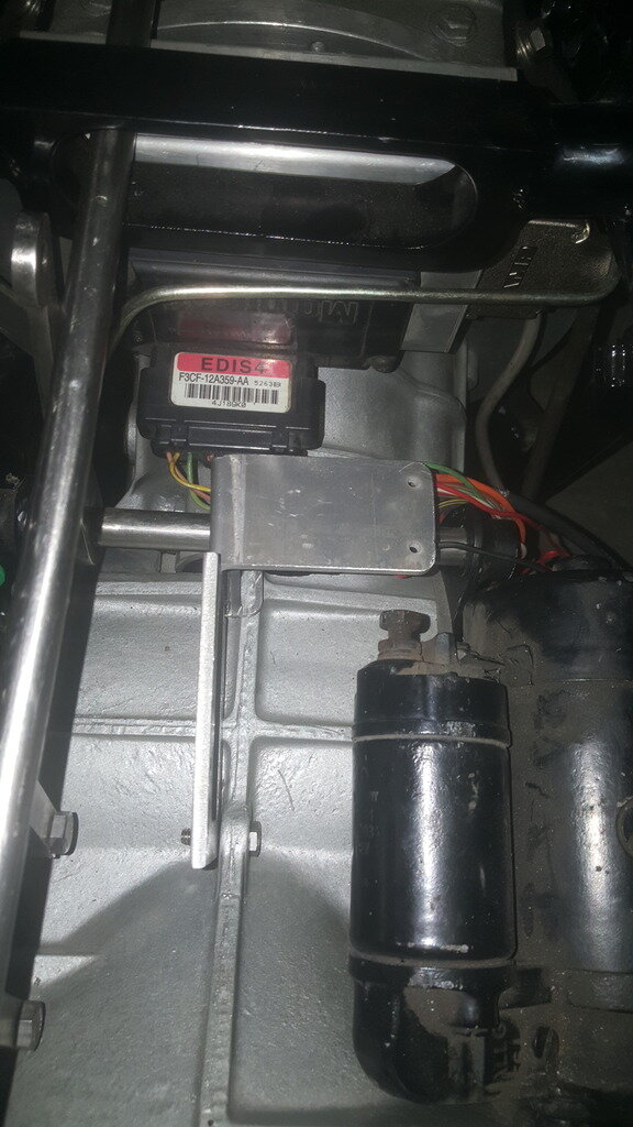

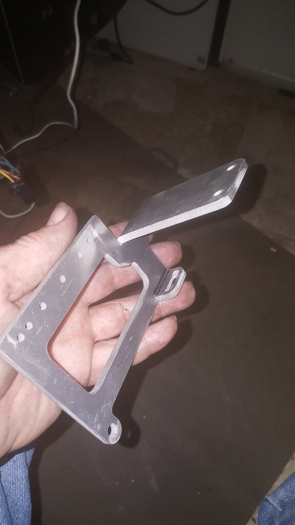

Made a bracket and drilled a few holes.
Mounts here.

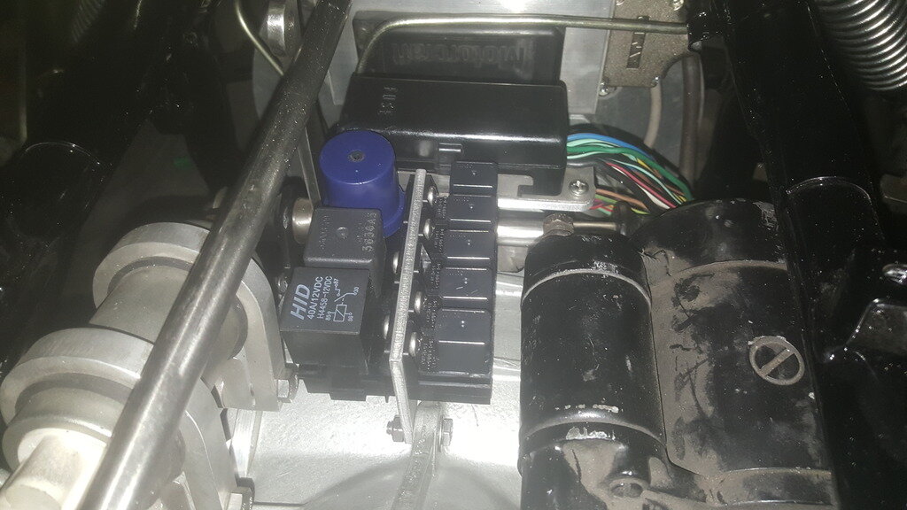

Holds all the relays and fuse box.
A tight fit ... but it is all in there.

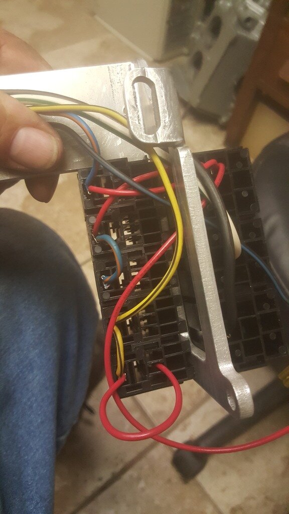

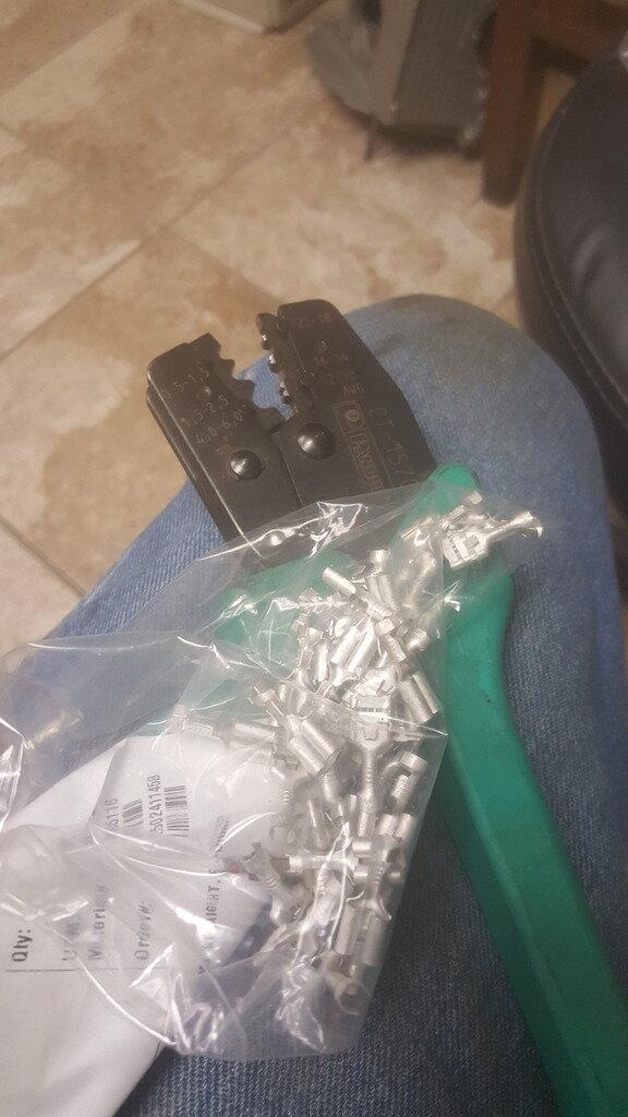

Started sorting wires.
And crimping ends on.

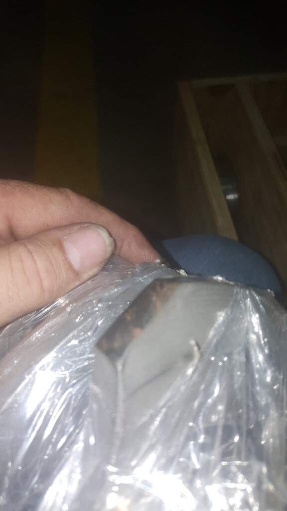

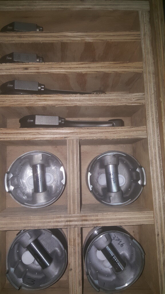

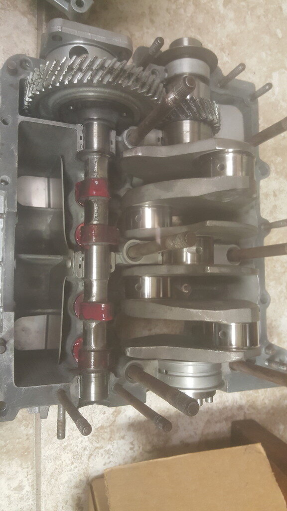

The bottom end is back from the balance shop.
Of course I had checked the static weights and knew things were pretty good there.
Pistons and rods have the slightest of work/ grind marks on them.
The crank has a couple corners ground on to get balance. No drillings. Not to bad.

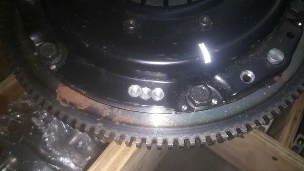

The flywheel took more than expected as it is a forged fully machined unit.
The pressure plate took some work but not to bad for a pp.

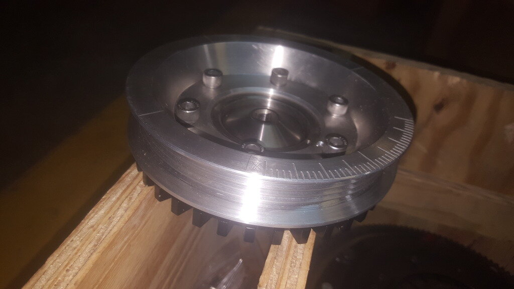

And my self made hub/pulley/crank trigger was dead slick. No balance work to it at all.

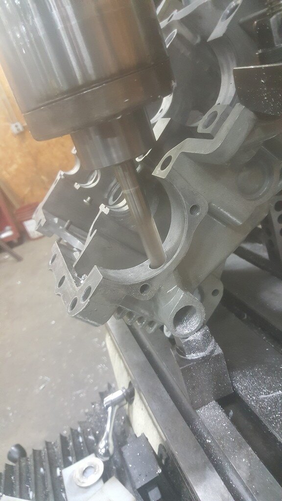

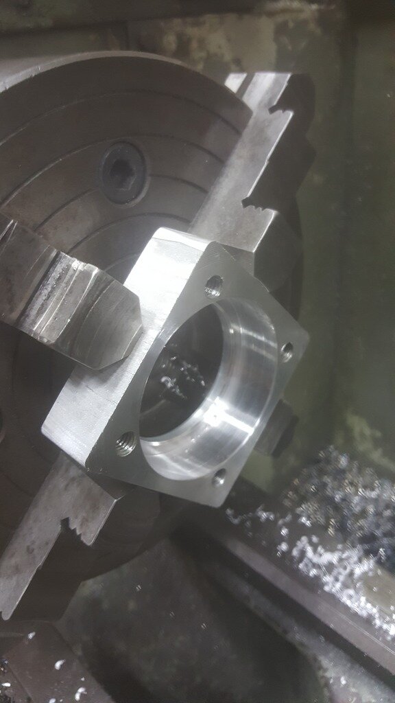

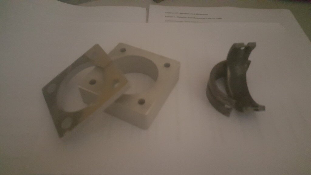

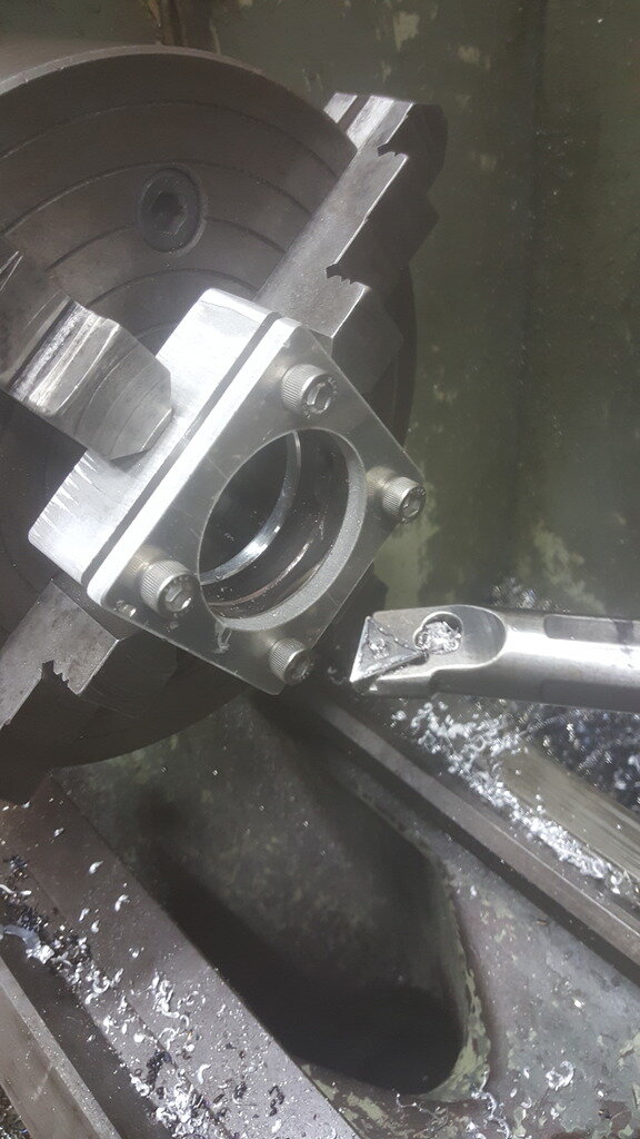

Made a little fixture.

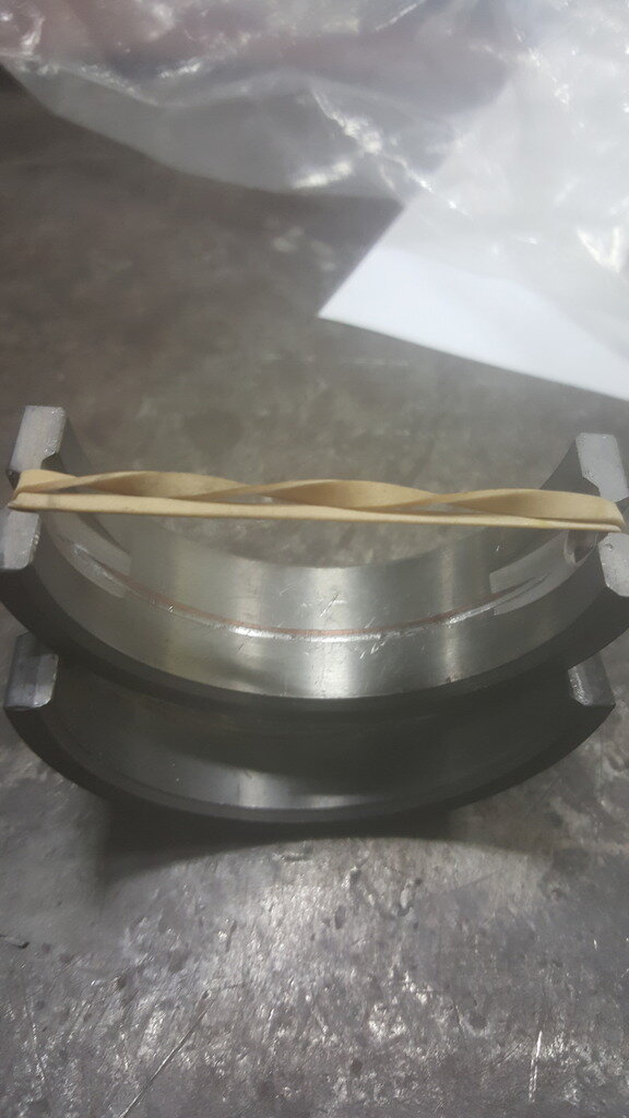

Bored it to fit the split main bearings.
Bolted the bearings in it.
And now I have main bearings with internal oil passage grooves.
This one is a test cut on an old bearing.

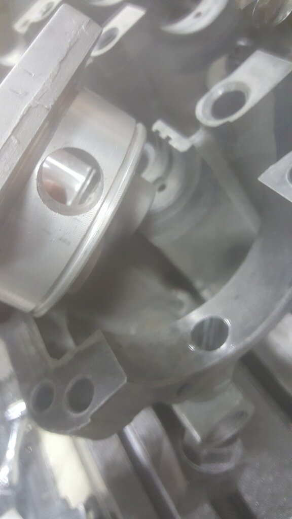

I am cleaning on the case, prepping to assemble the bottom end.
Oh crap, that's a great idea man!!! Cudo's to you, Rex!!!!!!
That has always been a minor issue with the main bearings on bug motors. I've always thought it needed oil passages cut in them.
The rods get their oil from the mains.
It is in pulses as the holes in the crank align with the holes in the bearing.
The groove on the inside of the bearing should give the rods full time pressure.
Like i have said before, i am trying to have lots of flow, thin oil, at reasonable pressure.

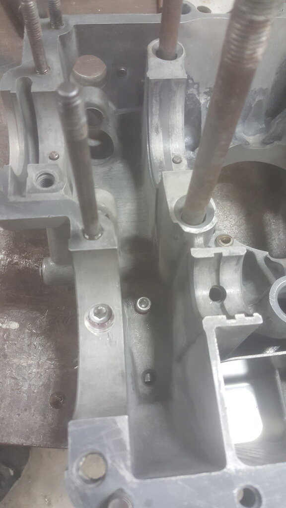

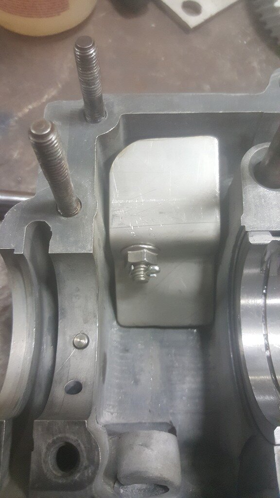

Trying to get the bottom end together.

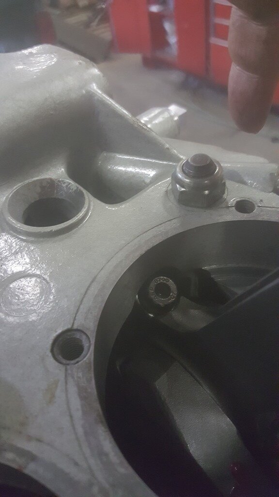

Suction side of the oil pump did not line up as well as I wanted. So I moved it over and enlarged it to match the pump.

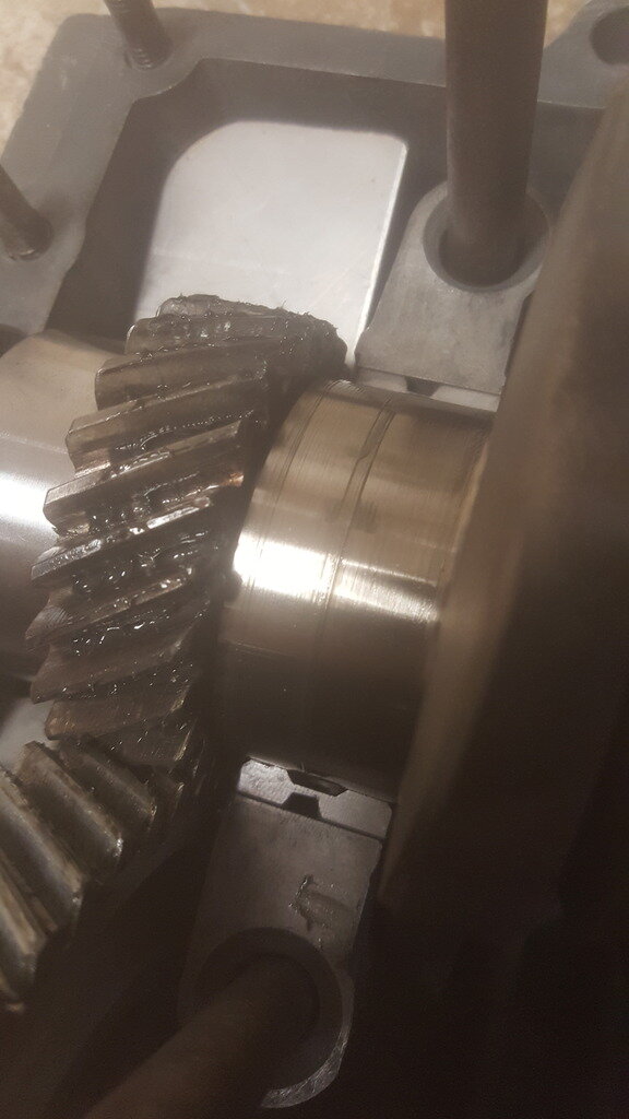

Some assembly.
Those gears are not new....but, are you looking at the moly smeared in the teeth?
O yeah...
And all H rated (130mph) tires now.
That's about were my will of self preservation kicks in.
I did seriously consider straight cuts.
I just dont want to listen to them all the time.
They are basically right between my ankles.
If yu can hear them whine all the way out the back of a beetle.....they gotta be loud.
Of course the case has the double thrust bearing.
But this cam is about as far as you can go and still expect to use a bevel cut.
Closed it up and had to open right back up.
Cam plug did not tighten up.
Got it sorted and closed up again.
Flywheel endplay shimmed.
Now for 350 ft lbs of torque wrench...
Some tight fits with that 86mm crank.
