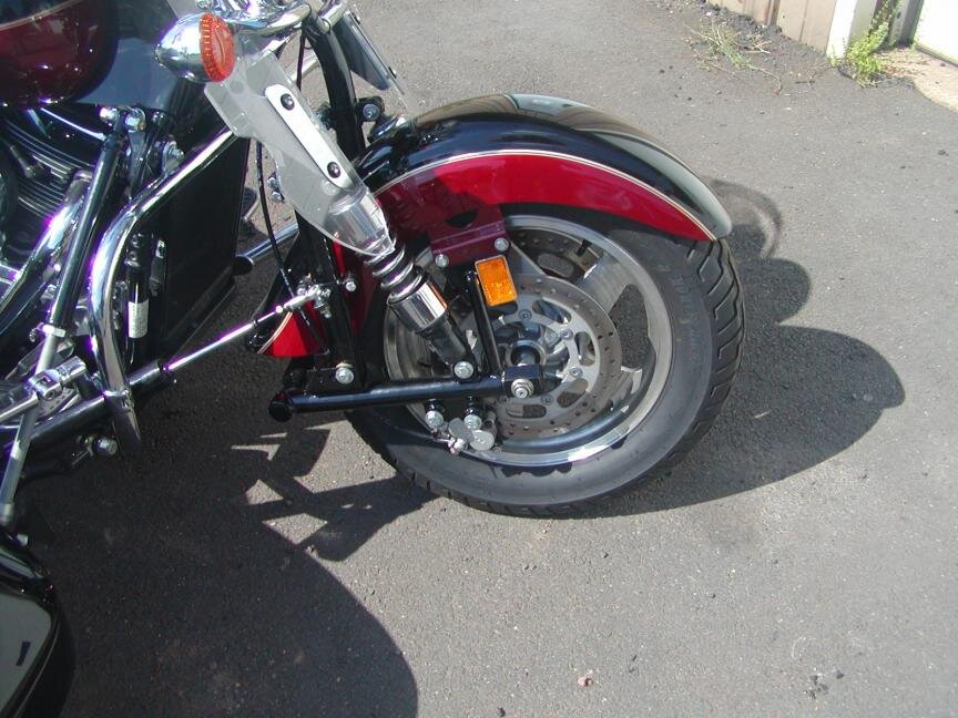

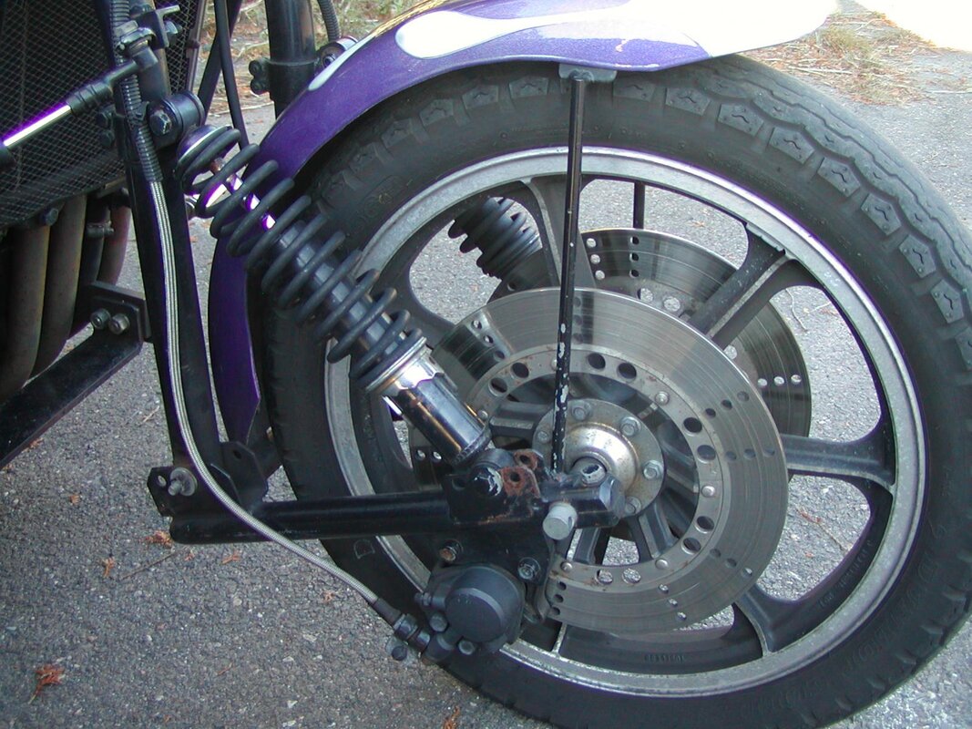

I plan to split my down tubes like this guys did.
I was planning on putting a bronze bushing on the bolts for the rockers to ride on so to stop the steel and steel wear
But what about the sides. Wont the rockers wear on the sides of the tubes?

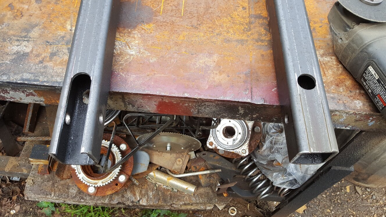

Did some more work on the forks.
Here I welded the top part of the bottom plate, drilled the holes for the pivot point and cut the down tubes to the right length. (am I saying that correctly are they called down tubes?)

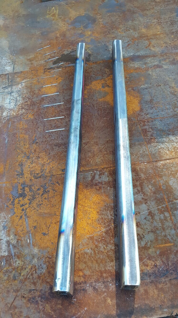

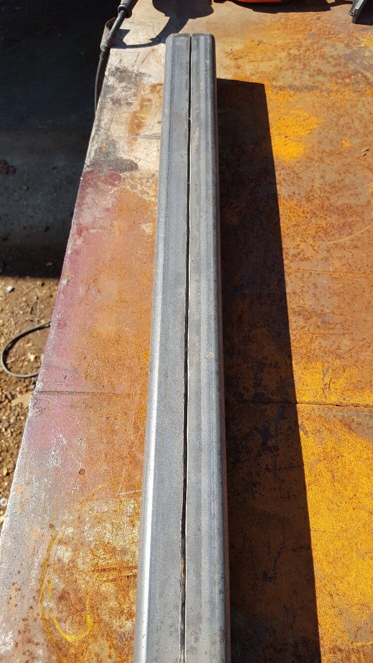

First pass with the cutoff wheel making the rockers
Cut in half now need to weld in the 1 side

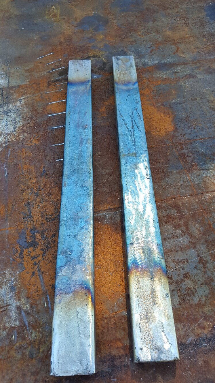

welded the side plate on. 1/4" thick. Notice the discoloration. They both warped when I welded them. I had to heat them and flatten them back out again
Side View
Need to drill the hols for the pivot point and the axle and weld in the inserts.
To Hot to work out there anymore today.
making headway....looking good!......I just call them fork tubes. I have heard the term down tubes used to describe the 2 tubes running from the neck tube down and bending rearward to make the engine cradle on a motorcycle. There may be other names for the so called fork tubes?

silly question...why cut tubing in 1/2 an weld bar ??
The 1/2 tubes are for my Rockers. They will go all the way back behind the tire and around the back.
I do not know the correct name for them but we have been calling them wrap arounds
I did not want to use use the complete 2x2 bar
I could have used something smaller like the 1/2 inch stuff I have but I do not have enough to make the complete wrap around and someone said they used 1/2 for that and it twisted some .
I do plan to weld in some inserts for the Pivot point and axle
I know its a little more heavy duty than I need but I like how its turning out so far.

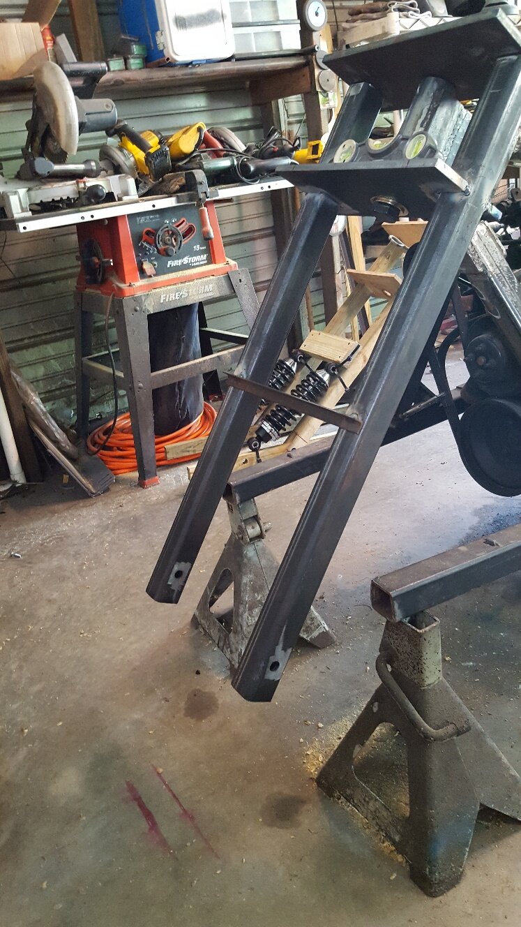

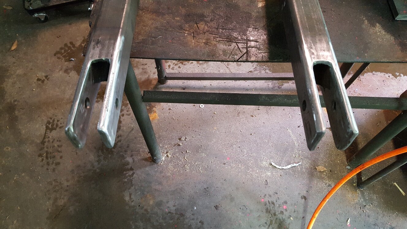

Started cutting the notches
Notches cut and reinforced. I welded 1/4 flat bar inside each side of each leg. It goes up 2 inches from the cutout. I welded all the way down the cutout and I reached up and welded inside as best I could. I am thinking of drilling holes in the tubes then weld the inside flat bar to the tube. (If I would have thought of it before hand I would have drilled the holes first)
That makes 7/16 on each side of each leg. If needed I can weld another 1/4 on the outside of each side of each leg.
Once I know I have the notches high enough I will weld up the top holes (sealing off the legs).

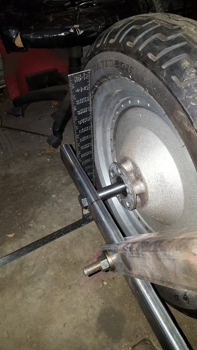

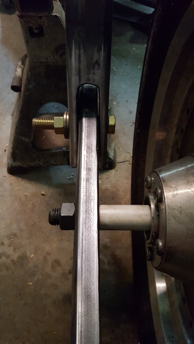

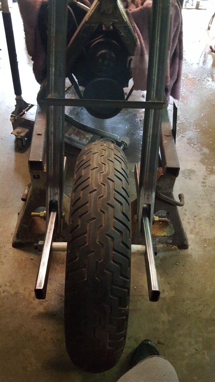

Fitted in place but only using PVC as axle spacers for now. I only have enough of the steel spacer left to make them once. So I have to get them right the first time So I am trying to get it correct in PVC first then will cut the steel spacers
The rockers are riding on a bronze Oilite bushing and has a bronze Oilite thrush washer on each side of each rocker
The bolt at the pivot point is a 5/8 grade 8 bolt. Had to buy extra long for the shoulder of the bolt would come all the way through and no threads are in the bushings. I will cut them down later
Do not have it centered yet. Once I have everything in place correctly I will shape the wrap around in back of the tire

Steel spacers made to replace the PVC ones
Now need to mount shocks.
Bottom mount will be 1 inch behind axle as you guys suggested
This will be a next weekend job (if I have time)

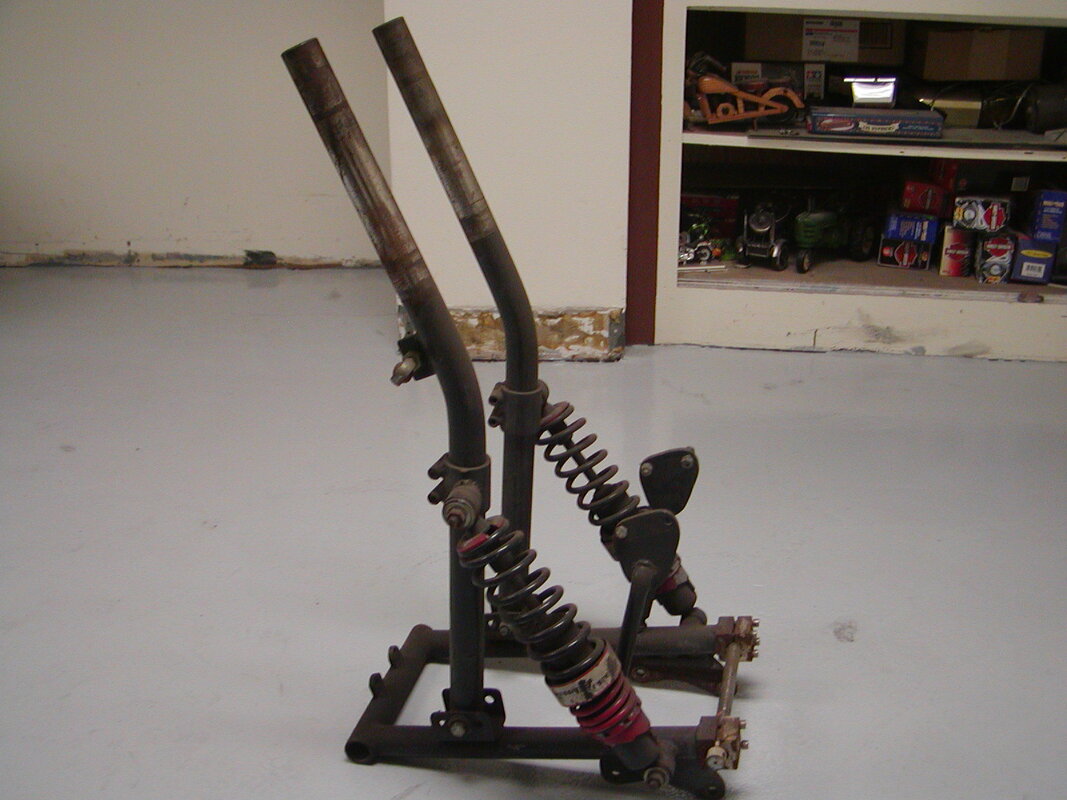

i have found with the weight on the front end the pivot wants to be about an inch below the axle.. i usually make the top and bottom shock mount adjustable top is a pinch clamp bottom several holes.... ironically dont think i have ever changed them from the 1st set up on the purple bike i had used the extra set of holes for a tow bar
