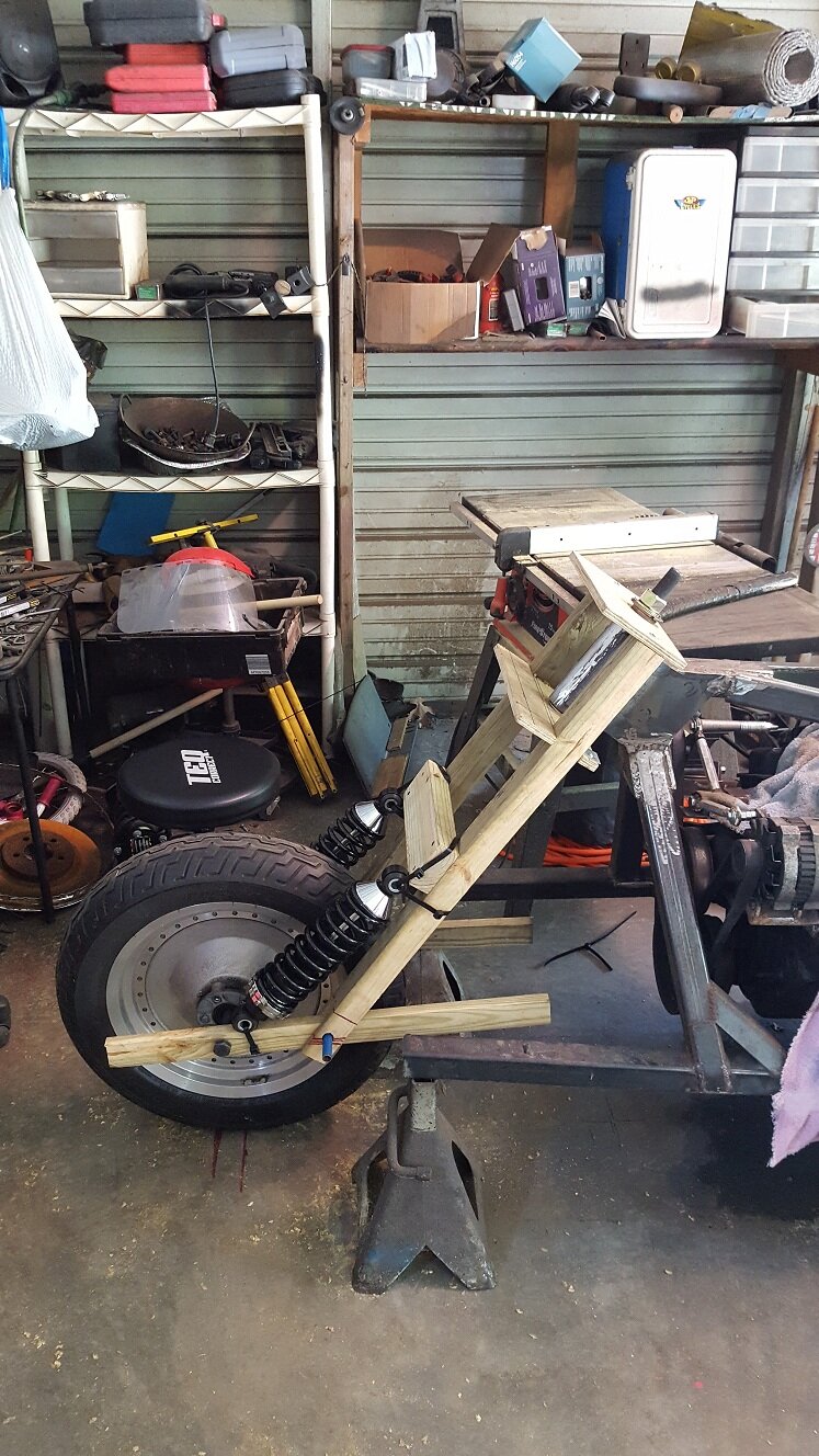

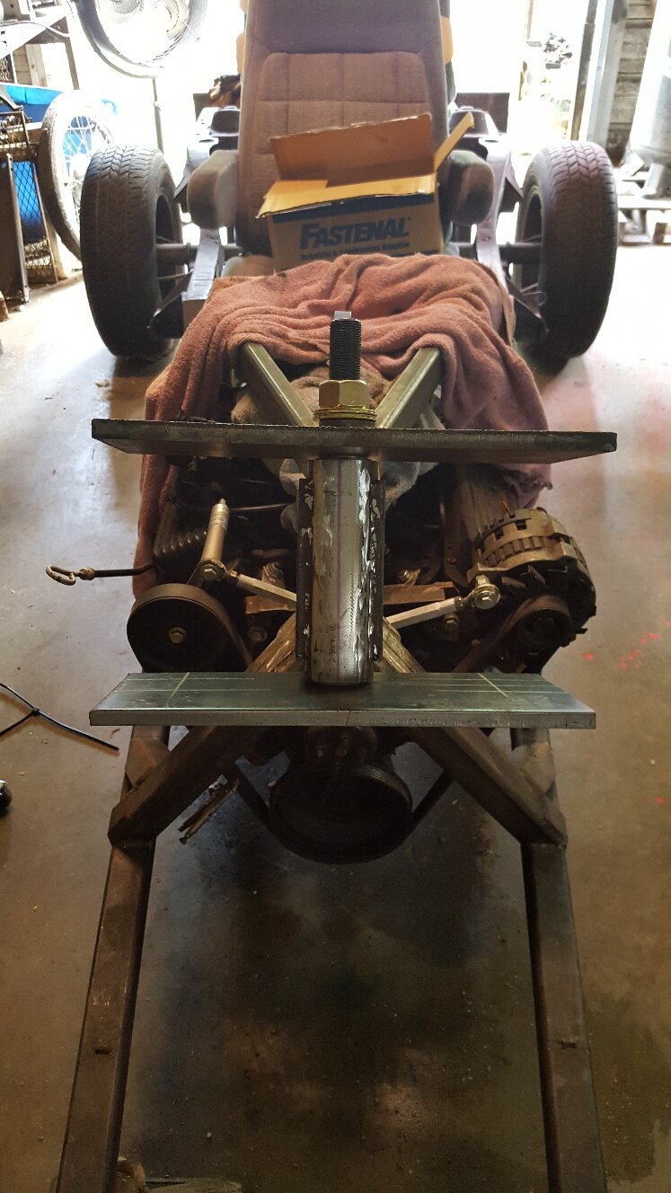

Did some more thinking in wood.
Will need to get my measurements better when I do it in steel
You should get the idea of what I am trying to do.
Tell me what you think of this design

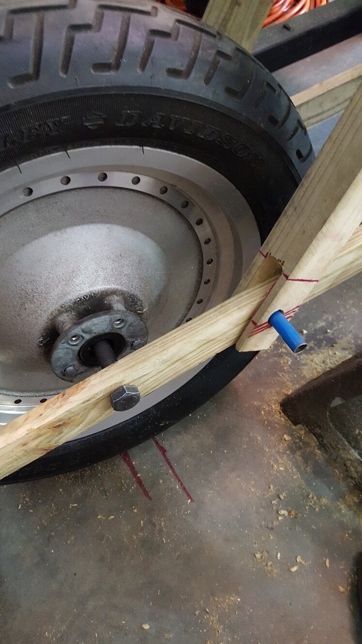

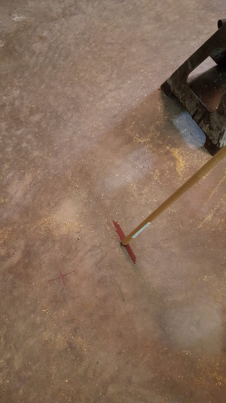

Took a wooden dowel to get a straight line from the neck
Drew a line where the dowel hits the floor

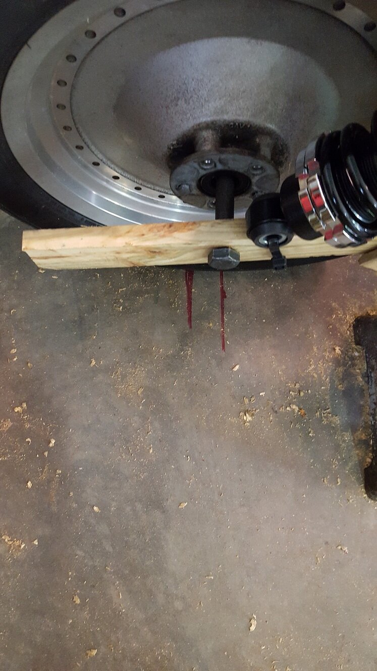

drew another line 2 inches behind
The wheel is lined up here 2 inch trail

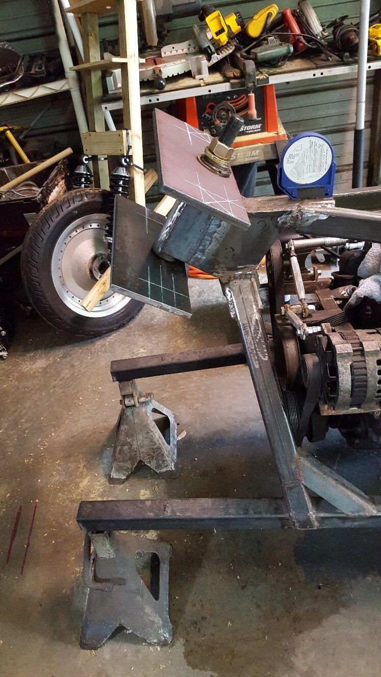

This is what i am thinking for the rockers and the joints
Zipped tied he shocks on. They are larger than I originally wanted but I do like the look.
1 thing I do like about them is I can get springs in different weights so I can go lighter or heavier one i figure out what I need
I have 1 inch clearance between the forks ad the tire.
just a question....what angle will your rockers be when full load is on your front end? Just my opinion, I like them tilted upward slightly at the forward end. Also what material will you use for the bail....or wraparound, as some may call it? I just used the same mtl. as the rockers. But it can twist, so I wish I had used round tubing like Stacybg used on his front. :cool:
I know the rockers are angled down in the wood mock up but I was planning to make them level.
Why point them upward? Does this help with something or is it just for looks?

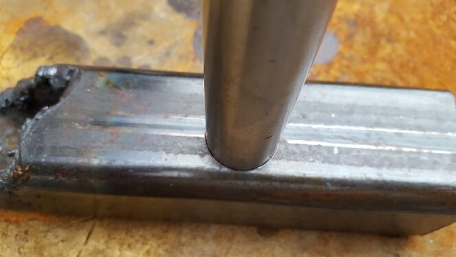

For the rockers and the wraparound I am taking a some of the same 2" square tubing I built the frame with and I am building the folks with. Cut it down the center then welding a back plate to it. SO when I am done I will have a 1" X 2" tube and it will be very strong
On the down tubs I plan to cut 1" out of the center at the bottom then reinforce each side. This will be where the rockers will be inserted

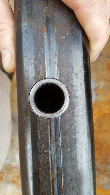

I would think that you would have better luck with a new hole saw, slow speed, and lots of lubricant. Less likely to grab a flute and launch your piece. If the 3/4 holes in the 2" tubing are for pivots, axle, etc. consider using a sleeve to provide more load bearing surface. https://www.ebay.com/itm/Steel-Tubi...R40&rt=nc&_trksid=m570.l1313&LH_TitleDesc=0|0
With this you could just drill 1" holes in the tubing, align the bushings, and weld in place. This process could compensate for any "drift" in the drilling process.

I've got the rockers pointing upward (front) about 30/40 deg from horiz thinking, that when the wheel goes up, there will be a straighter push on the link rods.

didnt notice what u got the hole saw for but.. it will not make a very tight tolerance hole... it will be quite a bit over
Well that sucks...
I was planning to use it for the neck stem holes in the upper and lower plate and the hold in the rockers for the axle. The axle is 3/4 but I am using a 1" spacer that reduces it down to 3/4"

not much chance of that being a good fit... even a good drill will drill over.. best bet is a 31/32 drill an a 1" reamer esp for the rocker
have never used a hole saw for drilling thick steel.....but would agree with stacebg that even with a pilot the 1 in. hole saw will wander enough to be oversize. can you find a local machine shop or weld shop that could plasma or waterjet those holes? or even drill undersize and ream to size. or worse case, buy a drill bit and adjustable reamer on e-bay, I see a lot of crichley adjustable reamers sets fairly cheap. I have drilled a lot of 3/4 to 1 in holes on my 1/2 inch drill press......also have drilled many holes with an old post drill fasted to the garage wall .....they had a rachet power feed that worked well...of course you cranked by hand. with a slow turning bit and heavy feed pressure I have drilled thru leaf springs on occasion.

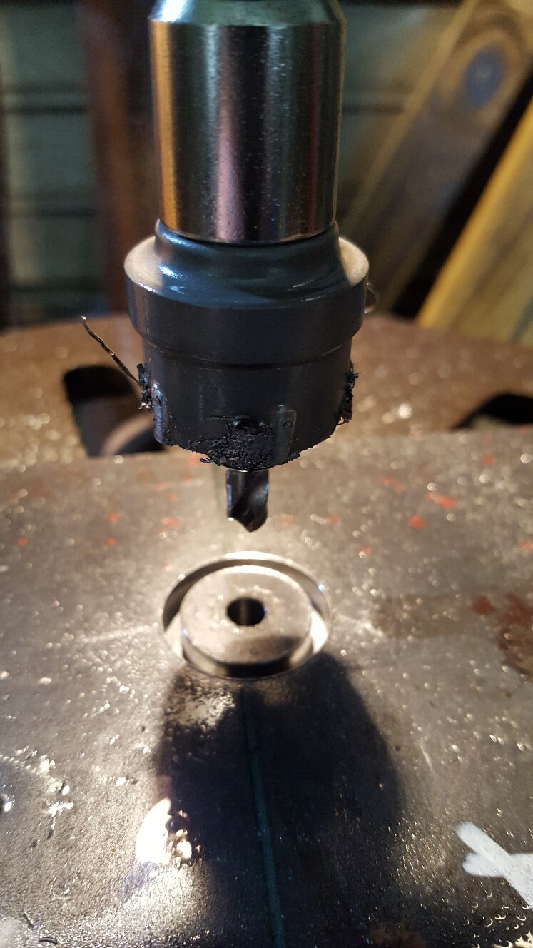

Bob if you drill or hole saw...you will need to ream the hole to get it straight and round. If the drill bit is sharpened correctly, a 31/32 hole should clean up with a 1 in. reamer. That is why you drill a sample hole in a piece of scrap steel. if in doubt use a 15/16 bit. The reamer will pull harder with the smaller bit of course. with an adjustable reamer you can increase hole size in steps. Working 1n. holes will require a drill press that turns slowly. the adjustable reamers are to be turned by hand.....the chucking reamers are used in a drill press turning slowly with plenty of oil....cutting oil preferred, but engine oil works, not as well, but I don't like the smell of hot motor oil... For 4 drilled and reamed holes farming out to a machine shop may be cheaper? Others may have ideas or suggestions. Good luck on this project.

I just looked at my hole saw. It is not actually 1 inch. It is 25mm (from Japan)
I just picked up some cutting oil from Ace hardware I am going to try it tomorrow on some scrap 1/4 plate
If that does not work I will buy a 31/32 drill bit
ya the 14 dollar one should work. I usually drill a pilot hole slightly smaller than the thickness of the drill web......that is the width across the point of the drill bit. It helps the drill feed easier. A larger pilot hole can sometimes let the bit wander and chatter. experiment on a scrap piece. The new bit should drill close to on size. At work we sometimes needed a larger hole than the bit had available, so we would hand sharpen the bit, grinding uneven cutting edge lengths, to make it drill slightly oversize.....not always successful!
Oh Yea of little faith...:). I've had good luck with hole saws on projects like this. Some caveats: Slow speed and plenty of lube/coolant. Subsequent holes may not be as pretty or precise. A second hole saw is always a good investment......You'll use it again sometime anyway.
As for drill bits.....MADE IN USA!!!! My experience with Made in China is that they aren't worth the blisterpack they come in.

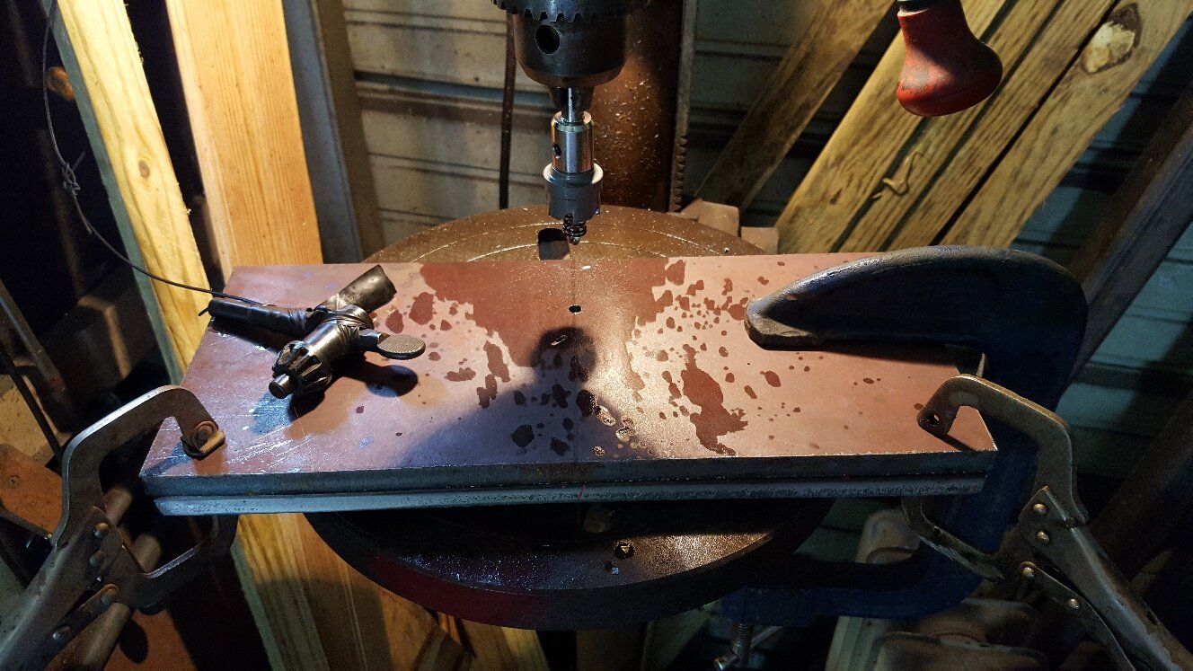

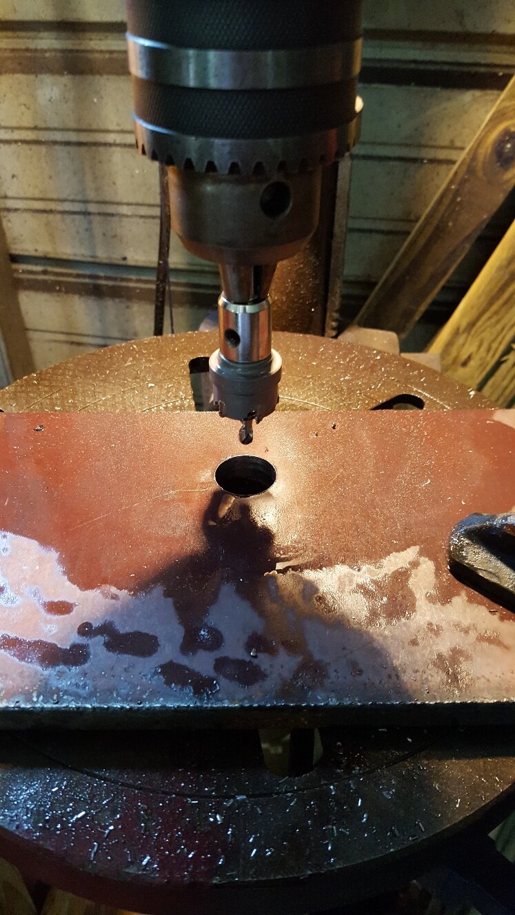

Started by drilling a pilot hole through both plates
Had to take it down to 1 plate at a time because it would not go through both
Also it started clogging up I had to clean it a lot
It went through 1 plate at a time fine just had to clean and oil it often
on the trike. The stem bolt fit real well but it is to long. I will have to get 3/4 inch more thread cut in it
