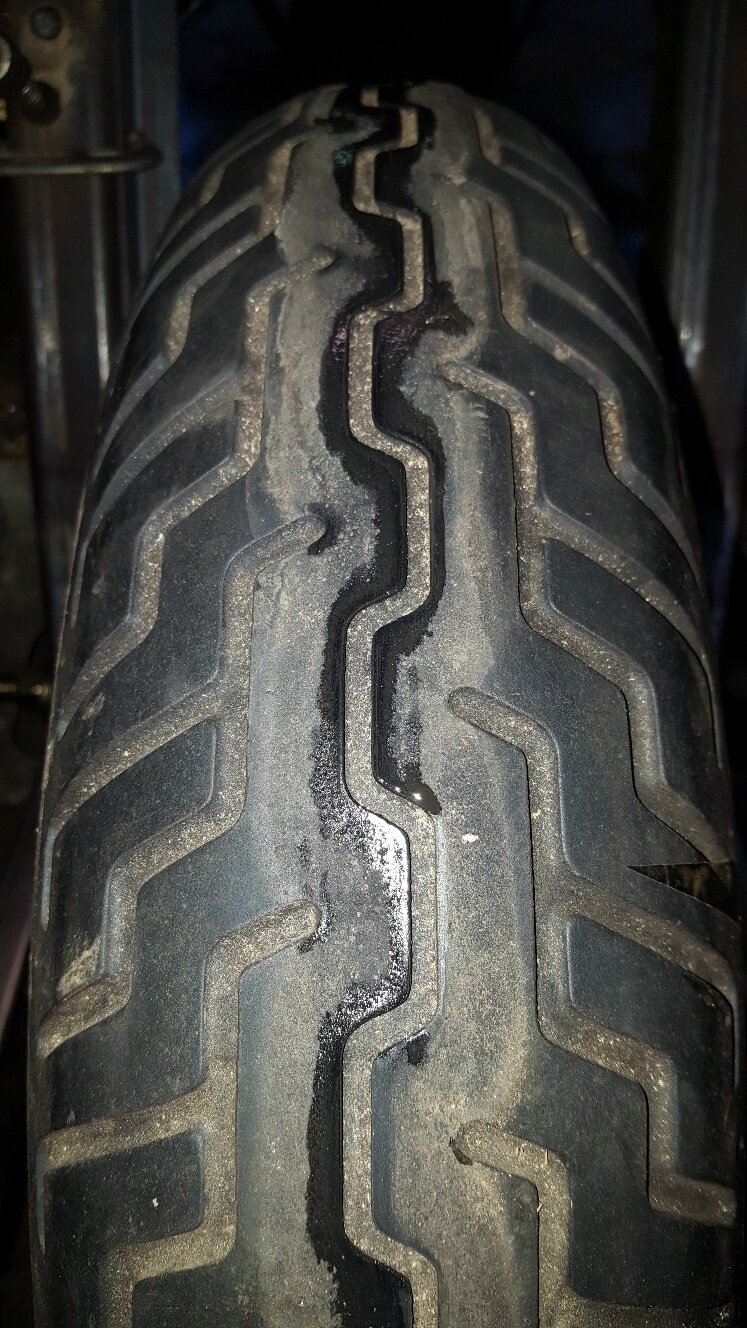

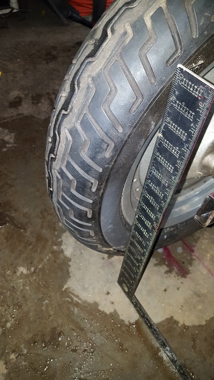

so I lined up my wheel
the square is lined up and you can see the water pattern on the tire where I spun the wheel.

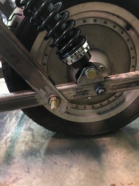

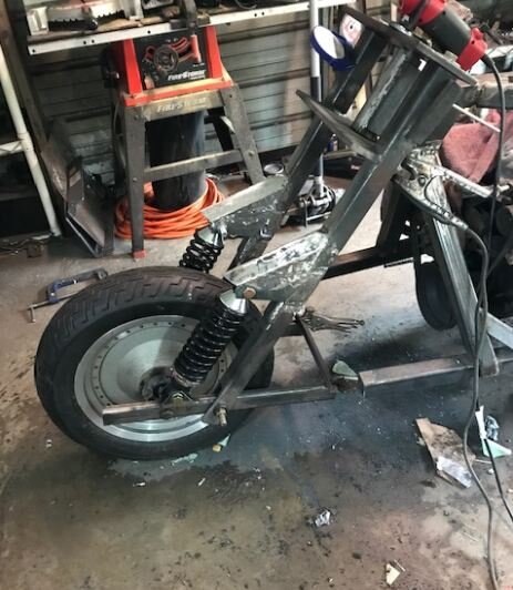

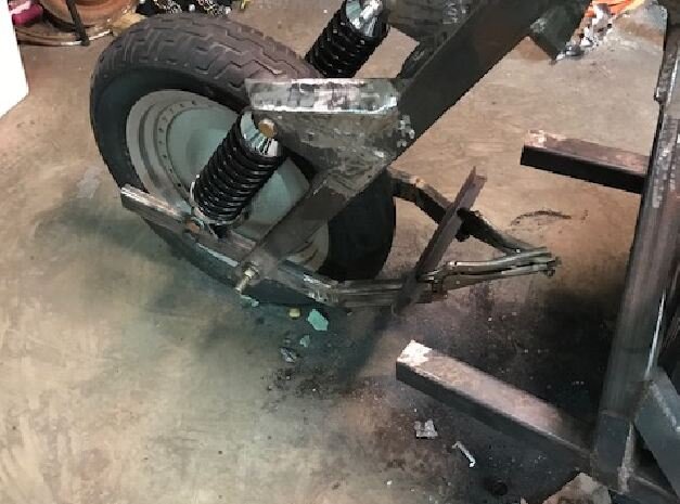

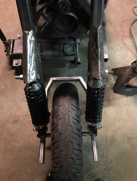

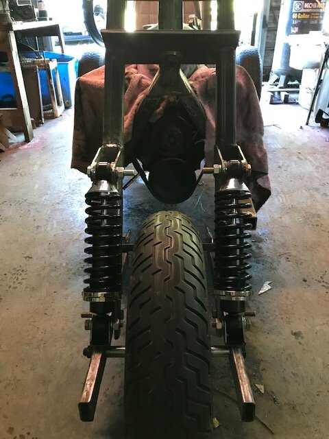

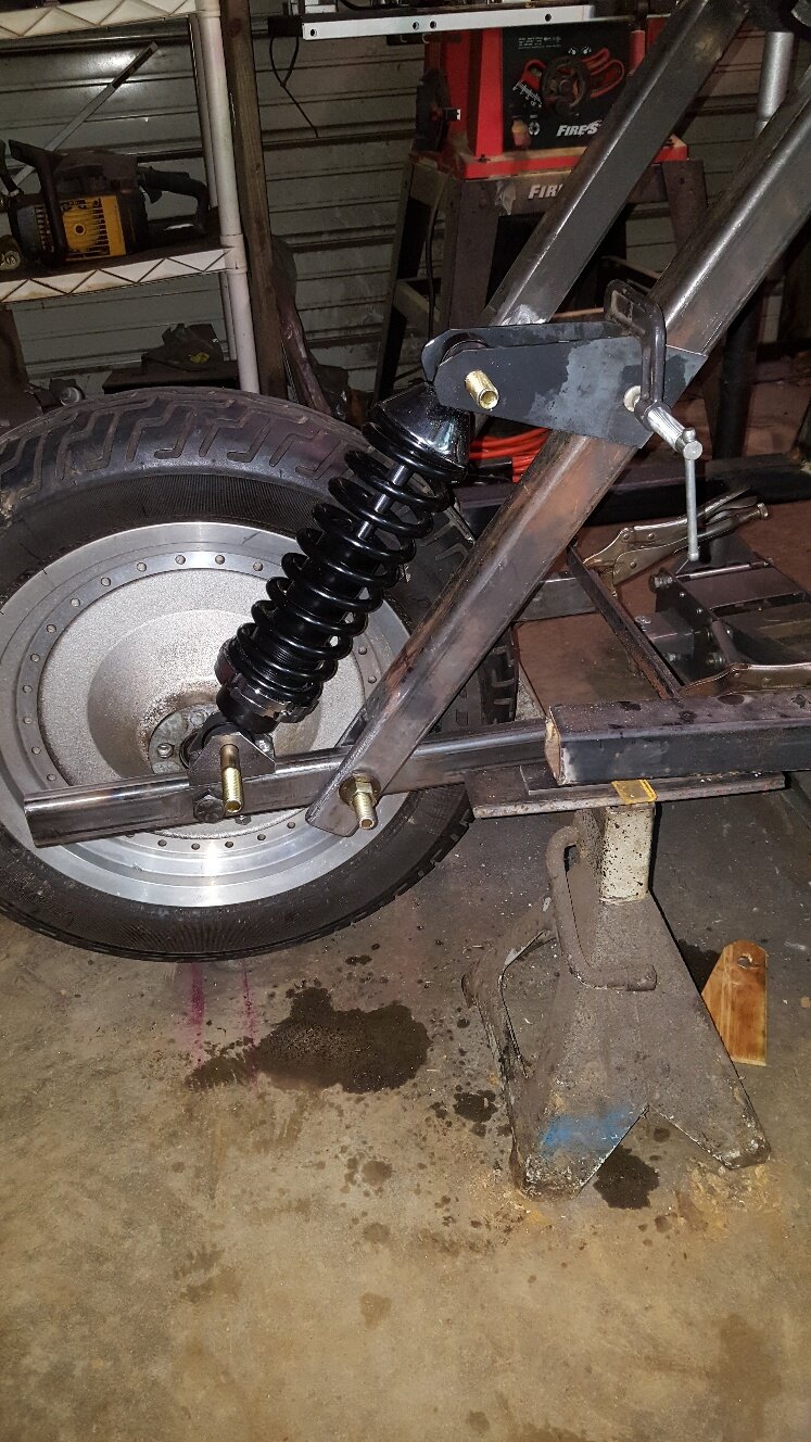

worked on the shock mounts today.
Just 1 side and only clamped in place for now.
The bottom mount is adjustable 1 inch forward or 1 inch backward. When I know its correct I weld it in place. I will clamp and tack weld the top until I know they are in the right place
each shock has a 200lb spring rate (400lbs together) So I raised the front up 1 inch from ride height, I am hoping that the weight of the front end will compress the springs 1 inch and back to ride height.

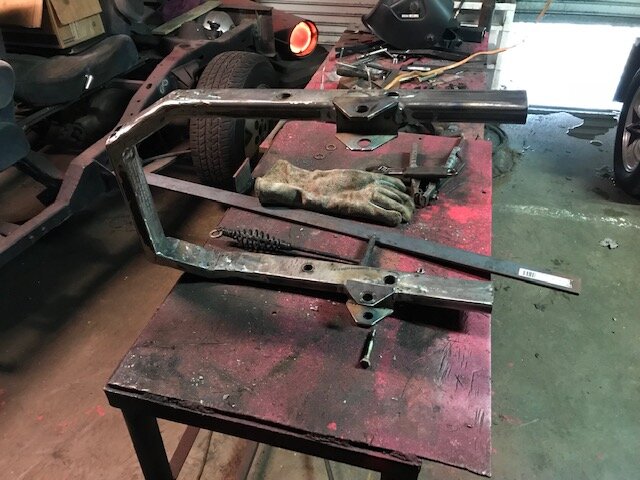

It is finally on 3 wheels.
The front end came out the way I wanted. It is strong and straight.
I only have it tack welded now but it looks good. I will weld up the rest and do the dress-up when i get more time

Looking good....you will enjoy the strength and stability of that fork for miles to come.
With front engine definitely the way to go. It's nice to have something major like that, decided and done.
I have been watching your build, mainly because I have to rebuild my front end and I am in that process.

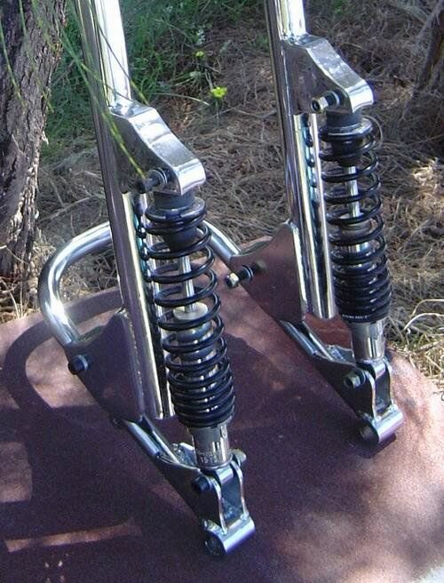

I had thought that the shocks would look better the way you have it set up, but than others who built the leading link style said that the shock needed to be on a slight angle so that you actually formed a triangle with the fork tube, leading link, and the shock.
I say if mounted in the fashion that you did yours, well the shock should react directly with the axle movement, but never built a front end, so what do I know.
My question is, have you been able to see how the shocks work and the leading link movement ?
I like how all looks nice and solid, should be a nice ride.
Not done yet though. I still have to finish the wrap around and some dress up,
Next weekend I hope to have the top to my fork mounts done.
Also the top and bottom of my triple tree sill has extra steel on it. I don't want to cut that off until I am 100% sure I don't need it
I bolted the top plate on my welding a 5/8" nut into a 1" then welding the 1" nut into the top of the fork legs.

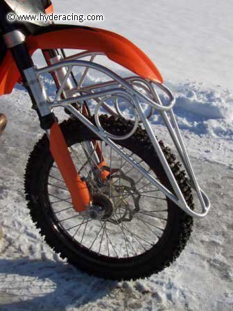

Never built a wrap around, but have researched a bit and all that I have seen seem to be a inch or two.
One thing is suspension travel, one wants to make sure that there is enough clearance for the rear of the tire to travel fully with out binding up.
Other than that, all that I seen was it being more what the rider likes and how it looks to them.
OH, okay one other thing that you have to remember, the travel of the steering side to side.
Remember as you turn the wheel the rear is moving the opposite direction.
For me with how my trike frame is the rear wrap around on the front end would wipe out my feet. All is just tight on my trike, but it is also why I am rebuilding my front end, partly to move the front end out from under the trike body and away from my feet some more.
Looking good, it is coming along nicely. :)
Also some use the wrap around for a fender bracket or attaching area for the fender. So that would be the closer wrap around and only about 1/2" on some front ends, this fender mounting distance also has to consider suspension travel of the tire so they do not hit one another.

Yesterday my son and I (about 400lbs together) both got on the trike, one of us one each side and bounced up and down like crazy. Everything held up good. No issues.

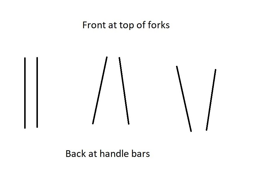

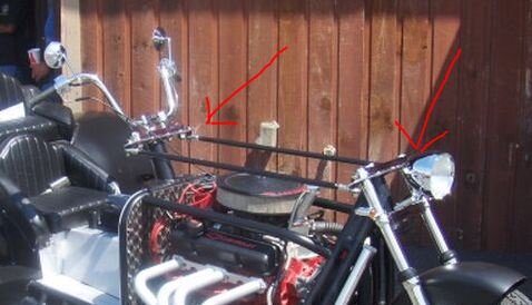

so next is my steering rods, rods connected at the forks going back a few feet to another neck and plate where the handle bars are at
I call it a push pull type steering
I plan to use heim joints with rods connected to them
What will give me the best steering straight, smaller at the front or smaller at the rear?
If I go with straight am I correct that wider is better?
if anyone has any pics of Trikes setup like this I would love top see them
not sure...but i think there was a thread here on trike talk about these linkage choices, maybe the non parallel linkages would bind up at some point in their travel? thought the thread discussed this?
Hopefully some one will remember.:confused:
the wraparound looks good, should be plenty rigid.
the 7 in tube will get your handle bars up to a good height.
I like the parallel steering rod idea, then handle bars do not need to be pulled back so far. Some bars are so pulled back it would be like tiller steering!

On the trike below the front and back necks and plates look to be about the same angle.
I was planning to make the back plate flat(not at an angle) and have bent risers on the front plate to make that connection not at an angle
agree on the plates being parallel with the link rods......or at least the last few inches of the plates twisted to be parallel.
