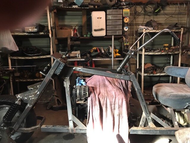

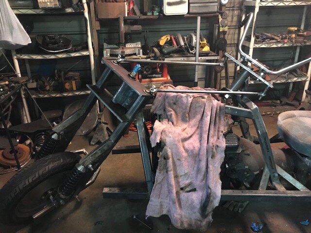

Got the neck tack welded in place. I may have to change the height and angle
My measurements are not correct though.
I'm off by 1/4 inch

I plan to connect to the top of the front plate and the bottom of the back plate

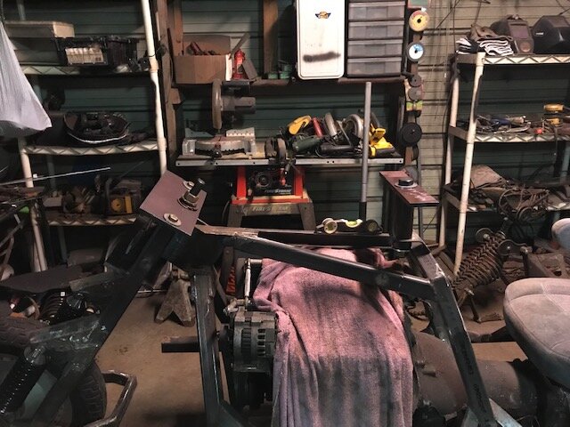

I think I see what VWbug means.....the front bar will swing in a tilted arc, whereas the rear bar will be turning an angle more parallel to the ground.......would that make the bars act as they were different lengths even if they are the same dimensions between heims? understand the possible problem, confused about the solution? or is there even a problem?:confused:
I understand what you are saying.
I just have it tack welded in place right now because I was not sure about the angles.
I was planning to use Heim joints
I will order the joints on payday and mock it all up just tack welded together
this way I can test the movement and change the angles if needed
I was drilling on the back plate pushing down on the drill and my tack welds broke
So I re-welded it back on but this time at the same angle as the front (as you all suggested)
It is just tack welded for now and I do not have any support braces yet. Once I get my joints in I will figure out the best working angles then weld it in place permanently
I may have to adjust the height of it also
Those will not be the handle bars I use. I stole them of a old bike just to have something there to work with. I plan to make my own handlebars
Looks like it will work if you come off the bottom of the handlebar plate and the top of the fork plate. Possibly coming off a bottom plate (arm) on the handlebar pivot to the top plate of the fork plate would give better alignment.

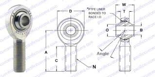

Heim misalignment angle is what to watch out for (Angle in figure):
This ia how i was planning to do it and I am still looking at doing it that way.
Once I get the joints in I will try different setups and stick with what works best.

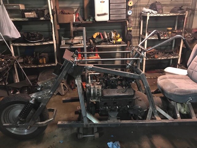

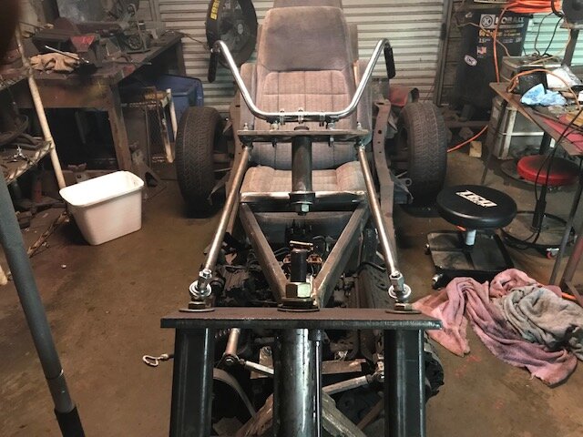

I worked on my steering today.
Like it is now my forks turn the same amount as they do on my other trike and that is good with the other trike. It has a 8ft wheel base
This trike has a 10ft wheel base. So I am assuming the turning at low speeds with be wider
It seems to be binding up at the end of my steering travel but I do not know what is binding
I was hopping that the forks would turn more. But looking at some others online they seem to be about the same.

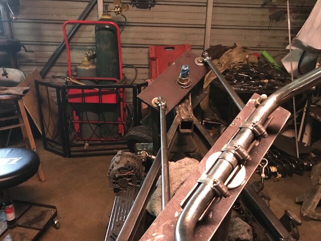

I remember someone on this site saying the link rods should be parallel to each other for their entire travel. It may be the camera angle, but the rods seem wider at the front?
I'm thinking that both neck angles and both horn widths would have to be the same to make that happen.:xzqxz:
Unless, you can move hole locations to make rods more parallel at the extreme turning angle?
just thinking outloud here:xzqxz:
I thought about that too Larry, but taking pic's a lot I learned how they can be distorted from the original.

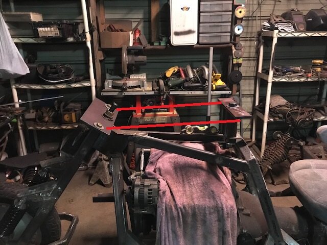

I am sure you had your reason for mounting the rear neck tube so high, but my mind says ideally one should have them on the same plane, same height off the ground, run the control arms from top of top plate to top of top plate so all is parallel and at same horizontal plane. As far as I know they should be identical in every way if possible, but what do I know I am still trying to get mine fixed and running.
All does look good, and all might still work, as Larry mentioned it might be fine fitting the control arms to the top plates that is the issue. Are the bends identical ? where top plates at the exact same angle ?
If the rear top steering plate is a bit higher from the ground than the front end top plate, but it is how you want it, than what about just using longer mounting bolts coming down from the rear top plate so that the control arms are horizontal, and need to be parallel the entire distance.
WAIT, let a few other's look it over and see what they have to say...……….some times my mind takes a very long hard way to get things done....not always the best answer...……...but do love the look of your trike and work.
Also: https://www.triketalk.com/forum/threads/25209-Push-Pull-Steering
Also, if you move the handlebar plate to the bottom of its neck, the steering bars will be more parallel to their plates and the pivot angles will be reduced. The steering bars would be tucked in more inline with the top frame member and all you would have at the top of the handlebar neck would be a post and plate just big enough for the riser spread. That would give you a lot more clearance for design options for that area.

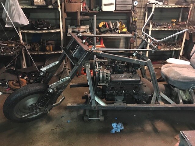

I got it to turn like I want it to. It turns easy with no binding
I did not get a chance to read your post until now but you all got it right.
My back neck it to high.
The reason I it so high is I thought it was working correctly at first and I liked the way it looks so I welded it in place
Come to find out after I tightened everything up I had a bind.
Now everything is tight and it works great
I just made the rear mounting bolts lower.
I have not dressed anything up yet but will make it look better alter on.
I still have some more work to do on the steering and front and but after that I think will I start on getting my Pinion angle, 4 link and shocks.

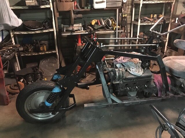

I really like how my steering came out. I can only test it standing still for now but I think it will work well (I hope)

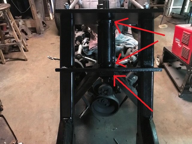

I have the front end apart finishing up the welds and such.
I will paint it with primer just to protect it from rusting. The real finish work will come later
I am suppose to work this coming weekend but if I don't I will get it back together
Got it put back together and did a quick spray pint on it for it would not rust
The bearings I used came with seals but I created "guards" at the top and bottom anyway.
I also added a spacer below the bottom plate. My bolt was to long and did not want to sped the money for a new one. A grade 8 1" X 13" bolt is not cheap (had to be long for the shank part is on the bearings not the threads) I will cut the extra threads off later
