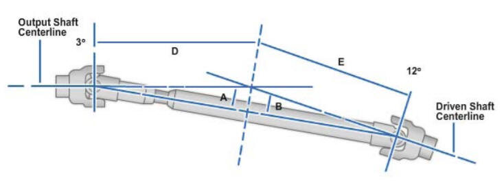

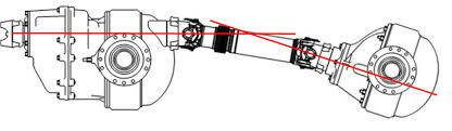

Bob ....one method the guy in the video didn't mention was the broken back method of eng/trans to differential angle setup....It is sometime used by lifted trucks, but more by tandem axle (twin screw) where drive shafts are short,
but, take a google of broken back drive line geometry.....not saying it will work in your case but it can have advantages in short shaft situations.

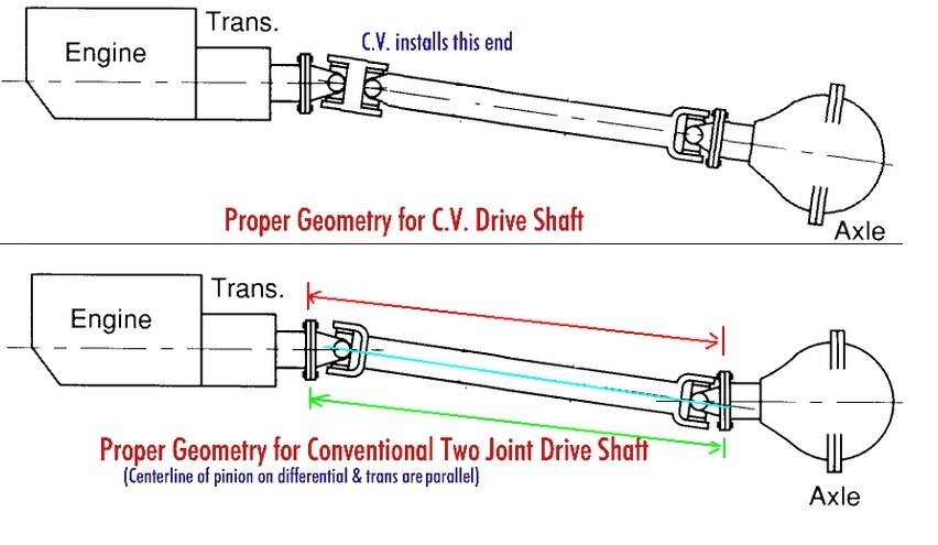

so I looked up broken back driveling geometry. but did not find a lot of info.
everything I read about a drive shafts with a single U joint on each end is that a parallel or a In Line setup is best as long as the angle is 7 degrees or below. I have read some that say I can go up to 15 degrees but I not sure about that.
Mine will be about 25 inches long and 4.5 degrees (4.573921259900861) with a Parallel setup.
If the distance between my yokes was shorter and I could not get below the 7 degrees then I would have to think about a different setup. I would use a double cardan (CV)
Not the expert, but have replaced to many U joints on drive shafts in my days.
I have seen that 7 degree's, maybe a bit more, not what I like now that I seen the straight lined shaft setup.
I do wonder if your low degree and short length will make a great drive line set up. To me it does sound good and much better than longer and more degree's, but that is me. Please keep the updates coming as I am learning as you go.
drive shaft1.jpgdriveshaft.jpgstrange, that accepted drive line geometry is called unsuitable in that google image.....but these configurations are mainly used in trucks, that have low gears and high driveshaft speeds also. I have never used these angles, and they look odd but they are used often, and with the same joint angle at each end and yokes in phase they work......now, in your application this may not be desirable or needed. Maybe they are best left to trucks.

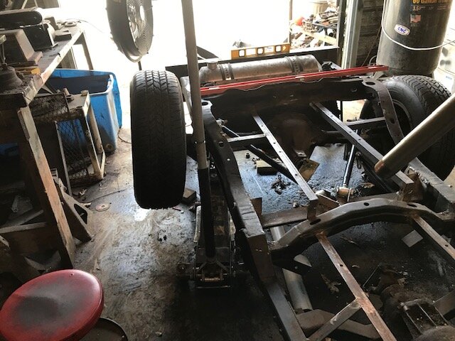

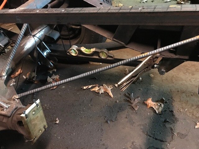

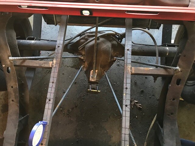

I got my rear end tack welded in place.
It ended up 1/8 inch to far to the left (the right as you look at the picture)
I took all kinds of measurements, had it all strapped in place, welded in the rebar, took my strapping loose and it snapped back 1/8 inch to the left. I think the rubber tires moved enough side to side to throw me off some
My other measurement are still good
I don't think 1/8 inch from 1 side to the other will matter.
I would not sweat that small error.....n.d. trike regs say centerline of rear wheels must be centered within 1 inch of the front wheel track. The dimension that i would watch, would be to keep the rear end square with the fore and aft centerline. Otherwise the rear end would in a perpetual turn, trying to pull the front wheel sideways.
Others, may have more and better information. just my .02
View attachment 68080View attachment 68081strange, that accepted drive line geometry is called unsuitable in that google image.....but these configurations are mainly used in trucks, that have low gears and high driveshaft speeds also. I have never used these angles, and they look odd but they are used often, and with the same joint angle at each end and yokes in phase they work......now, in your application this may not be desirable or needed. Maybe they are best left to trucks.
best explanation
i have ever seen on the subject

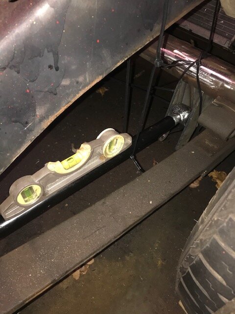

working on the side lower parallel pars first
They are just mocked up in place, held on with zip ties and vice grips
In the pictures the ends are screwed all the way in. I think I will screw each end 1/2 the way out in order to give me some adjustment room if needed

I got the lower parallel links tack welded in. Did a heavy tack weld.
I would have welded them completely but I did not want to lay down on the cold concrete
Will work on the top triangulated links next

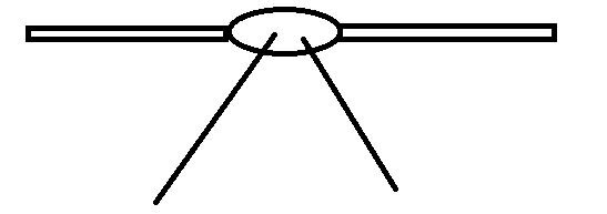

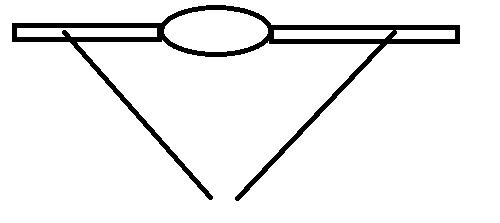

Need to decide on the direction of the links
1
or
2

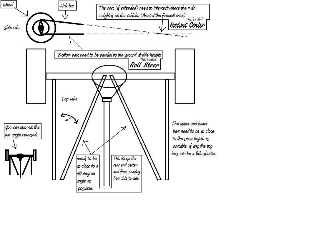

Bob, from your previous drawings, it looks like you can go either way with the taper of the upper rods, as long a the correct angles are used. the only consideration to me, would be how can you use the space given. passenger foot wells, storage, battery location etc. I do know that every last area will get used for something!

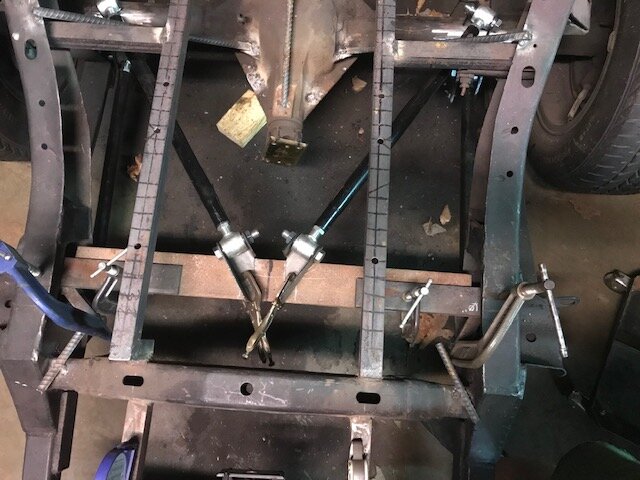

mocking things up this morning
The brackets that came with the link kit are set at 30 degrees.
I realize that I am using them in a different location than they were intended but they are still 30 degrees from center
What I do not like about them is the 2 shown in the pic below are only 3/16 thick. All the other brackets that came with the kit are 1/4. I may make my own or beef these 2 up
I was originally thinking of going with 45 degrees but anything over 30 degrees will be hard to do with the width of the frame. It can be done by changing the angels from \/ to /\ and then cutting the link bars shorter, but I am not crazy about that idea.
I need to drop the cross member down about another 1/2 inch
I will have to notch it in the center for the drive shaft. I will reinforce that area once I do that
The cross member is wider than I wanted but that is what I have and the local hardware store if out of anything else

I think if the upper tubes are 3/16 wall that should be fine....to me the weakest link would be the joint where the bushing meets the threaded rod. the upper and lower rods will share the rear end twist up under load...the only other load for the V bars would be sideways bending/shearing, but on a trike the cornering forces should be less than a car. my .02

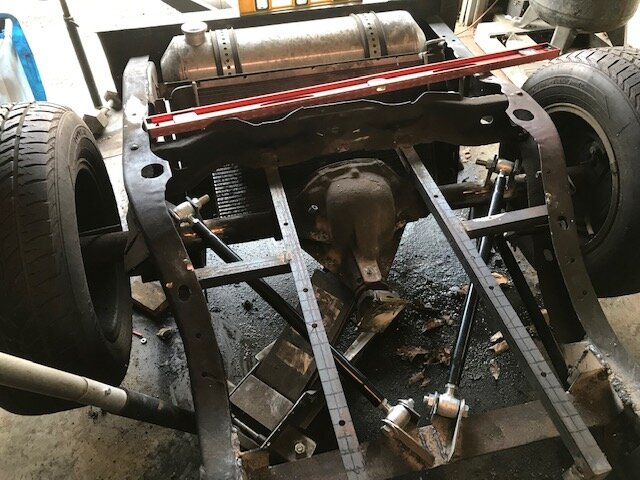

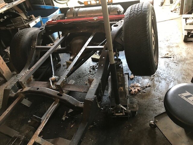

worked on it more today
its all in place but needs adjustments
On the top links they are 30 degrees and just a little higher in the rear
I am having a problem with my welder. It is not feeding the wire steadily. I think I need a new roller on it.
So I am not finishing the welding yet.
It moves up and down good.
Axle Up
Axle down
right wheel up
Left wheel up

adjusted the rear link system it was off by 1/8 inch I have it down to 1/16 off
