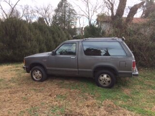

I am going to look at a 88 blazer tomorrow as a donor.
Getting it for a good price for what it is

I just got home with it.
Yep it is 4wd. I have researched how to convert the Trany to 2wd and looked up the parts.
That along with a rebuild kit will run me about $400 (will go with a beast sun gear)
Or I just buy a replacement trany
I was looking for a 2wd s10 but could not find one in my price range.
It was crazy driving it home. The steering is so loose. I passed a cop and was afraid he would think I was drunk.

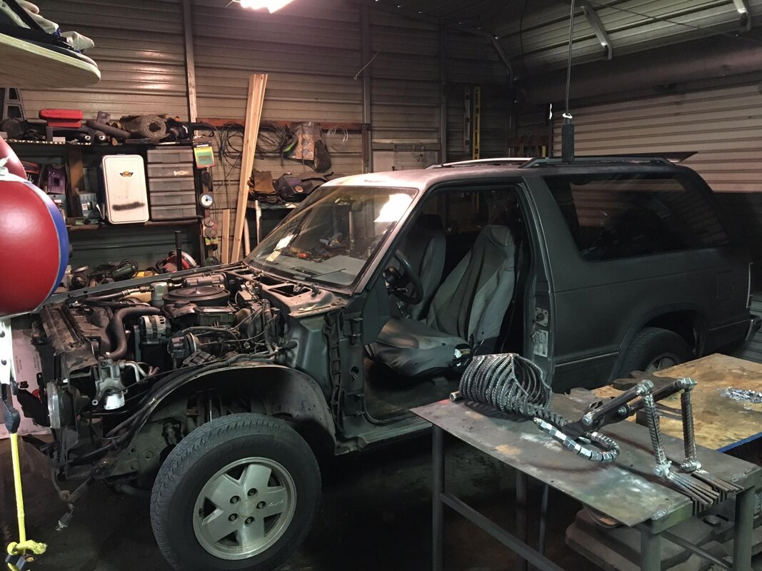

well Fowler.......good to see a project under way! remembering killing mice during disassembly of the datona!! lucky they hadn't damaged the wiring much...car had sat not running for 11yrs. it appears that you are starting with a live one! but whats with the dead on the welding table?? larry

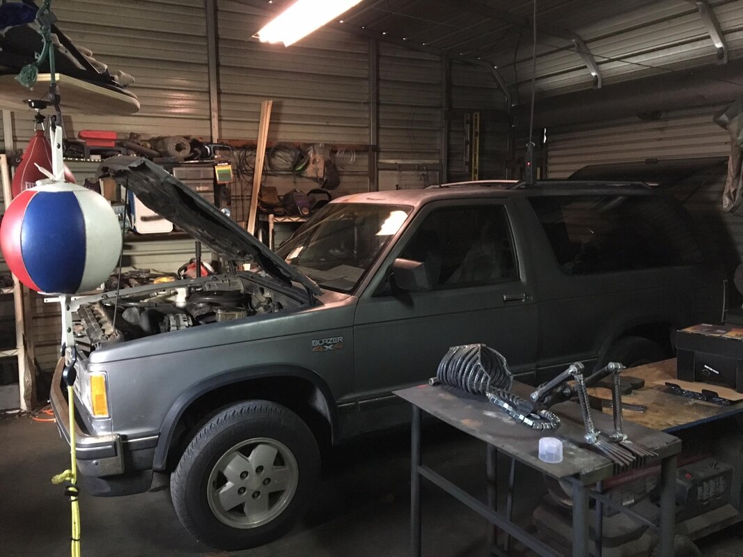

So far it is coming apart real well. The power steering has leaked all over, and I did catch it on fire when I burnt the door hinges off but I was ready for that.
Don't need the power steering so I don't care about it not working.
This coming weekend (if I have time) I will take the other fender off and then start taking what is not needed from the engine compartment
The dead thing is a dog I am building. It does kind of look like a dead creacher when laying on its back like that
