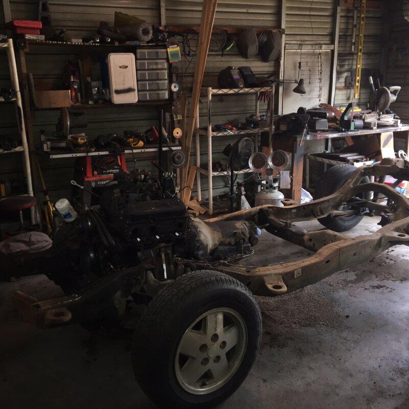

Tore more of it apart today
Before
after

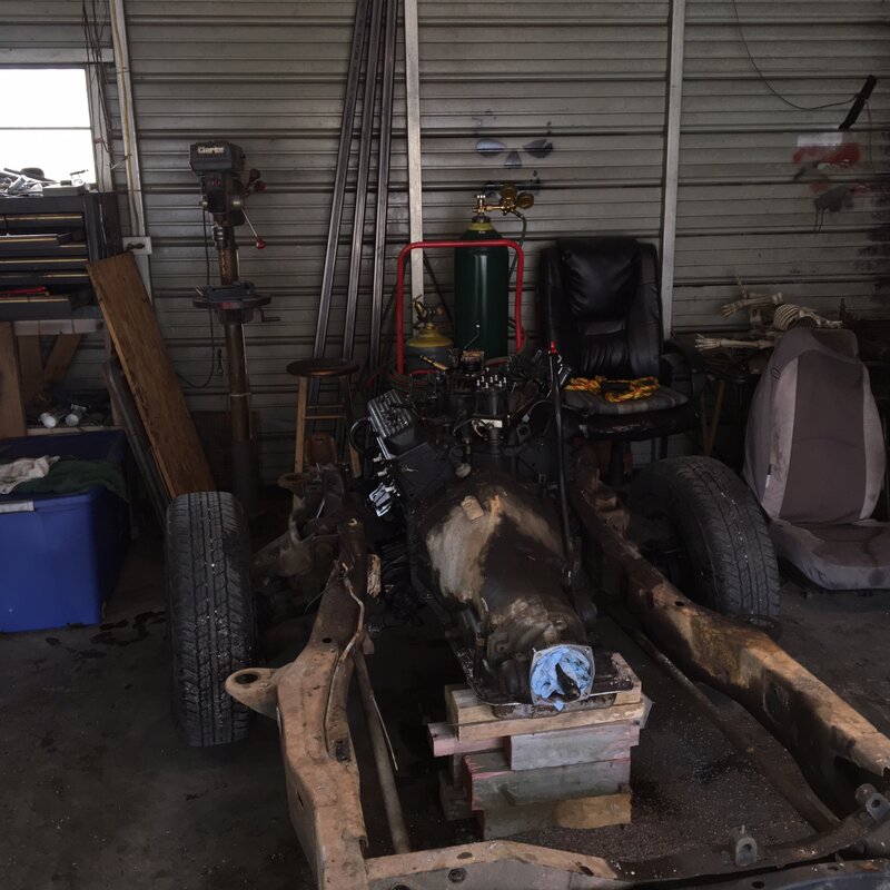

I am thinking of making a wooden engine/trany cradle on wheels. It will sit at the height and angle I want the engine and Trany to be on the trike. This way I can build my front frame and engine mounts around it.
I have not down it like this before but in my mind it sounds like it will work
My friend is promising to come get the body tomorrow after work.
I pick up the steel Friday going with 2 x 2 x 3/16
That sounds like a good strategy (making the engine and transmission free standing). I made feet mounted to my engine that allowed me to block the engine up to get it where I needed it in the frame. Working with a heavy engine with heavy transmission bolted to it us both dangerous and potentially costly if it is dropped and parts start getting snapped off! My advice is to build your cart stronger than needed and don't go cheap on the wheels. Get some nice heavy duty wheels. They can always be recycled for future projects.

all stripped down ready ready to pull the engine/trany.
Still have not decided on the rear end yet. I really like the look of the leaf springs but they are so stiff
Next steps in order
1. pull engine/trany
2. build stand and place engine and trany on stand
3. correct pinion angle on rear end with shims
4. Weld in cross member just in front of forward leaf spring mount
5. Cut old frame just in front of new Cross member
6. Build front frame and engine mounts
7. Attach front frame to new cross member
I think doing it this way I still give myself the option of using either Coil overs or Leafs. I like the look of the leaf springs but they are stiff. I can take out a leaf or 2 to see how that works but I just dont know. I have read that coil overs with a 4 link are a better ride
Also doing it this way still gives me the option to build the rest of the frame and narrow it if I decide to do that.
I do not want to limit my options just yet
Now that I think about it maybe # 3 (pinion angle) should be last
