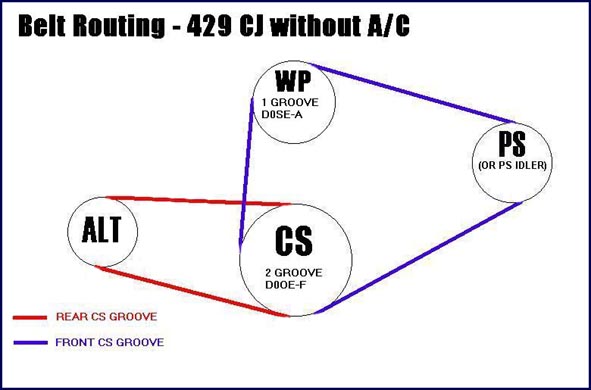

Yup. Then you could go to something like this:
Easiest picture to find on Web. Think of ALT in place of PS. Delete red belt.
The belt routing you have now causes the wp to rotate counter to the cs. The new belt routing the cs and wp rotate the same way. Probably v-belt set up would be easier. Lots of GM stuff is interchangeable.

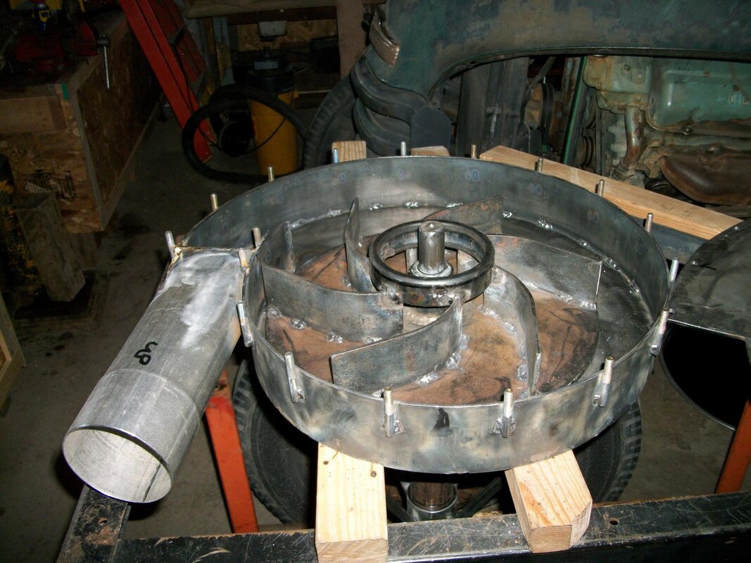

bob....looking at the water pumps pictured on your last page....the one on the left , the impeller turns clock wise, flinging the water outward while sucking water in under the impeller. turning that same pump around, the pulley end would have to turn counterclockwise......meaning its driven by the backside of a serpentine belt. hense, reverse rotation.....the pump on the right would be a v-belt pump or clockwise rotation as viewed from the pulley end. hope this helps! larry
reply
this is an 18 in dia pump I made in 2011. rotation as you see in the picture is ccw. the discharge is 4 in. pto driven from tractor....the pump suction is thru the bearing race in the center....the water flings outward in the volute housing to the discharge pipe. there is a cover with a bushing that bolts over the housing. the pump is screened over the race and is turned over. there is a shaft and a 90 deg. gearbox to drive it it will push 4 in stream of water thru more than 100 ft of pipe,....2011 was a wet spring and some of our property is low ground, so a spring project! larry
The clockwise rotation pump could be driven by a serpentine belt also if the WP pulley was changed from a smooth (Belt back side) to grooved (Belt front side) pulley. That way you could use an ALT pivot mount to act as the belt tensioner. Just need to make sure you have enough belt contact area on the WP so it won't slip and squeal. With this arrangement you can reuse your serpentine crank pulley and ALT pulley. Just need a shorter belt.
