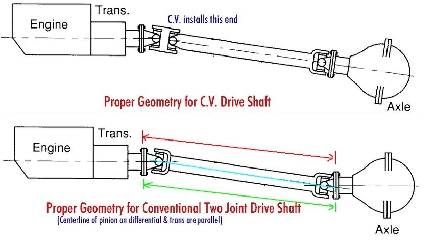

Fowler... could you lower the tailshaft a few inches to help decrease drive shaft angle? some eng/trans angle won't hurt road clearance much because oil pan is so close to motormounts, also carb, if used would be closer to the right angle, just thinking out loud! larry
I wish I could
I have had the trany and rear end at every angle and distance i could think of. It only works out if I make it longer than I want, angle the trany more than I want or go with a CV/Double Cardan joing
I have settled on the double cardan

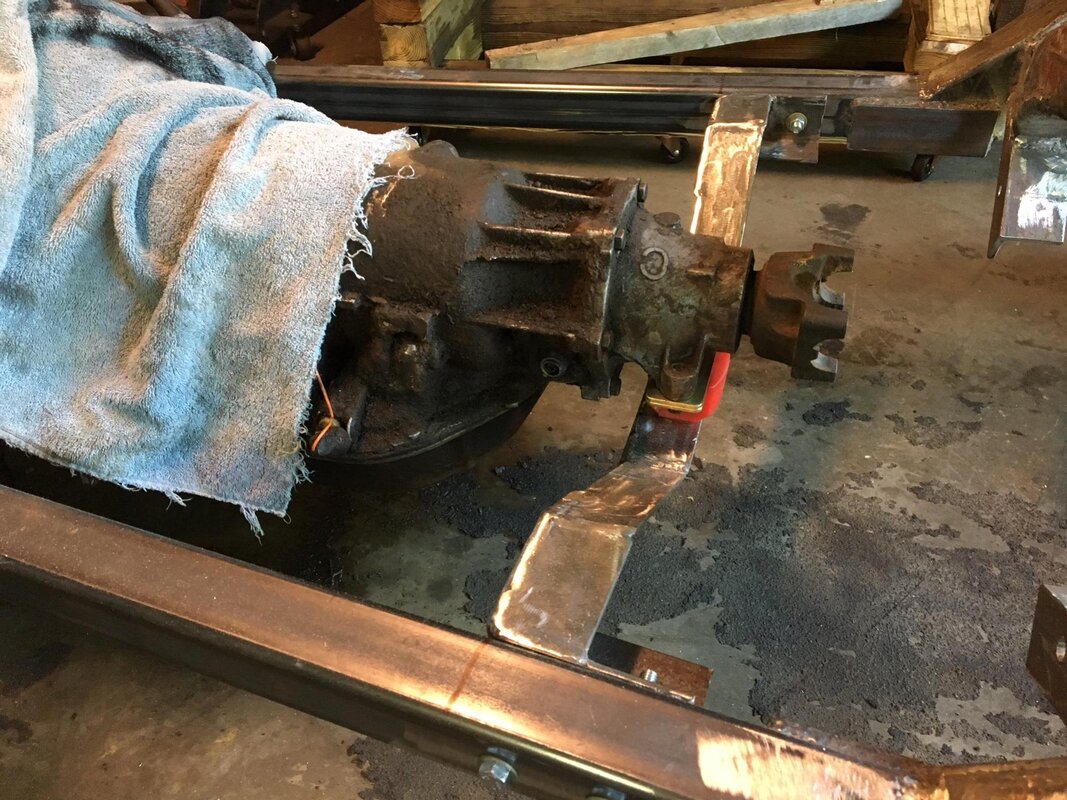

I mounted the Turbo 400 on the engine last night.
I have it level like I did the 700r4
BUT the output yoke on the 400 is now lower than the 700 was by about 1 inch. I am not sure why
I will have to re-figure my angles and drive shaft length before I go any further.
I have enough cash saved up to buy all the mounting hardware I need. But need to be sure on the angles and length first

With the 700 the distance from the ground to the center of the output yoke (with it level) was 2.5 inches
Now with the 400 the distance from the ground to the center of the output yoke (with it level) is 1.5 inches
This actually works out good for me

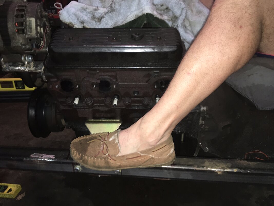

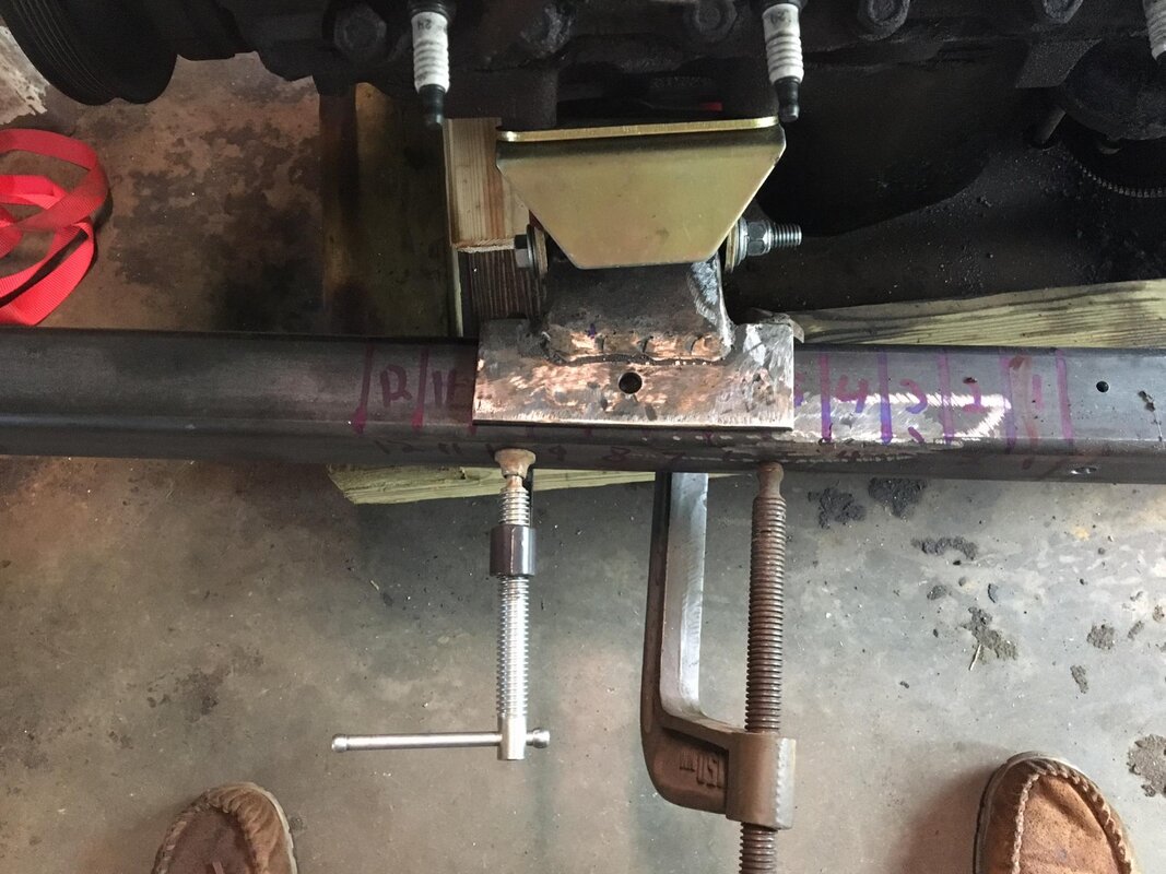

After looking over a number of different options for engine and trany mounts I have finally decided on going with something like this.
I figured it would be easy to find and replace if needed in the future.
If I went with a different type lets say a round bushing type. I would have to remember what busing I used.
These are standard for the engine and Trany so as Long as I know what engine and trany I have i can get the right replacement part
They will go on a Chevy 4.3 V6 and a Turbo 400 Trany

I talked to Shawn at Tom Woods drive shafts, he suggested I do not go any more then 20 degrees on the double cardan drive shaft for my application. It will be about 7.5 degrees (will make the final measurements this weekend)
