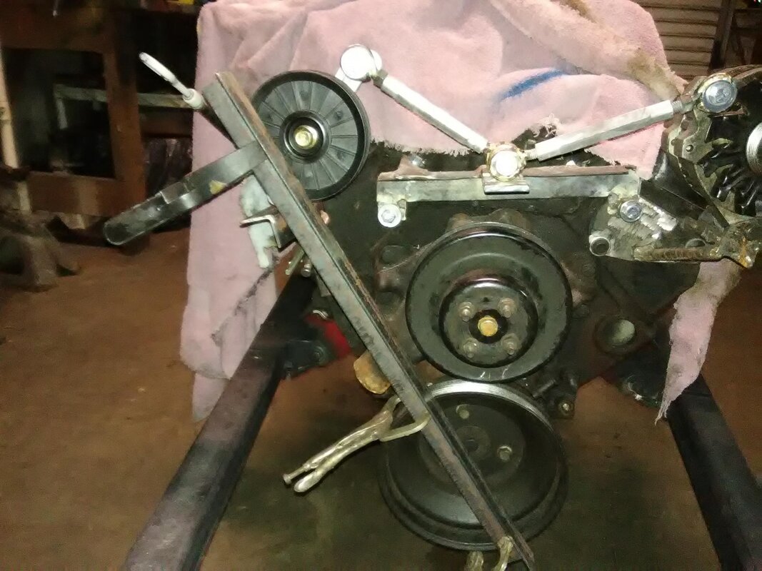

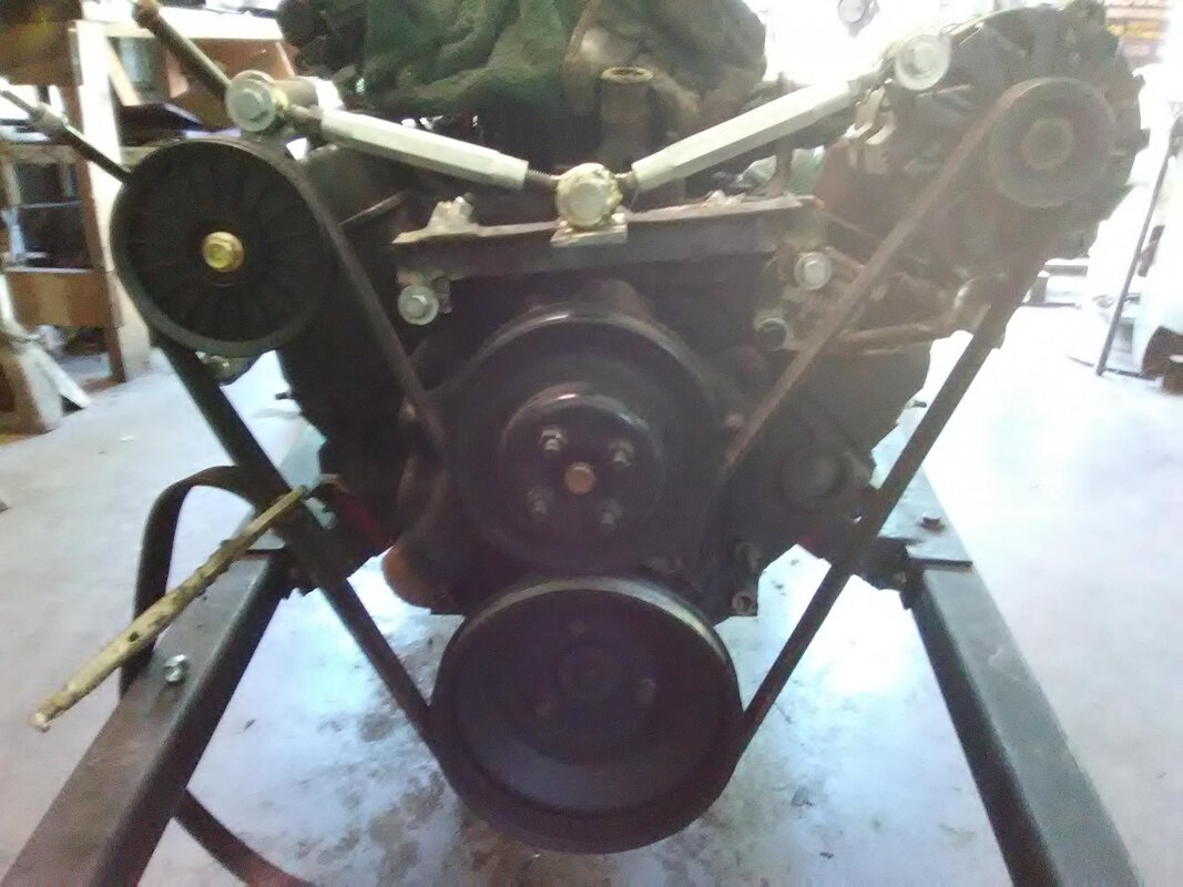

Installed a dummy pulley and made adjustment brackets
I made it for it can be adjusted at 2 points. This way I have more choices of belt lenths
Not sure if I need to make rear stabilizing slide brackets or not yet
I noticed my dummy pulley was very slightly out of line
I am redoing that this time I am using the same type of "jig" setup I did on the altenator
Replaced the rear brace. I will shape it later

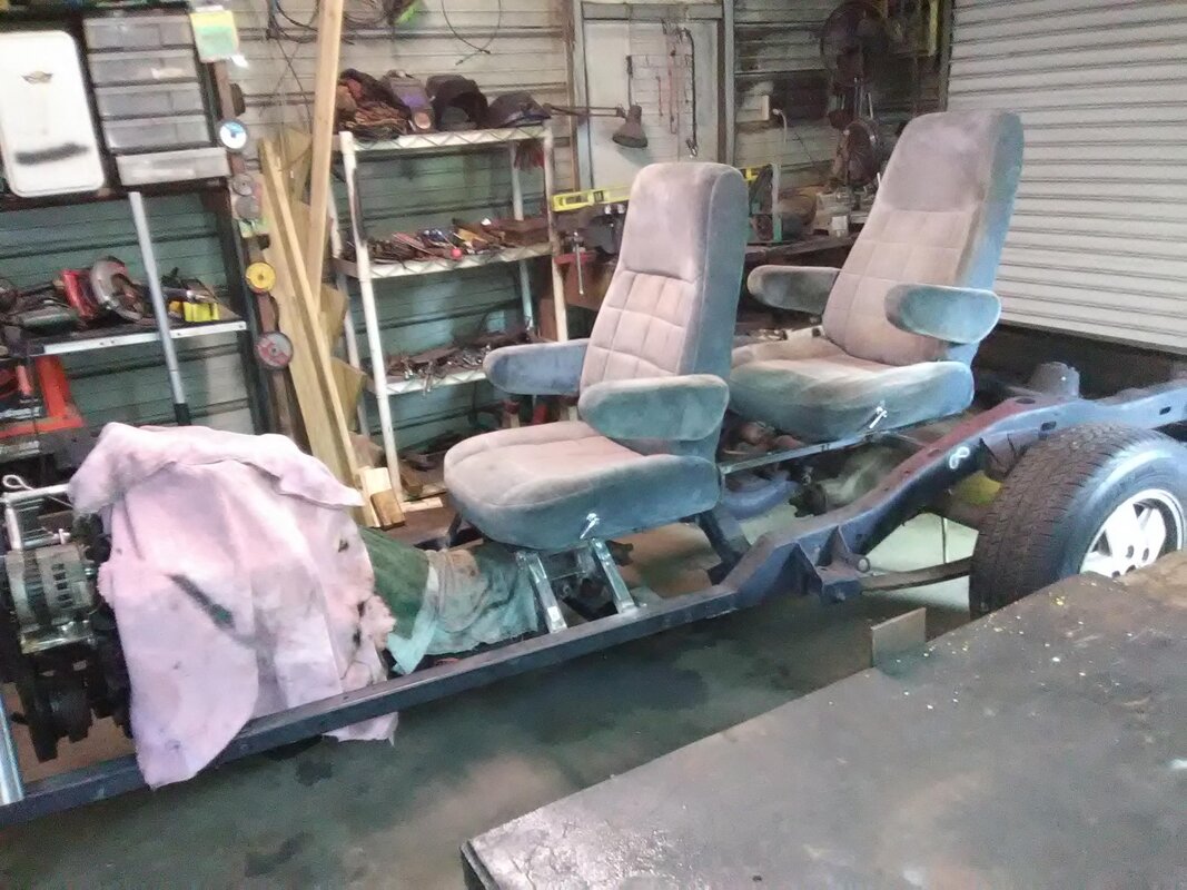

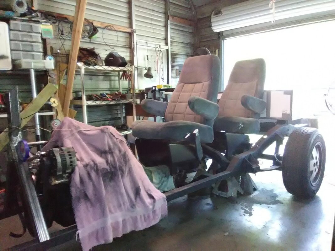

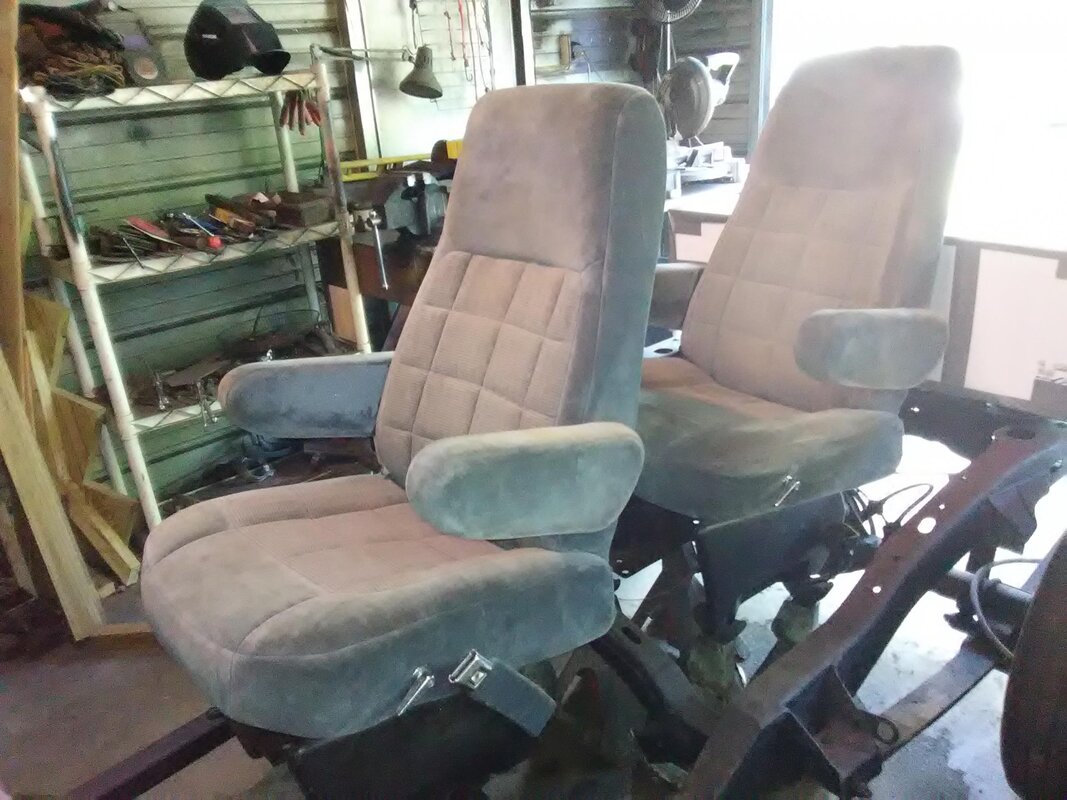

A couple hours ago I traded a old broken riding lawnmower for a couple bucket seats
Will need to build a frame for them to sit on then lower them and spread them apart
They are cloth but I am thinking I can get water proof covers for them.
Th guy did not know what they are out of. He though maybe some type of Ford truck
Got the seats mounted.
They take up a lot of room making my trike longer than I wanted.
BUT the Ol'Lady wants leg room and you know the old saying "Happy wife Happy life"
Since I had to move her seat back that takes up the room I was going to use for the gas tank.
Now thinking of having the gas tank underneath or over the engine like a motorcycle.
Tank over the engine seems pretty scary to me. Don't know what you plan on using but my 9.5 gallon round tank fits nicely behind the rear seat of my trike. Same here, wife wanted some room to stretch out.

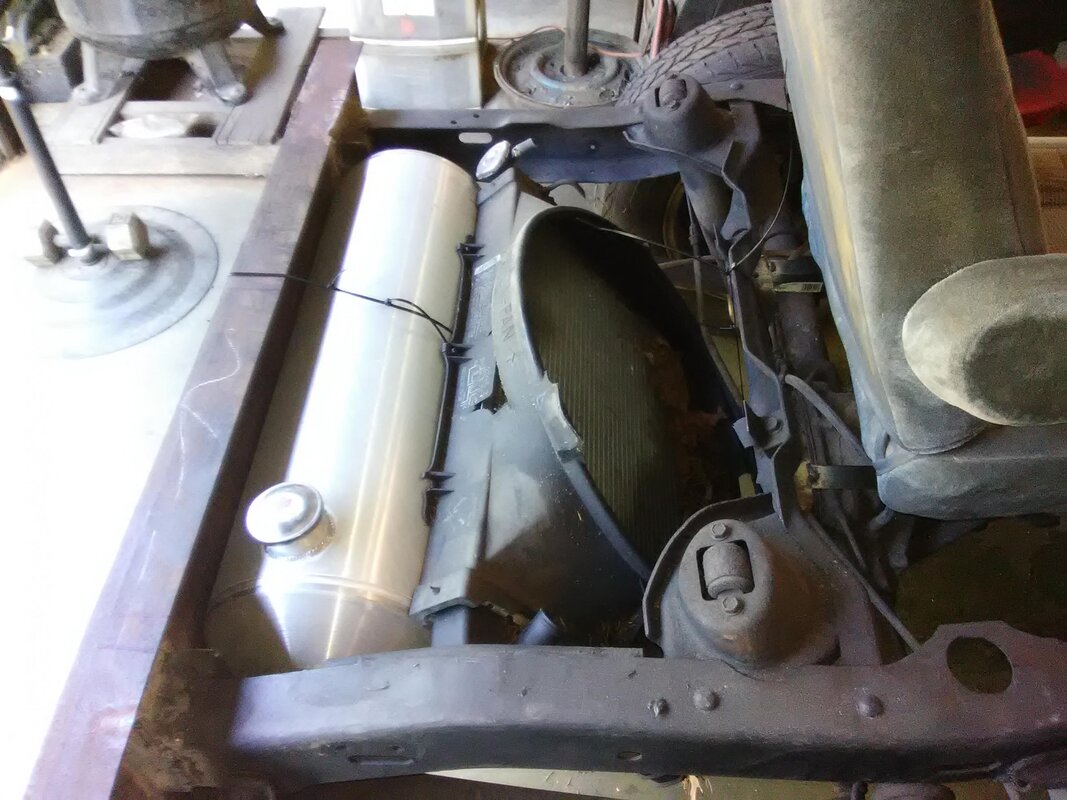

I could put it under the truck bed but that is where I plan to have the radiator (with air being duct to it)
I need to leave room for a brake booster and master cyl also. I cant fit everything under the seats.
Need to mock things up with cardboard and foam to see how they will fit.

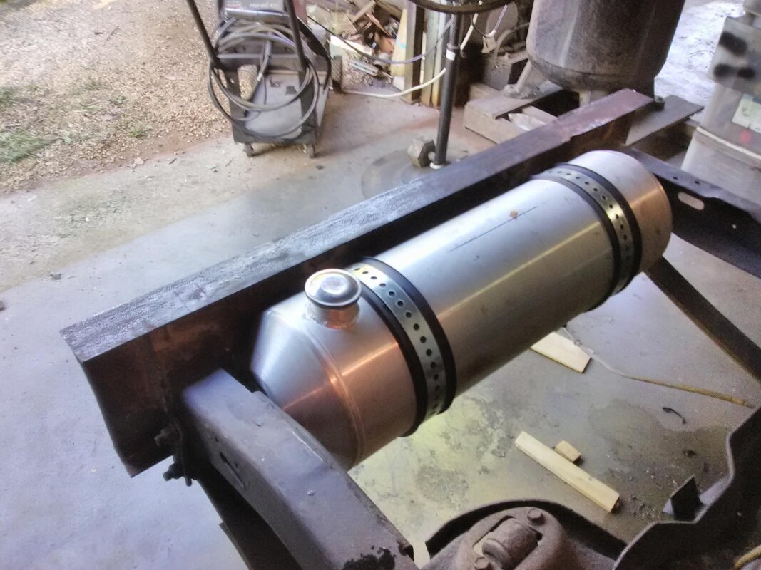

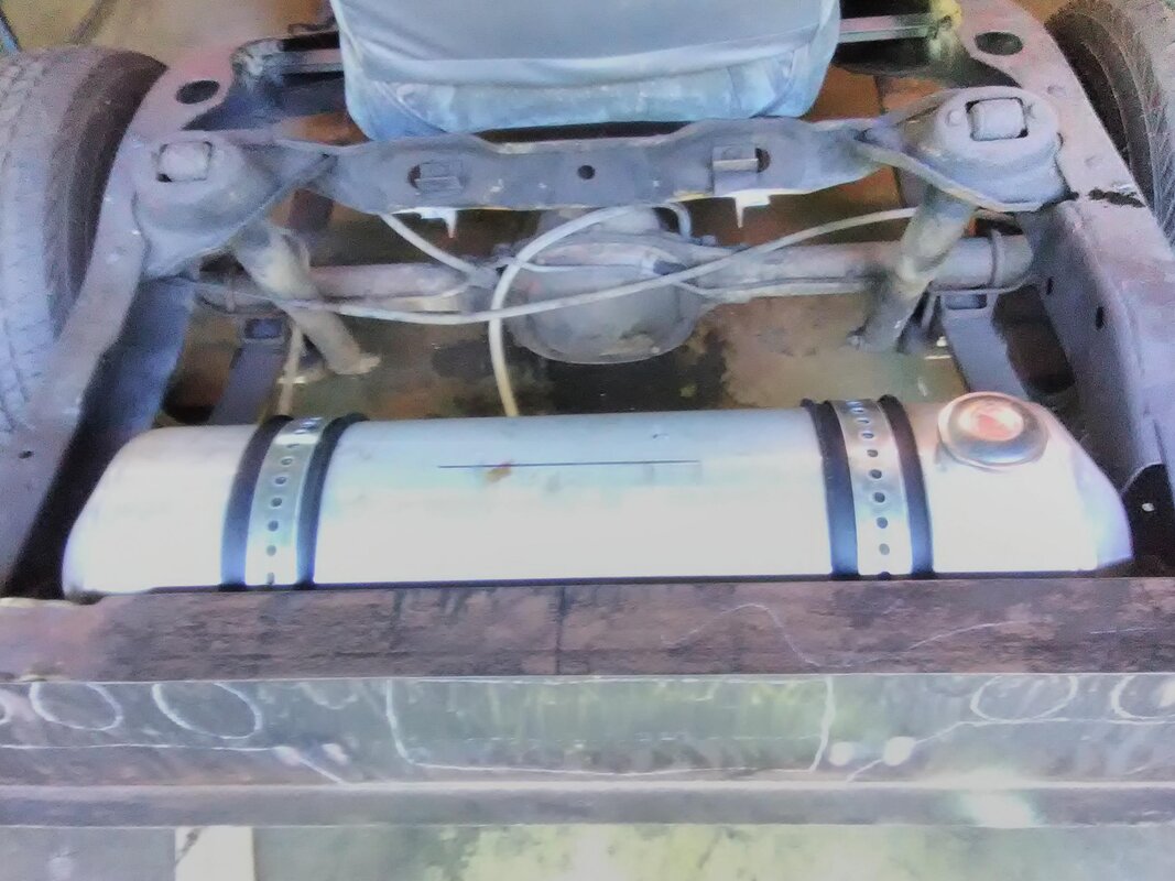

How about this?
This is only a 9 gallon tank but it allows me to use what I have. I would like a bigger tank though
The tank would actually be a inch or 2 higher allowing more air flow for the radiator
I would not use that shroud on the radiator. I would use a couple electric fans.

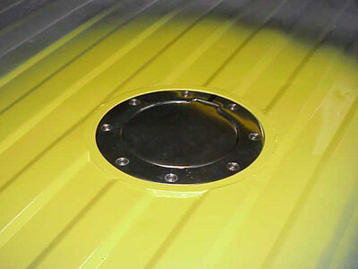

The fill for the gas tank and the radiator would come up flush with the truck bed. I have seen some nice flush mount truck bed gas caps before
like this
