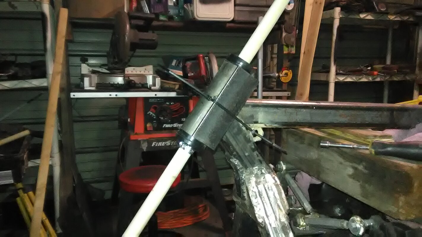

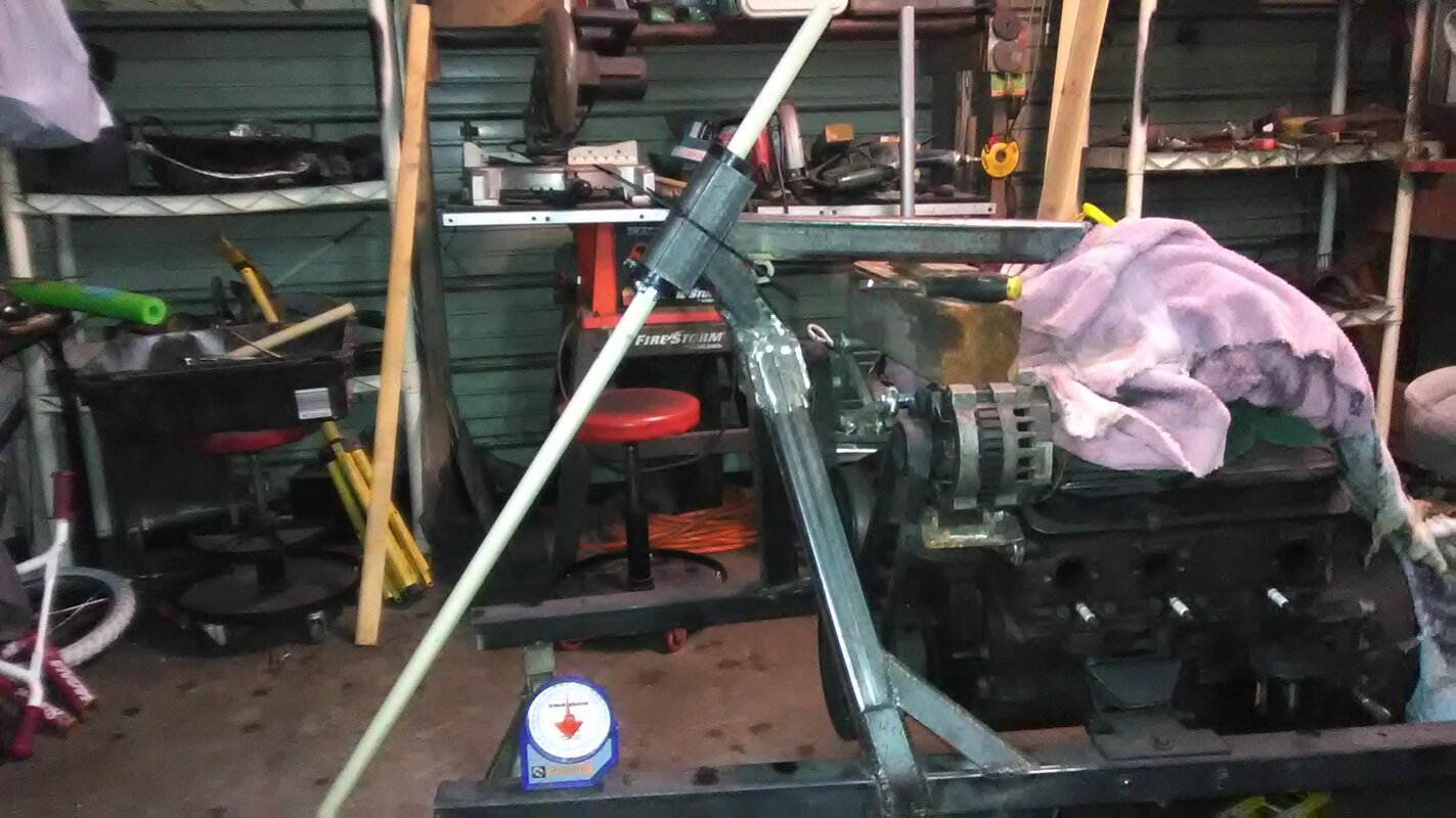

35 degrees
just hanging there now
Lots of measuring ahead
Will tack in place then weld the hell out of it.
I plan to use 1/4 inch gussets/bracing on the top, Bottom and sides
The neck itself is sitting in a 1/4 thick channel
The top bar you see there will be cut back and then 2 ran 1 on either side of the engine

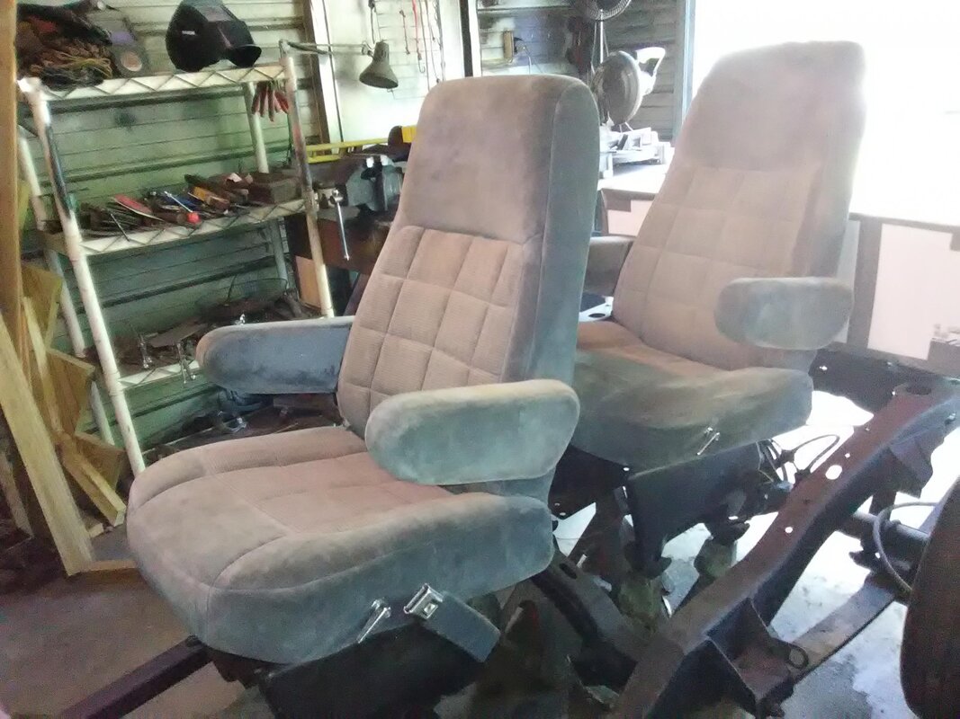

With the seating I have this Trike is way longer than I wanted it to be.
Right now it looks like my wheel base will be 11 ft.
I want to get that down to 9ft if possible
I have to rethink my seating area to shorten the trike

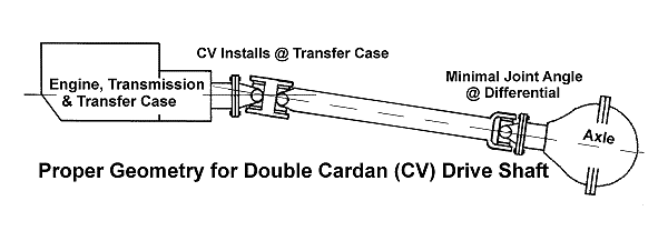

with the wheel sitting in approximate place with approximate 2 inch trail I measure approximately a 10ft 4 inch wheel base
I have 24 inches between the trany yoke and the rear end yoke.
I could cut 10 inches out of that leaving 14 inches and use a double cardan drive shaft
That would leave me a 9.6 wheel base
My question is is it worth it.
How bad is having a 10ft 4 inch wheelbase?
Per Tom Woods custom drive shafts website
Our 13.375" CV drive shaft will have a "safe effective and usable stroke of 3" allowing for 2.25" of spline engagement with the slip yoke at designed full extension. Longer working lengths will allow for a greater range of travel and tend to cost a little less.
