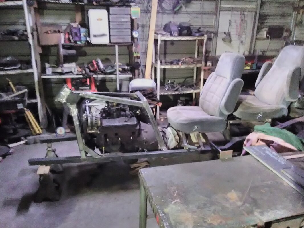

did some more work on the trike yesterday.
Need to finish up the welding today adding some gussets and braces here and there.
Sorry the low quality of the picture. The camera on my phone sucks
I left plenty of room around the engine on purpose.

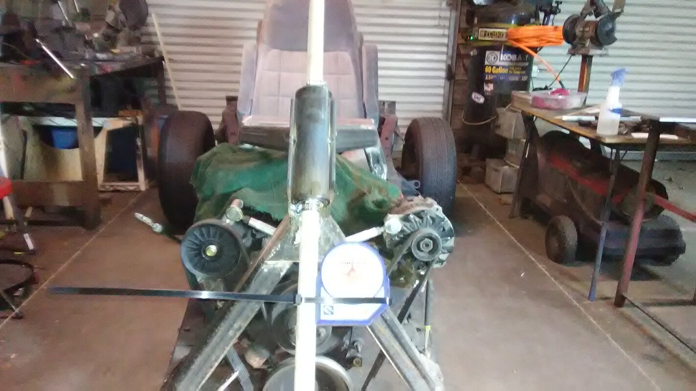

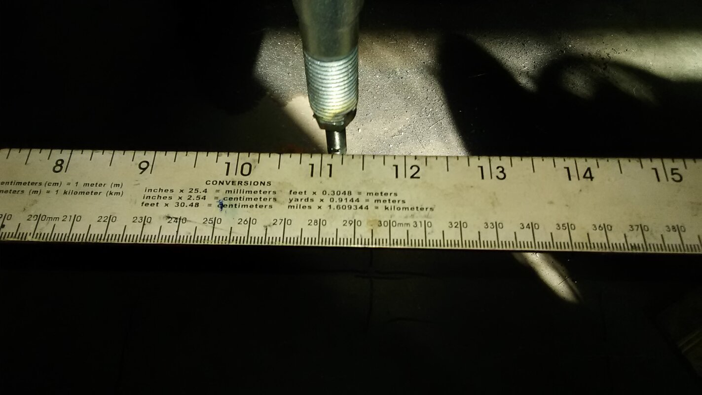

from left frame to right frame is 22 1/4
So I should be 11 1/8 center
Im a little off but not much
Measuring with my my homemade plumb bob
I also took measurements from different points on the frame to the top and bottom of the neck

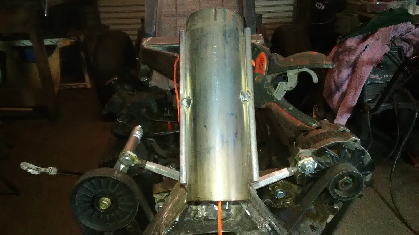

Neck is just tacked in for I can adjust it one way or another if needed
I split a 2x2 square tube down the center, 1 on each side.
I was going to use a full 2x2 but it took up to much room in the center open spot.

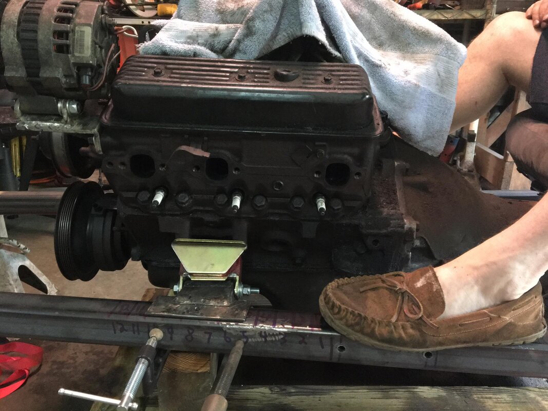

one more ? if i may.....will your feet go outside of the hinged hood, or is there room for your feet between the dash uprights?? curious! larry
Bob...liking what you have done so far!
outside the hood (if I even make a hood)
This shows about where my feet would go, this is a old pic so you have to approximate on the new pic with the dash uprights
I had to make the dash narrow on the bottom just for my legs would not rub against the dash uprights

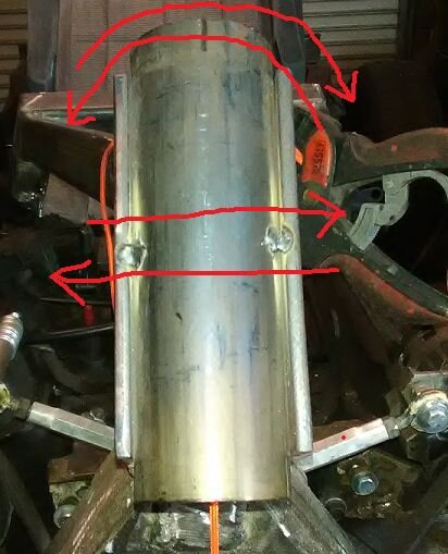

I have the 2 adjustments I am concerned about drawn below

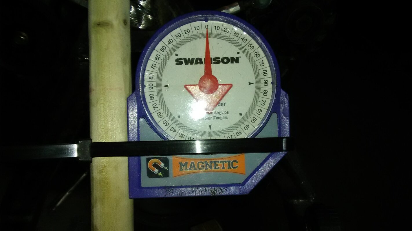

I ran a plumb bob down the center of the neck and that tells me the bottom of the neck is real close
Need to figure out if the top is center also.
Any tips on neck alignment?
long as the neck is perpendicular to the ground you should be fine.... if the whole neck is of center a tad i doubt you will even notice it... my honda subaru trike was of set about an inch or so.... never know it
As it sits now it is off center by about 1/8 inch.
But am looking at how I can make sure it is perpendicular
I like Tom's idea of the cones and a long rod.
A while ago someone else suggested a 1 inch pipe through the bearings to the ground. I tried that with a wooden dowel but did not make the proper adjustments before I broke the dowel. (cant find the right size metal pipe)
Im going to think about this more and gather more ideas before I do anything.
Got to clean the shop today to get ready for Boxing tonight.
Bob,
That looks good so far. Is the dimension from the rear tire contact point to the dowel rod contact point on the floor on each side the same? With the dowel rod perpendicular as you show it tells you that your frame is symmetrically triangulated and should ride good.
The reason I suggested the cones is that they are self centering in the neck bore and then the bearings aren't subjected to the welding heat.
The frame builders use a frame jig for several reasons, the most obvious being speed and repeatability. By clamping the neck and frame tubes in a rigid jig they can control the stresses in the frame until the welding is complete and the parts are cooled and fixed in place. Have you ever cut a frame apart and had the ends of the tubes "spring"apart? This is welding stresses trapped in the frame.
Without a jig the neck will move around as you weld. For example, when you weld the right side of the neck and gussets the rod will probably move to the left due to the heating of the right side components and the associated expansion. This might be a little or a lot. I had an old school welder show me how much a tube could move around while welding up a dune buggy frame. He was welding up a roll cage and the 3 ft long end of the tube would move a full 1/2 to 3/4 inch out of position as he welded. He would watch the tube and weld on the other side to bring it back into alignment. He wanted to minimize the residual static stresses in the frame.
If you mark the floor for the dowel rod triangulated contact point and keep an eye on it while welding you shouldn't get any surprises.
All that being said, I've seen some home built trikes that looked like they were parked on the side of a hill when they were in a level parking lot and they rode just fine. Part of the "fun" of riding a home built trike is going down the road knowing intimately the condition of all the welds and components! :D:AGGHH:
The dimension from the rear to the top center point on the dowel is the same. The dowel is not long enough to reach the ground. But I when I measure from the bottom of the dowel It measures the same on each side also
I cant find a dowel long enough to reach the floor around here. I may buy another one and join them together
I also measured from the top and bottom of the dowel to other fixed points and they are the same on each side.
I also ran a string around the back tires straight past the front like we did back in the day to do a front wheel alignment
I then measured from side to side, The dowel measured in the center
But when I look at it it does not look straight. Part of that is that my seat is not bolted down in the background so that makes it look crooked (need nuts for it). I am headed out in a little to get the nuts
Thanks for the input guys. Keep it coming. I what to get this part right.
as vwbug said it will move when you weld but dont worry about not having the jig....before do you any welding it needs to be tacked good from both sides and alternate the tacks... dont tack all one side first
its the same as if it was in the jig... if you welded all one side first the jig couldnt hold it
another thing you can do.. if you cant find a dowel long enough... if you have someone to mark the floor for you... if you have a hole in you triple tree stem you can sight down through the hole and have some mark the floor where u see the floor down through the hole 4 marks r l front and rear.. stand above the neck a ways gives a smaller view.. . you would be surprised how accurate this is..i have use this method all the time for finding that spot on the ground when figuring for trail... more accurate than holding a bar against the neck
if u have no hole in the stem looking through the bearings works too need to have someone hold lower bearing in
hole you can figure that out
