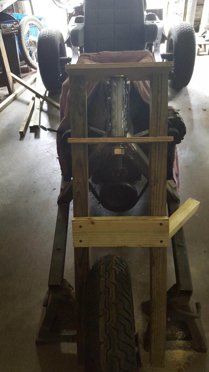

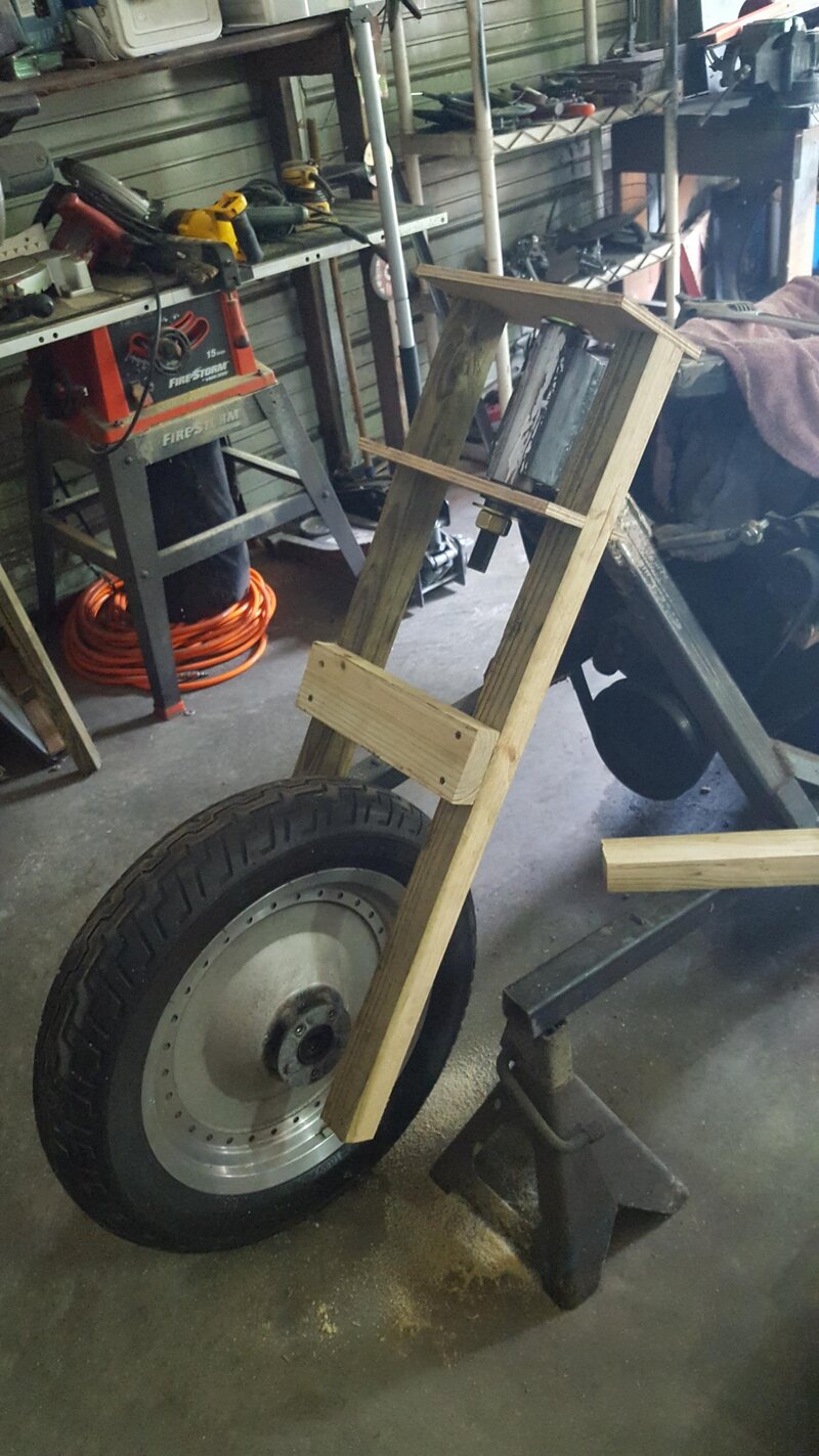

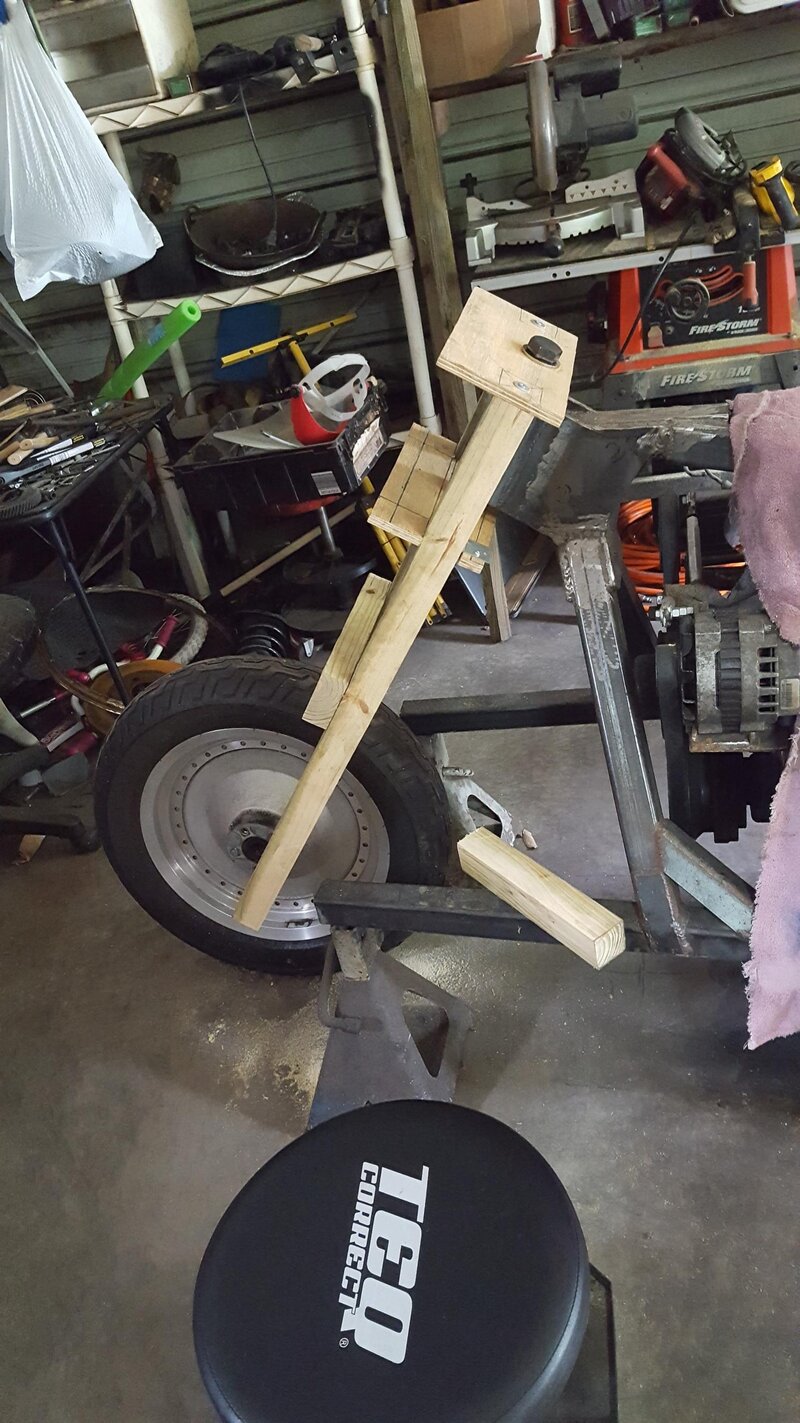

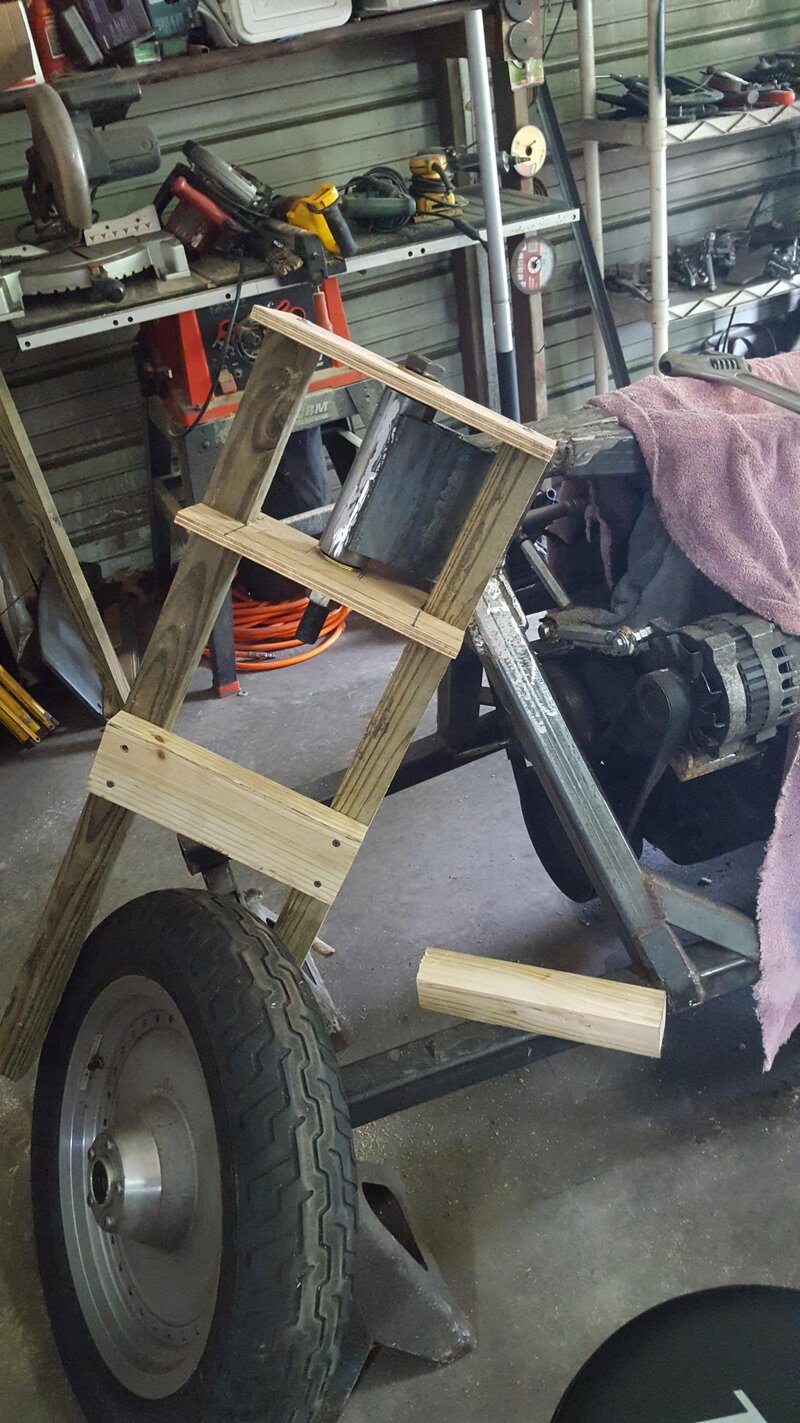

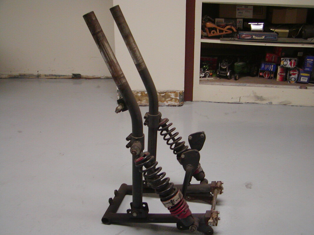

started the mock-up up but i ran out of wood
did not get to the lower part of the forks. (the part that goes straight down or even backwards)
The 2x4 above the tire is just there temporarily to hold the bottom of the forks in the right position
a good way to mock up!.......however got to thinking lol, it would cause some 2nd or 3rd glances if when you finish your forks with the square tubing and steel trees.....that you give the front end a finish
that looks like wood tubes and plywood trees!
the inspector and insurance agent, may not find the humor in that situation!:cool:

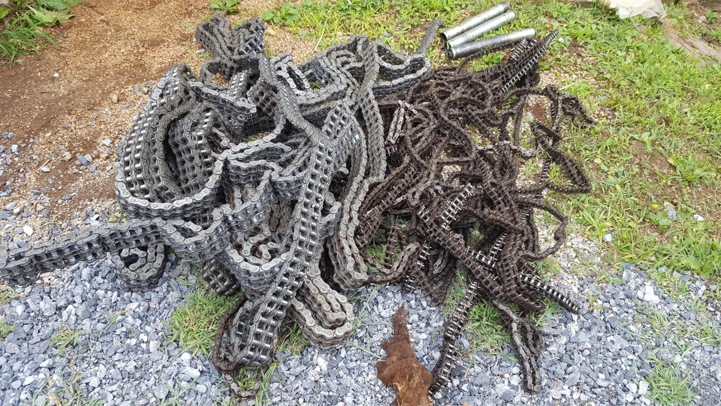

I know it would not be strong enough but I would love to make my forks out of this industrial conveyor belt chain I just got.
I have a lot of it and it has big links. I just cant see it being strong enough. I even though about putting a 1/2 backing on the chain but again do not think it would be strong enough
I have another load of chain to get tomorrow. This stuff is heavy and I did not want to weigh down my sons S10 to much chain.jpg

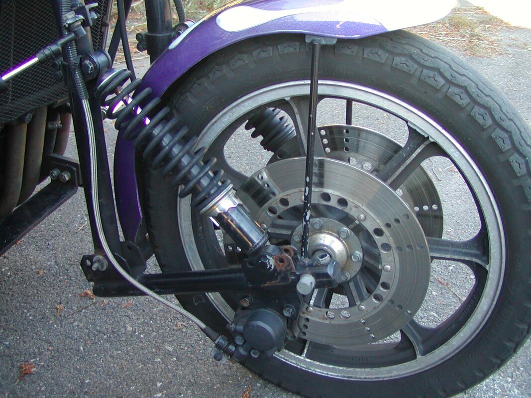

I'm assuming the harley shocks are adjustable like the honda ones? this will help fine tune the height. I needed to add a 1 inch spacer between the upper shock mount and the top tree to get my height right. I would recommend provisons to adjust this dimension when you build. As far as calculating spring rate.....cannot help there. using actual mock up preferred by me, plus weight changes may occur during build and modifications. I'd b tempted just borrow some used shocks to starts with.....shock not important but see what weight the used springs will support. my .02

at 400 lbs i am thinking most any rear shocks from a say a 1000cc or bigger bike should work
if the spring rate isnt quite right change the lower mount and if the height is right you can move that too... keep in mind they seem to work best when the pivot point is about 1 inch below the axle... hope that makes sense

I did not have time to work on it today.
I did order 2, 200lb coil rate coilover shocks
the shocks are 14.5" extended and 11.5" collapsed I hope that is enough travel
I got my 3/4 axle bolt and the 3/4 space in.
The spacer came in 1, 12" piece that i will cut spacers out of as needed.

Leading link is probably the strongest and best weight bearing front end, if you can get past the semi-ugly.
Never heard of a hossack, either, but I'd bet its stronger than plywood ;)...:Shrug:
I never heard of a hossack front end either. So I googled it, went to the site. Well flashed across the screen it says your ipad has a virus. Click this link don't shut your ipad down or risk damage! So I shut it down and got out of there. From was I saw briefly looks similar to tne new bmw front end.
I looked on google images....what it looks like to me is an upper/ lower a-arm setup fastened to the front of the bike frame with upper and lower ball joints or a cross type joints, and the vertical part of an automotive knuckle without the spindle.
....the forks fasten between the ball joints with a cross bar then extend down to the axle.....almost the same as an auto front end.
it would need a coil over shock like an auto would use. looks like it would work quite well.

I got my shocks in
I want to build something like a Earls fork but a regular leading like would be much easier.
I have the enough metal to do either
I have not decided yet.
From what I have read I believe a 2 inch trail would be best either way I go.
