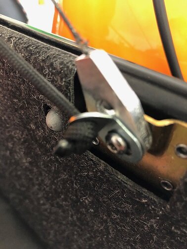

Today's Project #1

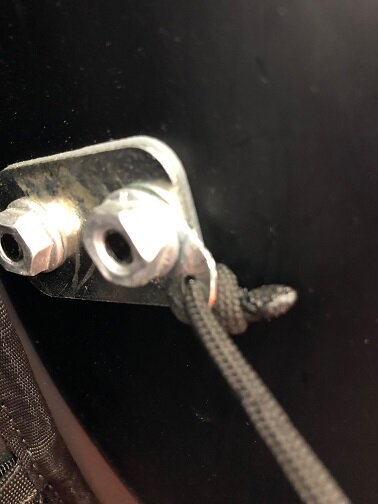

I've seen the pictures and read the comments on the Tour-Pak tethers breaking and breaking the TP or the lid when it falls open. The parachute cord is a good idea, but I didn't want to squish it under the nuts and risk it failing at some point, too. So I went one step farther and found these:
This one is mounted to the upper seat cushion bolt:IMG-0656.JPG
This one is mounted to the bottom tether anchor screw:
There is a fail point where the parachute cord passes through the angle plate, so I think I'm going to take it apart and put some shrink tubing on the cord where it passes through and try to beef it up. Should last a little longer that way.

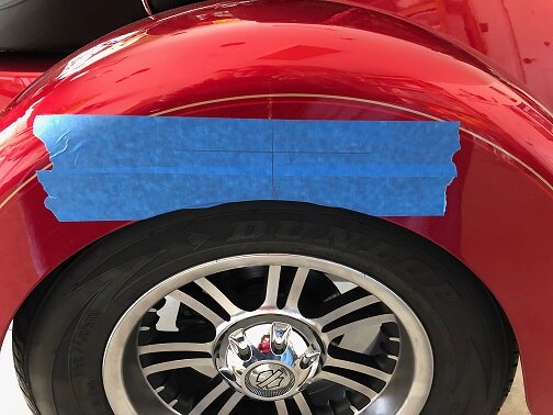

Today's Project #3 Part 1

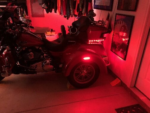

The reflectors on the rear fender didn't suit me, as they are just that, reflectors. I wanted a more "active" marker back there. Went to Custom Dynamics and ordered a pair of their Red TF-R Tru-Flex lighting strips with 20 LEDs. Then to Amazon for 25ft - 1/8 inch Flexo PET Expandable Braided Sleeving - Black/Red - Alex Tech Braided Cable Sleeve and GWHOLE 100Pcs 3M Adhesive Cable Clips. Then the fun began!
The "almost worthless" reflector.

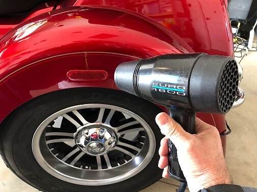

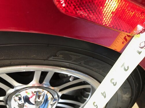

Taking and marking measurements. Mark at center of reflector with a perpendicular line. Then measure the horizontal center of both ends of the reflector and write the measurements down for future reference.
Borrow the spouse's hair dryer (or use your own if you have one) and heat carefully, moving the dryer over the reflector until you can start to move it. Keep heating and work it around until you feel it loosen and peel it off. Clean the residue with your favorite cleaner and, you have a clean fender!

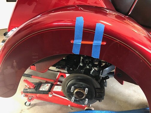

Painter's tape on the fender to cover the area where you will transfer your measurements for light bar placement. Mark your measurements and center the light bar on the lines. Make a mark where the wiring will pass through the fender. I put my wire marking to the rear of the bike. Use that mark to drill a 3/32" hole in the fender. OUCH! I know there are some that will cringe at doing this, but it's the only way!

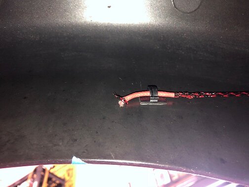

You will want to thread the Light Bar wiring through the 1/8 inch Flexo PET Expandable Braided Sleeving - Black/Red - Alex Tech Braided Cable Sleeve at this point and shrink tube the end of it as close to the back of the Light Bar as you can. Again, Be careful with the heat on components. Then start your wiring through the (UGH!) hole in the fender. Tape it up out of the way to make work easier.

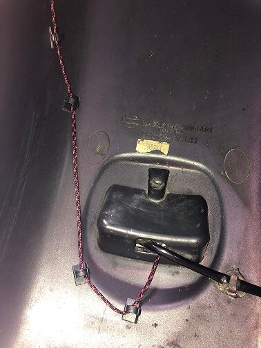

After bringing the wiring through the fender, I used the GWHOLE 100Pcs 3M Adhesive Cable Clips Cord Organizer Wire Management clips to secure the wiring to the inner fender back to the taillight and tapped into the black wire to connect the black wire and the blue wire to connect the red.

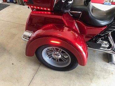

Today's Project #3 Part 2
This is the Custom Dynamics TF-R 20 LED mounted permanently in place with no power applied.
This is the Custom Dynamics TF-R 20 LED mounted permanently in place with power applied.
Makes a big difference! Picture was taken in a fully lighted garage.

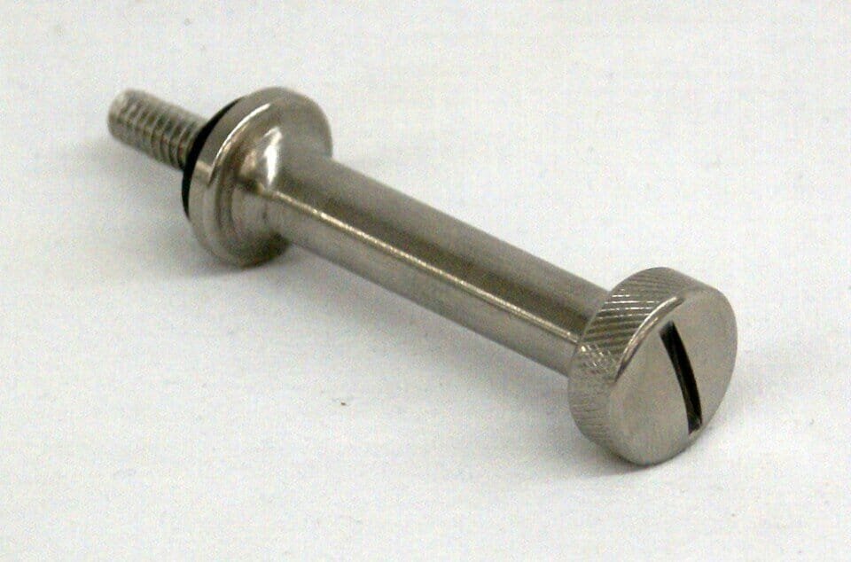

Mounted and wired DK Custom's Stealth LED Driving Lights. Replaced the OEM Seat Screw with Rivco's 2 1/2" Knurled Seat Knob. The longer knob is much needed with the one inch longer than stock Ultimate Seat. Did some quick cleaning with Purple Slice to remove bugs and lite grime from yesterday's run to Dealership for their April Lunch Ride. Maybe some installs tomorrow, but best of all.....some ride time!!
Rivco Seat Knob....no more fumbling with a screwdriver deep in that dark cavity.:)hd9000_updated_009_ps_web-1.jpg

Wes, I would keep an eye on that seat knob and make sure it stays tight. I had something similar on a VTX several years ago and could not keep it tight (never tried blue lock tight) and finally lost it somewhere. Hope this one is better than what I had then. Keep us posted, if it works for you, I may try one. I like the idea.
