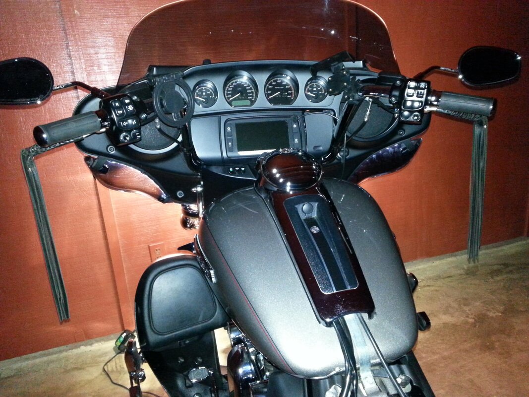

Alan, since there has been so many previous threads on handlebar changes, I figured I just post highlights of my projects. Since the inner fairing only needed to be released from the forks and tilted back for access to disconnect/reconnect and rerouting of cabling, and swap out of riser bushing.....I didn't take any pics of that. Just took the one below of new bars. Right now I'm not sure if it's good night or good morning.:laugh:
First, I was overly optimistic in thinking I could singlehandedly do the handlebar change and Mighty Mite install in one afternoon, but did finish up so soldering jobs. However, due to all the bending and stooping my joints and muscles took a beating.....been heating pad and meds tonight. For today's efforts, age certainly proved it's more than a number.
I did completed the handlebar change, plus removed the stock riser bushings and installed polyurethane bushings. After running the internal cable for the TGS, I decided against attempting internal wiring for the other cables. I did a test fit of PV tuner and will leave it on the right side. Just have to tidy up the cable when I run other wiring. Think I'm going to like these bars and looking forward to getting a ride when I'm finished. I already like like that the center of the faring, gauges and auxiliary dash panel is more open now, just an illusion because the controls are farther apart.

Nice work...know what you mean about the joints and age.:xzqxz:
Question for you...where did you get that cover that is over your electronics, under the seat? Did you make it, or purchase it?
Kevin, you guys have great eyes and can spot all the small differences and little oddities, even those in photos with bad images. Even I was stumped as to what was so neatly covering the battery and seat area. It's not a cover, it's my Service Manual that's open in a binder. Fits neatly there for quick reference. Guess the night shot under car port with bug light and flash washed out the pages color and binders outline.. Man you had me puzzled.....and I took the photo.:laugh: Taking it a bit slower today, besides starting tomorrow our forecast is thunder storms through the weekend.:(

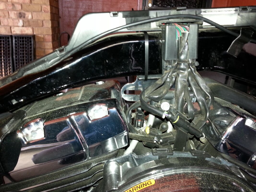

Today reattached and torqued the steering damper, installed the Mighty Mites, but used the horn mounting method. Made this decision after discussion with Randy. The frame mount method requires installing on the frame between the two cylinders very close proximity to the hard coolant lines carrying fluids to and from both heads. Just don't trust my skills in that tight space. Decided to play it safe! Will return the frame mounting kit. Will see how well the horn mount method works. Can always get a Vibration Master later if need be. All electrical connections received dielectric grease. Torque Wrenches got a workout too.

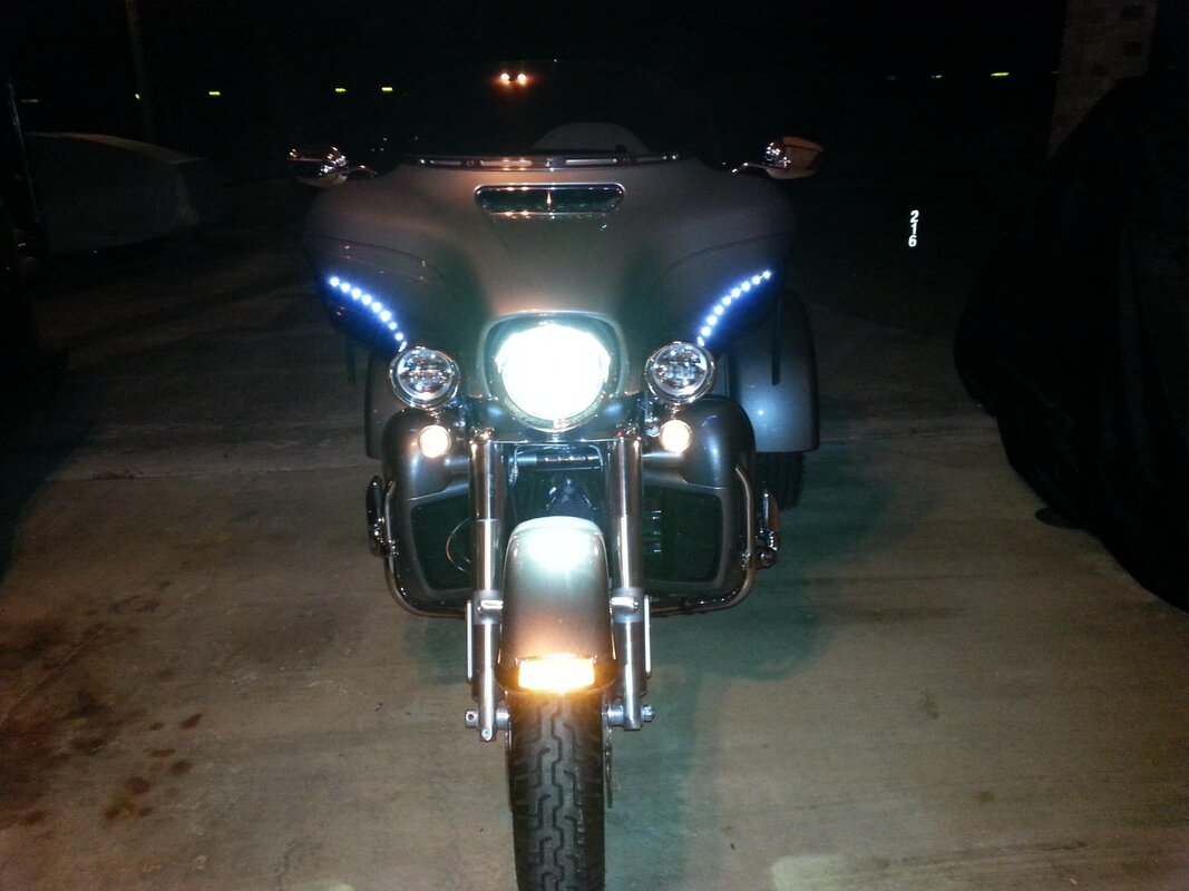

The Mighty Mites look great (like fine jewelry) and they're not as loud as I thought. They will really earn their keep when temps begin to climb. I added some daytime running LED's to the fairing. They also have amber turn signals on each side. Got the tank reinstalled too. Hopefully, a few more things will get done over this stormy weekend.
My 16 is at the dealer getting a few things done and one of those was to put on the Mighty Mites with the frame mount. Dealer tried it but did not like how tight the frame mount / coolant lines were, so they did the horn mount instead. So, I guess I will see how that all works out too.
By the way, nice job there!

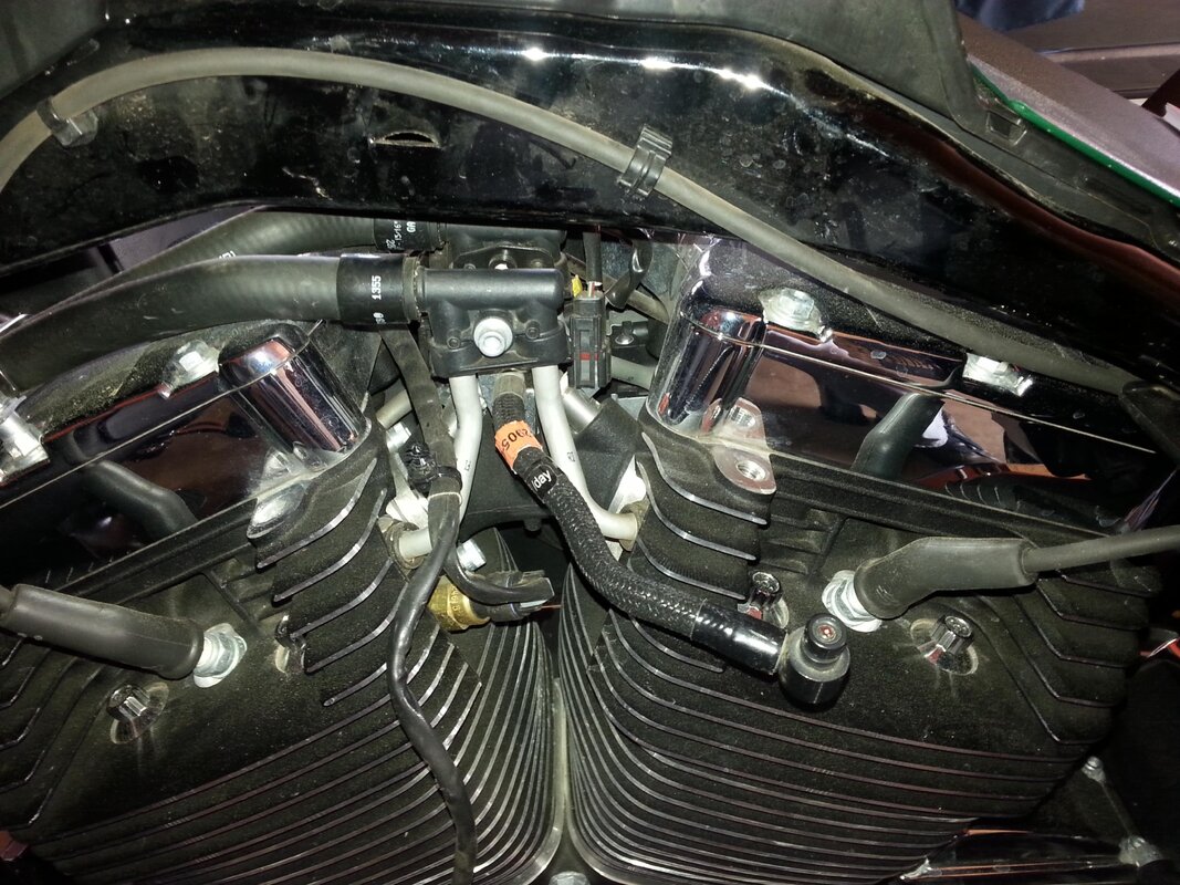

Feels good to know that my concerns were shared by the professionals. No chance to ride as we've got stormy weather through Monday, but I'm anxious to get time behind the new bars.Here's a couple of snapshots showing the location for frame mounting. Second pic shows the bracket under the frame with one zip tie, but that's as far as I cared to go. That wiring loom on the right side poses difficulty too.
Do know that the kit has been installed on trikes.....just takes someone with a Skill Set Echelons above my level.:)
Thanks for the compliment.....Congrats on your Mighty Mites!
Would you keep me posted on your thoughts on whether you stay with just the horn mount or go to the vibration master?

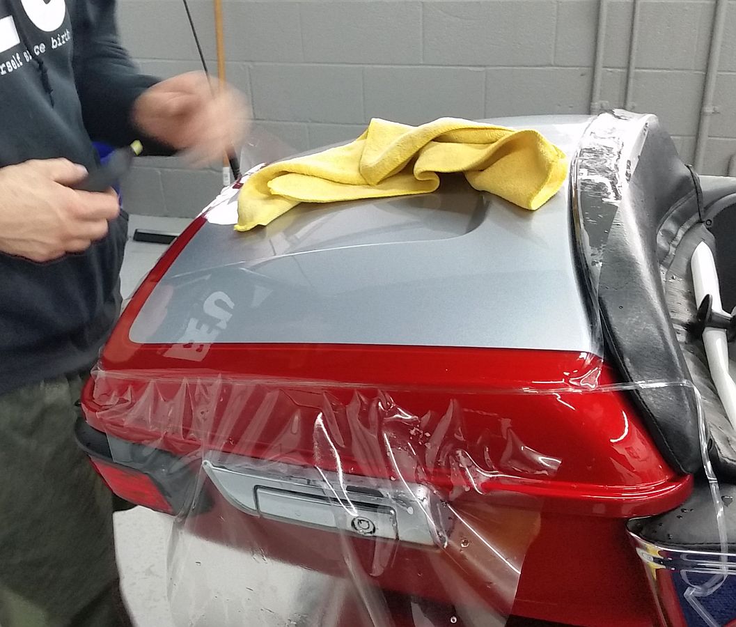

Yeah, a first appointment at the Tint Store to have them put protective film on, then over to drop it at the dealership for them to install the bars.
I have a screenshot of the weather I rode thru yesterday to get to those two appointments...will post it later. LOTS of rain, no lightning hits! lol
Hopefully they will be calling this weekend that it is ready for me to pick up.
Unfortunately, I need to take it back to the Tint Store. He did not get the job done before I had to leave to take it over to the dealership.
Here's a photo I took while is was in progress on the Tour-Pak Lid.
