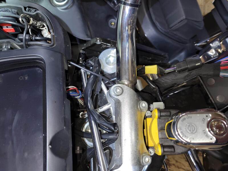

Finished up doing new speakers and amp today. Took alot longer then I had planned for. But thats why I waited for the weather to cool off. Everything was pretty straight forward EXCEPT the speaker pods. Don't watch any of the YT videos' out there and think it's gonna be easy. The Trike is different. With our rake the last three bolts on either pod are pretty hard to get to. Make sure you have a long (like 24") extension and swivel sockets. Not just a universal. Maybe a ball joint allen wrench would work. It took longer to get those bolts out then the rest of the install. I found the best way to get to them is to remove the passing lights and fasteners that hold the fairing in place. Lift up about an inch or 2 and tilt the fairing forward. The fork down tubes block four of the bolts. Otherwise...easy day...or two....maybe three if your retired and don't care how long it takes. More if you don't use the Cicada HDTLINK harness.
