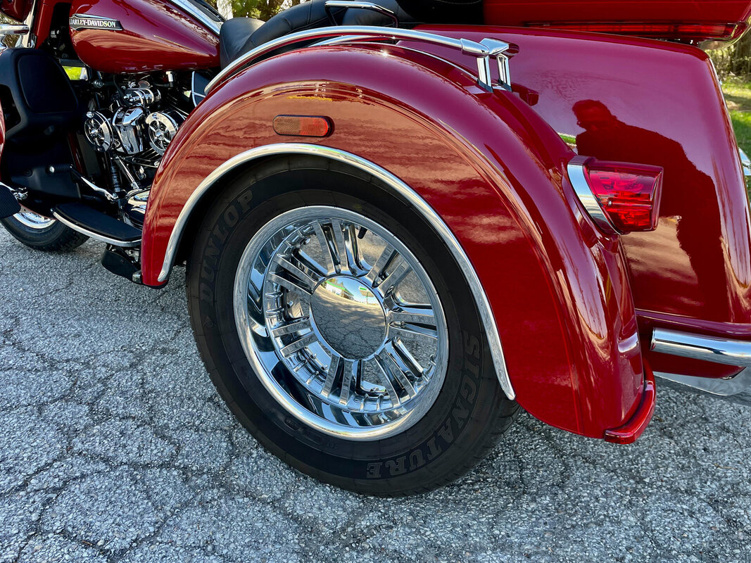

Removed, washed, polished and ceramic coated both rear wheels. Tomorrow the front one.

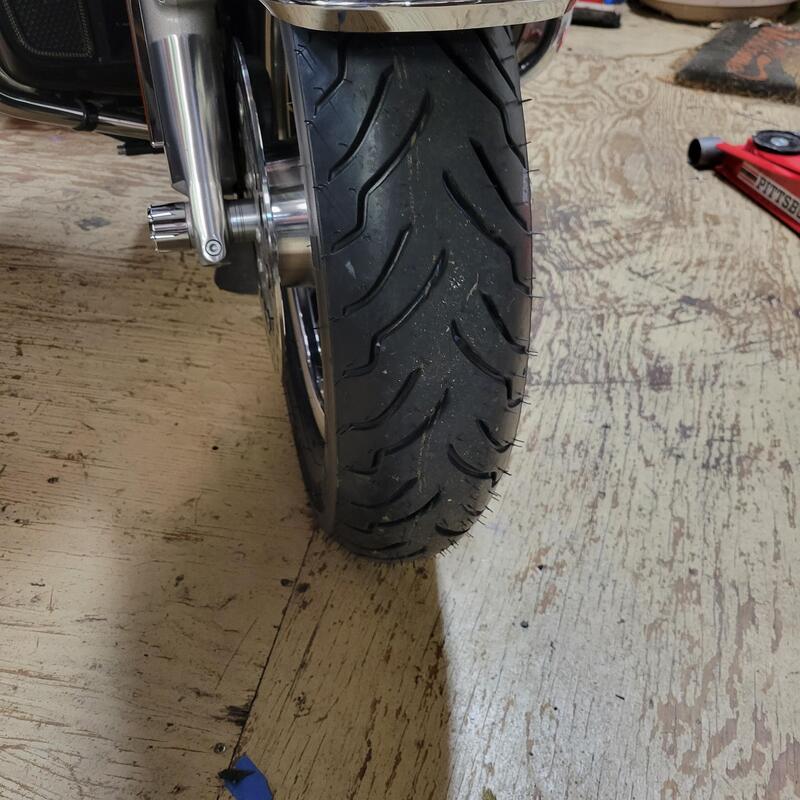

reversed front tire
Got a Dunlap American Elite rear tire installed. Reversed mounted. Took some pics to show at least on this tire that doing this does not point the water grooves in the wrong direction. Took a short 10 mile ride to test the handling and to spread the Ride On out that I use in every MC tire I get. Seems to track well. Maybe a little less of the feeling that your pushing the tire threw a turn. We'll have to see how it handles in the rain.

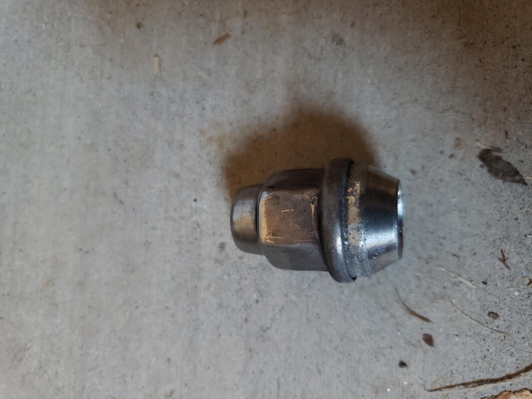

Replaced the rear wheel lug nuts with solid one piece nuts. This replaced the MOCO factory two piece lug nuts, small nut / chrome cover. Thanks for this information Kevin at DK Custom.
Can I get more info on this please?
Thanks.
There was a discussion on the forum about wheel lug tightening. Over time the factory lug could become loose due to the external chrome cap that is pressed on the lug, not tightening correctly. Could be a problem with someone who is removing the wheels many times as Kevin had. This may have been on a wheel thread. The cover did not contact the wheel surface, just a chrome cover. Think about a bottle cap.
